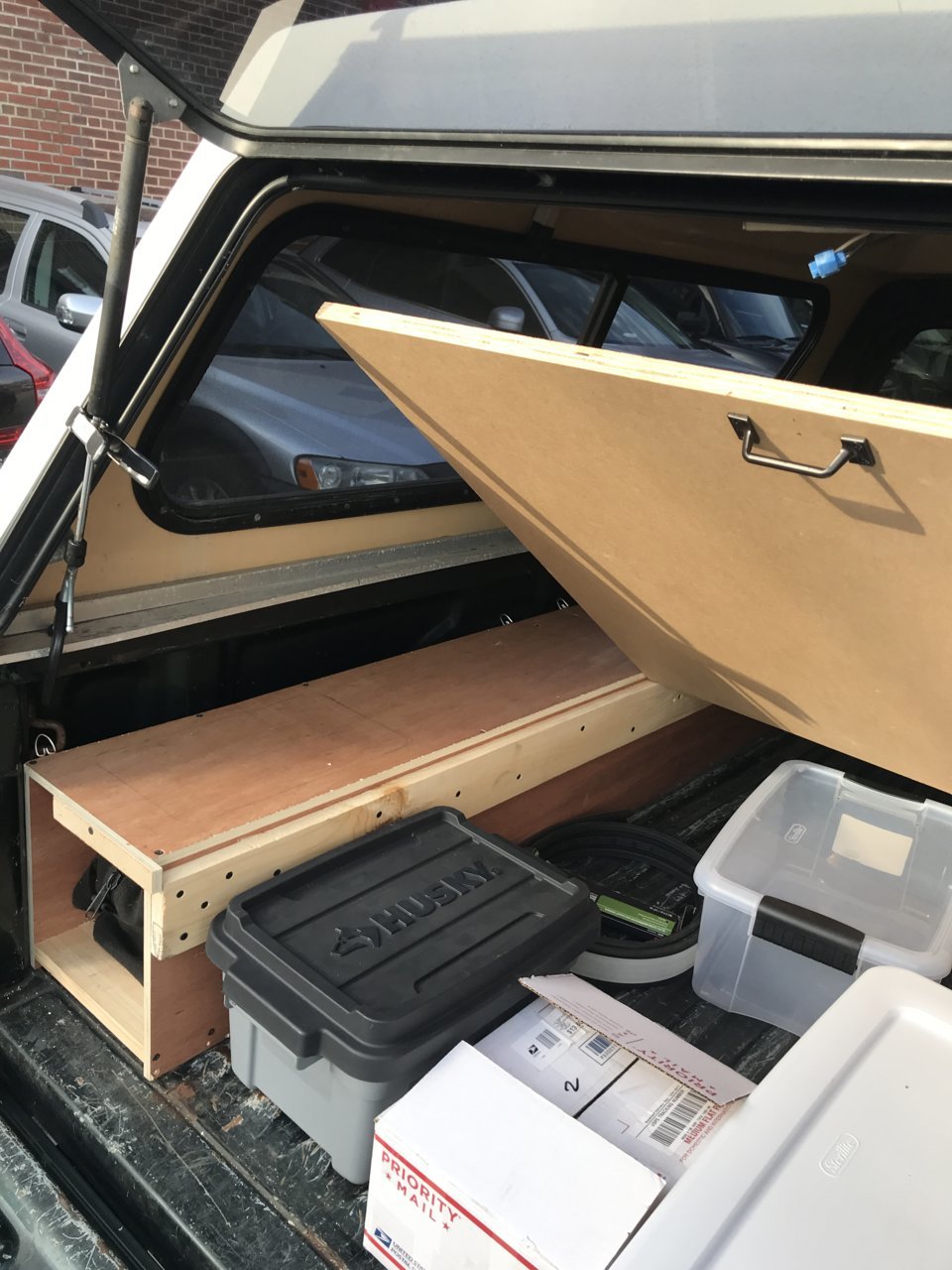

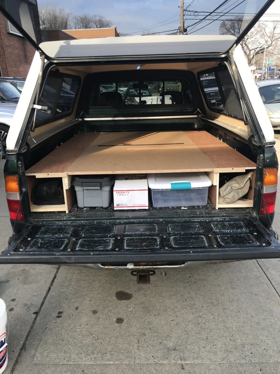

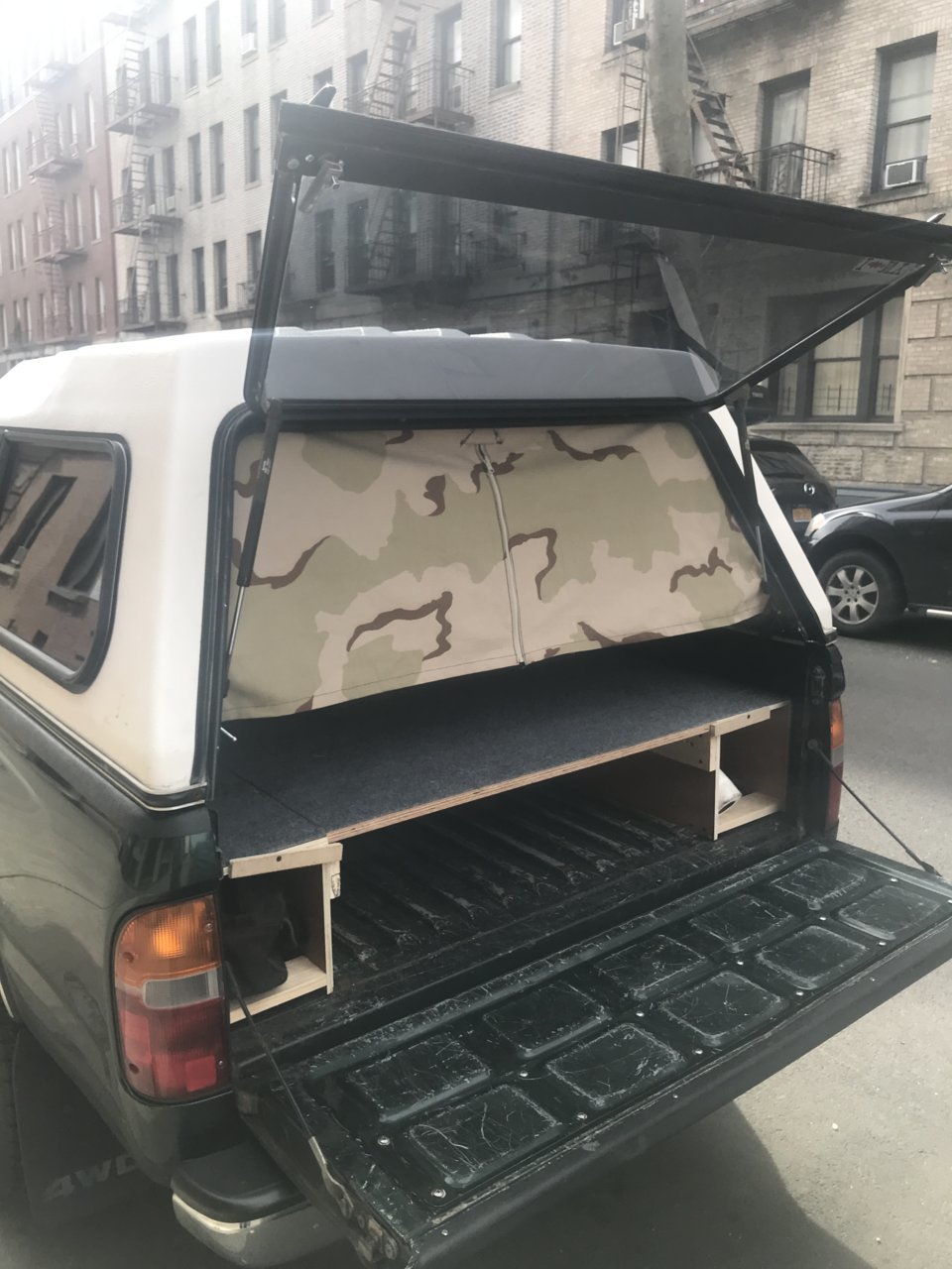

    Some progress since my last post.
    Hinged the center panels so one half can be folded back or lifted to load underneath.
    Next up, cut some doors in and add carpet.

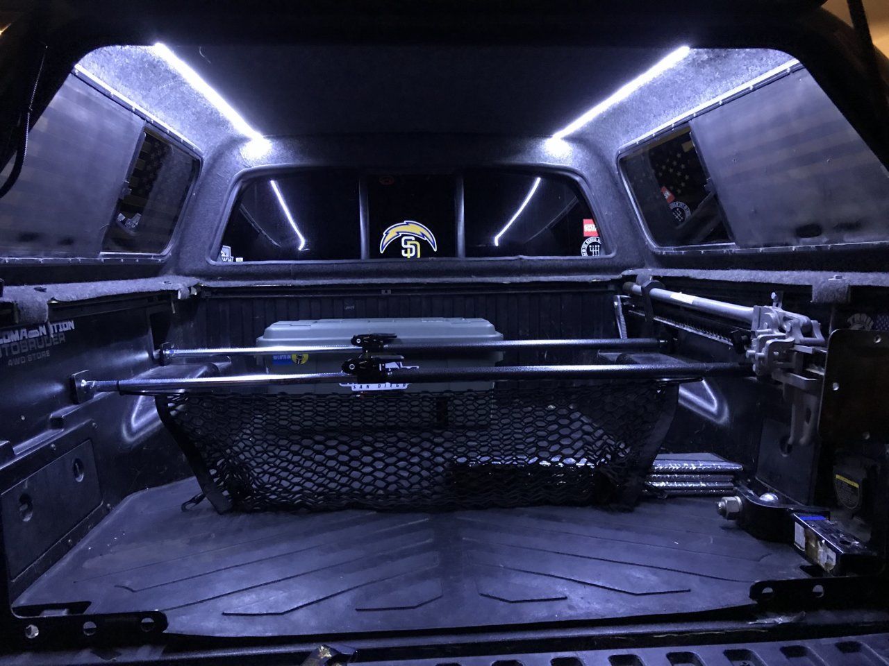

    stuff
    Not sure if it was someone in here or the other shell thread but I was asked how I attached my lights to my shell. I used the double side tape and hot glue gun. My shell is carpet on the inside so not sure if it will would on the bear shell, but this works really well. I laid it not straight on one part and i had give it a good pull to get it off.

    What basket/netting is this??? Very interested in it. Thanks.

    stuff
    It’s just the cargo net out of my wife’s new rav4. I stole it and zip tied it to the bar. I use the bar to stop crap rolling around. Being lifted and me short it turns in to a pain. Then I can put smaller stuff in the net.the other bar stops my box of tools and recovery stuff from moving

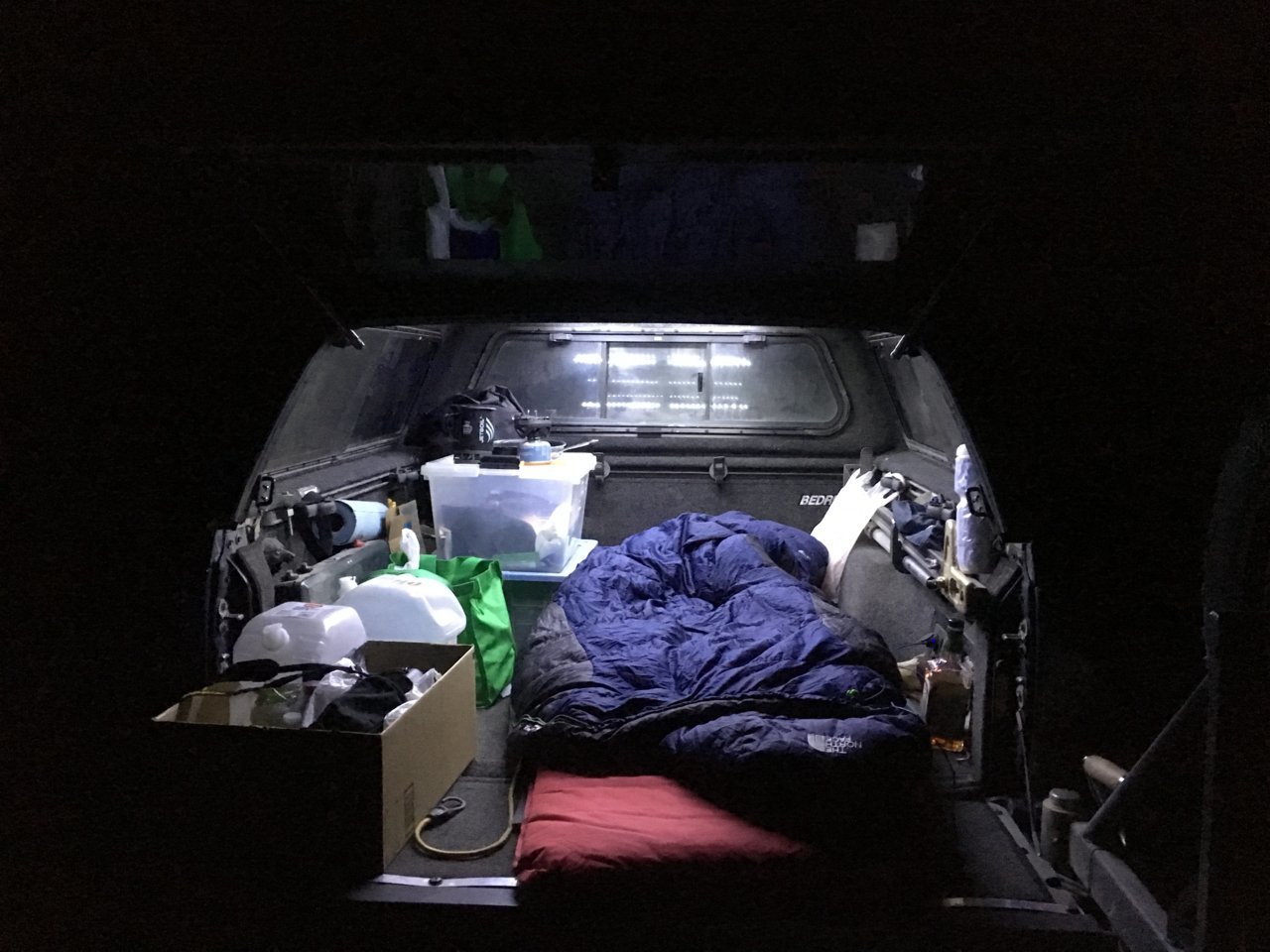

    Just finished my milk crate "floor" last week. Usually I've also got 20lb propane tank, gas firepit, Home Depot Bucket Loo, Tool Box, ARB Awning Room, Buddy Heater...
    Milk Crates have lights, 1lb propane bottles, everything to cook with, toiletries, couple tiny folding chairs and whatever else I can't think of. Probably need to get through and organize those!

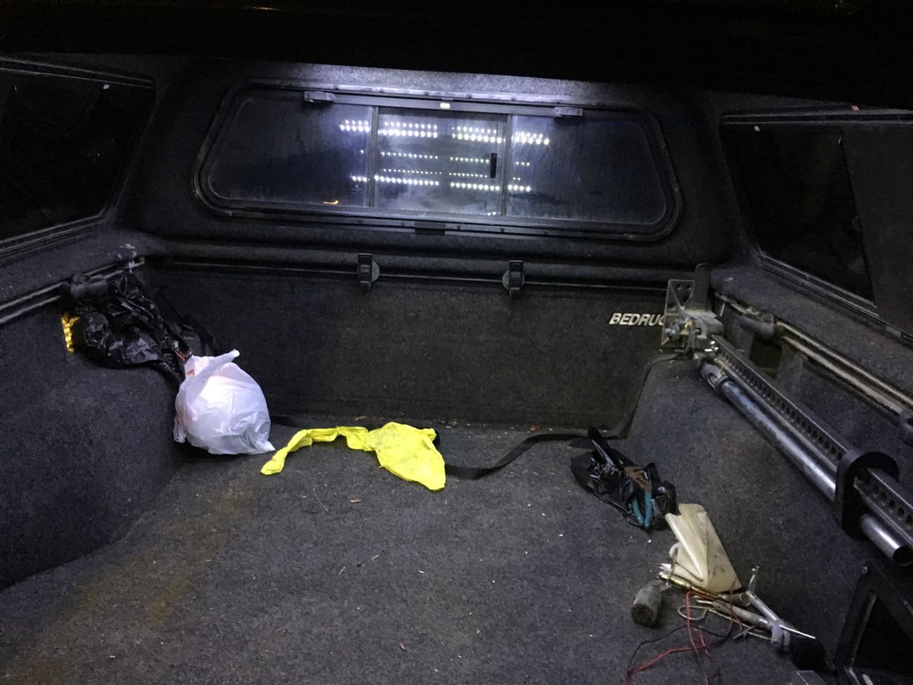

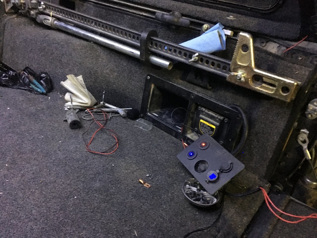

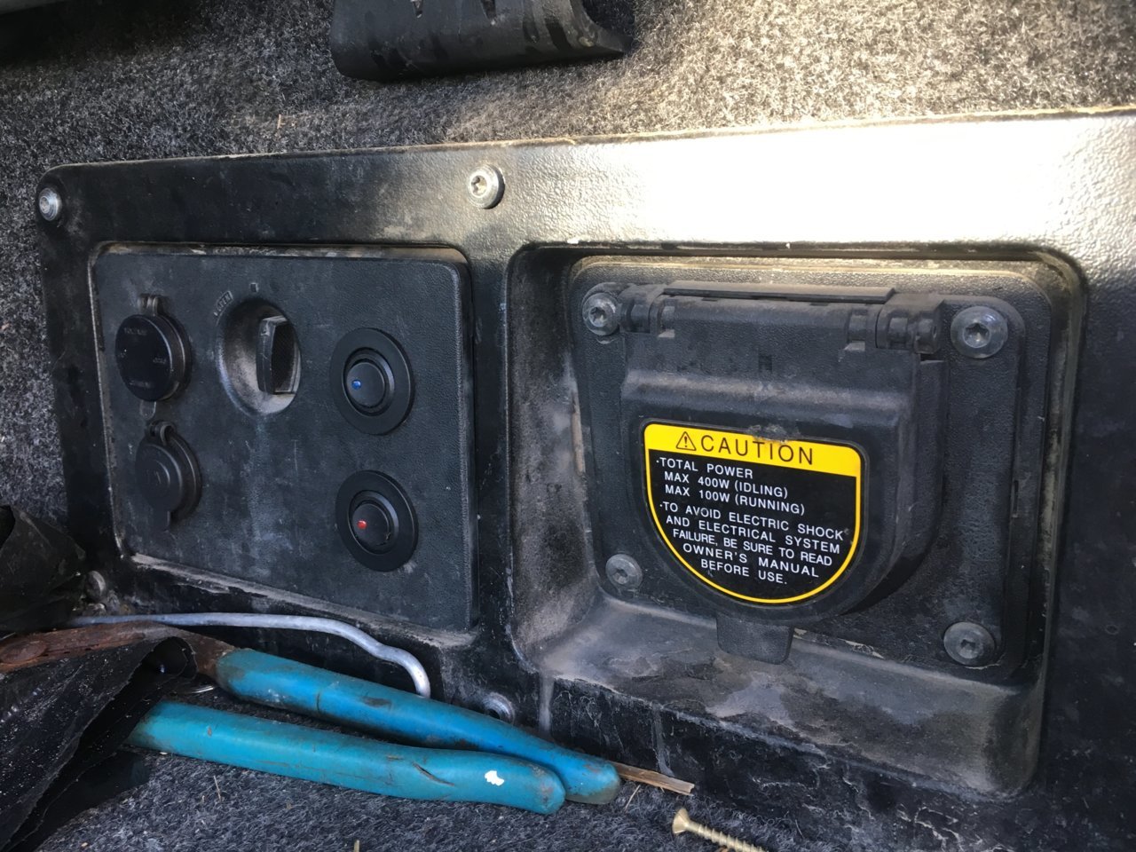

    Added better lighting and power to the back. Ran 6 AWG from the battery to the bed. Installed a fuse panel in the cubby and a breaker under the hood (wrapping the mount for the breaker later this week then I'll be official done with this project).
    Used double sided Velcro to cover the wires on the headliner and the LED strips are attached with adhesive backed Velcro tape.
    CE9C09F0-FBE1-4F1F-812F-318C8C2F9EA5.jpg C6B2587F-A44C-4938-BFEC-52B9EA17DE15.jpg
    This pic was taken at midnight in a dark driveway when I was testing the light output. It's like daylight back there now.
    Testing before installing. Added a USB3.0 charger with volt/amp meter and a 12v plug...both wired to the red switch. The switch on the top right controls the LED lighting. I'll add another 12v plug that'll be always hot for a fridge when that time comes (this will all be powered off a second battery at some point too).

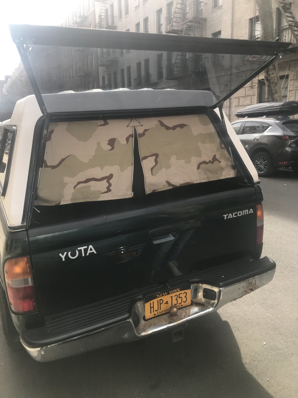

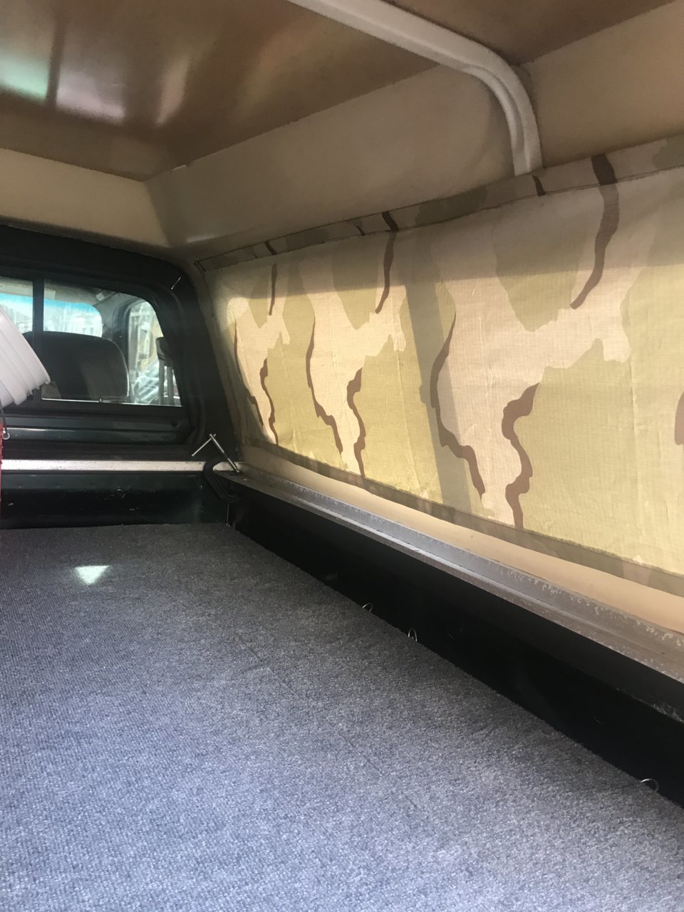

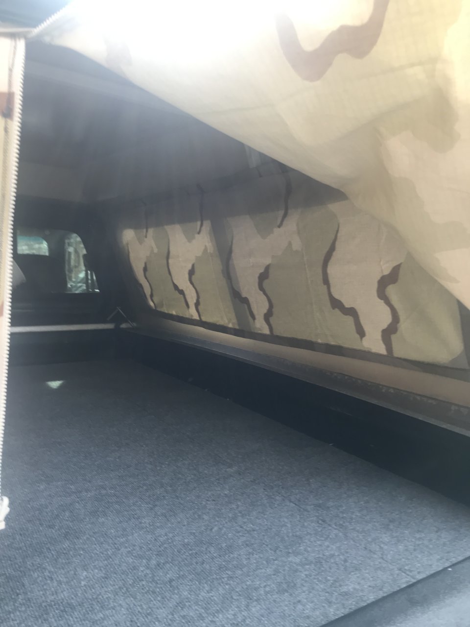

    Alright, my platform is all done and carpeted, and I made some curtains to go on the windows for privacy and to block some sunlight. They are hung using heavy duty Velcro so I can tear them off when I’m not sleeping back there.

    nice job. stealth & more stealth. like the platform "locks".
