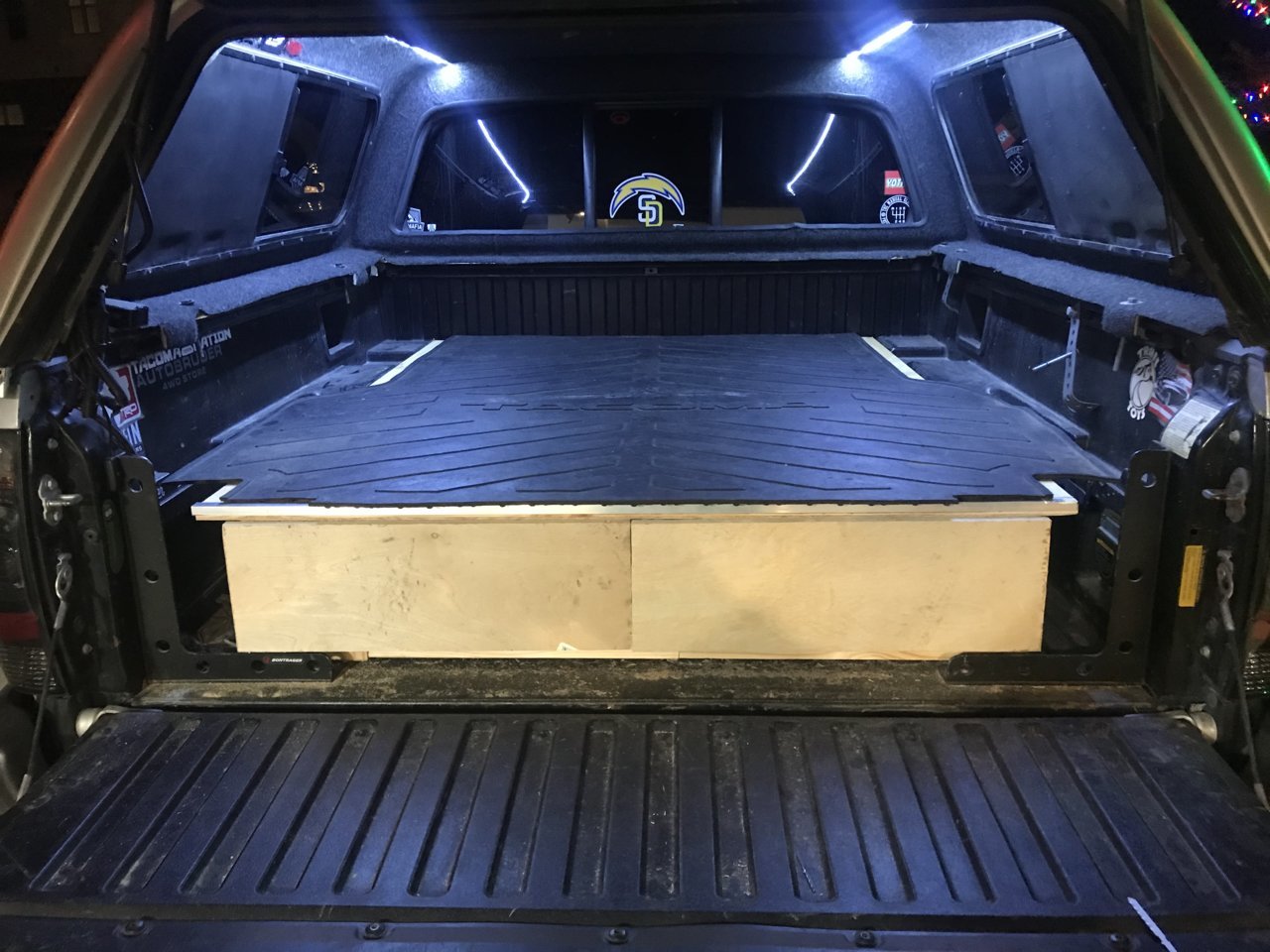

    Installed a LED strip inside my topper. I honestly didn't realize how bright it would be, it's almost too bright.
    I did install a dimmer with it, but even at its lowest, its still pretty bright.
    Last week I ran a new 9 conductor cable from the front of the truck to the back and replaced all of the poor wiring runs that I had done in the past. Right now I have 4 legs as spares, so we'll see if I need them all in the future.
    This is the strip I got: https://www.superbrightleds.com/mor...-fixture-low-profile-surface-mount/1683/9700/
    Dimmer: https://www.superbrightleds.com/mor...2a-12-volt-dc-single-color-led-dimmer/61/364/
    Extension: https://www.superbrightleds.com/mor...-extx-series-power-cable-extensions/935/2291/
    Plug: https://www.superbrightleds.com/mor...ors/cps-pt-pigtail-cps-adapter-cable/759/376/
    I installed rivnuts into the reinforced section of the topper to mount the little metal clips that the led bar uses. This worked since there is space there to not drill all the way through.
    I actually had to revers the plugs on the dimmer switch since it only works one way, but that was pretty easy with a soldering iron.

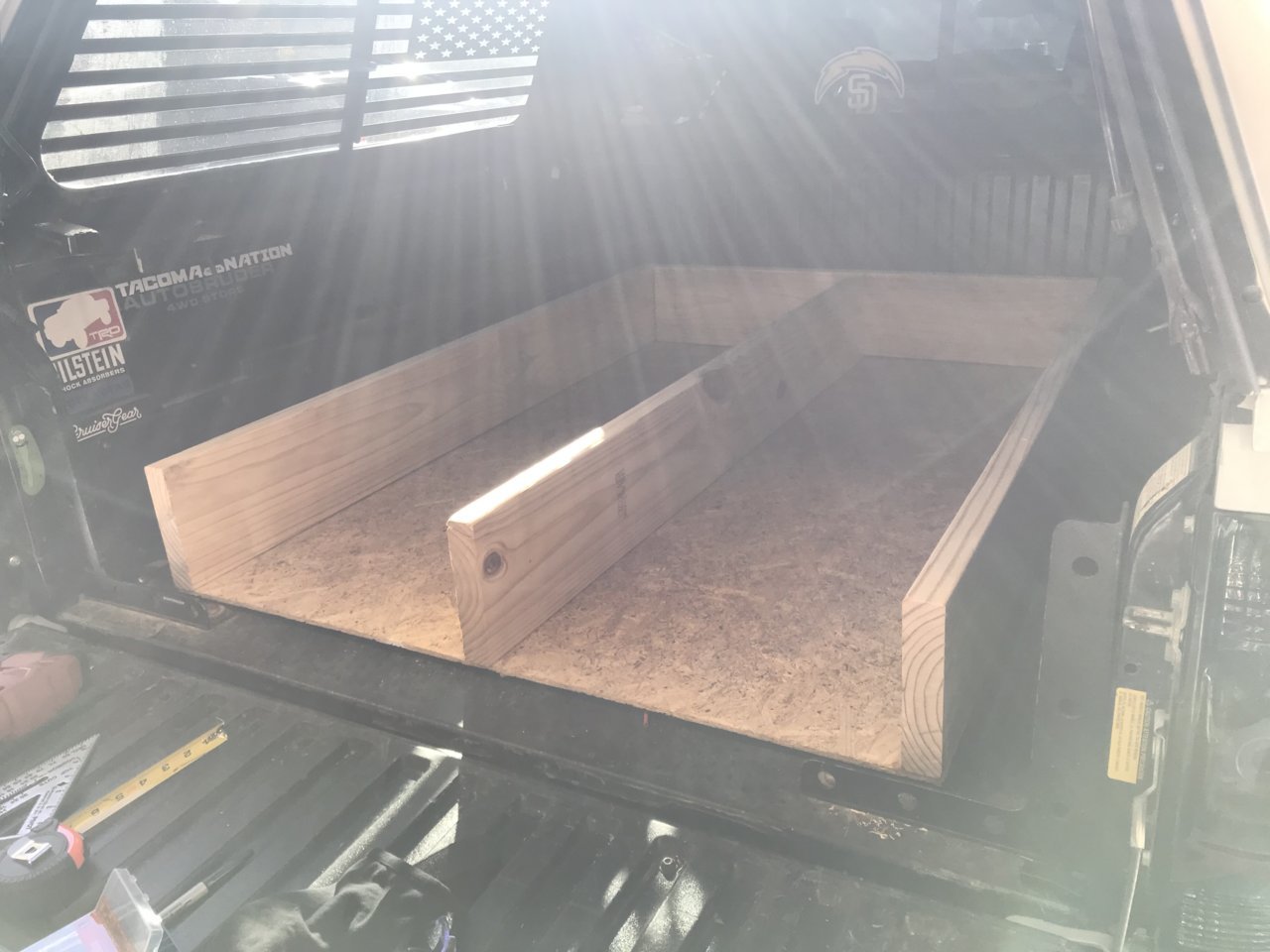

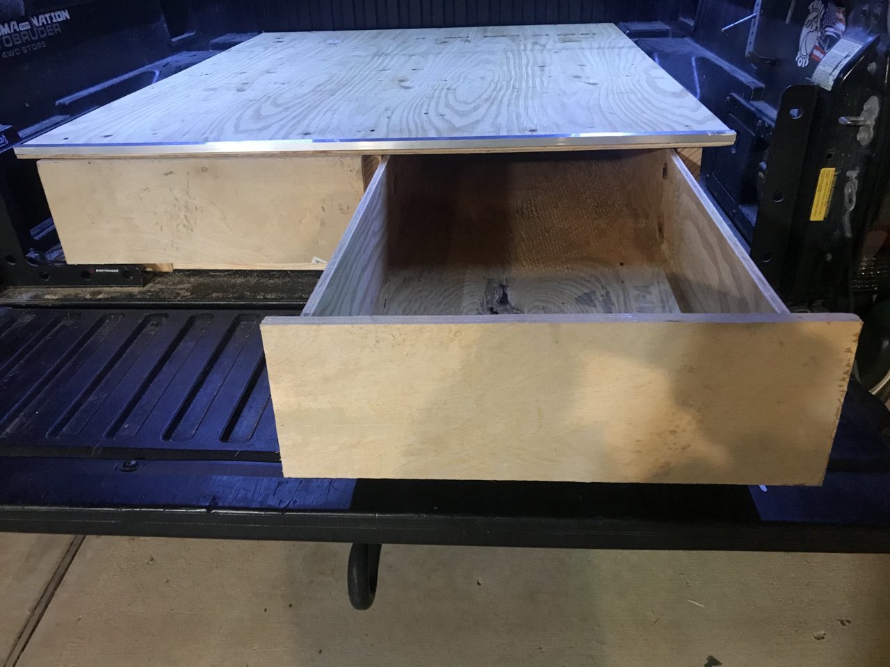

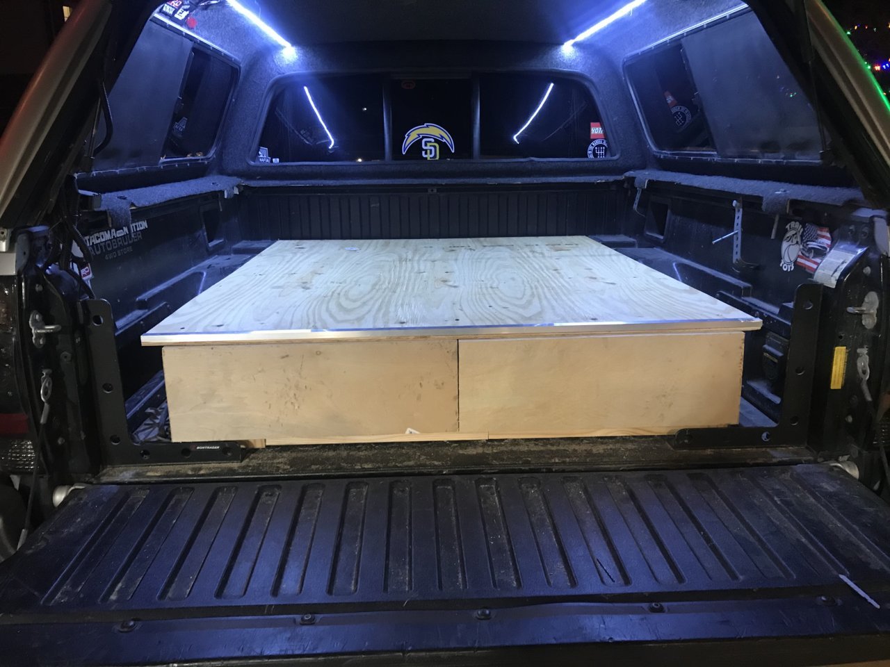

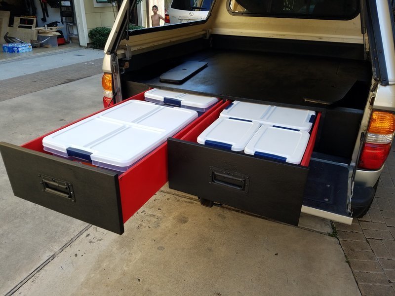

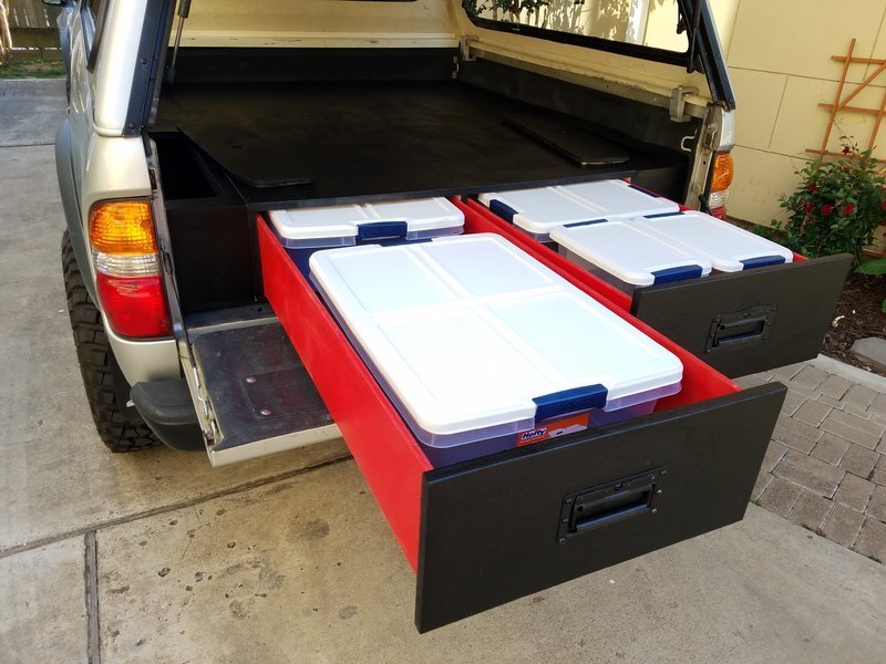

    Finished my drawers for my bed. Completely forgot about the handles. Going to add sides to make it a full flat top and paint it before jambo. Going to sleep back there that weekend. Had to add 1” spacers under it so the drawers would clear my bed stiffeners.

    Wow, I love those

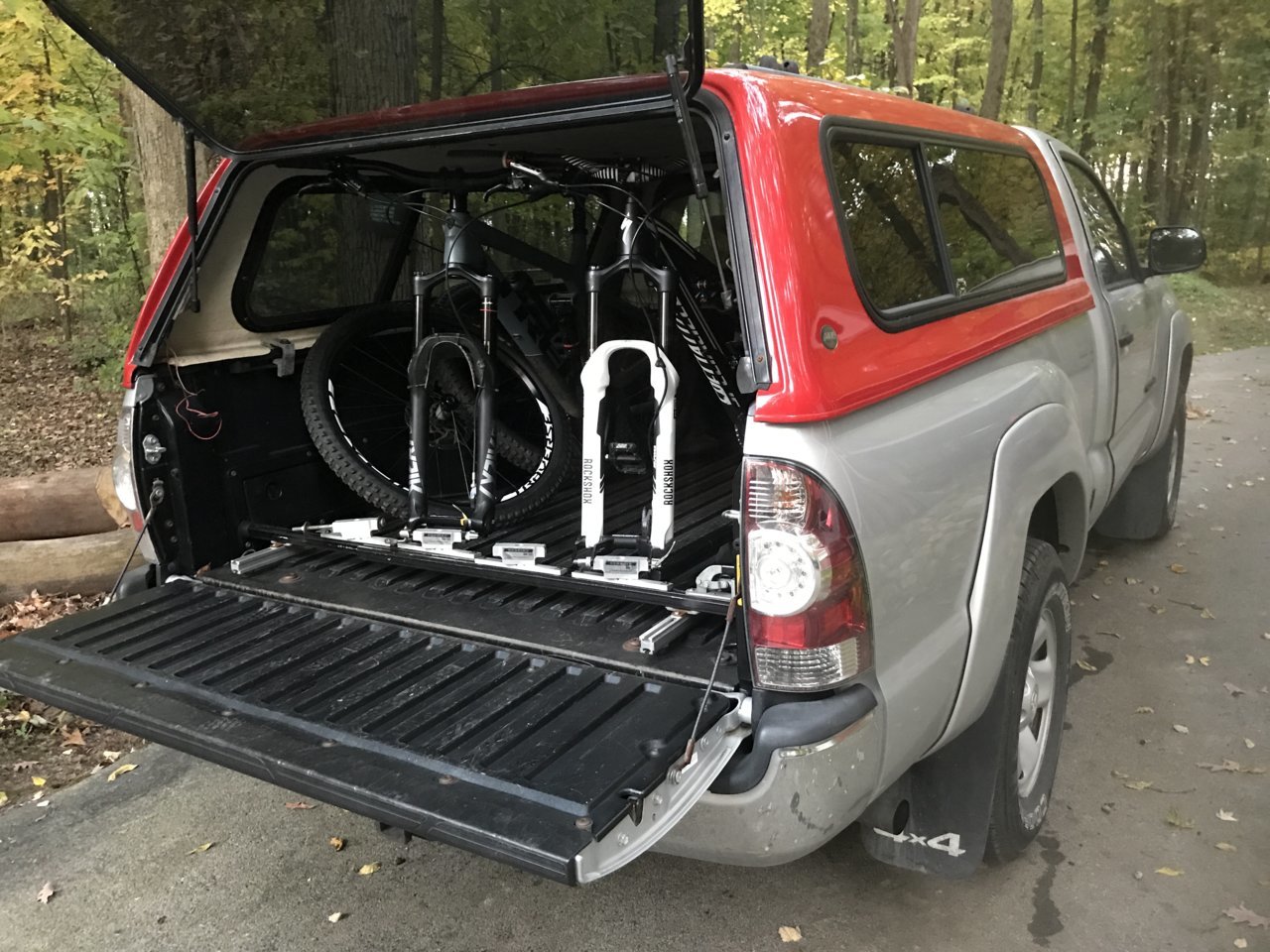

    the main use for my mismatched as hell topper!
