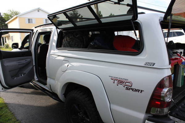

    Went camping with my family up in northern Newfoundland for three nights. I'm super glad I bought a shell. Finally got to really use it :)
    The windoors worked excellent. I'm really glad I got this feature. It made getting certain gear out of the bed really easy.
    And here is some of the gear. You can fit a ton of stuff in the back. I had no trouble taking more stuff.

    Nice shell. You might want to put some 3M clearbra on your bedsides where belt-buckles and whatnot will rub when people reach into those windoors.

    That's a great tip! Thanks so much. I really appreciate that

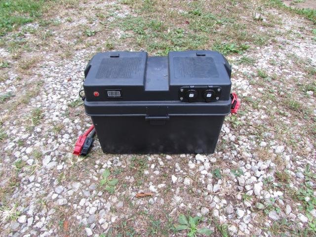

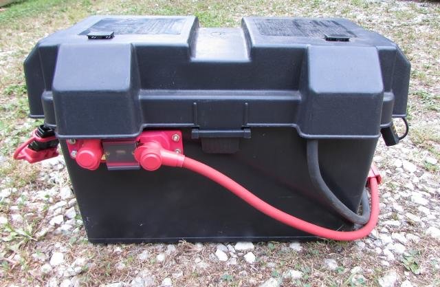

    Do you have a build thread? I need to know how the fridge is connected and kind of fridge.

    I don't have a build thread.
    It's a Dometic CF-18. Not very big, but enough for my needs. The important thing is that it uses a Danfoss compressor, known to be reliable and not suck too much juice. Google it and you'll find plenty of info.
    The fridge comes with a 12 V power cord which plugs into a standard 12 V receptacle. I run it up to the battery box that you see in the front of the bed. The battery box has a pair of Blue Sea 12 V locking receptacles. The battery box is connected to the truck's electrical system through a solenoid that provides isolation when the truck is not running. It also has two pigtails, one for charging with an AC charger and the other with a portable solar rig. It also has a voltmeter with a momentary switch. All of the connections are fused. It looks like this:
