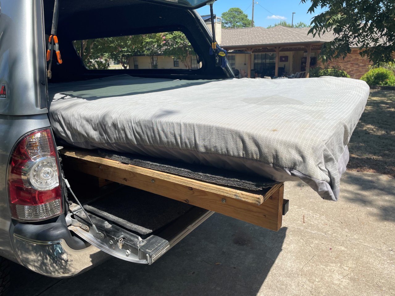

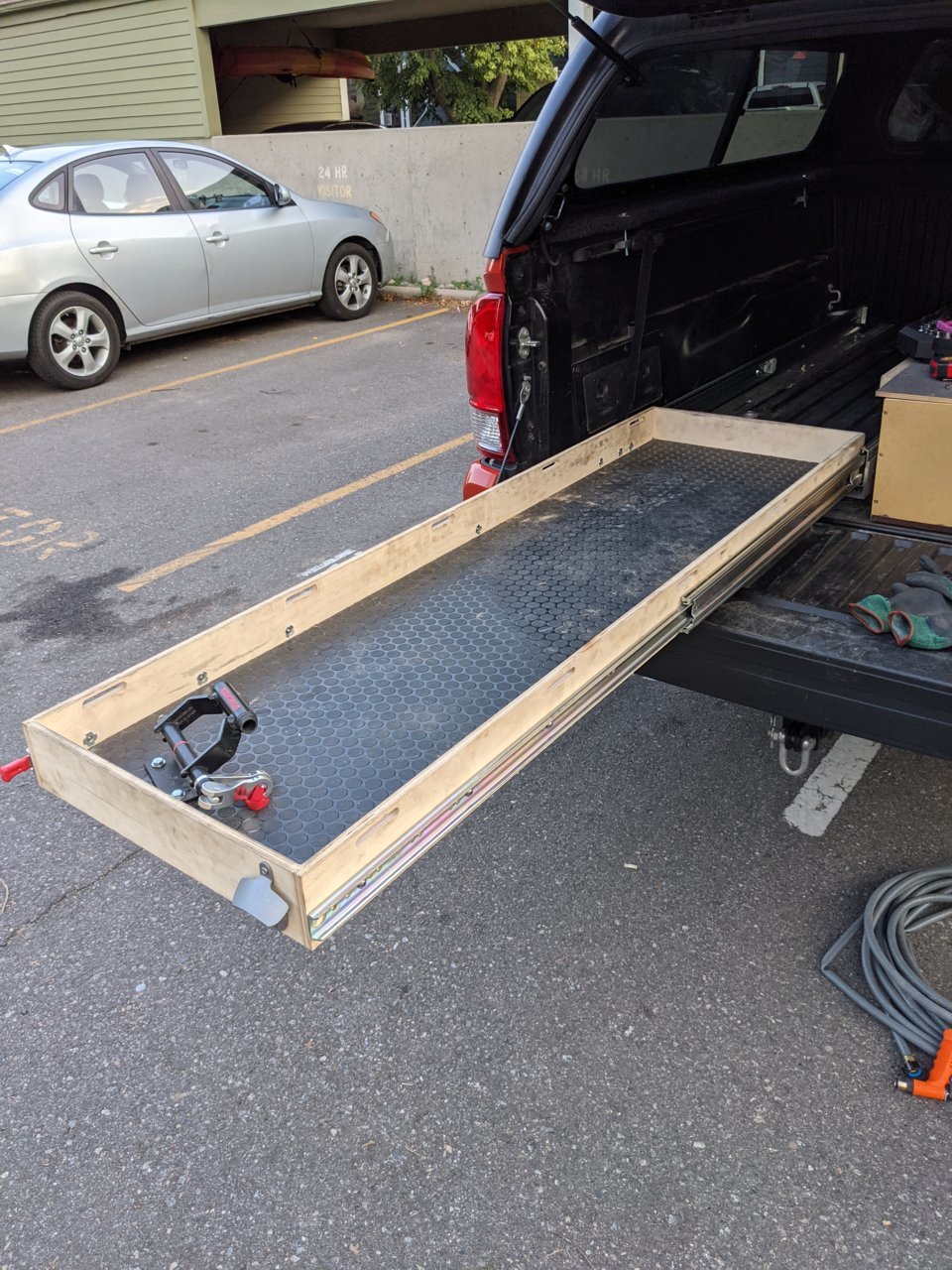

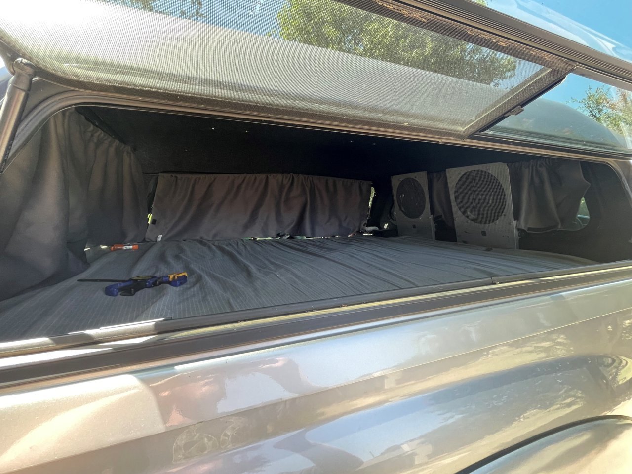

    1.) Memory foam mattress.
    2.) Bed Slideout (Special build, Wife loves stargazing)
    3.) Gear Drawer, 6' drawer, comes out 4.5' on rectangular tubing and skateboard bearings.
    4.) Curtains

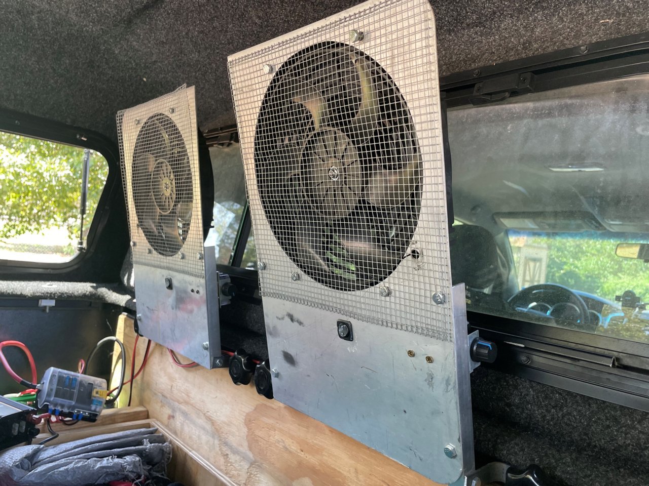

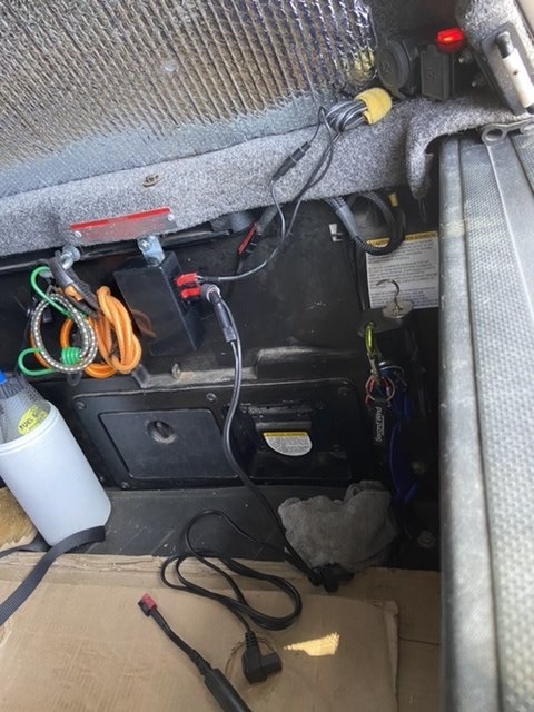

    5.) Deep cycle battery, charges from an Isolator inline with the starter battery and alternator. Fuse box, inverter.
    6.) Cheapo universal radiator fans, because it's Texas, but they'll blow the covers out the back on high.
    Bonus: Quick Grip, until I replace the lift assists...

    if that side window shot is of your mattress height, you ain't got much pushin' room unless she likes side-saddle

    Hence the slide out.

    Lol. This rig was her idea. It is nice being able to sleep comfortably in a 6ft bed though. Tacoma's seem like they're made for short people! I guess Big's and tall's can go get a Tundra. :notsure:

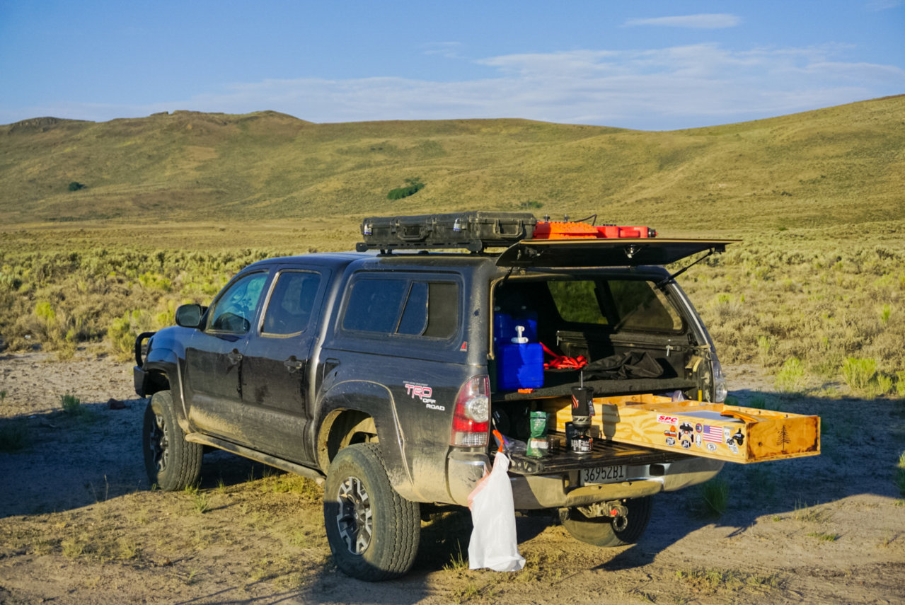

    Lots of rad builds guys!
    I believe I have posted in here earlier about this setup, but I had just made it. A couple months later and I've got a few nights under my belt in this setup now, 27 to be exact. It set me back about $100.00 and it does everything I need it to do. I'm 5'11 and I am able to sleep in the back of my SB diagonally on the platform, did 13 nights in a row with no problems. The drawer was made with the excess pieces of of the platform and slides on pine dowels which fit in the grooves of the bed so it doesn't move around when I'm driving. I've got small shelf hangers on the inside which prop up wooden planks, holding my stove while I cook, giving me a sort of kitchen. I've done hundreds of hard miles on dirt and even had to haul heavy wheels and tires on the platform, nothing has broken. It can be setup or taken down in a minute.
    Most days I wish I had gotten a access cab long bed so I could have more room, but I believe this is the one of the best setups for a DCSB truck camper, it's served me well thus far and utilizes the full space of the 5 ft bed!

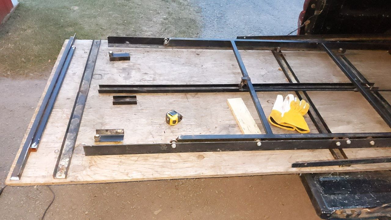

    Picked up this 8' Bed slide off craigslist for $100, In the process of cutting it to 73"x42". I'm using the bedslide in my Chevy as the work bench...
