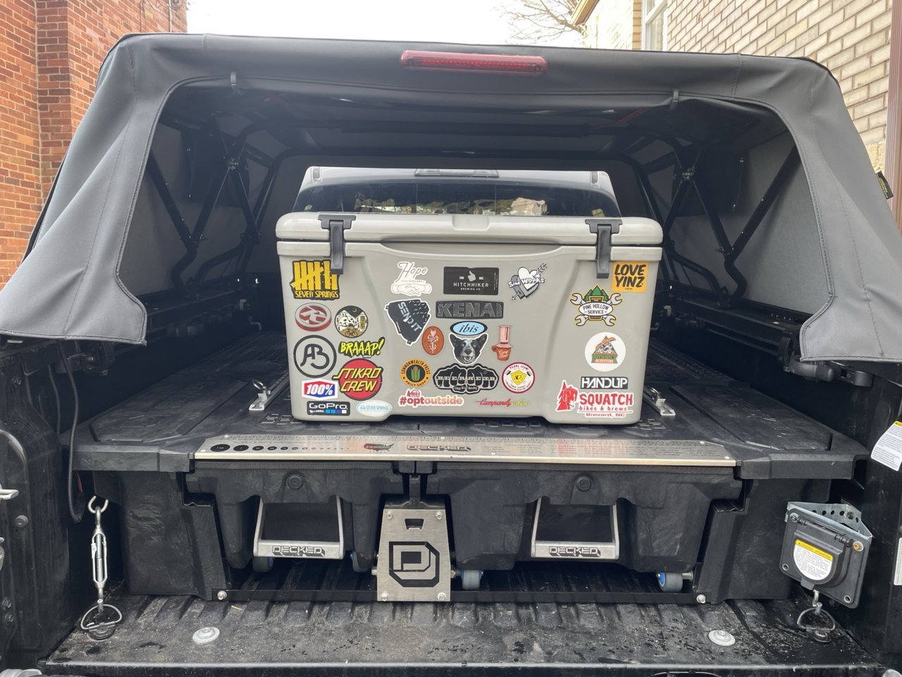

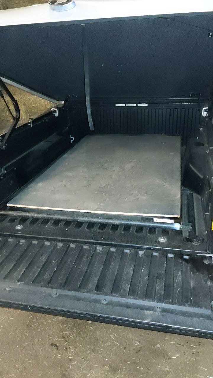

    I just do a platform so i can keep my snowboards somewhat hidden since i just have a soft top but ive also learned i can carry my entire raft set up in the back haha

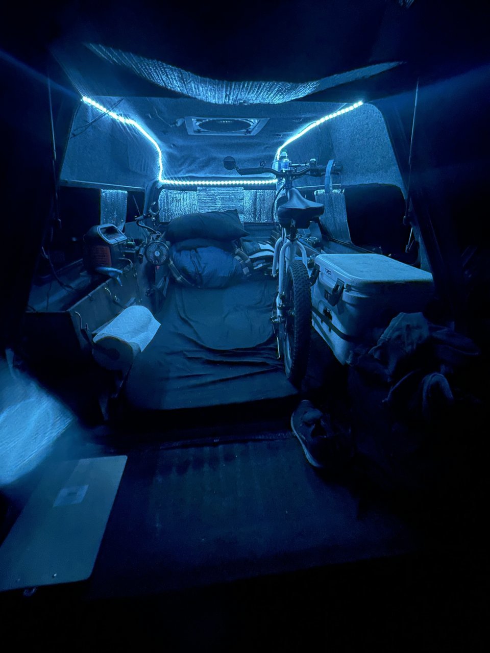

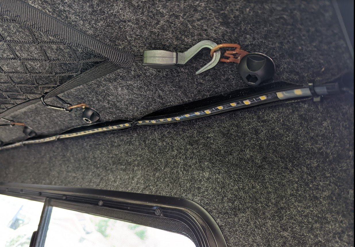

    The velcro held for me but the adhesive that held the strip lights to the velcro did not(Florida Heat). I zip tied the velcro to the strip light every foot or so, no issues since then. you can see it pulling away but the velcro is strong enough to keep everything in place.
    golfindia and 2013XSPX like this.
  19. Apr 22, 2022 at 8:54 AM
    #1019
    2013XSPX
    2013XSPX Well-Known Member
    Nov 29, 2015
    #170975
    2,606
    GA/FL Border
    2013 XSP-X
    Pelfreybilt front/rear, RCI underneath, Morimoto Headlights, Prinsu racks, SCS Brushed Copper Ray 10's, EO Sliders, Baja Designs and Rigid lights, Inca 4x4 Camper
    Mine did the same thing (GA/FL coastal border here). The zip ties worked just great!

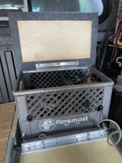

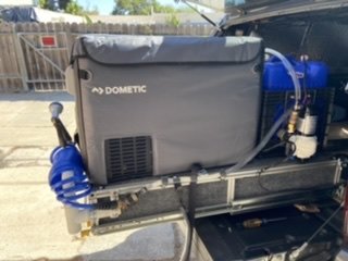

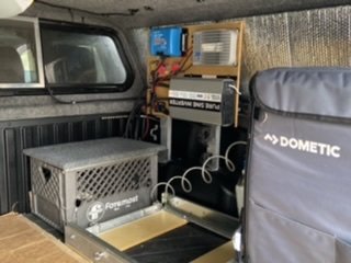

    In January of last year, I ordered a GFC SuperLite. That opened up the bed for a multitude of projects. First, I built a dual slide for my fridge/stove and installed it in place of the full bed platform. At the same time, I built a 7 gal. water supply, powered by a Flojet pump, to provide water for the "kitchen" and other washdown purposes.
    Ultimately, I decided to remove it from the slide and have it more portable.

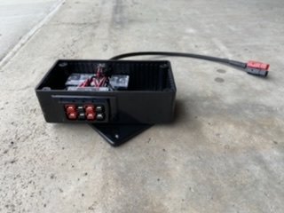

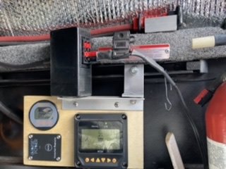

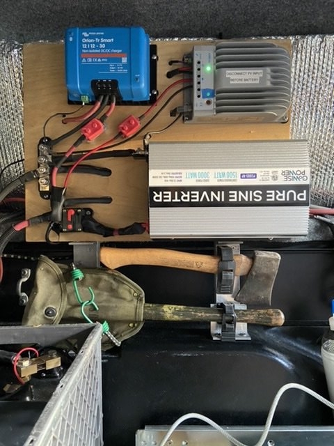

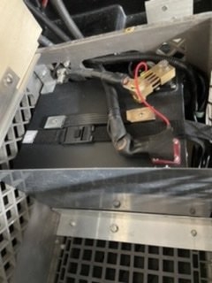

    The next project was to redesign my solar setup and move it to the bed. I added a dedicated 100ah SOK LiFeP04 battery, Victron Dc-to-DC non-isolated charger, and a 1500w inverter.
    This setup powers a box with 4-circuits of Anderson connectors. These circuits are used for the fridge, water pump, power outlet/USB ports for the RTT, and other accessories. Beneath the circuit box is a panel with the remote inverter switch, a solar charge controller monitor, and a battery monitor.
    Above the circuit box on the bed rail is a 2 awg circuit (terminated with an SB-175 Anderson connector). This allows me to run my cradled winch in either the front or rear hitch. It is also a good power source for my air compressor.
    The Blue Seas 6-circuit fuse box in the bed is still connected to the Northstar X2 AGM starter battery.
    My last project that I just completed is a half platform that I integrated with my dual slide.
