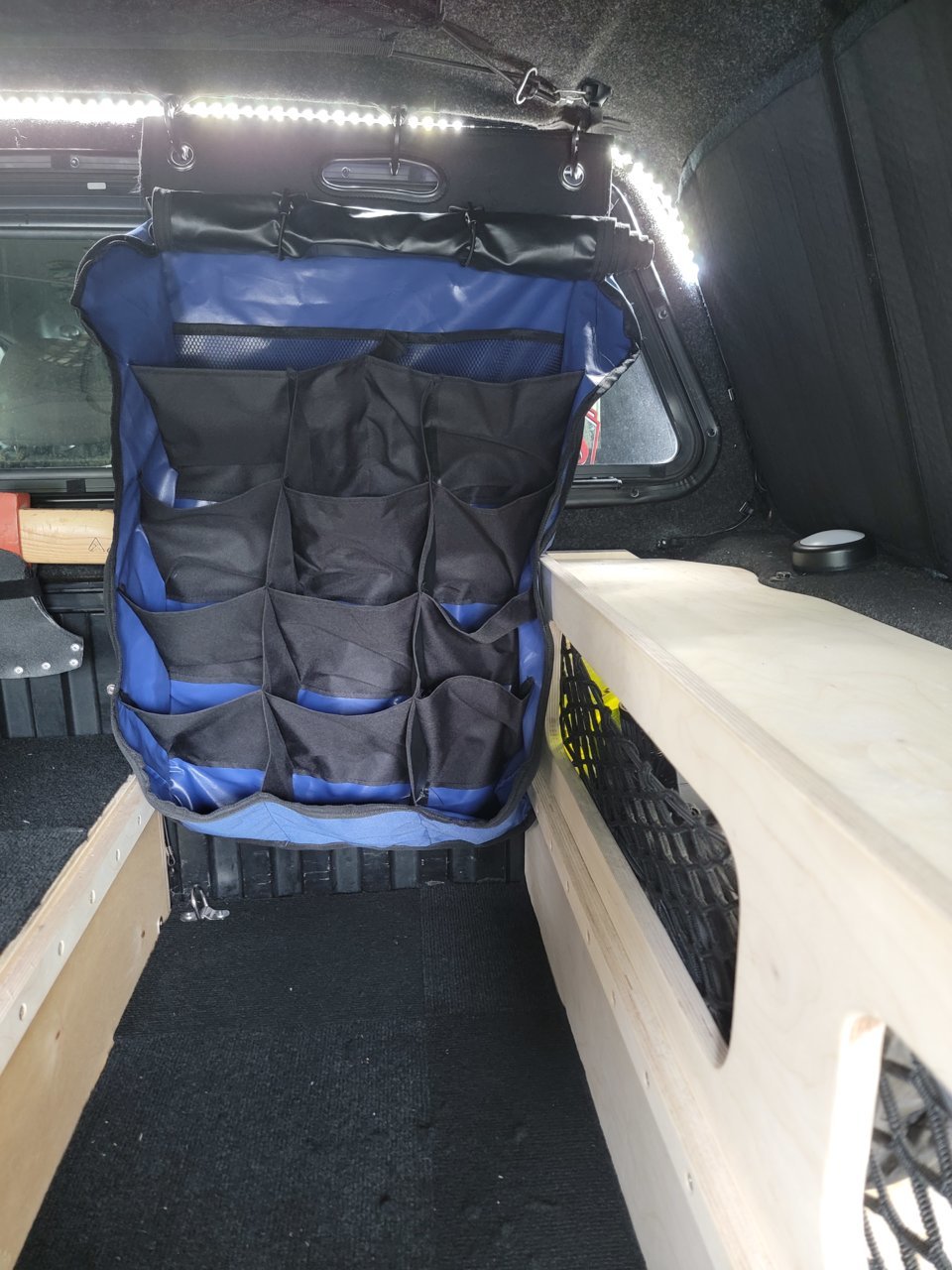

    Came up with another little addition for some extra storage in camp. I won't drive around with it hung up, but once parked it'll come.in handy20230902_102825.jpg 20230902_102647.jpg 20230902_102533.jpg 20230902_102415.jpg

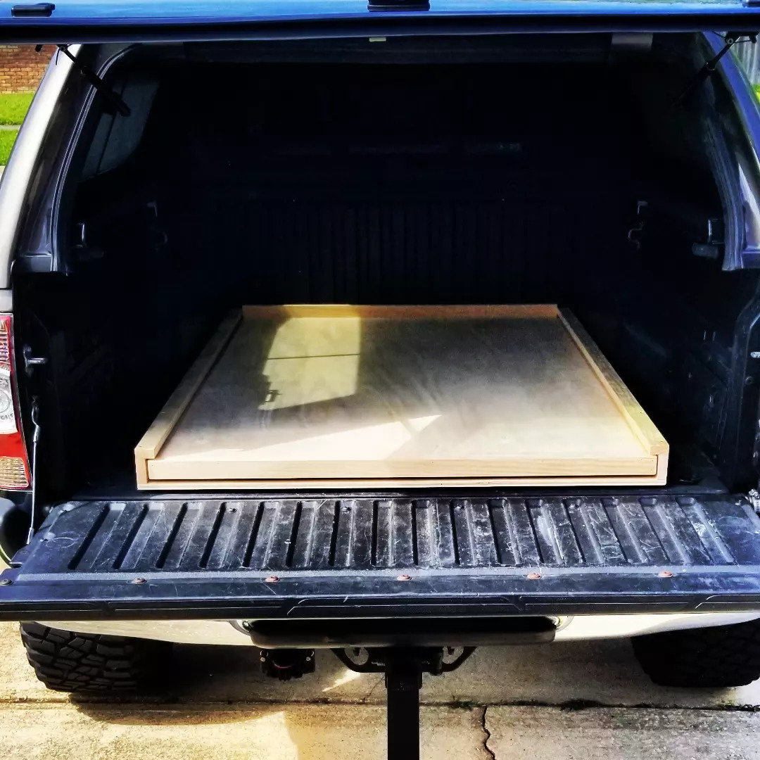

    Mainly tools unless im camping. Built a slide out deck for easy access IMG_20220605_180530_497.jpg IMG_20220423_204441_515.jpg IMG_20220423_204441_557.jpg

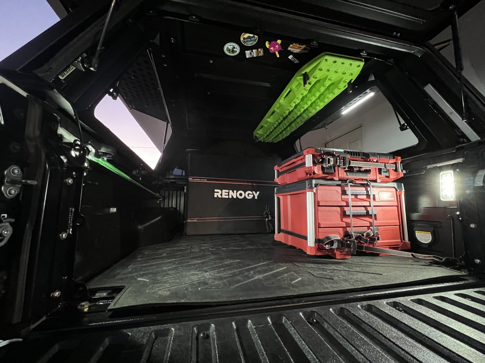

    My latest revision.
    Moved 35” spare from under the bed and placed behind the 200W suite case solar panel. Mounted boards on the inside roof.
    Recovery gear is in the smaller Milwaukee pack out on top and my tools in the larger lower toolbox. This has been holding up surprisingly well for over a year. Air compressor is stashed in the front right corner near spare.
    This is cleaned up and I usually have random stuff floating around back there. It’s always changing though.

    Hard to tell from the angle, so it may not allow, but could you run your ratchet strap through the rails on the right side of the toolbox instead, so you could maintain ability to get into bottom drawer? I'm not familiar with the Milwaukee boxes; are those corner bars metal or plastic? Your setup may be preferred the more I think about it if those corners are plastic.
    Either way, setup looks great man, super functional and lots of usable space left :thumbsup:

    You might be able to run it in the right side but not sure how stable it would hold. I keep the things I need the least in the bottom drawer and that bottom ratchet it pretty quick to loosen if I need to.
    The silver bars are aluminum but everything else is plastic.
    I have more pack-outs that I mount on the driver side as well but rarely use them.

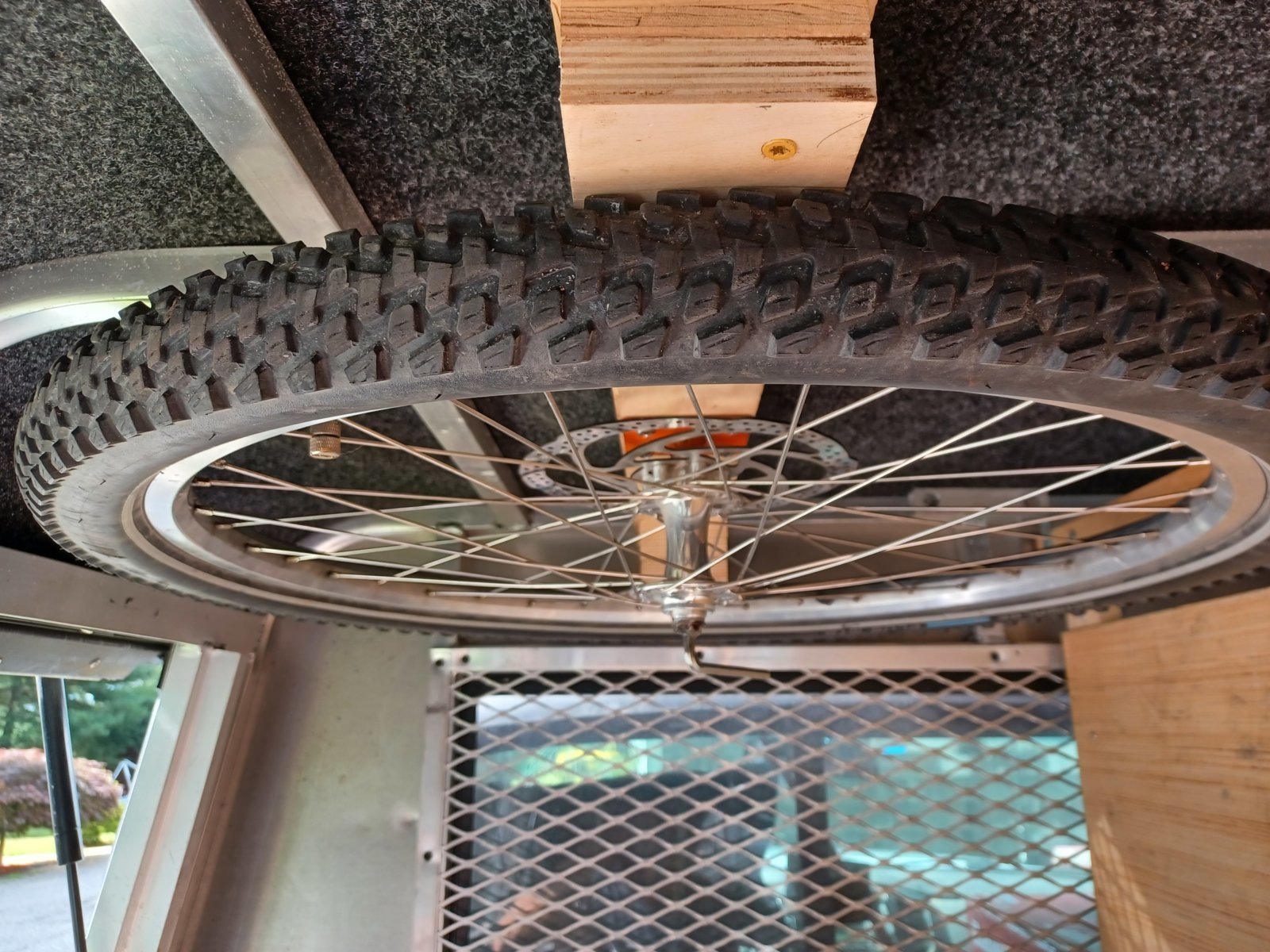

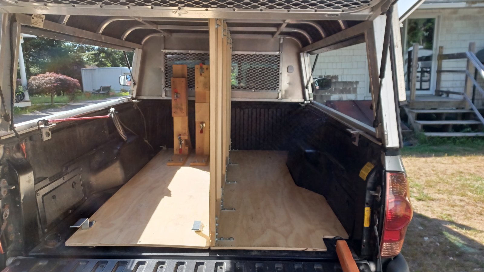

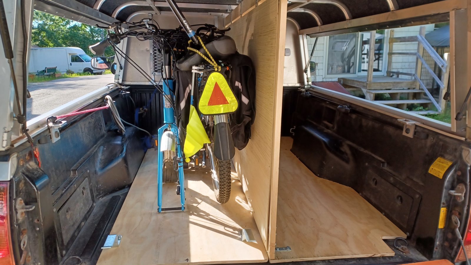

    For major trips: second build: slide-out tandem bike carrier left, gear right; wheel under cap roof.
    Earlier build:

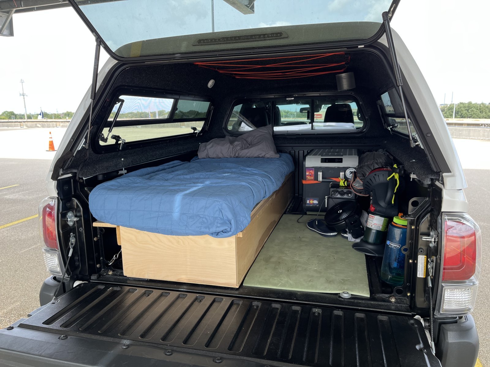

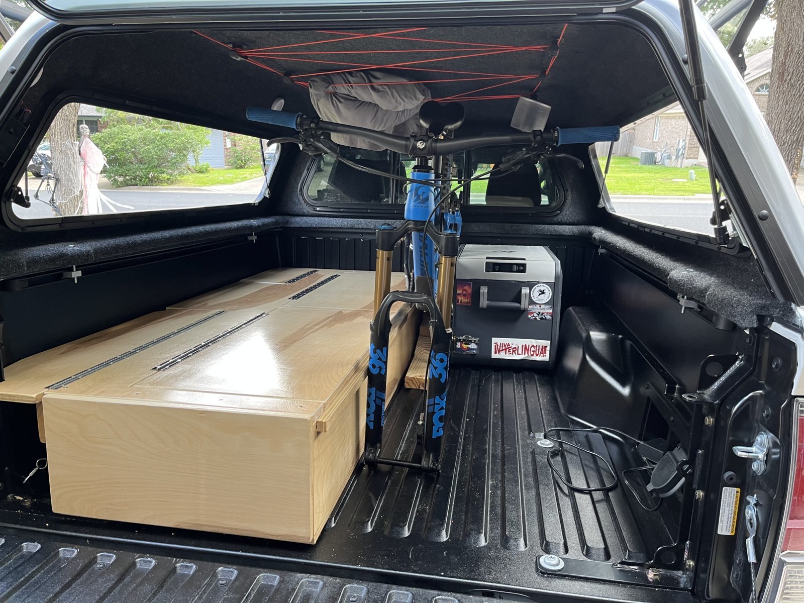

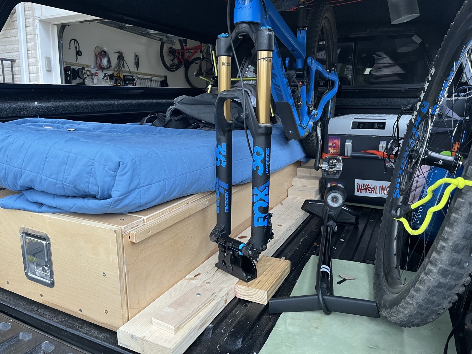

    Bed, fridge, bike, heater, gear…
    2nd pic was taken during a test fit. There’s now a full length slide-out 2x6 between the platform and the fridge with a fork mount to hold the bike. It ramps up at the back to raise the rear wheel so my chainstays and derailleur aren’t rubbing anything. Also, the rear section that ramps up is a snug fit between the fridge and platform so that keeps the whole board from tipping with the bike on it.
    There’s also a paddle latch on the drawer now too. I went against the grain on fridge placement. I like it against the cab so I can climb in and out easier. I can access it from the windoor.
    4AE2AE8A-5880-4186-B8B1-E43F5A906CBA.jpg ED74D2C5-77A0-49A3-8A4B-A425CCB5247F.jpg

    Here’s another couple pics that show the bike rack and the way it helps me clear the fridge with the bike.

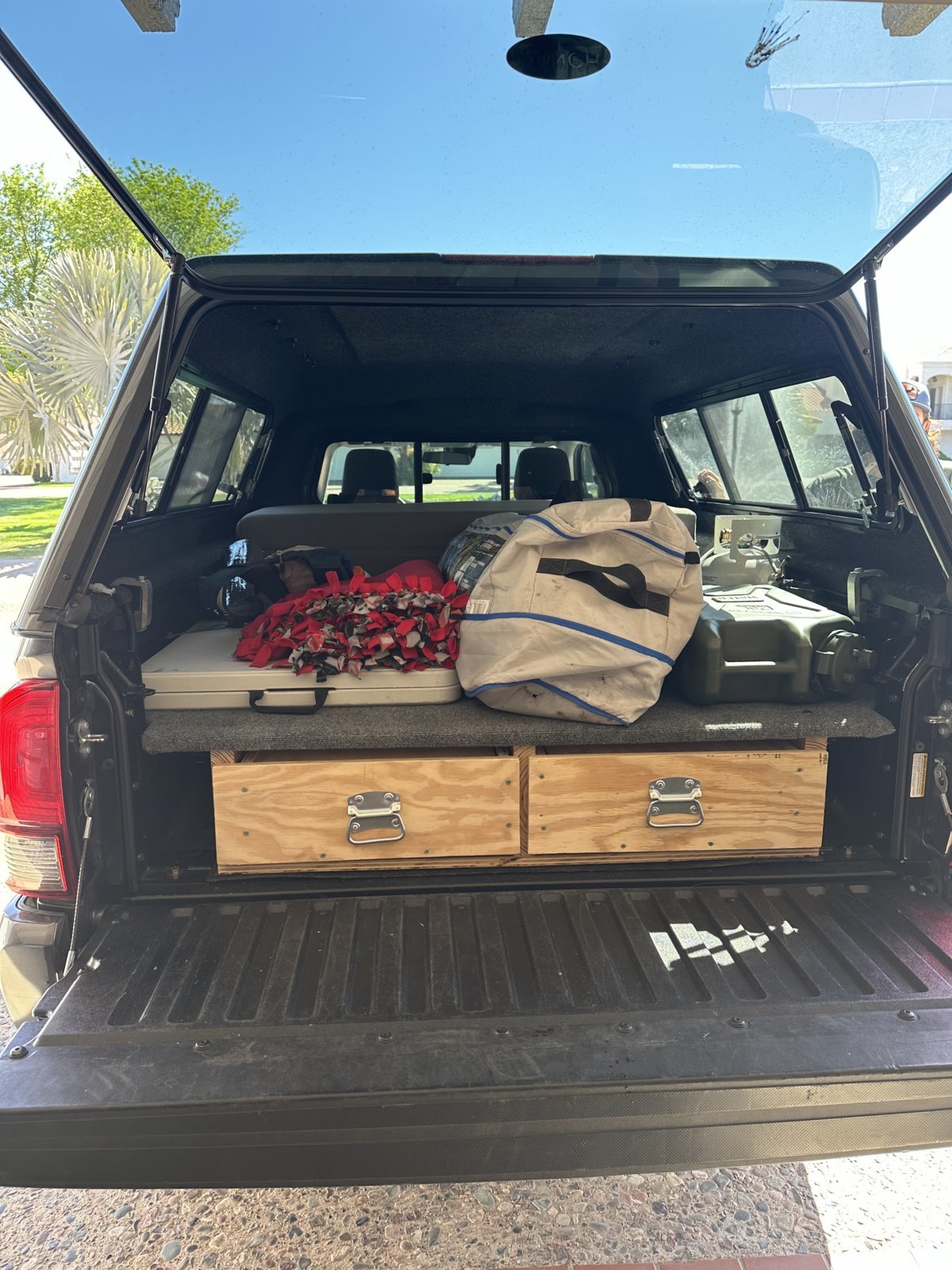

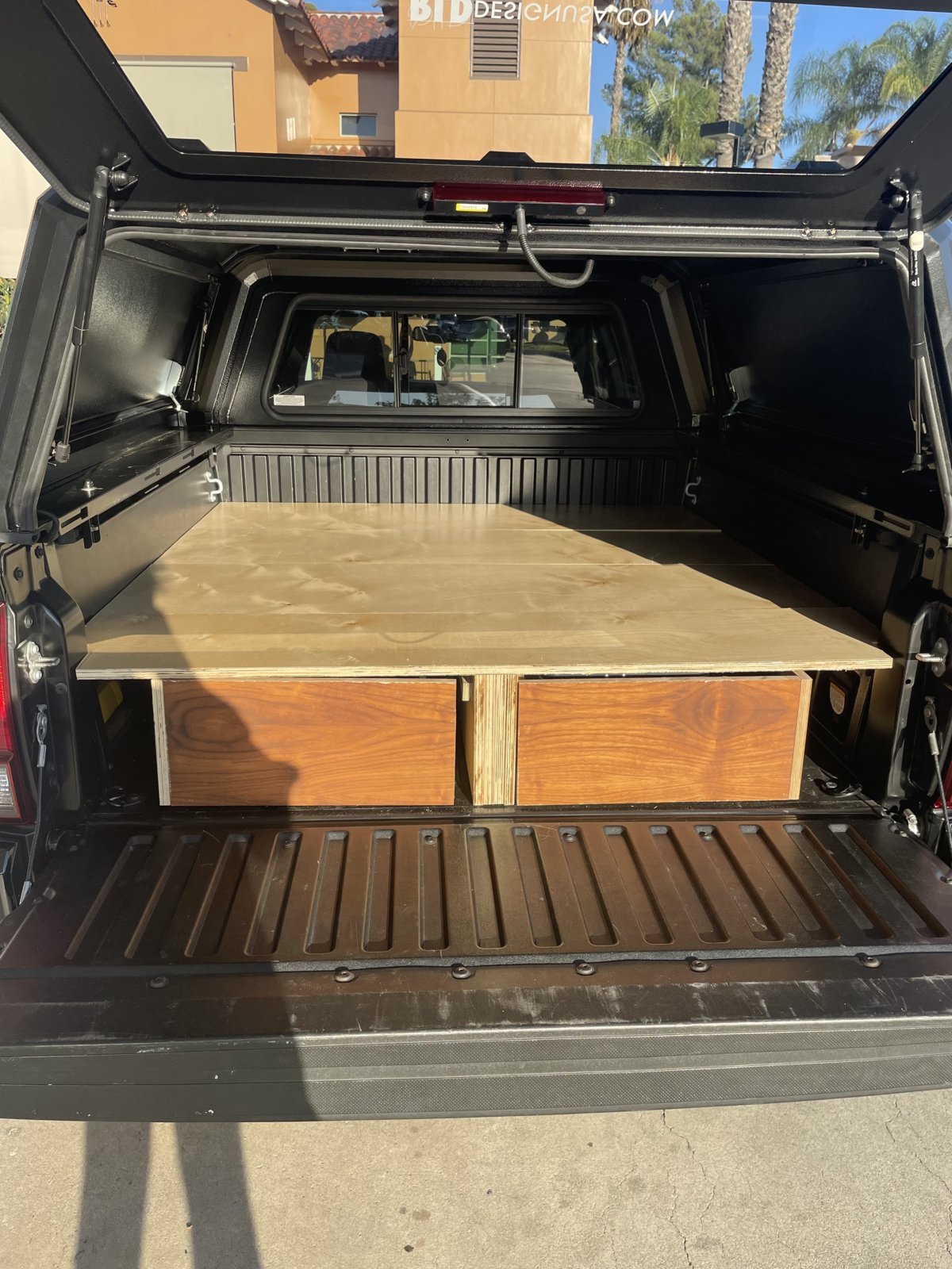

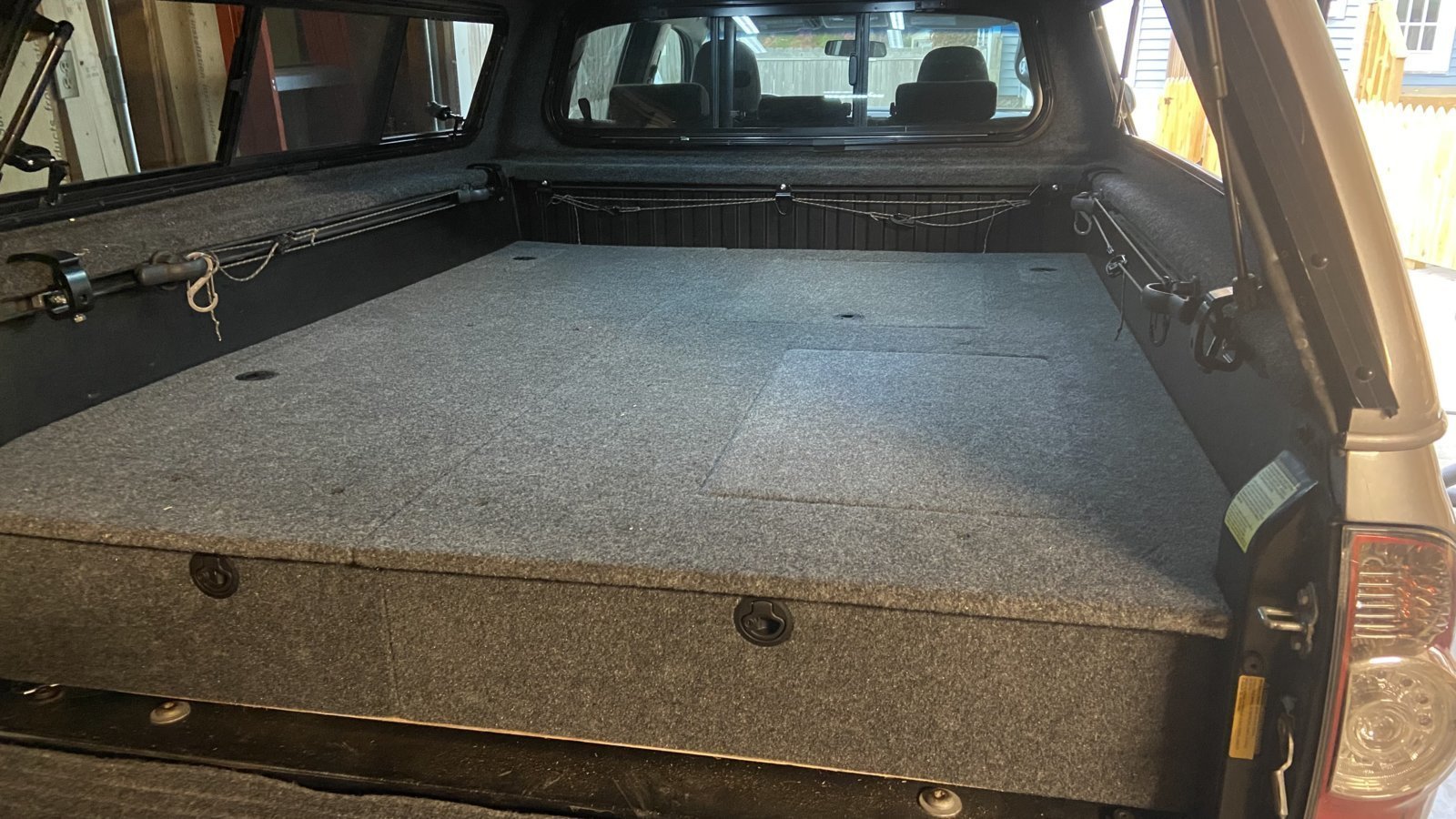

    The stuff on top isn’t there all the time. This was just a camping trip. The drawer system and carpeted platform is always in.

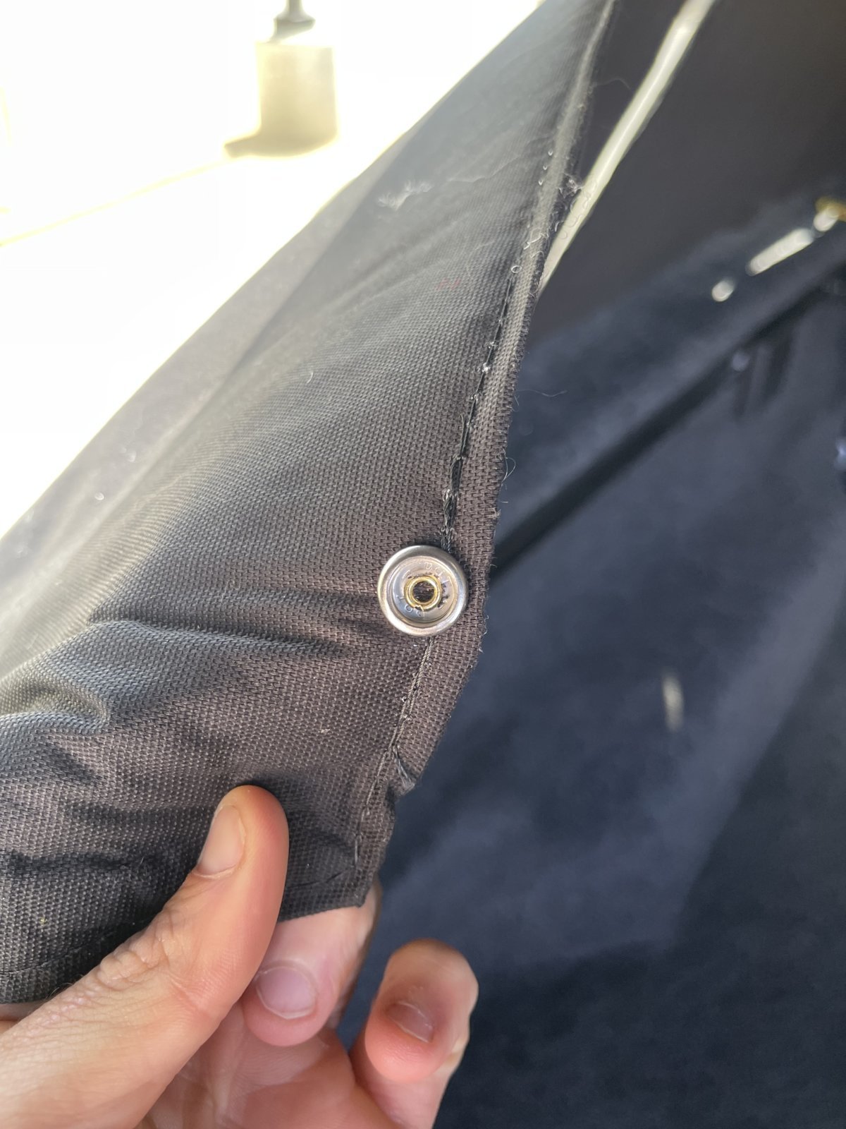

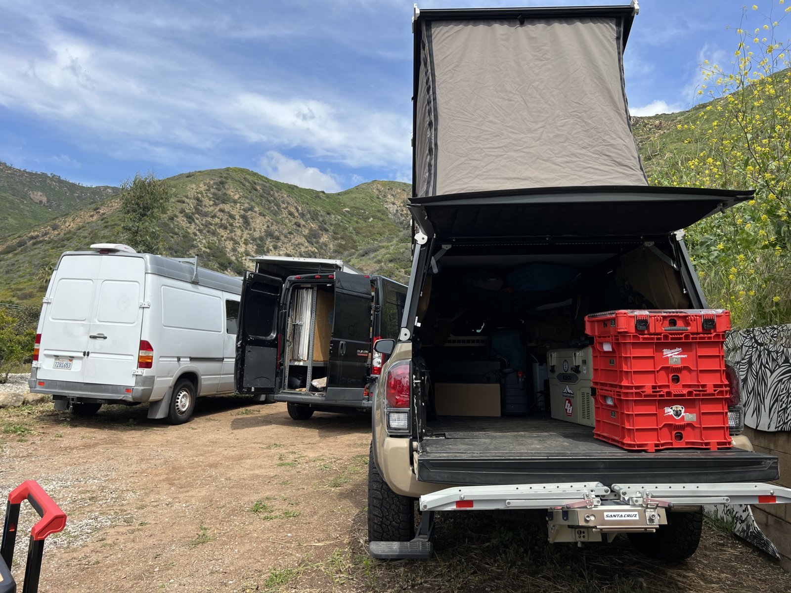

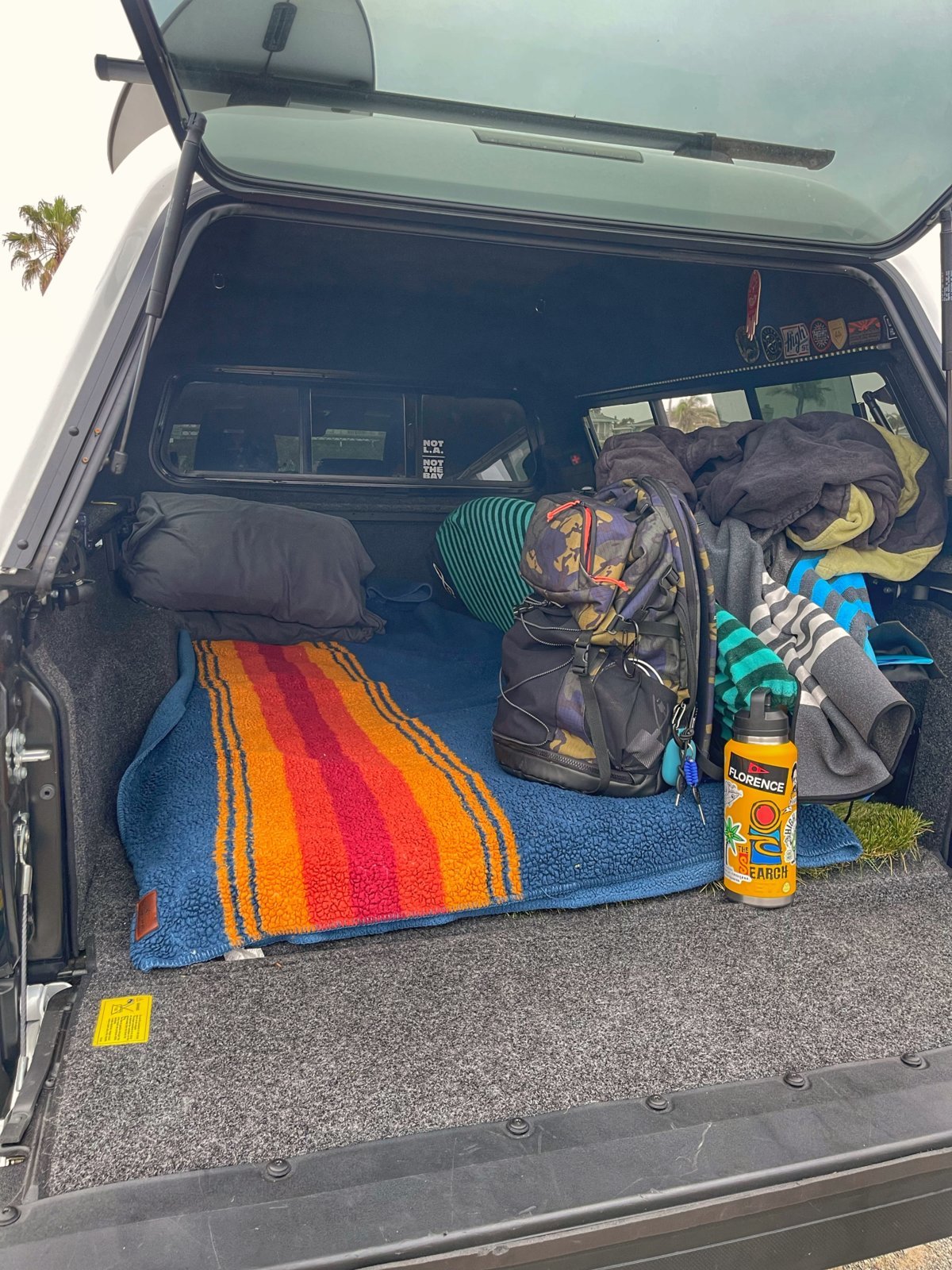

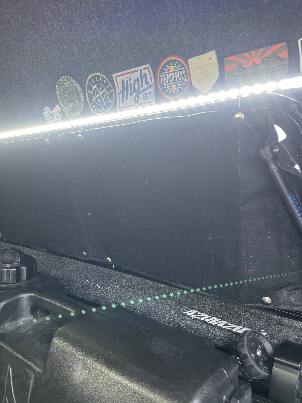

    Finally made “shades” best ones I’ve done so far out of three trucks. Used boat snaps. Drilled into the window frame. Next up I’m going to get a custom box built for the back. Here’s a couple weeks ago on a solo surf trip

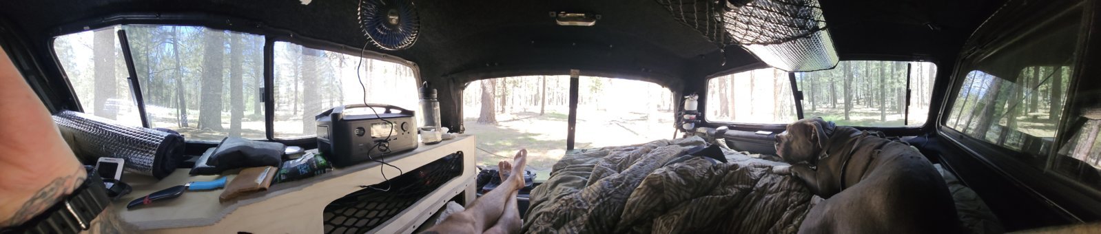

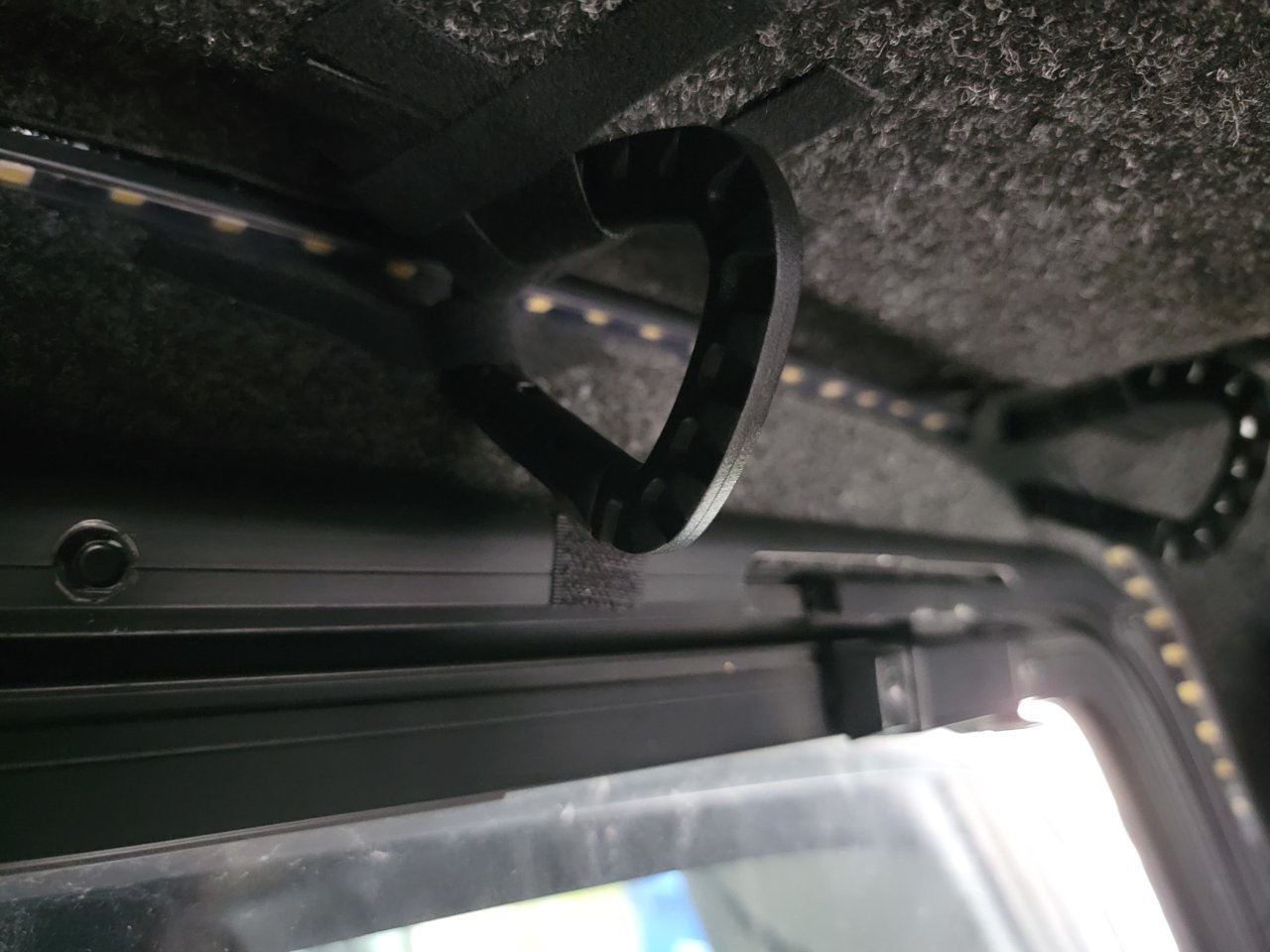

    Is the fan mounted on a bolt from the roof tracks?

    No. I have a cargo net attached to all of the bolts on the roof tracks. The base of the fan is held by the steel braided cables I used to attach the net. Had I planned better I would have used longer bolts for the tracks so that I had some threads on the inside. Screenshot_20240622_085114_Gallery.jpg
