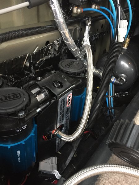

    @fatfurious2
    I don't remember which thread you tagged me in before about not running a leader hose.
    But, I just used my compressor for a prolonged period for the first time. That braided leader hose gets pretty hot. I wouldn't trust a plastic fitting there.
    Side note. I really like having OBA
  15. Jan 14, 2017 at 10:48 AM
    #75
    fatfurious2
    fatfurious2 [OP] IG: great_white_taco
    Jun 28, 2014
    #132884
    49,887
    David
    Ashburn, VA
    2010 TRD OR Access Cab
    I am going to redo my leader hose. Right now, I have the braided 18" going to a Tee with the ARB quick connect. The problem is, that I ran it towards the middle of the engine bay on the firewall side. So its hard to reach it.
    I just bought a hybrid 3 foot leader hose, so I can run it under the airbox and washer fluid, and put the quick connect behind the passenger headlight. From there, I will run the 3/8" air line to the back of the truck, into a bed cubby like you have, and to another quick connect.
    When you disconnect the hose from the engine bay quick connect, is there a lot of air pressure? mine shoots out from the quick connect. More than a "normal" amount. Maybe I need to add some sort of safety valve?

    There's 150 PSI. That's the cut off for the compressor. So yes, it's normal. Mine does the same. I wouldn't screw with a relief valve.

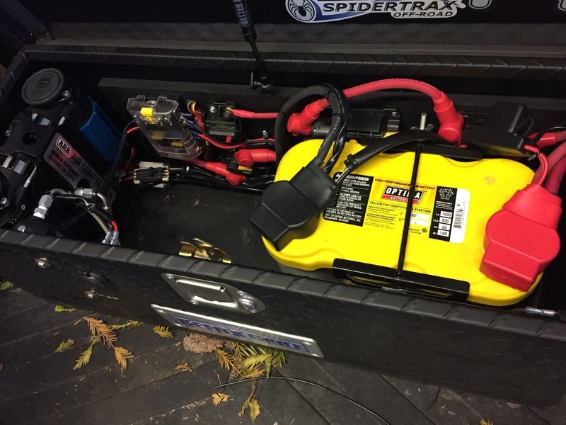

    I plan on putting mine in a similar location. What size gauge wire did you use to extend the harness?
  19. Feb 26, 2017 at 5:00 PM
    #79
    mrbedgood
    mrbedgood Isaiah 6:8
    Oct 16, 2013
    #114599
    3,420
    North Carolina
    '11 MGM DCSB TRD Off Road 4x4
    Total Chaos +2" Long Travel Kit; King/TC 2.5 LT C/O w/ 16"x600; TC/CVJ Extended Axles; TC Spindle Gussets; King 2.5 RR shocks; All-Pro Expendition Leaf Pack; Pelfreybilt Sliders; Anti-Dark LED Hood Light mod; LED map and dome light mod; Bed lights; TRD Cold Air Intake; KB Voodoo Tailgate cap system; HomerTaco Thin Lip "Raptor" grille; sPod SE System w/ LCD Touchscreen; Baja Design OnX6 40"; Baja Design S2; Rigid Industries LED Rock Lights; Front Runner Slimline II Roof Rack; A.R.E. Z Series Camper Shell Projector BHLM Headlights (with custom wiring); Method Racing NVs 17"x 8.5; and Nitto Terra Grappers 265/60/17
    6, 8, 16, and 18 gauge
