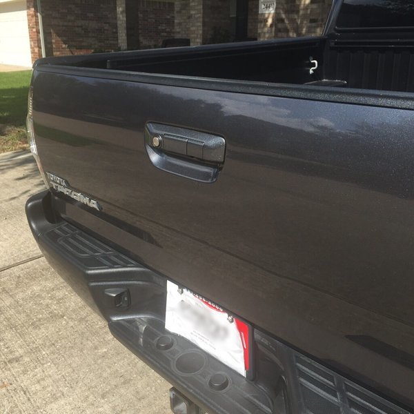

    Maybe I did.

    Over time the gap between the tailgate and the bedsides starts to get wider, especially if you have a shell on it. The reinforcements help prevent it.

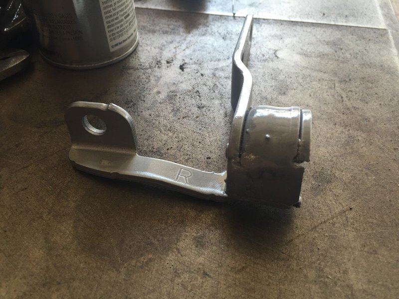

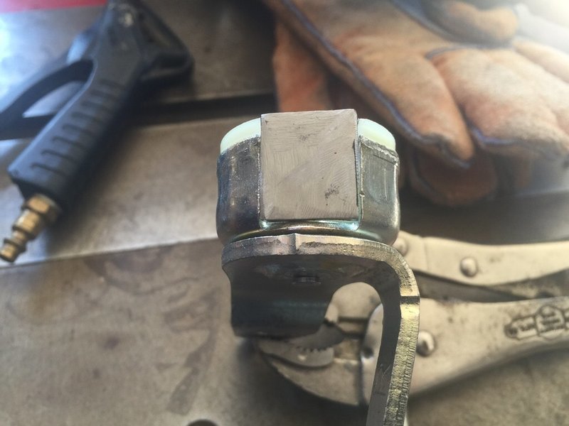

    The little 90 amp harbor freight welder comes in handy for little stuff like that. :thumbsup:

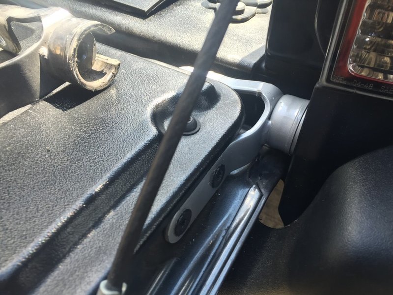

    This. Also they give a couple of extra tie down options.

    There is an incompatibility issue if you have the KBVoodoo bedrail caps. They bed rail caps use the same bolt as the top of the Total Chaos bed reinforcements. But I'm sure a little grinding could fix that. I don't have the rails but I'm thinking about getting a set.
