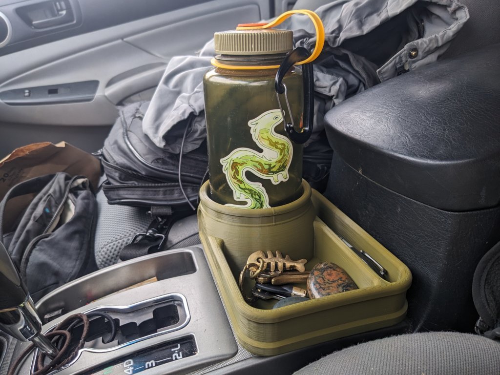

    Just finished designing a solution for the tiny cupholder and wasted space of the center console on the 2nd Gen Tacoma!
    I often complained about the lack of places to put things like pens and keys, or large drinking containers like a Nalgene, Yeti, Stanley, etc. The stock center console is just a bad design!
    After a few months of development and testing, I honed in on this design. It is held in place with four 1"x1" squares of 3M SJ3560 heavy duty hook-and-loop ( https://www.amazon.com/dp/B00AQ6IS1G ), which is plenty strong for the high heat in vehicle interiors.
    This has been a gamechanger for day to day use of the truck, and feels like a natural part of the interior. A large bottle like a Nalgene can sit in the cupholder and doesn't interfere with the gear shifter or opening the center console compartment.
    If you have a 3d printer, I have the file available for download here: https://cults3d.com/en/3d-model/gad...lder-tray-for-2nd-gen-2005-2015-toyota-tacome
    If not, I have a few of the prototypes that I would be willing to sell, and I would be willing to print these for order if there is interest. Also, let me know if you would like to see a version with a smaller cupholder because that would be fairly easy to develop. Cheers!

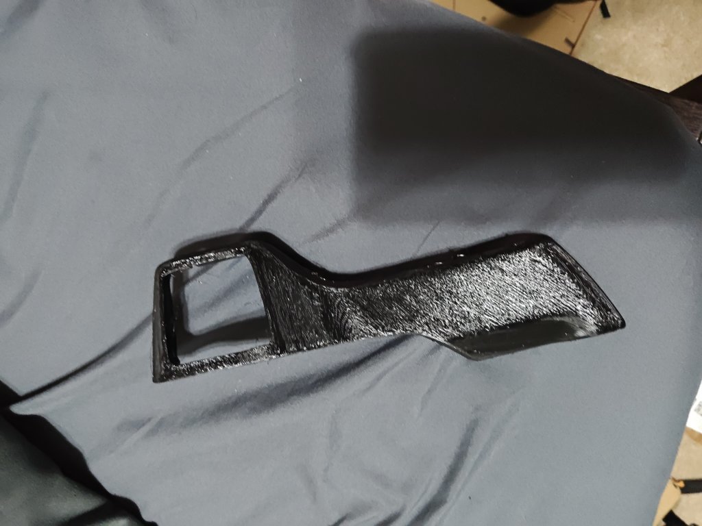

    I know some other companies have made plastic steer wheel cover overlays but I got bored and printed out a prototype for the 2nd gens. Almost fits correctly some minor tweaks but just less than 60g for 50% infill with supports.

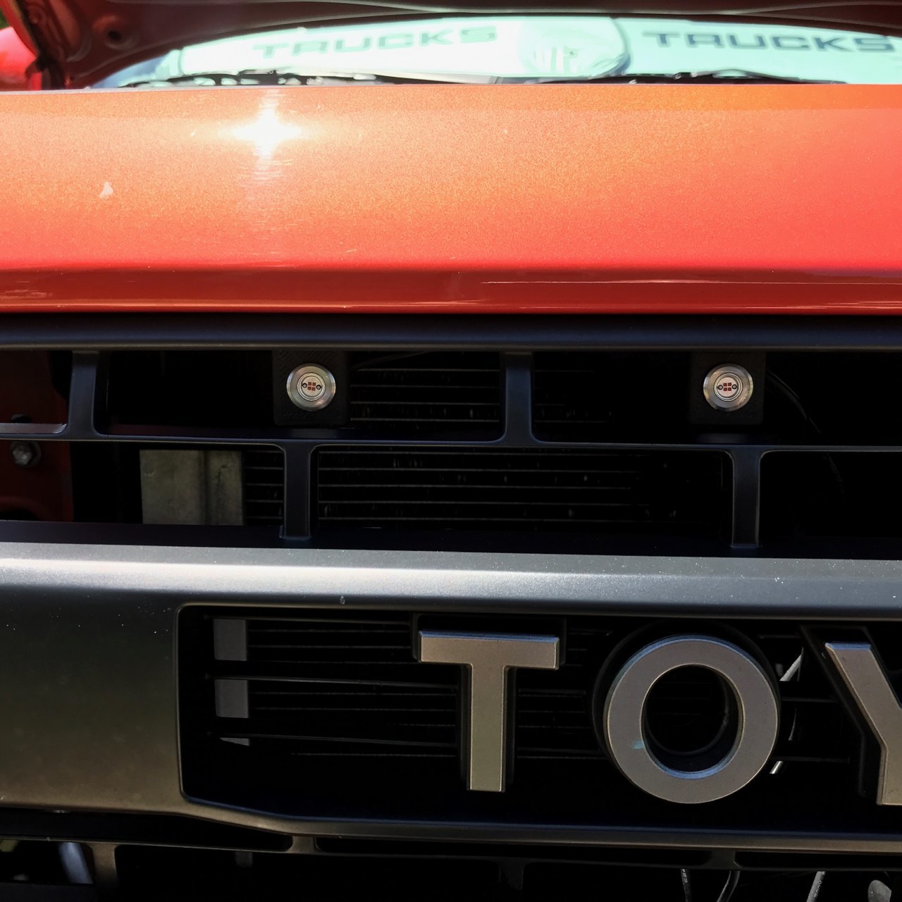

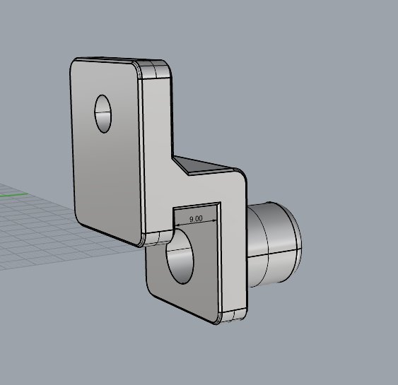

    For anyone who has a NOCO trickle charger like myself, I wanted to be able to easily plug-n-play as they say, so I worked up this bracket for the grill. Now I can simply unplug and go, vs. having to fish wires in and out every time. Printed using ASA, so I'm hoping it will survive the heat.

    Just need to sand and paint it, but looks a lot better than the prototype I did P_20250416_091400.jpg

    Very cool, I like this!

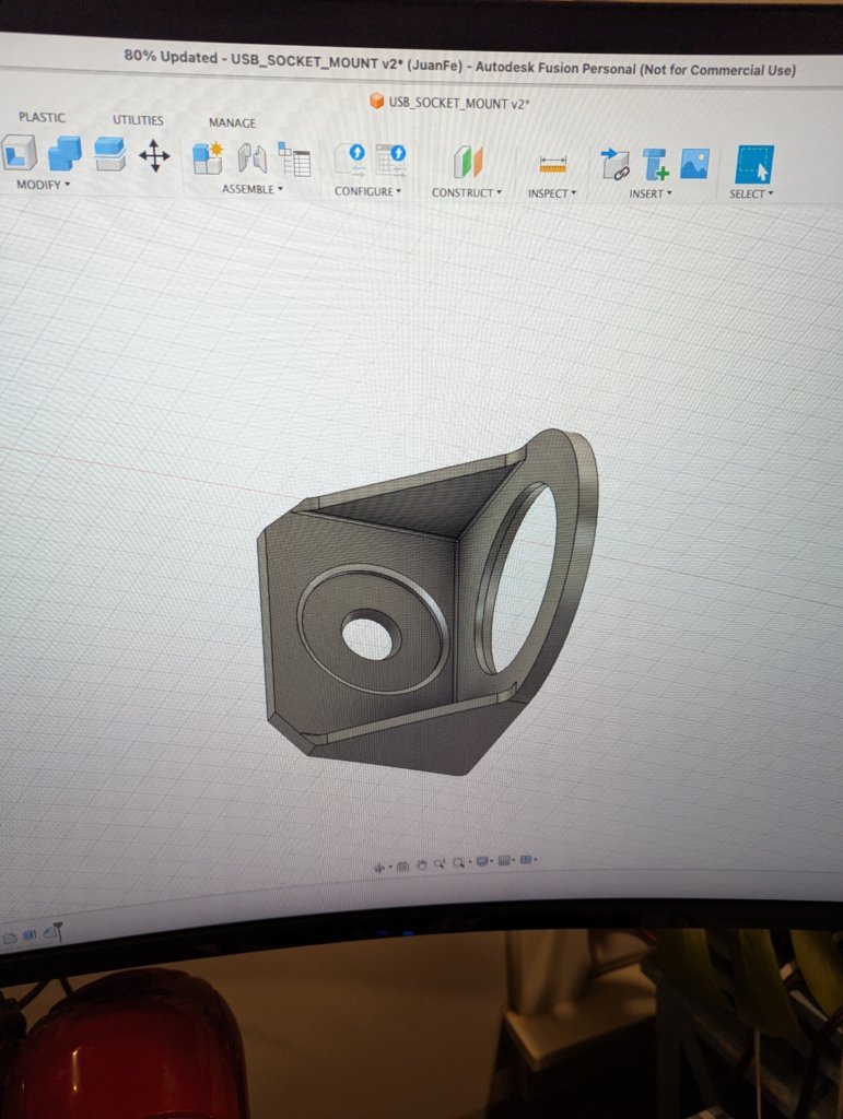

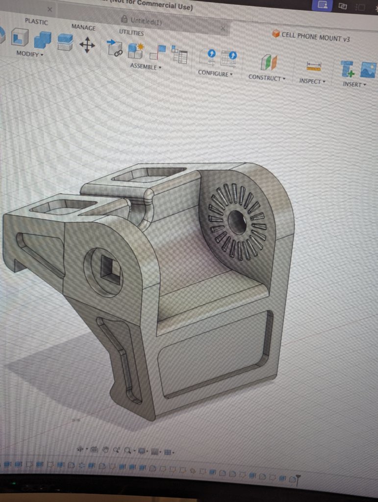

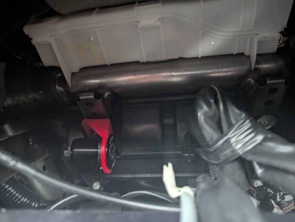

    I have printed 2 items with plans for future prints...
    1. Hidden USB socket bracket behind radio
    2. Phone mount

    What material?
  20. Aug 27, 2025 at 9:03 AM
    #820
    Tacoffee
    Tacoffee New Member
    Aug 27, 2025
    #476399
    2
    2017 Tacoma TRD Sport 4x4
    PETG at this moment. It's been a week or so, I will continue monitoring and if it fails will attempt PETG+CF or maybe ABS...
    I have a Bambu A1 in my shed. I might be able to play with my set and maybe upgrade nozzle and put an extraction fan if and when printing ABS. Hopefully PETG is enough.
