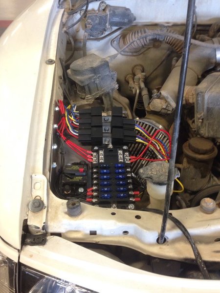

    Not bad for a first attempt, I need to do some more wire management though

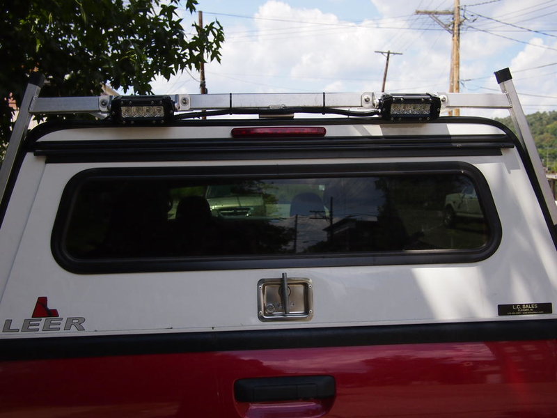

    Got some back up lights installed! 2 - 4" Heretic spot pattern bars.

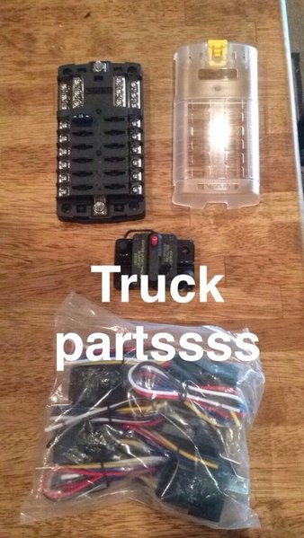

    Got my stuff today, blue sea 5026, bussman 100a and 5 new relays, gonna get a sheet of steel I'll work to get it all going. Post pics up as I go
    Only pic I took was snapchat lol

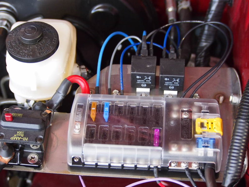

    Not finished yet

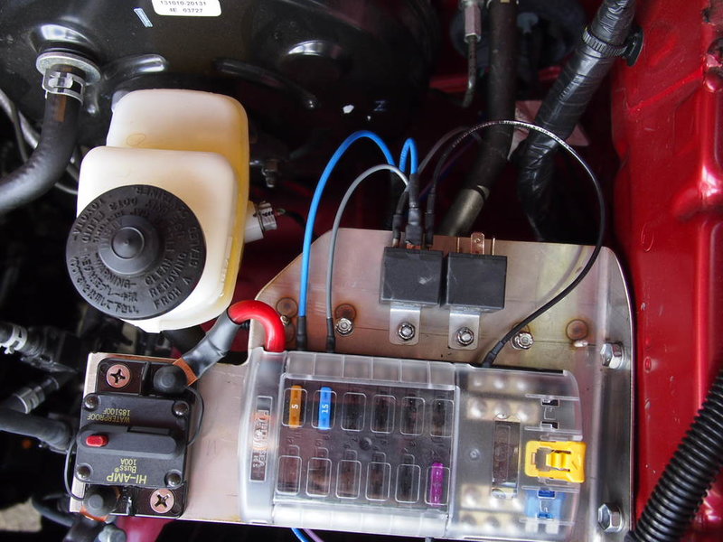

    Did a little more wiring on mine, added a 10" light bar behind the grille and wired it up to my second relay. It's a challenge to think ahead how you want to run the wires. I'm trying to keep them as neat and uniform as possible.
