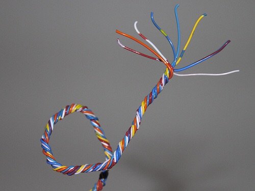

  4. Aug 8, 2016 at 11:54 AM
    #264
    Whitecloud
    Whitecloud Cloudy-fabricator of things
    Feb 24, 2010
    #32031
    4,424
    Johnathan
    Albuquerque, New Mexico
    Superwhite 06 DCLB
    ICON Extended travel Coilovers, Custom leaf pack, custom sliders and F&R bumpers, 295 75 17 Toyo Open Country MT's, On-Board air with F+R connectors, On-Board water with quick disconnect shower.Trimmed fenders and body mount chop. LOTS of wiring, dual battery setup, Solar charging system, with some random lights spread around here and there.
    That is what I used for my build. Here are some from that. So very painful........

  7. Aug 8, 2016 at 1:13 PM
    #267
    abarber11
    abarber11 Well-Known Member
    Jul 16, 2012
    #82790
    421
    ATX
    2011 DCSB
    That's a lot of twisting, and it sure is be-a-u-t-iful

  10. Aug 9, 2016 at 7:53 AM
    #270
    Sandman614
    Oct 26, 2010
    #45273
    36,034
    Tim
    Garner, NC/Boone, NC
    '06 SR5 Off Road
    Soo much twisting extends the wires sooooooo much.
  11. Aug 9, 2016 at 8:00 AM
    #271
    Whitecloud
    Feb 24, 2010
    #32031
    4,424
    Johnathan
    Superwhite 06 DCLB
    It does but if planned right, it takes up less space, the wires are all used, and it is super flexible.

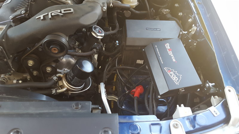

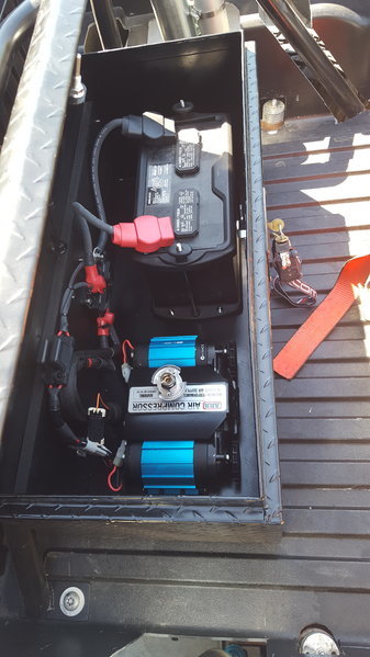

  12. Aug 9, 2016 at 8:04 AM
    #272
    VolcomTacoma
    VolcomTacoma Well-Known Member
    May 25, 2011
    #57205
    20,617
    Jeff
    NorCal
    2015 TRD Sport 4x4 6 Speed Supercharged
    Front- Camburg 4x4 Long Travel 2.5" King Coilovers 2.5" King Triple Bypasses Wheelers Superbumps Rear- DMZ SUA 16" 3.0 King Triple Bypasses 3" 2.0 Fox bumps Wheels and Tires- 295/75/16 Toyo ATII XTREME SCS SR8 Dark Matte Bronze 16" Lighting- (2) 30" Combo light bars (4) Iggycorp diffused pods Tepui Ayer TRD Supercharger URD Mark III 3" Exhaust URD 4x4 Y Pipe URD CAI URD 2.85 Stealth Pulley Hurst Core Shifter with Hurst T URD Stage 3 clutch URD Lightweight flywheel URD Throw out bearing upgrade AEM Wideband AFR Gauge Speedhut Boost Gauge Craven Speed Flex Pod mount Weathertech Floor Liners BAMF Sliders Ultragauge sPod SE ARB CKMTA12 Hella Supertone horns Relentless Tailgate Reinforcement
    Heres mine! Does this count??
    tmp_8319-20160714_105803-1355213438.jpg tmp_8319-20160714_105710-763443524.jpg tmp_8319-20160714_105854540867698.jpg
  13. Aug 9, 2016 at 2:27 PM
    #273
    robssol
    robssol If it ain't broke, leave it the eff alone!
    Jun 4, 2013
    #105622
    7,681
    Rob
    S. Wisconsin
    06 Tacoma, TRD Sport, SR5, 4X4, AC
    Totaled but still alive! Frame 2.0, Fog lights anytime, Seatbelt reminder delete, Secondary air filter delete, LED bed lights, Running boards, 2017 Rims, Ultra gauge, Cup holder/consol/glove compartment lights, Interior LED conversion, Blue Sea aux. fuse panel, fuse panel mounting plate by Yotamac, ProEFX heated towing mirrors, LED engine bay lights, Redline Quicklift Elite hood struts, Wet Okole Heated Seat Covers,m, Rear bumper 2.0, Decal free visors, Washable cabin air filter, Overhead consol auto dimming override switch, BulletProof Fabricating Skid plate, 2lo module.
    How does that location for the battery work? On voltage drops or slow cranking?
  14. Aug 9, 2016 at 3:35 PM
    #274
    VolcomTacoma
    May 25, 2011
    #57205
    20,617
    Jeff
    NorCal
    It takes an extra half second or so to crank up on cold mornings, thats about it, haven't seen any voltage drops or anything. Still on the stock battery, probably gonna move up to a better battery soon

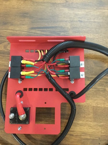

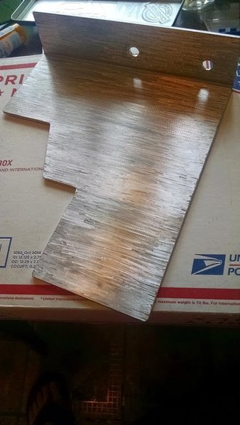

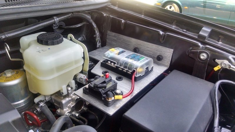

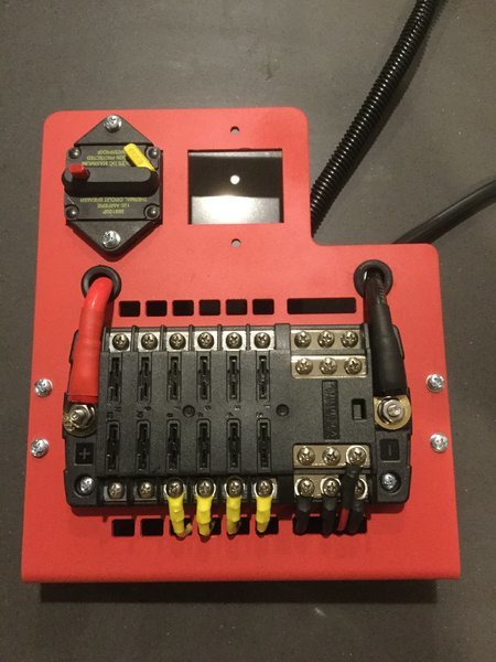

  16. Oct 31, 2016 at 12:07 PM
    #276
    Kieran
    Kieran Friendly Neighbourhood Canadian
    Jan 4, 2015
    #145592
    100
    Toronto
    09 Access Cab V6 TRD OffRoad
    None yet.
    I have been planning on adding an additional fuse block to power some additional accessories. I finally have all the bits and designed the mounting plates. Below is the design I am going to get routed out of aluminum and the basic wiring diagram to help me plan things out.
    I have everything but the Stryker SR-89MC but that is a future install at this point. The cap has a pre installed LED light that I wired off of an inline fuse holder currently. At the same time I ran another wire to add a 12v outlet back there. I will build those into a waterproof box that I will mount in one the cubbies in the bed so they are out of the way. There will be 2 additional 5v USB regulators installed in the cabin. One by the headliner for my Bluetooth hands free thing and one to the left of the steering wheel to charge my phone in the A pillar RAM mount. Any additional low current chargers can be powered off this circuit. I will also parallel a female 3.5mm with the Aux input beside the shifter. This will allow me to use 6" USB to lightening and 6" 3.5mm (1/8th") male to 3.5mm (1/8th") male cable to connect my phone to the stereo and charge it.
    I work in TV and do a lot of wiring and installing of gear. So the plan is to keep it a clean and simple wiring install. I know first hand from work the key to troubleshooting if you need is having your interconnects clean and well laid out.
    [​IMG] [​IMG] [​IMG]
  17. Oct 31, 2016 at 1:27 PM
    #277
    robssol
    Jun 4, 2013
    #105622
    7,681
    Rob
    S. Wisconsin
    You'll need to ground the coil on your relays. Also member Yotamac makes fuse panel mounting plates (vendor). Probably easier than making your own:thumbsup:
    Stryker420 likes this.
  18. Oct 31, 2016 at 2:39 PM
    #278
    Kieran
    Jan 4, 2015
    #145592
    100
    Toronto
    None yet.
    I googled around to try and find the panel location I want. I want to put the breaker by the existing fuse panel and the fuse box on the other side of the engine. There is an open space in my 6 speed between the fender and the air intake.
    I totally forgot to put that negative terminal in. Thanks! I was going to more the overall wiring and fuse/relay assignments etc.
