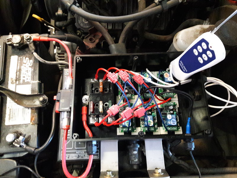

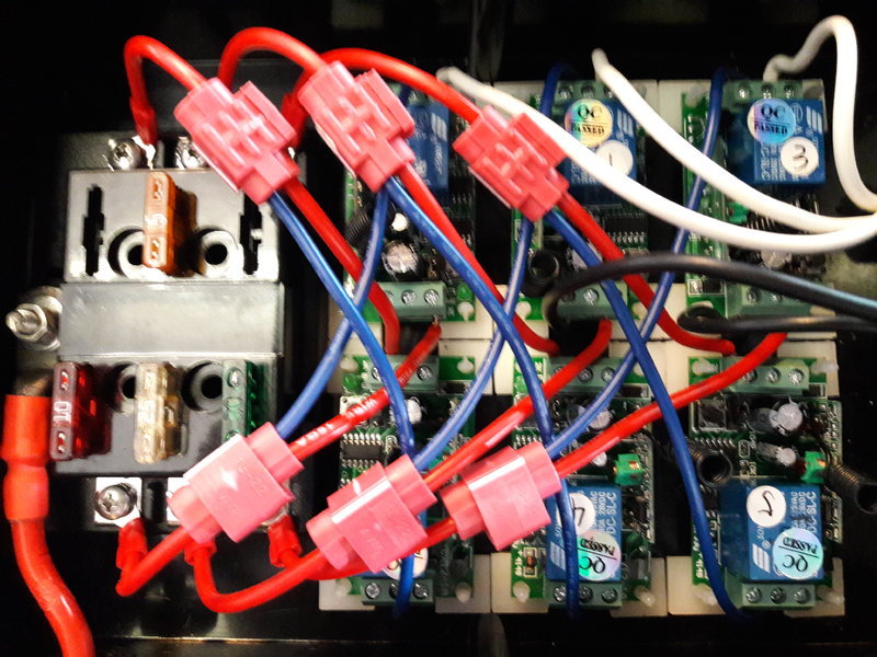

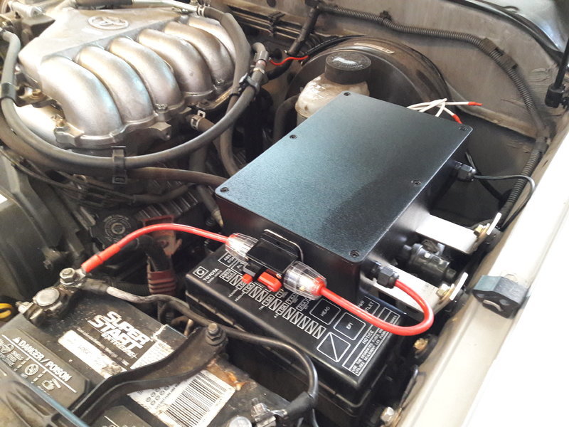

    Finally have something to post. This project was actually inspired by this thread.
    DIY 6 channel wireless controller. Cost me around $75 $90 in parts.

    Thanks. It was a fun project. Sourcing the right parts, especially the right size enclosure (especially in black), took a while. The first enclosure I bought was too big. The one I used is a tiny bit too tall, but it works.
    With these relays, you're limited to 10A. That is plenty for my current and planned lighting.
    I was off a bit my cost estimate. For some reason, I though I paid $27 for my relays. I paid $37. With wiring and connectors, probably closer to $90-$95 in parts.

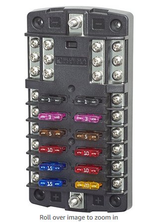

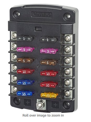

    Buying a fuse box, what is the reason to get a box with neg terminals as appose to no neg terminals.
    Only thing I can think is if you want the fuse on the negative/ground side.
    no negative terminals
    with negative terminals

    I want a neg bus so all grounds from switches etc. can be jumped together and grounded at one place using a single wire. Much cleaner design.

    Any bad parts from having negative terminals.

    Sometimes they don't get used if you ground near your accessory but generally no bad parts. Having negative bus gives you the option to use it instead of grounding to body/frame or to negative terminal of the battery
