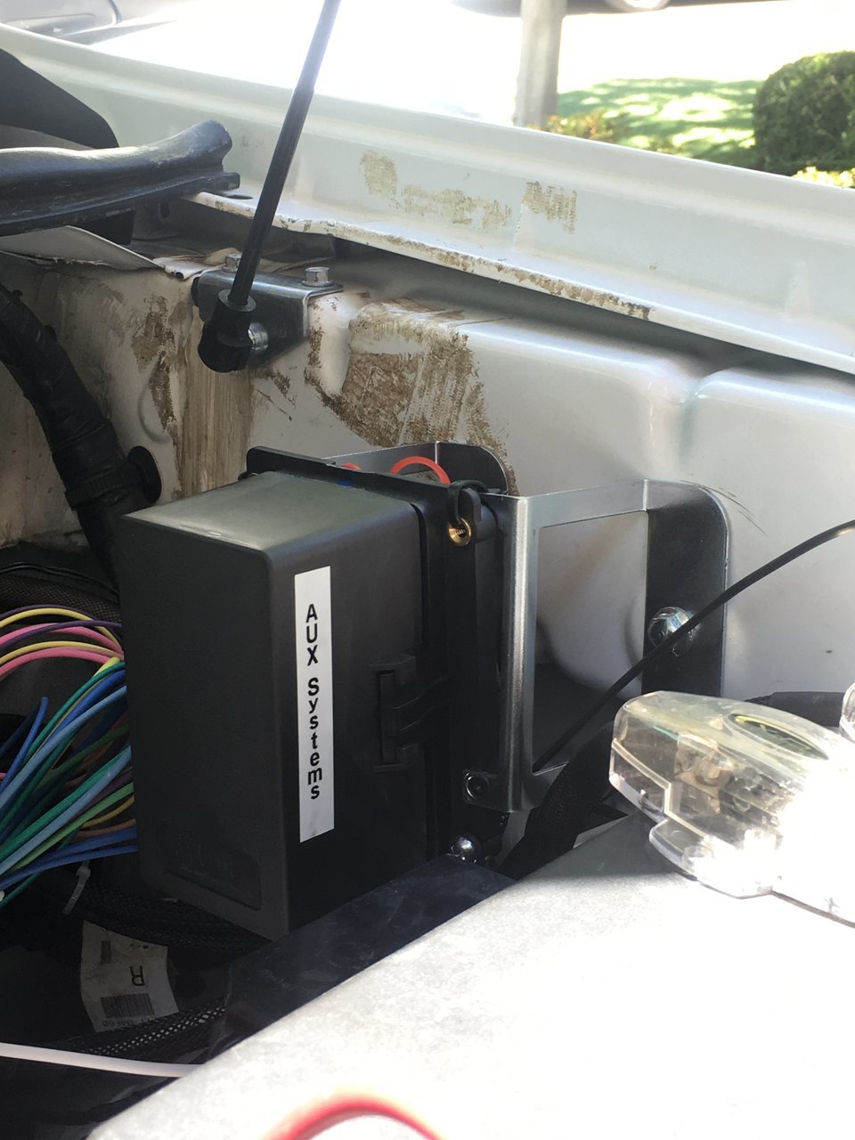

    5 fuse/relay channels, and everything’s color coded!
    SO much cleaner!

    That's different and clean. Why no mount it horizontal for easier access??

    Those terminals needs some love. Baking soda solution and wire brush, felt pads, and anti-oxidant.

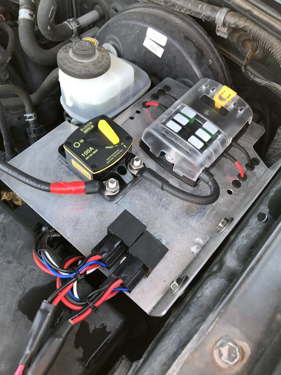

    Finally finished mine up with a 6 circuit blue sea block & circuit breaker, and a paranoid fabrications plate.
    @paranoid56 are you the one who makes these? Reallly nice product!

    yep :D I like making stuff :D lol

    I probably will, but that’s just the easiest way to mount with the supplied brackets.
    Haven’t needed to open it yet actually.
    It’s a “kit” off Amazon for like $115. Included all wiring, relays, fuses, and 3’ of colored wire.
