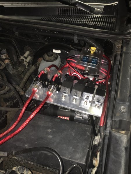

    C25393E4-1FEF-4AF0-9DA0-6960BC17101D.jpg 568341D5-8D8C-4E15-976C-7A57F0768015.jpg Finally got around to installing everything. Took me a while to wire everything up. I was just working on it at night when my daughter went to bed. It has 5 relays tied to fuses. There’s an option for a 6th relay but it’s a weird 4 pin that I haven’t bothered with yet. Thanks @paranoid56 for the custom plate, it worked out perfectly for this relay box.

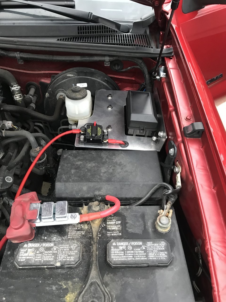

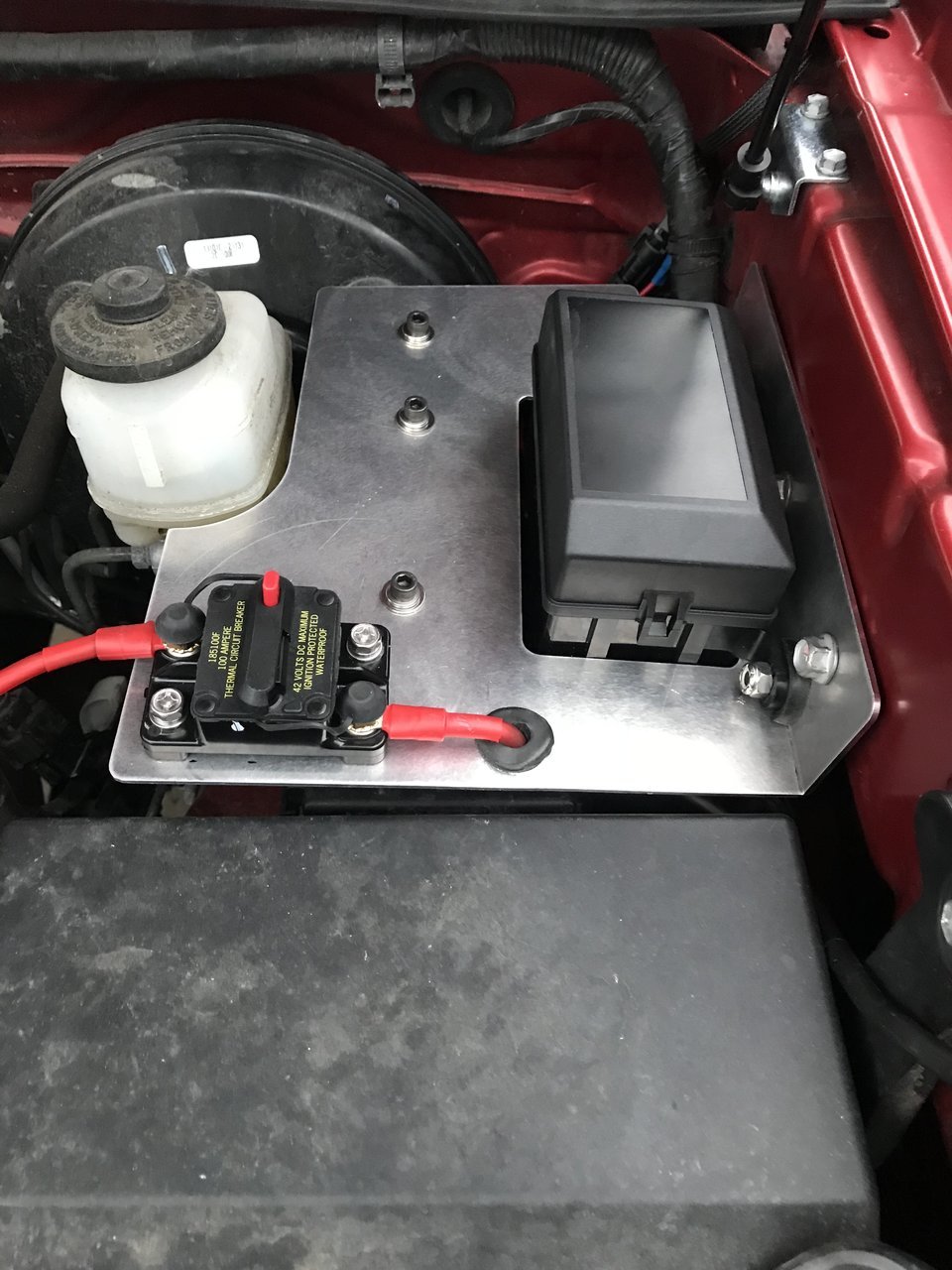

    Designed this one to fit my 3rd gen. Had @paranoid56 burn it... turned out great. Will get it bent up and powder coated this weekend. Holds a c/b, 8 circuit mini fuse, and 7 micro relay bank.

    Here’s mine. Water jet cut aluminum, drilled and tapped to fit everything I need. Powers my fog lights, ditch lights, light bar, compressor, and here’s a main power all the way to the tail light which powers a 12v outlet in the bed and my bed lights.
