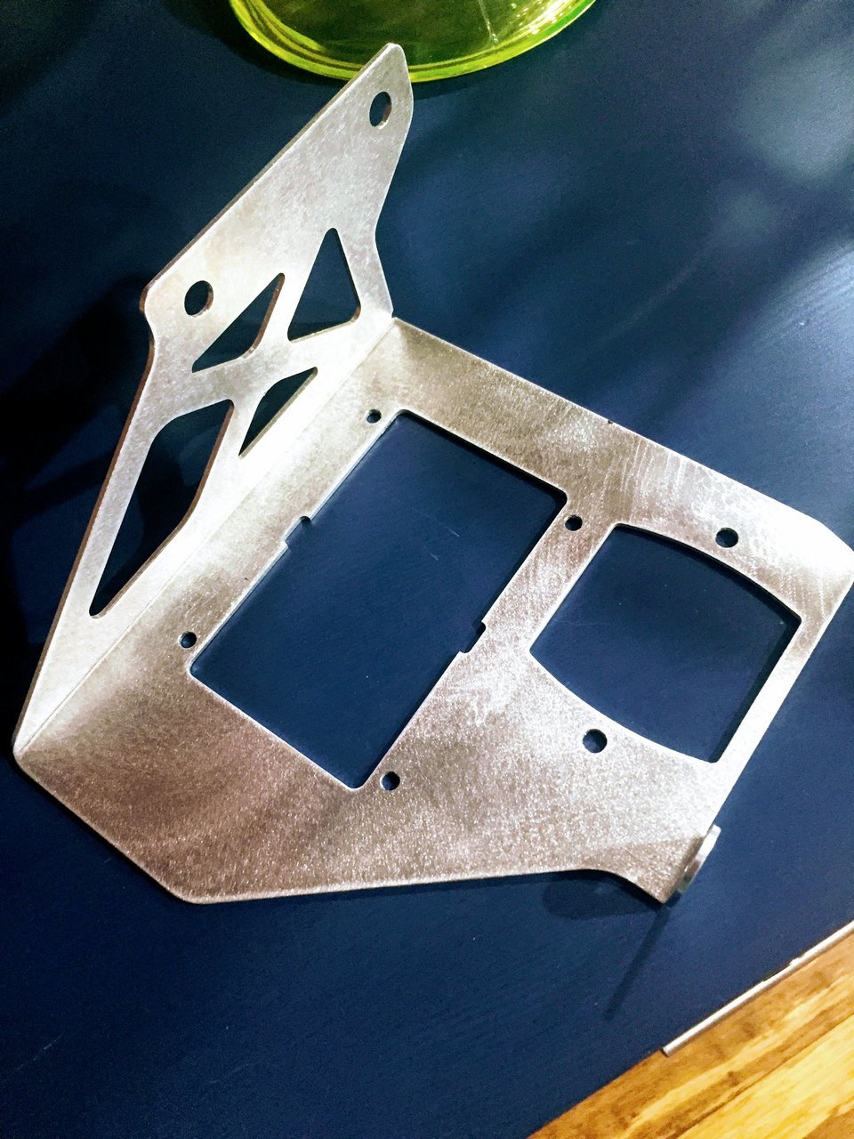

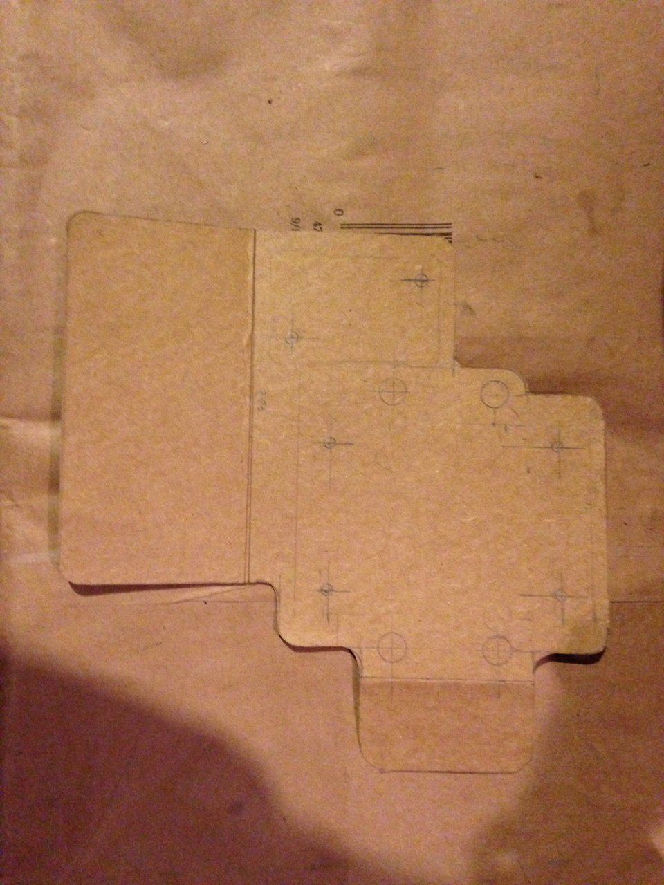

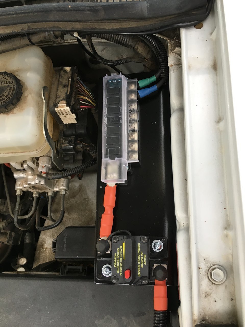

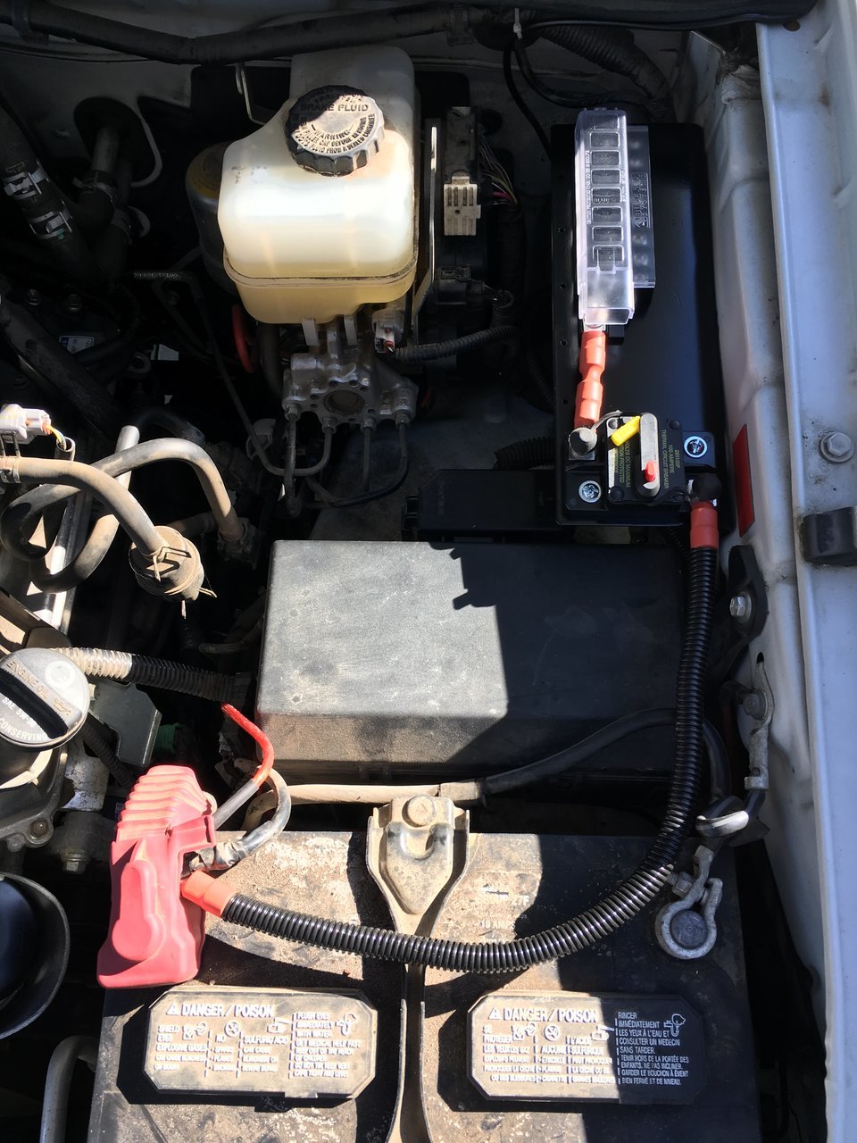

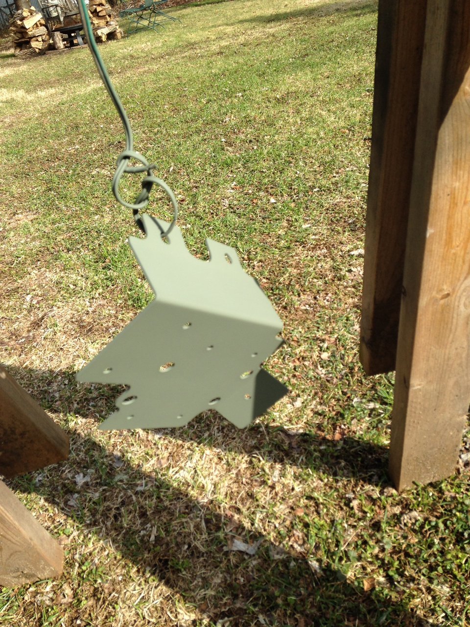

    I already had wired up some lights and it was kinda sloppy so wanted to make it better with some new circuits added for heated seats. Made mine from a small piece of aluminum plate then sprayed it with bedliner. Mocked it up using a 30 pack beer box. Any brand works.
    Refined the design as I was cutting it out, bending and punching out the holes. Then primed it before spraying with bedliner.
    Test fitting the parts before final assembly.
    Mounted and wired up. Works good and looks better now.
    Was fun to build.
    Neutral, Cid, TomTwo and 9 others like this.

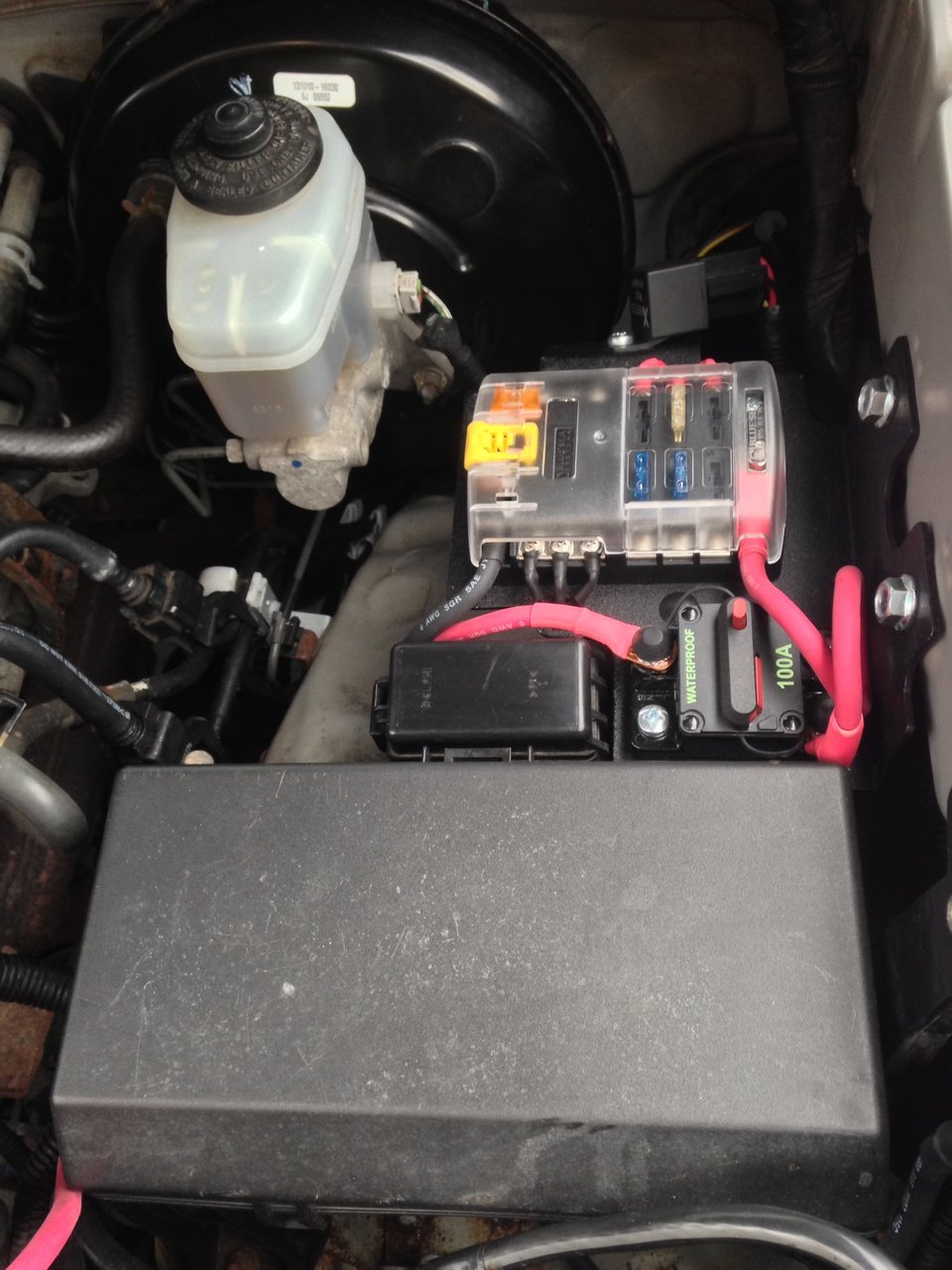

    Just designed my paranoid56 plate with Shane and its on my way. Thanks mesojdm for advice. Currently handwiring my bussmann relay/fuse flush mount following these directions. Gonna be a super clean install. Pics to come...
    http://www.bodenzord.com/archives/583

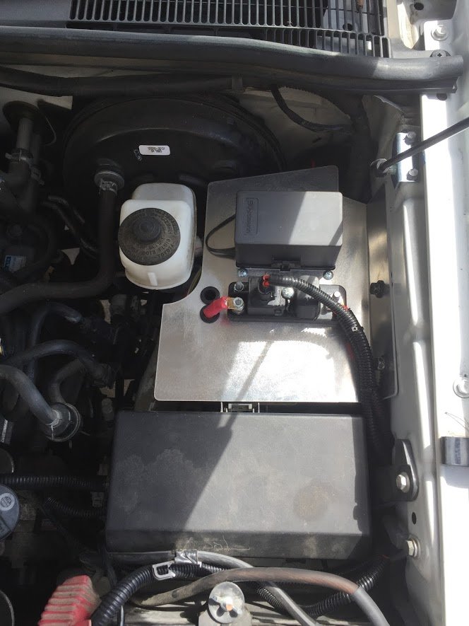

    Side notches don't look wide enough for the bussman latches.
  16. Jan 27, 2018 at 1:58 PM
    #516

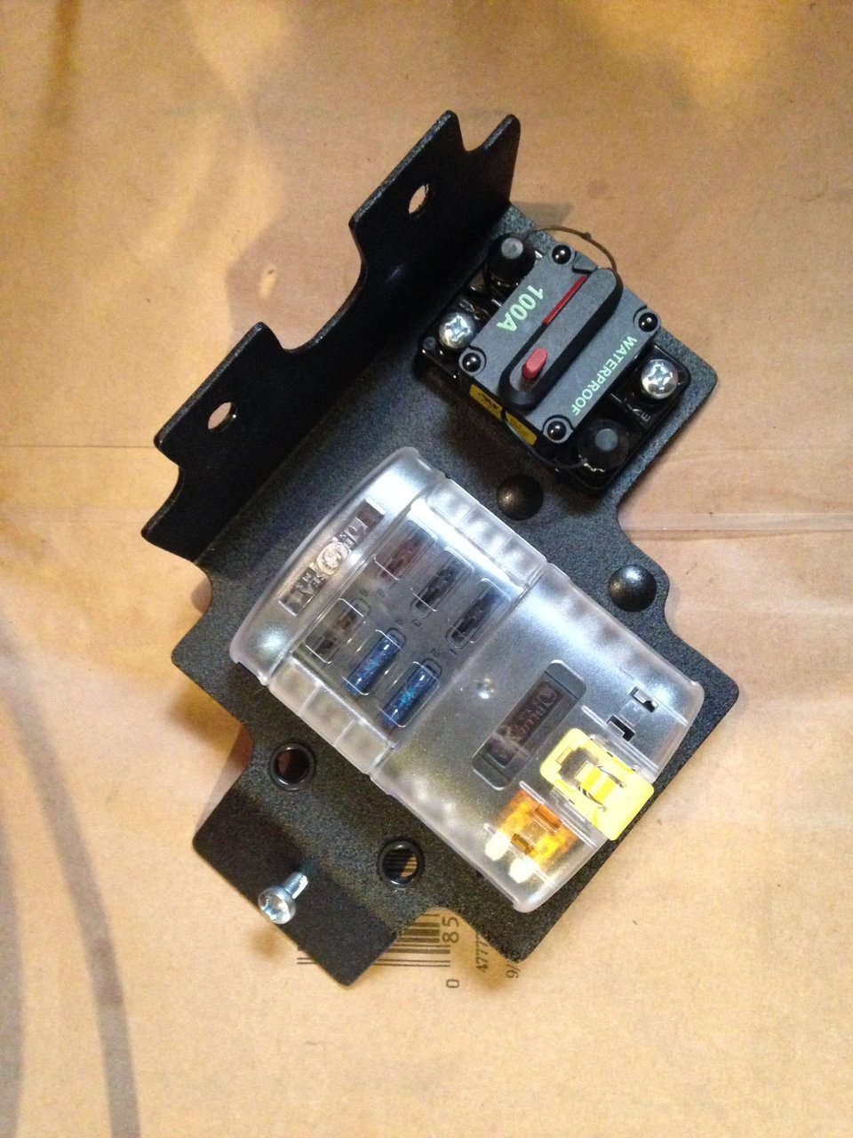

    paranoid56
    paranoid56 Well-Known Member
    Jul 25, 2012
    #83443
    3,444
    San Diego
    14 double cab taco
    They fit :D I like a tighter fit then how they are normally cut
    you can kinda see here.

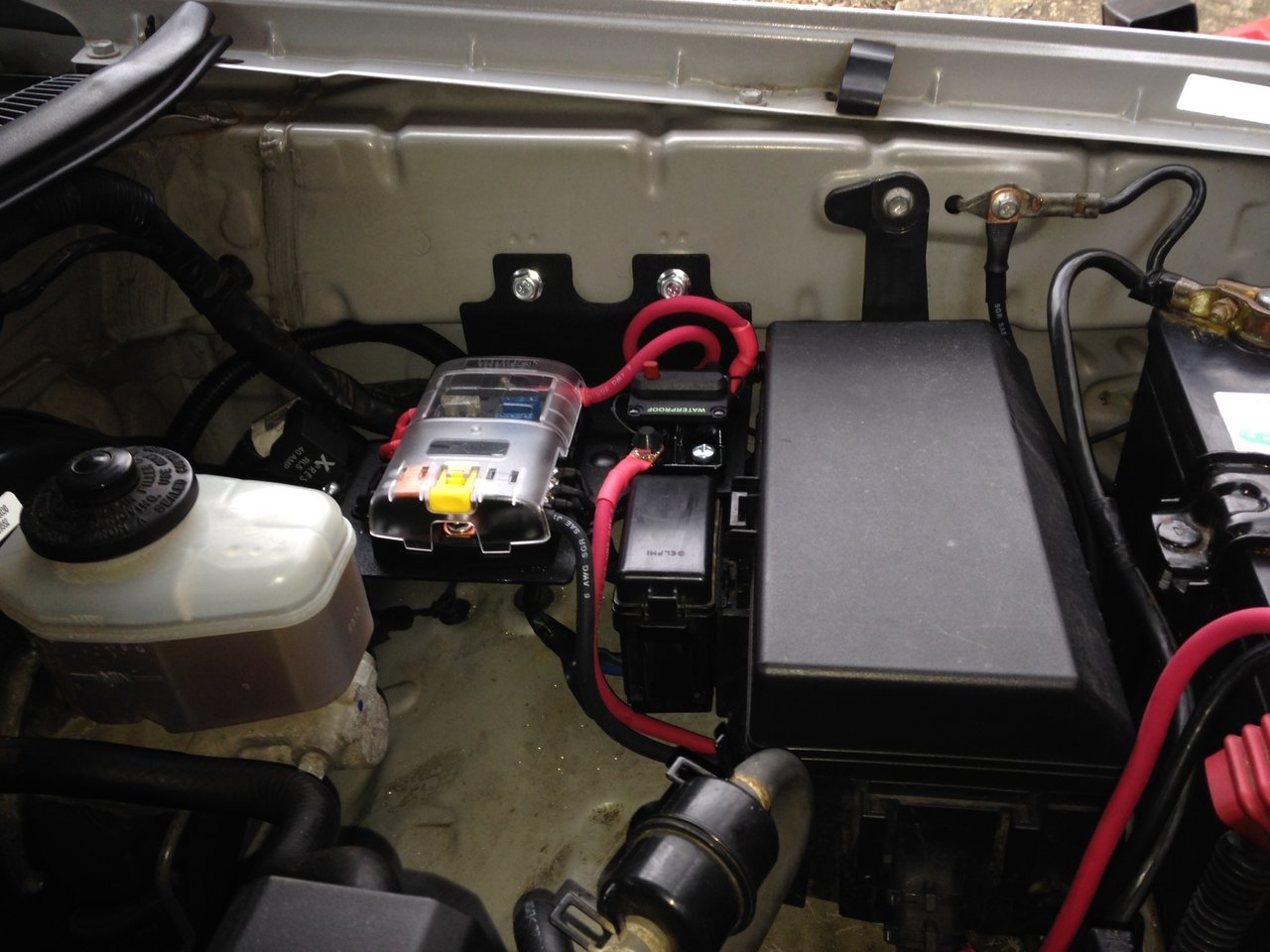

    Here's mine. Nothing fancy but compact and I can still access all the stock fuse boxes and the big grommet in the firewall. Thanks for all the advice I got on this thread!:cheers:

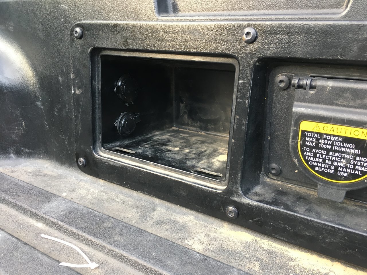

    There's mounting holes for 5 relays under the bracket too. All I've done for now is wire up a 12 volt socket and USB charger in the bed:
    Friedtacolover likes this.

    Nice cut on that plate. What did you use to cut it ?
  20. Jan 29, 2018 at 10:02 AM
    #520
    L J
    L J Well-Known Member
    Mar 16, 2010
    #33339
    859
    Illinois
    07 4X4 SR5 TRD Sport DCLB
    I used a band saw to cut it out of a 9” x 9” aluminum plate. I made the holes first to get a nice radius where the cuts meet then used the band saw. Finished with round and flat files.
