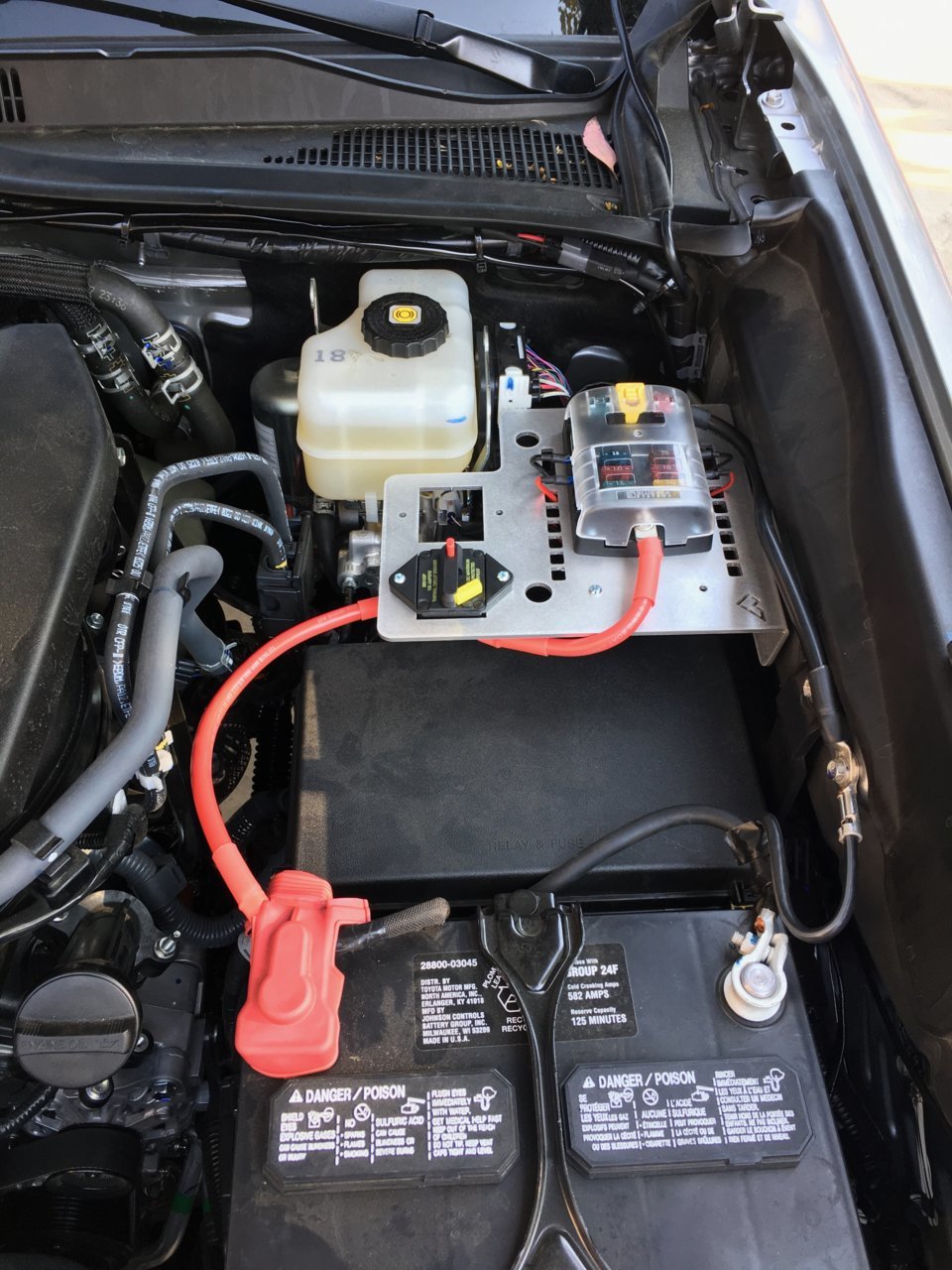

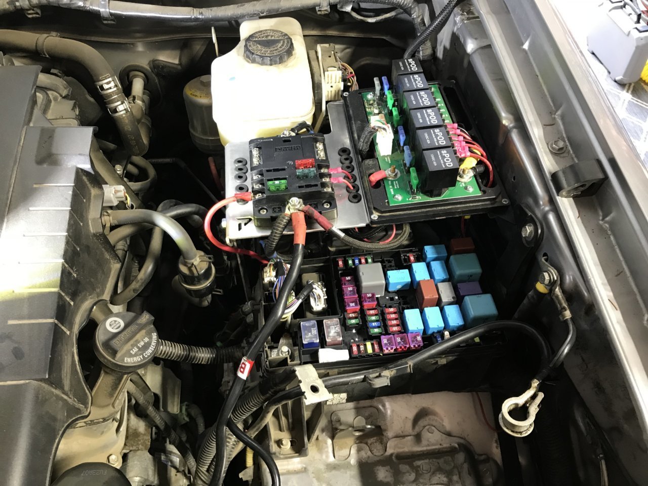

    Just installed mine using 4awg wire

    Is that a pelfreybilt mount?

    Yup

    @AWD_Jeff what type of terminal did you use on the fuse box? Crush or solder?

    Looks good, I think that'll be the one I get.

    I was lazy and purchased online. I believe it’s crushed.
    4 Gauge AWG Custom Battery Cables - Solar, Marine, Power Inverter - Copper Wire https://www.ebay.com/ulk/itm/381118203401

    Sorry my bad. The smaller 12g ish wire

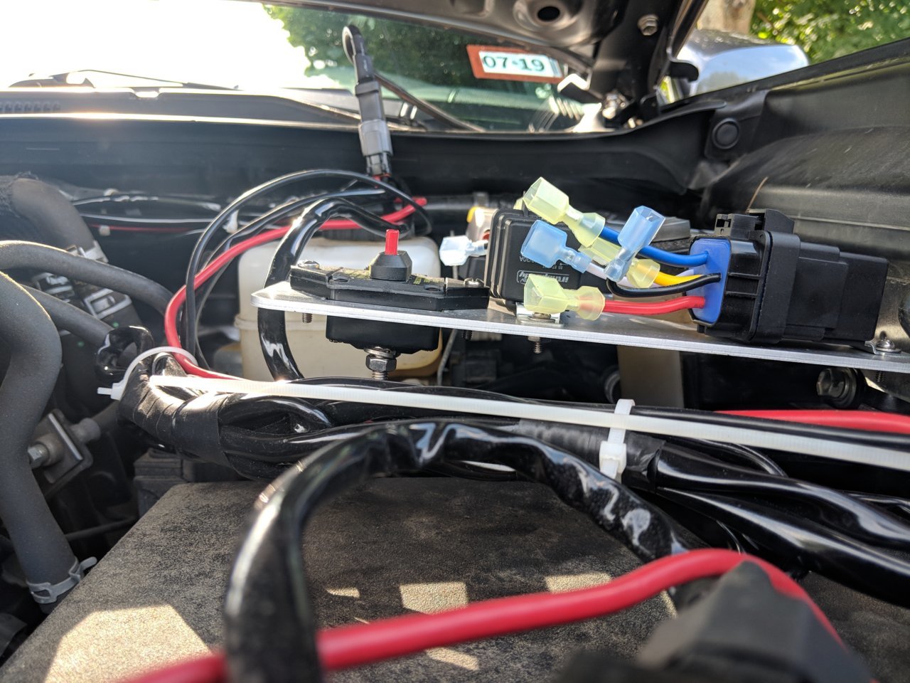

    I did both, crimped everything with a vice then soldered it up well.
    Also finally got mine installed, 1 Master relay on top runs 4 relays bolted underneath to all be switched when the truck turns on. They all terminate at the 4 pin terminal on the back right for fast access for future switched items. then I have my aftermarket fog lights relay bolted to the top so I didn't have to mess with adding that to another relay. Fog light relay and my dashcam hardwire really messed up the "pretty" aspect of it once I installed them. Thinking about putting the fog light relay on the bottom and re routing the dashcam hardwire.

    Ic. I’m running caliraised ditch lights which is probably a 14g. Also, national luna battery monitory which came with a 16g wire.

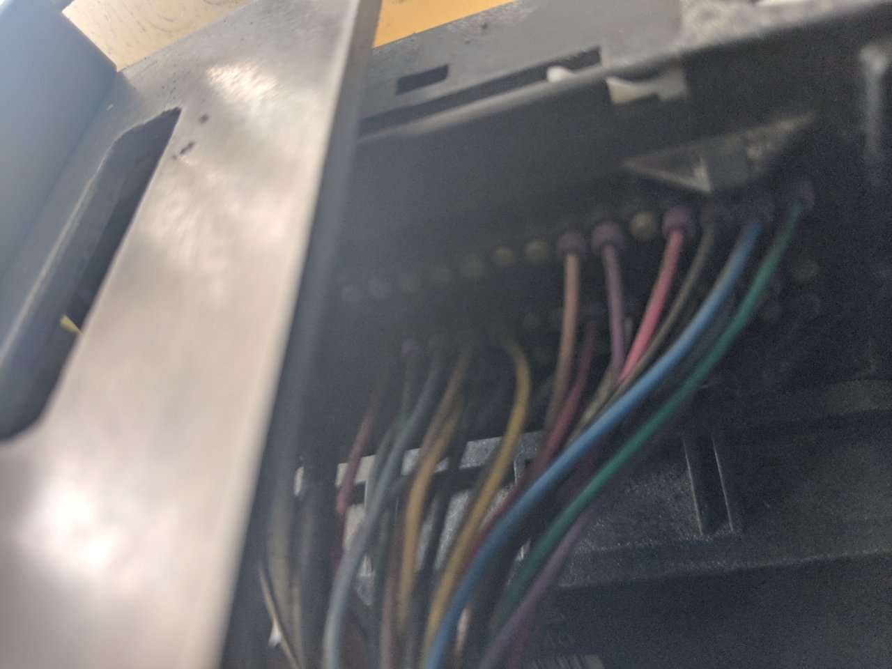

    Anyone install a Pelfreybilt aux fuse pannel mount recently? On a 3rd gen , TRD OR, manual.
    Anyone resolve this interference?
    IMG_20180902_152047.jpg MVIMG_20180902_152150_1.jpg MVIMG_20180902_152557.jpg

    Yup. Same experience. This pannel is junk to me. Money wasted.
