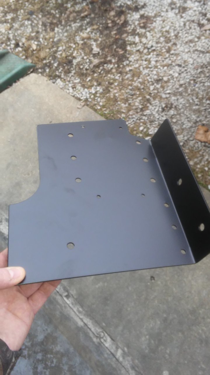

    Thanks man! I made that myself! There are some pretty legit ones available for purchase tho. Check around the forum. TacomaPros down there in the Vendors section has some stuff I think.

    I have searched High and Low in this thread and others but cannot seem to find the bolt size listed for the Gen3 fuse panel bracket where it bolts in near the fender. If anyone has any idea where I could find that information that would be amazing!

    ^ I believe the bolt is an M8. I thought I read that somewhere in the thread....Mine came with bolts holding the clutch resovoir on though :)

    @Thunder chicken got any pics of your setup? Trying to figure out how to go about mine with the reservoir in the way

    Thank you! Bolts are cheap, but guessing can get expensive! I do miss having the clutch until I get stuck in traffic... Thanks for the info and I like your clear plastic idea for the mount!

    Yup, M8. There are places under the center console that use M6 and M5 bolts as well.

    Who makes this one?

    The post directly above the one you quoted mentioned paranoid56.

    Paranoid Fabrication

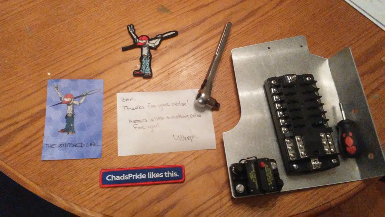

    If anybody wants me to make cables for your setup, let me know. I carry 4awg but can order a bigger/smaller gauge if needed for your setup :)

    I put together these 4AWG cables for him, happy customer! I can build you the same cables if you’d like :)
