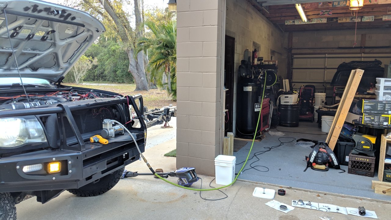

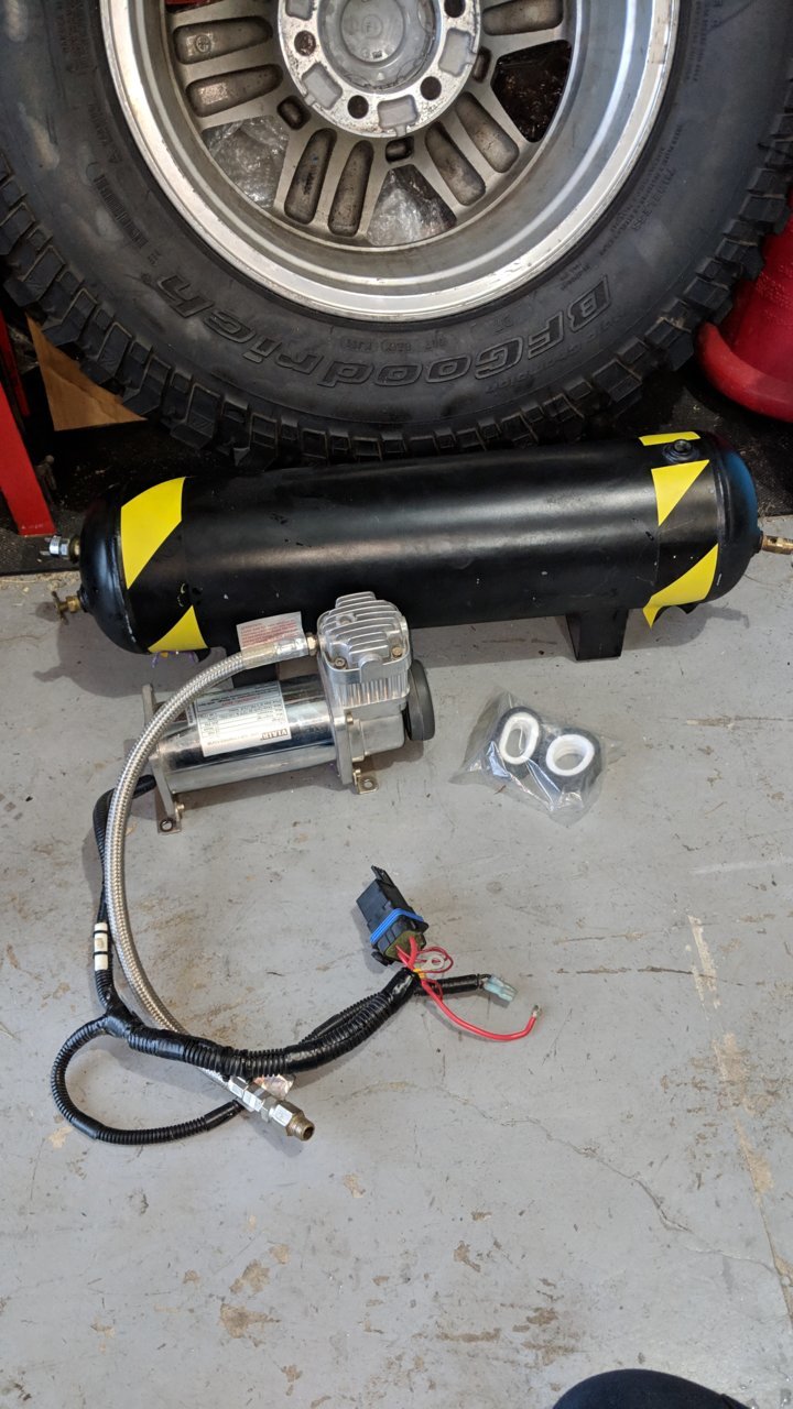

    Anyone know how to wire up an auxiliary 12v air pump with the pressure cut off switch? (Diagram / wire schematic) :)
    I received the pump from a buddy who said it was "good to go" made the mistake of trusting the wiring underneath the mile of electrical tape when I tested it on a battery... :facepalm:
    Unfortunately one of the 16ga wires became a fuse and instantly melted.:mad:
    (Relay probably has welded contacts now too but I got a plenty of them.)
    Pump still works though so no REAL harm done.:thumbsup:
    Used it to charge my 60 gallon since I haven't had a chance to wire in a 220v 60a breaker at my current place yet. :D

    Pressure switches and relays don't care about polarity so there's different ways to do this. Here's one,
    Switch circuit: 12V pos > fuse > switch in - switch out > pressure switch in - pressure switch out > pin 85 on relay -pin 86 on relay > ground
    Power circuit: 12V pos > fuse > pin 30 on relay - pin 87 on relay > compressor red lead - compressor black lead > ground to chassis or Battery neg.
    Either connection on pressure switch works for electrical in or out
    Pins 85 and 86 on the relay are for the switch circuit
    Pins 30 and 87 (also 87a on 5-pin relays) are what gets switched on/off
    No idea why those numbers but I'm sure there's a good Cliff Claven story there.
