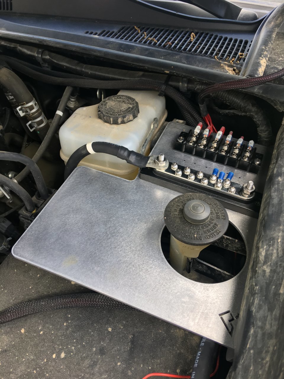

    tacoma.jpg Well-Known Member
    Oct 17, 2018
    #269766
    66
    Colorado
    2018 TRD OR Access Cab
    Matte Silver Metallic Vinyl Wrap 2.5" Icon Stage 3 Total Chaos UCA's Rear AAL + Shims 17" Jet Black SCS Ray 10's 285/75/17 Cooper's RCI Offroad Bed Cage RCI Offroad Skid Plates Decked Drawer System C4 Fabrication DOM Welded Sliders Nitro 4.88 Gears ARB Front Air Locker (Not hooked up yet) PIAA SMR 520 6" Lights (Hidden Behind Grill) Prinsu Access Cab Roof Rack

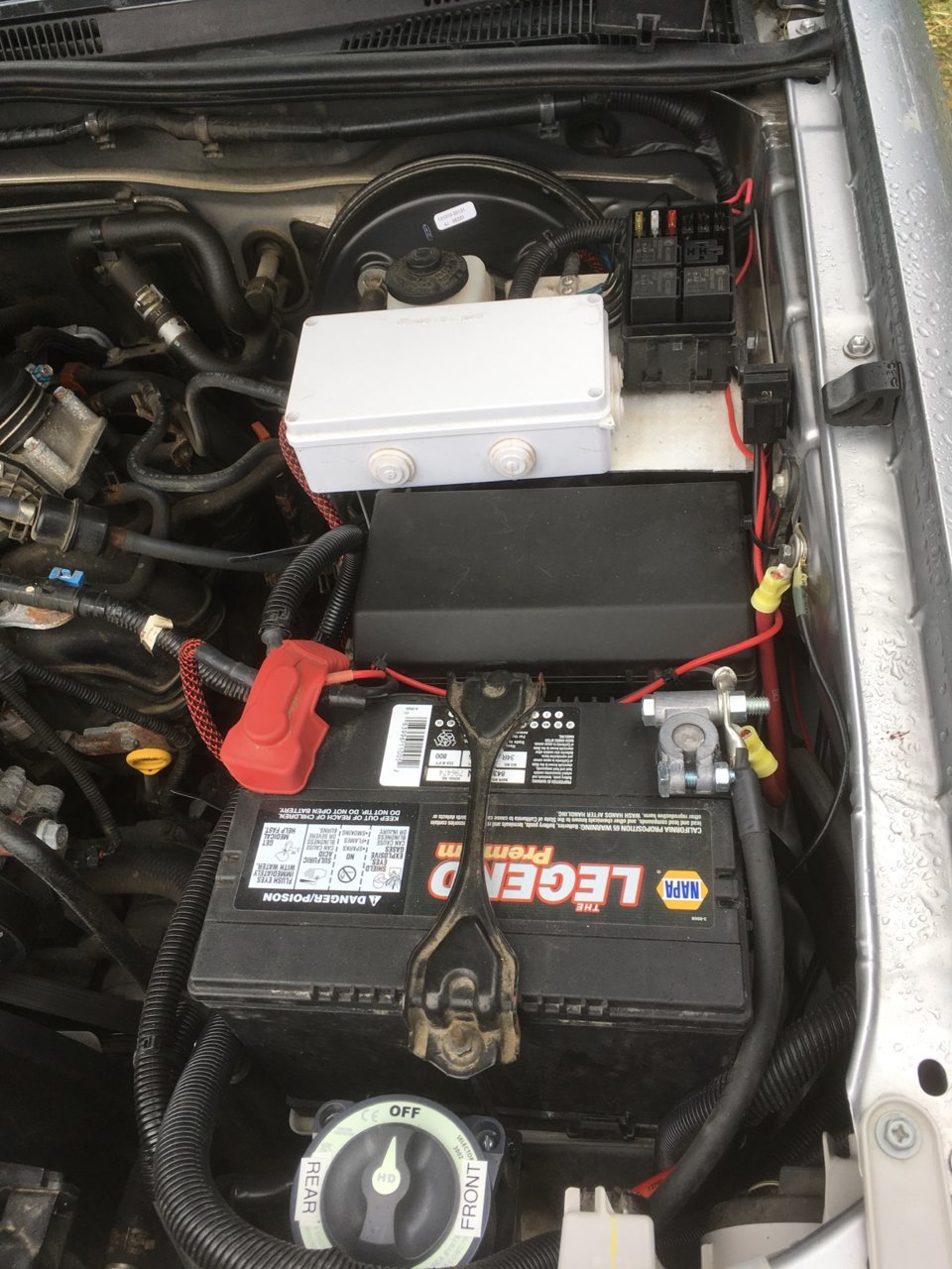

    bkrdave36
    bkrdave36 Well-Known Member
    May 12, 2011
    #56546
    826
    Dave
    Wittmann,AZ
    06 Prerunner Double Cab Black
    Front OME Springs, Upper Control Arms, Icon Stage 3 Rear Leaf Springs, Durobump bump stops,Bilstein 5125 shocks, BFG All Terrain KO2 Tires, Avid Light bar and step rails, Victory 4x4 bed rack with Tepui Ayer Rooftop Tent, Anytime Fog light mod, Outside Air Temp Gauge mod, ImMrYo Rearview Mirror mod, Chinese Knockoff LED lights, Body Armor 4x4 Offroad Swingout rear tire carrier and bumper, Victory 4x4 Bed Stiffeners, Rattle can Custom Camo paint stripe, Truxedo Lo Pro tonneau cover, various Blue Ridge Overland Gear storage solutions in cab, thats it so far .... to be continued!
    Thanks for the Heads up.
    Here is mine "mid" project.
