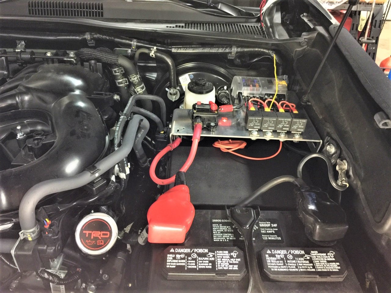

    Distance from the battery is one thing I can think of as far as driver vs. passenger side install... There were a couple of passenger side installs in this thread if I recall. Also firewall access comes to mind. Same with proximity to the cab fuse panel.
    I am hooking up the switches that power the accessory relays to "keyed" power in the cab fuse box. That way nothing can turn on unless the key is in the "On" position - the exception might be the scene lights I plan to attach to the roof rack. I may run constant power to that switch for camping, tailgating, etc. Realizing that I run the risk of accidentally leaving them on but I don;t see that as a big issue.

    Using my meter I checked the fuses for "hot" fuses in the cab with the key off and then ruled them out. Then I turned the key on and tested the ones that were not hot with the key off to verify "power when on". Then I used a fuse tap.
    I built a hybrid version of the DIY Bussman in the thread below - It was by far the most educational post I've read on TW. I used a fuse panel/relay/blue sea set up and pre-wired all the relays with weatherproof connections and a switch wiring harness similar to the one in the thread. I did not do the Bussman set up but what I have works well so far. All I have to do is run the accessory wires to the aux fuse box, add a male weatherproof connector and plug it in the the corresponding female relay plug (I labeled all with switch number and relay number). I then insert the appropriate fuse in the Blue Sea fuse box and I'm good to go! Switches are all pre-wired so no messing with those and if I want to change accessories all I have to to is remove the plug at the aux fuse box and run the new accessory wiring. I don't have to mess with the relay or switch wiring.
    The only issue if a relay fails I'll have to redo that but I'm OK with that (for now). I may build a more traditional Bussman set up down the road but the good news there is that my switch wiring will work with either setup.
    https://www.tacomaworld.com/threads/diy-build-and-install-a-bussmann-rtmr-fuse-relay-block.399454/
    Highly recommend reading through that thread for a crash course on aux fuse panels. It was fun to build and I learned a ton! I was so happy when the first set of lights I hooked up lit right up! No messy wires in my engine bay and super easy to install/change new accessories.
    Keep in mind that these are for lights and other lower amperage draw accessories - read up on AMP draw and what wiring is needed - it's VERY important if you don't want to torch your truck. You'll want to take a different approach for a winch or on board air - stuff like that. Personally I would have them on their own circuit with a dedicated breaker.
