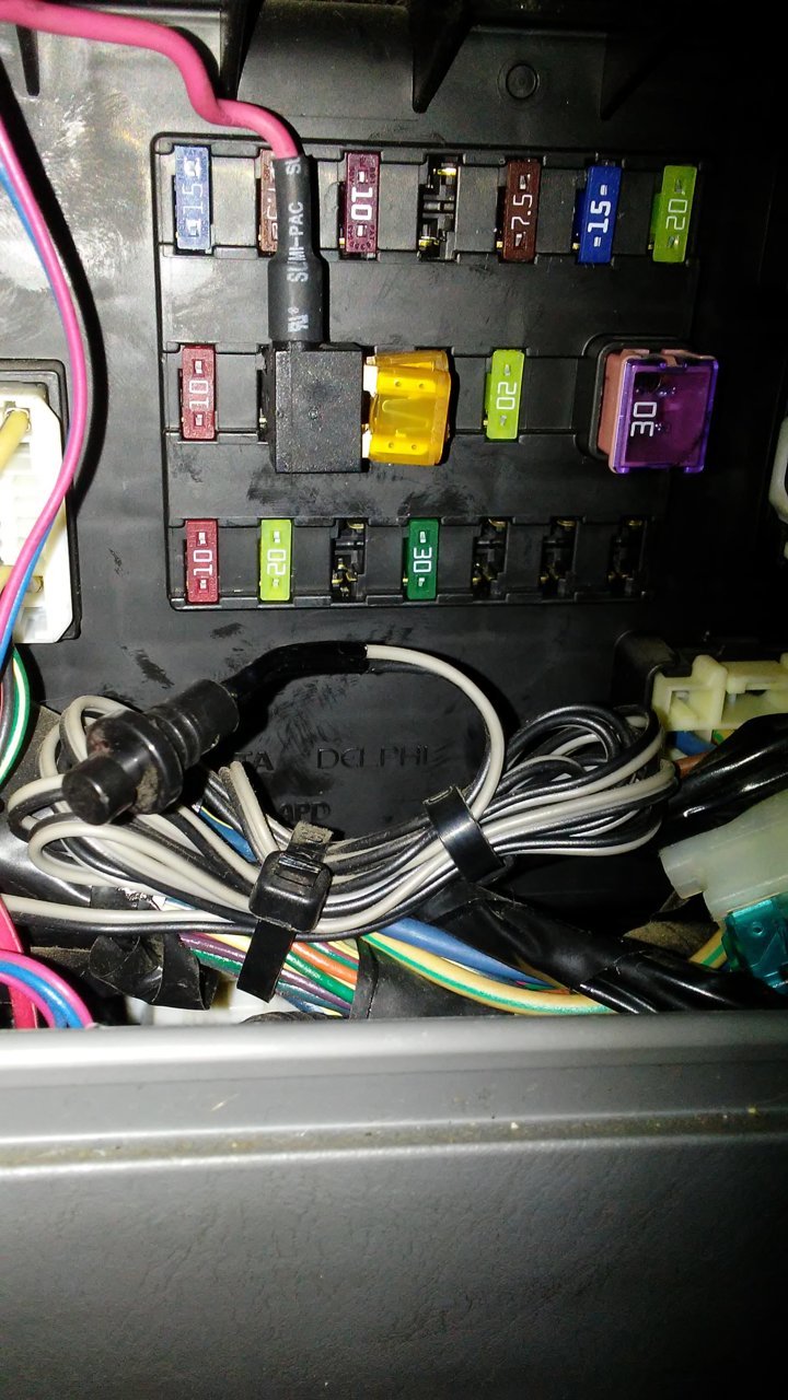

    If it’s empty, do you have to put 2 fuses in there or just one?
    And which slot top or bottom?

    Just use the top slot of the add-a-fuse.

    Orientation of an add-a-fuse in the fuse block is important.
    The correct way both fuses get power in parallel from one blade with the original fuse protecting the circuit on its downstream leg and the extra fuse protecting the circuit connected to the wire. Installed backwards and the original fuse still works but the extra fuse draws in series from the downstream side of the original fuse instead of in parallel with it. Still protected but more likely to blow the original fuse.
    Fuse blocks have a buss that supplies power to one blade of the fuses and terminals for the circuits protected on the other blade. The non-wire end of the add-a-fuse should be plugged into the buss side. Since fuses don't have an orientation the block generally isn't labeled so it's up to you to figure out which blade socket is connected to the buss.
    As far as the add-a-fuse itself goes only one fuse slot connects with the wire so if you're using an empty fuse panel slot and no original fuse only one add-a-fuse orientation and one add-a-fuse slot combination will be hot.

    Wire pointed up, blades pointed away from you, the fuses on the right. Closest to you is extra, furthest is stock.

    Yes, if you install the add-a-fuse wrong, the top slot won't have power. If you install the add-a-fuse correctly but put the fuse in the wrong slot the wire won't have power.
    If however, you install the add-a-fuse wrong but use 2 fuses the wire would have power. Current would flow first through one fuse, then the other and out the wire.

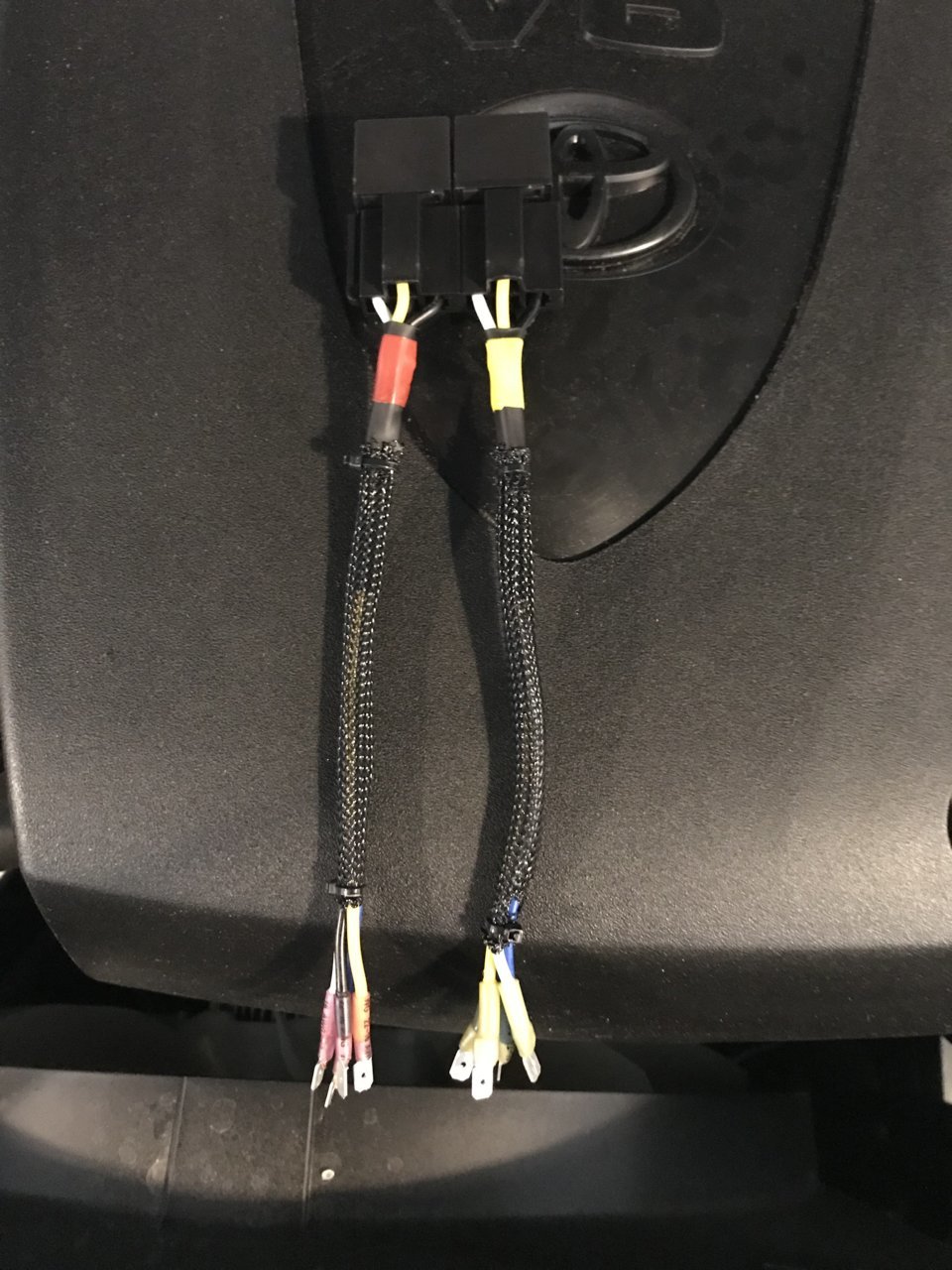

    Figured it out. I have my relay sitting in the power tray. Its on a slight angle so one of the prongs was just touching the tray. Put electrical tape around it and no issues anymore

    Probably should move it a bit. Vibration will cause the tape to rub through and short it out again.

    At least some heat shrink instead of tape. I hate using electrical tape for anything more then marking wires.

    there's heat shrink that can go over the connectors after they plug into the relay?

    Krown undercoating, Protect a plate, blindspot mirrors, Reese stainless steel towing ball, Bakflip MX4 tonneau cover, Tufskinz tailgate letter inserts, Console organiser, Tinted windows, LED interiors, Bed lights, Hood lights, Black Canadian flag decal (@bfeth), Oem bed mat, WeatherTech floor liners, Arctic Claw XSI tires, Recovery Shackle, Ultimate LED turn signals V3 @mesojdm, OEM TRD Off-Road tow hook, Bilstein 5100's with ARB's Old Man Emu 2887 coils, ICON progressive add a leaf, General Grabber ATX tires, Fuel ripper rims, Auxbeam F-16 H11 Led headlights, Borla S-type catback exhaust with black tip, custom powertray, vinyl badge inlays, (@rrentrop), Rear diff breather mod, Redarc trailer break controller https://m.youtube.com/watch?v=qqN7m1pc6AA
    how it looks

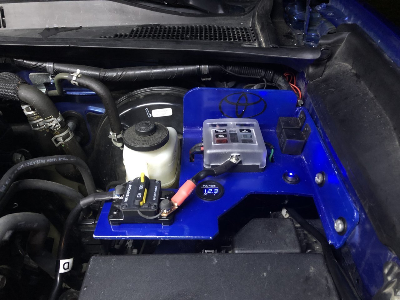

    Here’s a pretty simple one. More room for more in the future. What’s the benefit of a circuit breaker over a fuse like I have on the right?

    Not sure how your getting a short issue or how you have the bottoms done. Mine have the actual plugs so no issue of a potential short.
    Also attached to avoid faulty connections and so I can trace wires without tearing out my plate.

    I was getting it not anymore
    It’s cause your are pre wired where mine I had to wire. Female connectors
  20. Sep 2, 2019 at 12:38 PM

    That’s what I figured. So cover the connections with heat shrink. Slide it down the wire, connect the spades, slide it back up and heat... or get spade connectors with shrink tube. I do both.
    https://www.amazon.com/gp/aw/d/B07HRHC8BW?psc=1&ref=ppx_pop_mob_b_asin_image
    There are spade connectors under the heat shrink.
