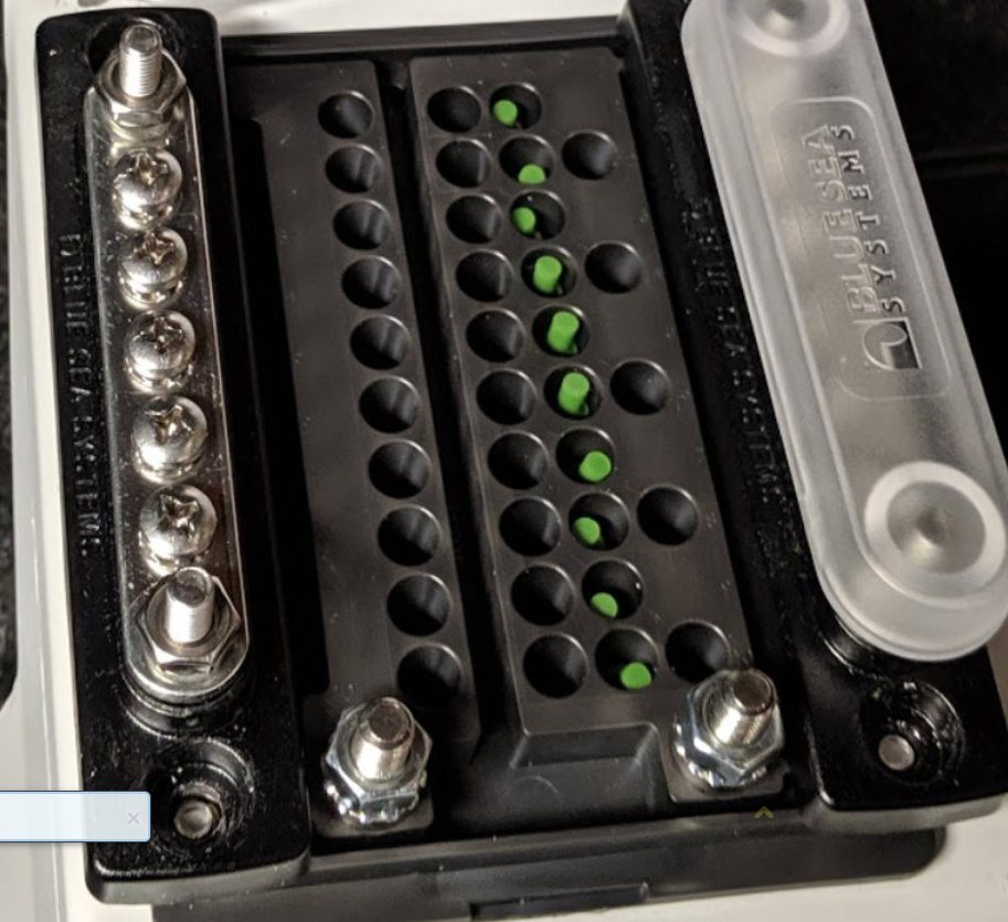

    Anyone here know how to use the Meso cover with the add a fuse if you put it in the blank spot? Doesn’t seem big enough

    It fits. You just put it on.

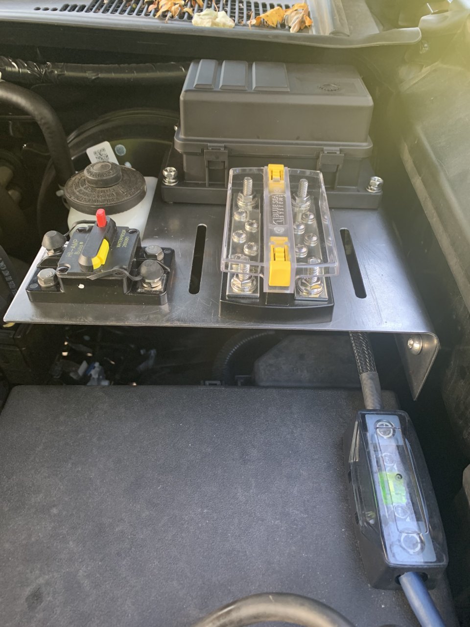

    Bussmann RTMR done, Now i just have to make the switch panel and install
    JustinL, motofish84, bagleboy and 4 others like this.

    can you post a pic of the top view of the bussmann panel?
    I am doing it a bit different as well. For the 1st gen (as you found) the panel doesn't have enough space for the two ground bus bars on either side of the bussmann. Instead of putting at the top or bottom of the panel, I used longer screws and attached them like this -
    JustinL and yodataco[QUOTED] like this.

    sure thing.
    I used this bussbar from bluesea instead.
    https://www.bluesea.com/products/2306/Common_100A_Mini_Grounding_BusBar_-_6_Gang
    and were mounted this way. I used a scrap piece of plastic to raise the rear busbar higher than the front one. Also if your going to route the negative wires like i did for the metripak terminals i would give an extra 1/4-1/2 inch of extra wire for the link between the fuses and relays so you have extra room to fit them.
    And i mounted the ground lines differently than in the writeup.

    Why the fat ground cable to the Bussman? It looks like your accessories ground to your buss bars so all that’s left is the coil current through the relays, all 5 of which don’t add up to even a single amp. Maybe I’m seeing it wrong but it looks like the main ground cable should go to the buss bars with an awg18 to the bussman.

    Mostly because i couldn't find a way to link both bussbars in the orientation that it is. If you look at a 1st gen you would know that its extremely tight in there.
    Either way it should still work as intended the only difference is the internal ground bussbar gets full amperage.

    Let me know how it fits, Your using the plate from paranoid right?
    I was going to mount the bussbars exactly as you showed but based on the dimensional drawings on the bluesea website showed that there still wont be room on the sides.

    Clever how you offset the ground busses to overlay the wires to the outer buss. The mount plate already connects the external buss bars though a metal strip joining each end would eliminate the need to strip the paint under the bolts. As you say, it works, but if space is tight it could be done with one small wire from the Bussman ground buss to the buss bars and the battery cable from there instead of those two cables and 3 heavy lugs. Clean work though.
