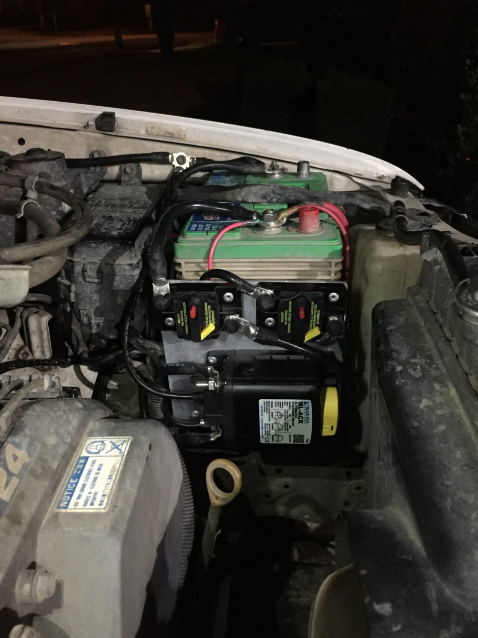

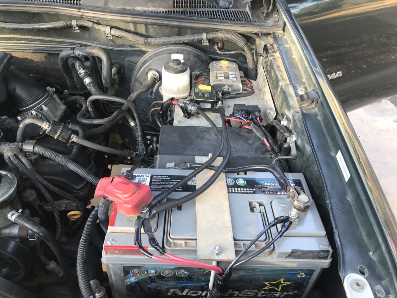

    This is from a 1st gen, part of my dual battery setup with a Blue Sea Systems Automatic Charging Relay. Its basically a smart relay that senses when theres a charge it combines both batteries, when theres discharge (from the winch or starter) it isolates the batteries so theres always one for cranking. You can also manually combine the batteries with a switch.

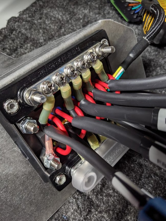

    Very clean, I do electrical work for a living so I can appreciate this

    super clean, nice build

    Gosh guys! I’m feeling kind of low today. So the complements mean a lot at the moment. Thanks

    sorry to post twice on your pic, it just really stuck out. Its hard for someone to appreciate how much time and effort goes into stuff like this

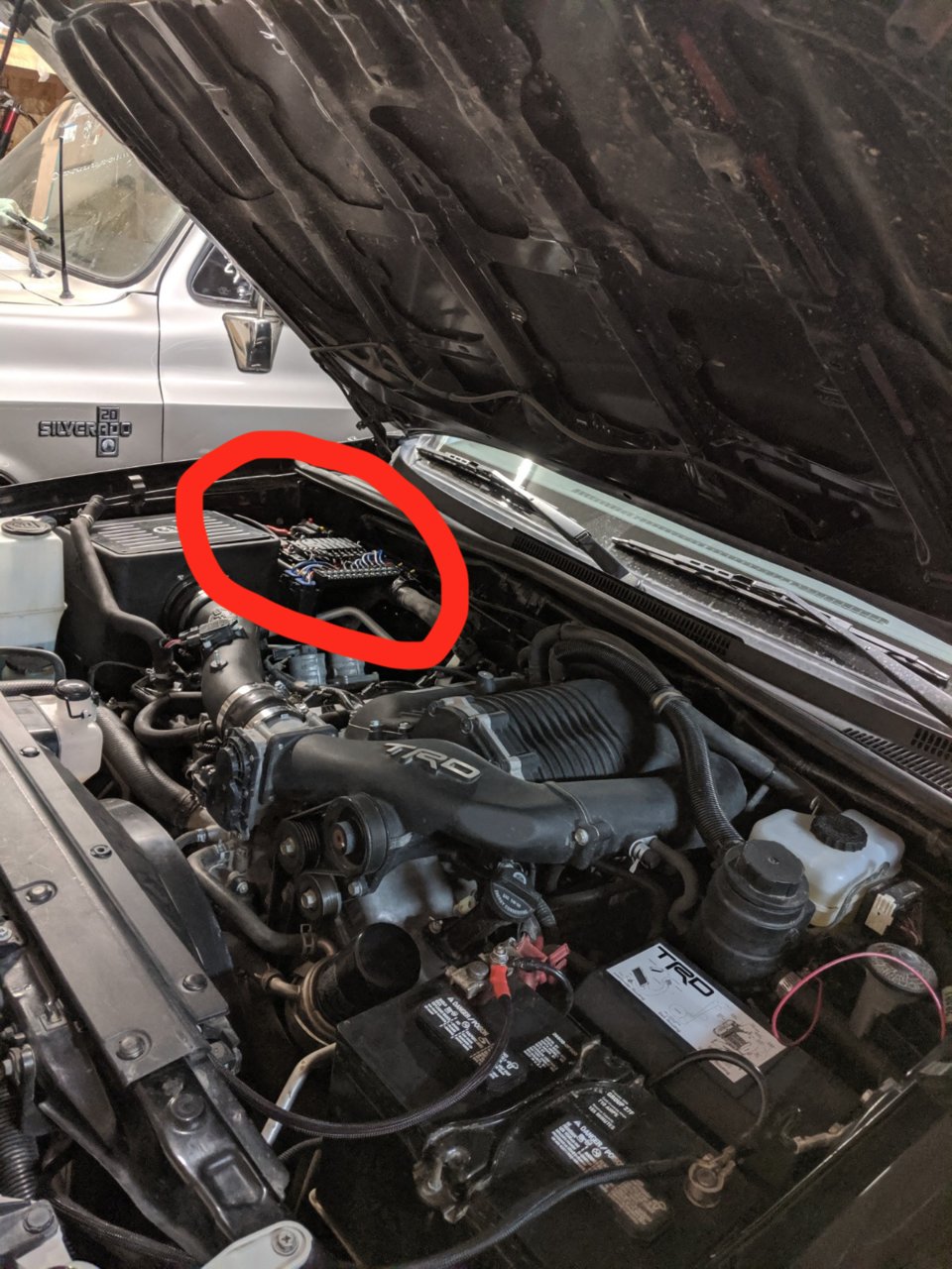

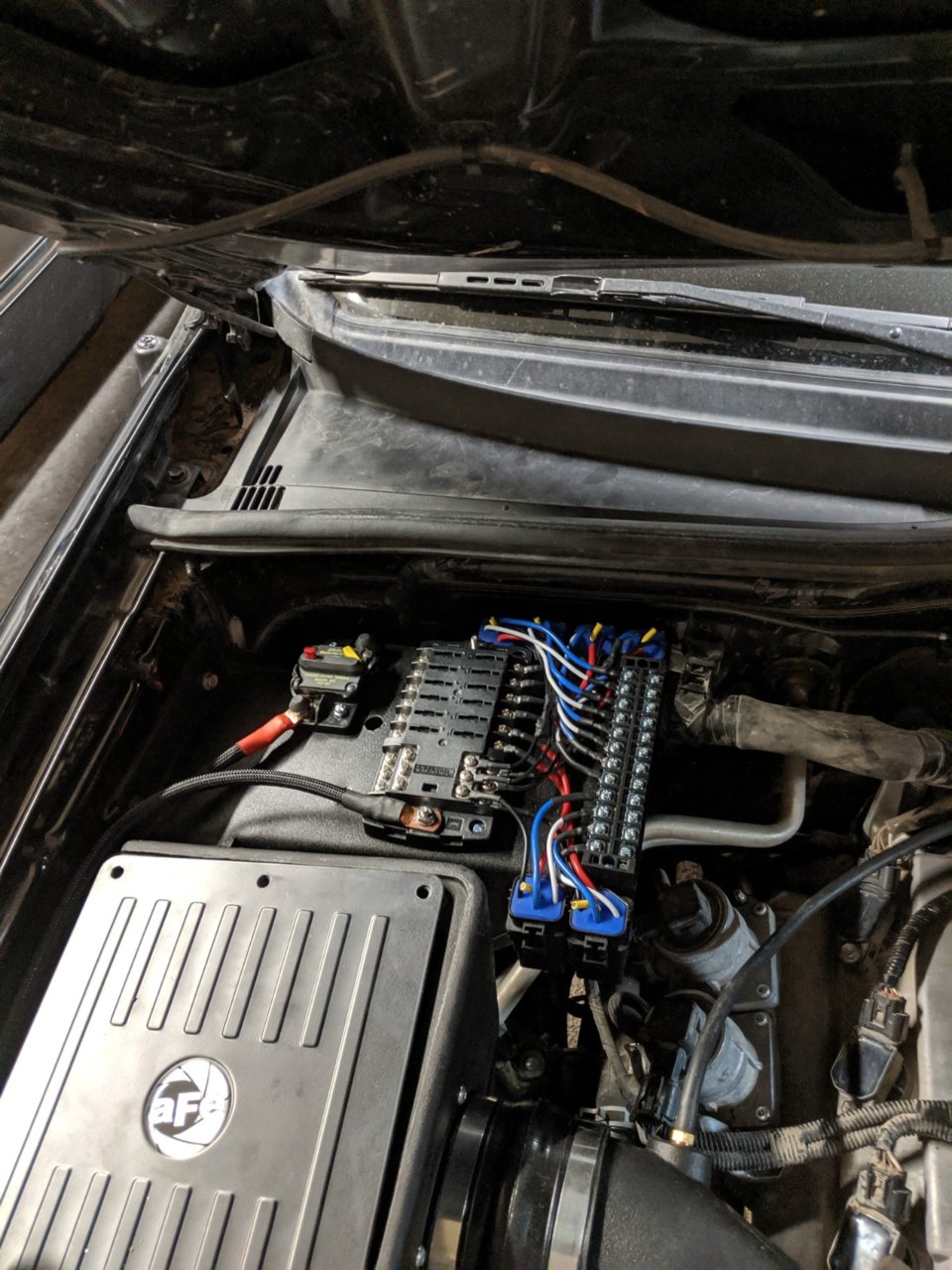

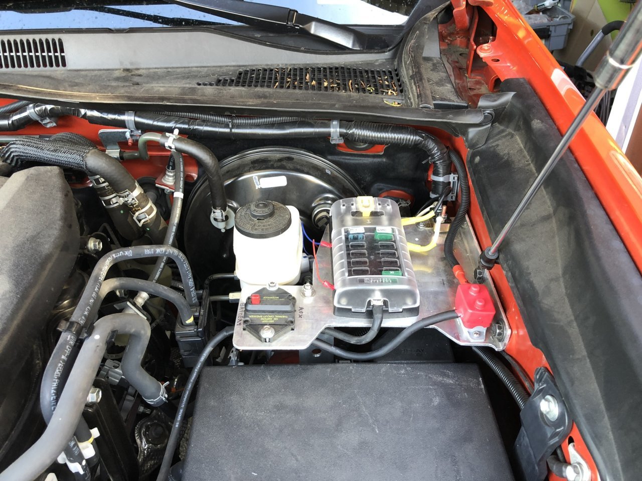

    I made my own bracket that holds 6 relays and the 12 fuse blue sea with breaker. I had to mount it on the passenger side because the super charger doesnt leave much room on the driver side.

    Appears you ran the battery cable in front of the motor on top of the radiator. Is that right?
    Love the set up :cheers:

    That is correct. I just got it all installed last night so I will run my wires that go into the cab alone the factory wiring harness on the firewall and then into the cab.

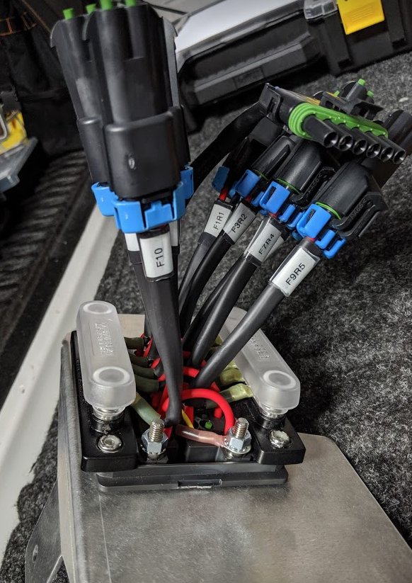

    Posting this here.
    Started with my "temporary junction box" (2 1/2 years temporary!) I have two other wiring locations inside the cab, but this is for my front bumper KC's, overhead Off-road lights, back up lights and front camera connections:
    5 Circuits and 6 fuses with 3 relays. I found a decent enough build it yourself small box: https://www.amazon.com/gp/product/B07MR64XK1/ref=ppx_yo_dt_b_asin_title_o04_s00?ie=UTF8&psc=1
    Untangled the mess from the existing junction box, and soldered up all the connections. Tested it and it all works...good thing I have a meter!
    Made final feed connections, then wrapped, bundled and built a small bracket for mounting the new Relay/Fuse Box:
