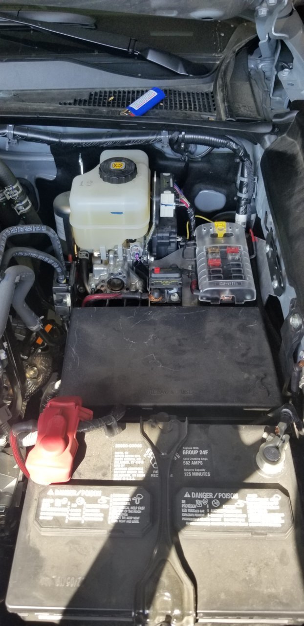

    Thanks Scott - couldn't have gotten this far without your feedback and advice!
    Still a bit to do but definitely coming along now. Rear panel/box is almost complete as well. Need to run the wiring along the frame, maybe tomorrow.
    :cheers:

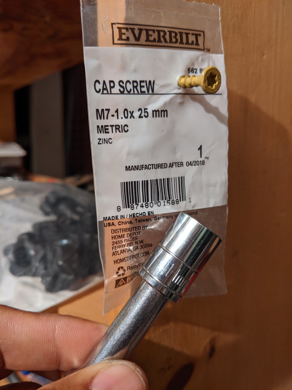

    For anyone that has problems finding the correct bolt to mount your aux fuse plate to the existing holes and M8s don't work, I had to use M7. I'm sure I could find the OEM screws online but until then I had to use these.

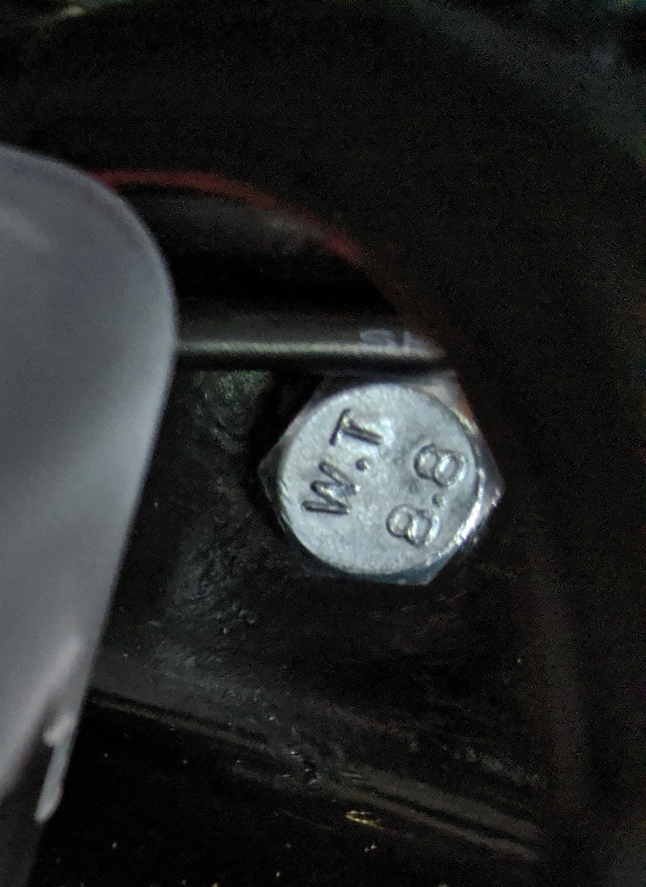

    you sure? i have never seen a m7 bolt used in a toyota.
    it should be a m8 1.25 pitch.
    Stryker420 and shane100700 like this.

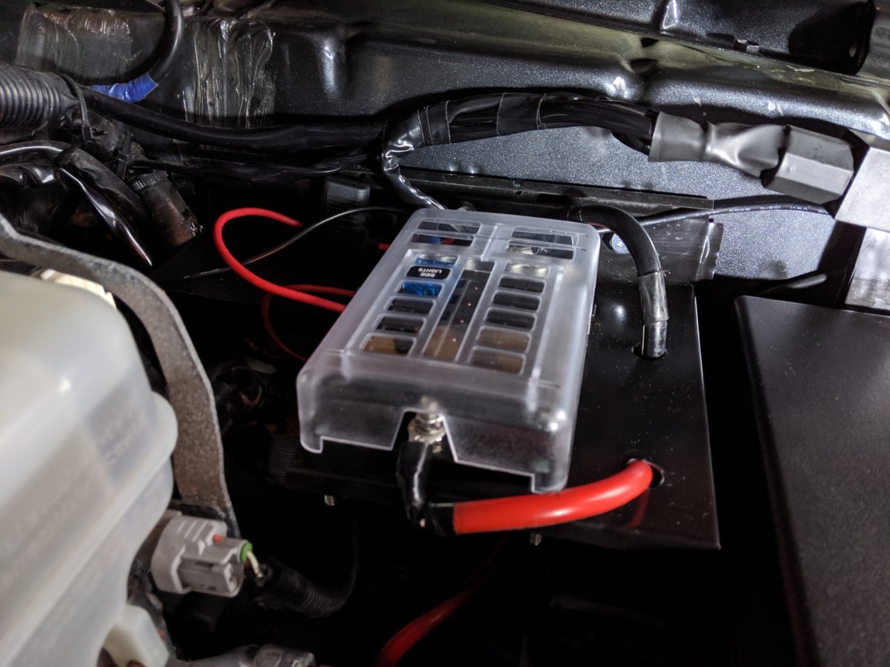

    Just re-wired my panel. Used Paranoid Fab's panel along with CaliRaised's relay holder. I did have m8 bolts holding my panel in but the relay holder came with some Allen bolts.

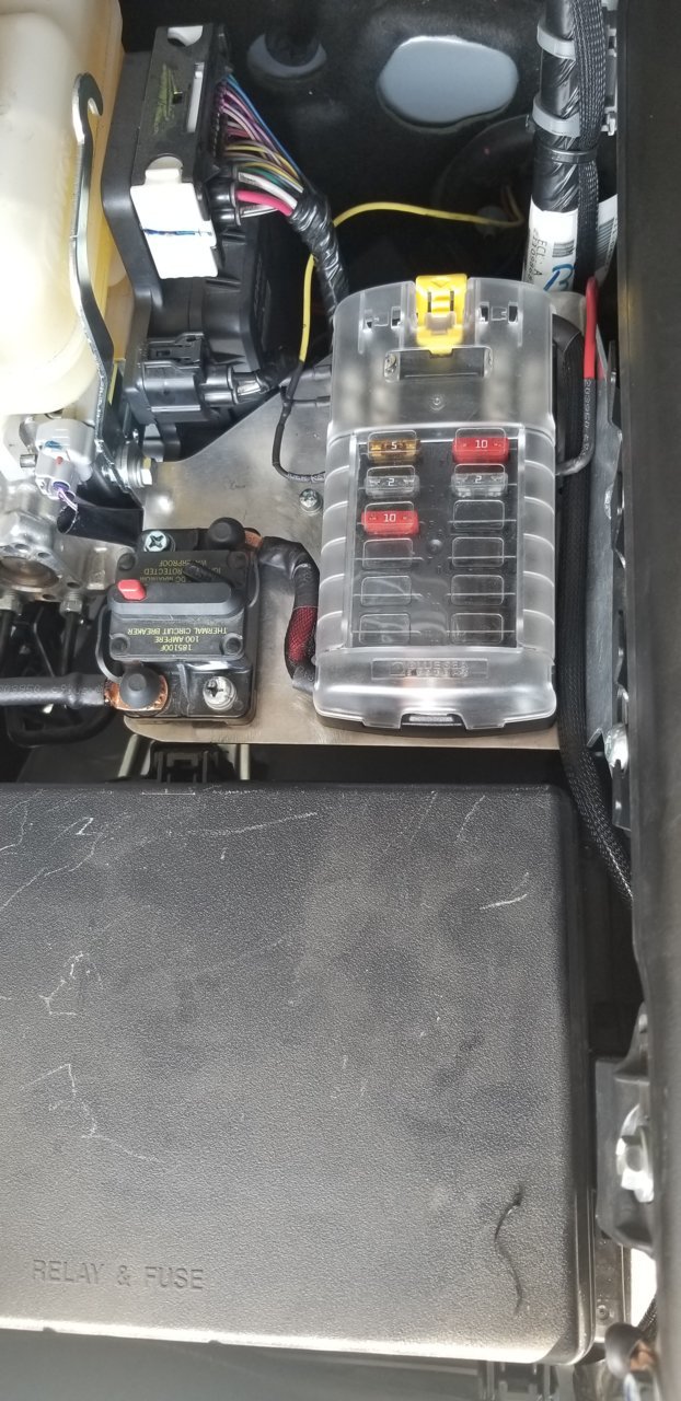

    Got a few things installed. Helped clean up the wiring immensely! Now I just need a 4x4spod and I’ll be set.

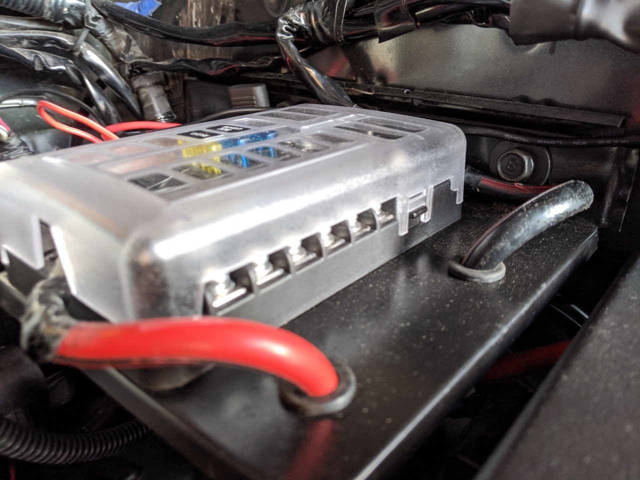

    Posting here: Finished my second auxiliary fuse/relay box today. Same type I used under the hood. Four fuses and two relays gives room for expansion. Under the bracket is my auxiliary battery for my ham radio and an always-on power port in my console.
    This also drives my siren/flashers and the scene lights I installed on the roof rack. Today I completed the bracket and cable management.

    Yeah, the M8 won't fit..I messed with it again last night. The M7 screws in but it's not snug. Weird.
  9. Oct 30, 2019 at 8:11 AM
    #969
    paranoid56
    paranoid56 Well-Known Member
    Jul 25, 2012
    #83443
    3,442
    San Diego
    14 double cab taco
    something is up. any chance you can take a pic of the bolt you used?
    Sasquatchtaco[QUOTED] likes this.

    Yessir... I'll take it apart Saturday night and send you some pics. I wonder if I used different holes? I mean, I think there were only two lol
    I also got some more screws to try. We'll see.

    So I ordered these from an unnamed conglomerate and they worked just fine. I realized that the problem was that the holes were all junky and so I didn't want to damage/strip anything. The home Depot M8 bolts would of worked just fine.
