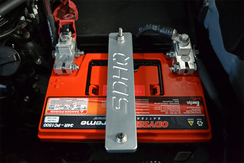

    I'm so new to anything electrical. when you change something like this out from stock do you just clip off the ring connector that goes over the current battery post and just screw them down or connect into the new terminal ? of course taking precautions to use heat shrink and such . also have seen folks doing the big 3 upgrade as well.

    If I went with the exscorpion because my cables already have ring terminals I’d probably dip the B+ terminal in rubberizing compound to make it safer. I’d be worried about a hard plastic cover getting cracked.

    Depends on the connector but in general you need to cut the clamps off the cables and crimp on new lugs. The heat shrink just covers the part of the lugs not covered by the terminal boot.

    I replaced the factory terminals with these Amazon ones about 10 months ago. Haven't had any issues with them.

    yeah im kinda liking these SDHQ terminals. really like the wiring also and guess you'd just upgrade the guage of wire ?

    I've gone through many battery terminals and these are by far the best that use set screws and "sockets"
    https://www.amazon.com/KnuKonceptz-Ultimate-Positive-Negative-Terminal/dp/B00JK9FTLC/ref=asc_df_B00JK9FTLC/?hvadid=312057677264&hvpos=&hvnetw=g&hvrand=7206949418455924540&hvpone=&hvptwo=&hvqmt=&hvdev=c&hvdvcmdl=&hvlocint=&hvlocphy=9028269&hvtargid=aud-801381245258%3Apla-563199249090&psc=1
    I used to have those, once any battery acid or corrosion gets on them you wont be able to tighten them without a sleeve. Notice how the ends are touching where the clamp is?

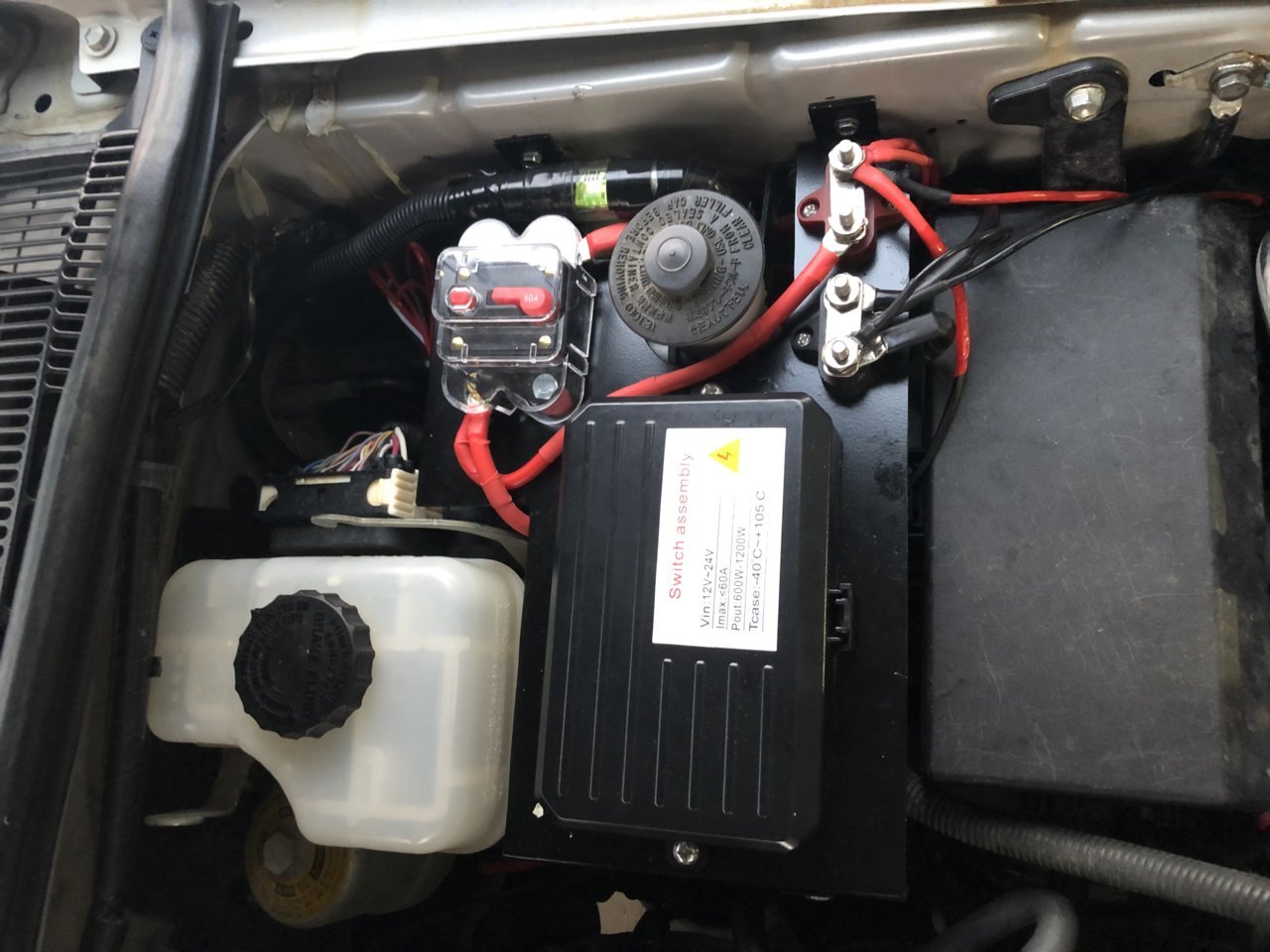

    Swapped fuse panels...
    Went from this...
    To this...
  12. Mar 5, 2020 at 3:51 PM
    #1112
    baldbeardedtaco
    baldbeardedtaco Well-Known Member
    Sep 4, 2018
    #265223
    3,334
    FL
    18 TRD Sport DCSB MGM
    That looks clean! I’d paint the tray personally
    What’s the bigger black cover?

  13. Mar 5, 2020 at 3:55 PM
    #1113
    shane100700
    shane100700 Bed, Bath & Beyond Crawler
    Jun 1, 2011
    #57578
    7,012
    Montana
    2019 DCSB, OR
    Rocket Boosters
    Tray is painted cement, but mine paint is a little lighter then factory or what you get from automotivetouchup.com
    The left is an AMG fuse holder, and the right is the fuse box.
    https://www.amazon.com/gp/aw/d/B001PYSUP2?psc=1&ref=ppx_pop_mob_b_asin_image
    https://www.amazon.com/gp/aw/d/B07MR64XK1?psc=1&ref=ppx_pop_mob_b_asin_image

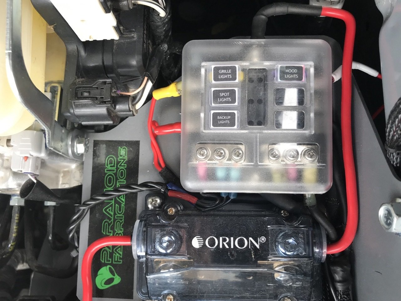

    I installed an 8 gang switch panel from Amazon.
    I decided to fab up a panel to place everything on since having a manual, there is nowhere to use the included mount.
    Take a look at my build page in my signature for more details.

    Nice,
    I suggest safety caps/covers for the positive connection studs. It’s pretty easy to lay a wrench there and get some fireworks.

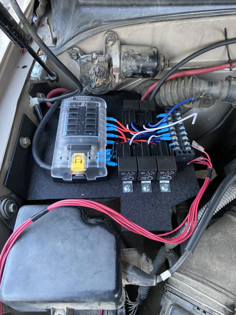

    Threw this together the other week. Wish I had used a one of those waterproof Bussmann boxes :anonymous:
    maybe I’ll re work it later :D

    lol Did the same initially, knowing I’d just end up redoing it.

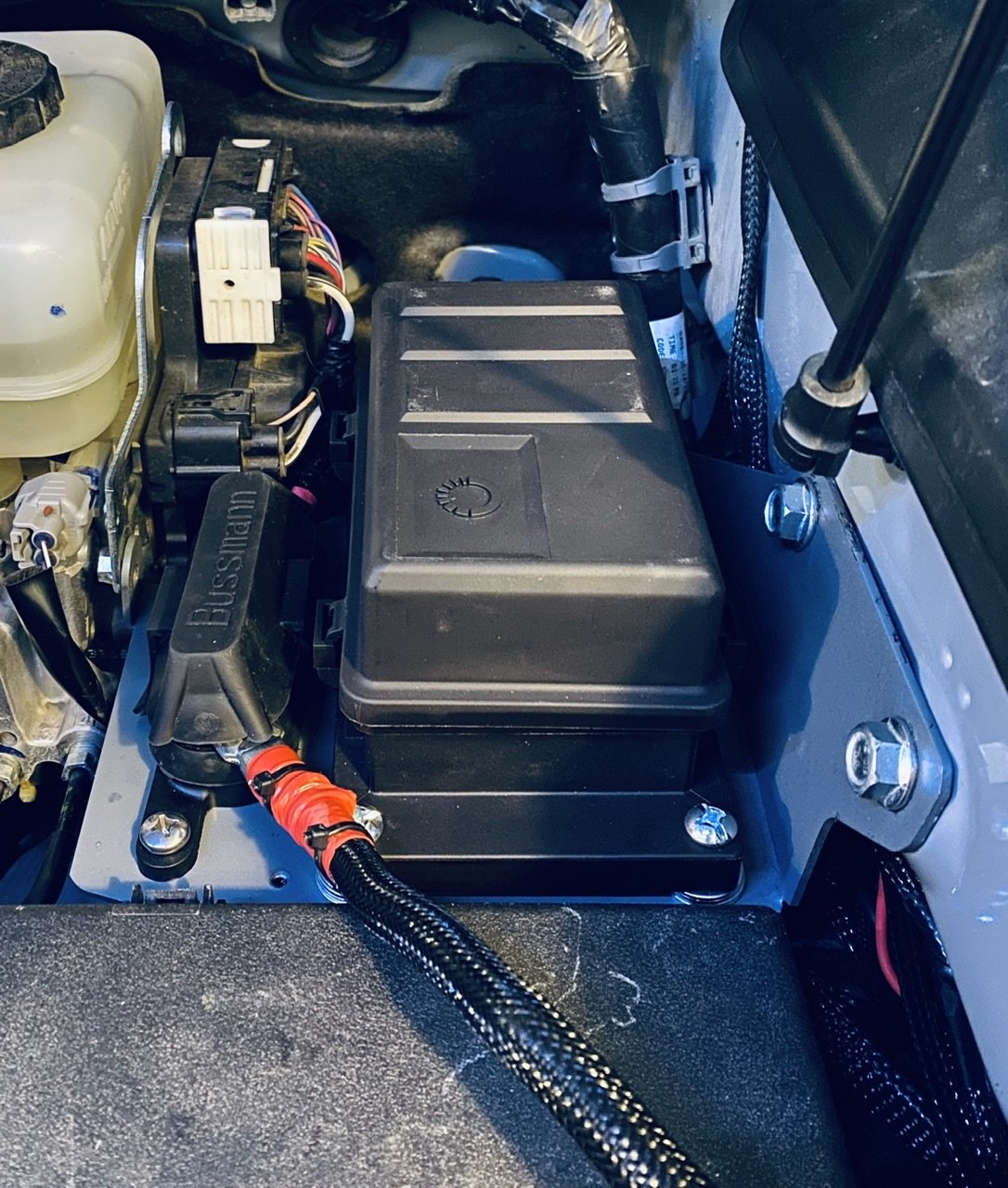

    I just finished mine inside a box and it was a pita but very worth feel better having all the relays and fuses in a single waterproof box. After I got that all mounted and safe. I made a small harness with 6 wires going through the firewall to a custom box I made out of cherry and ended up bed lining it and mounting it where the rear view mirror used to be so all 6 switches are nice and neat in one place. The best part is they're out of the way and in my opinion super clean looking.
