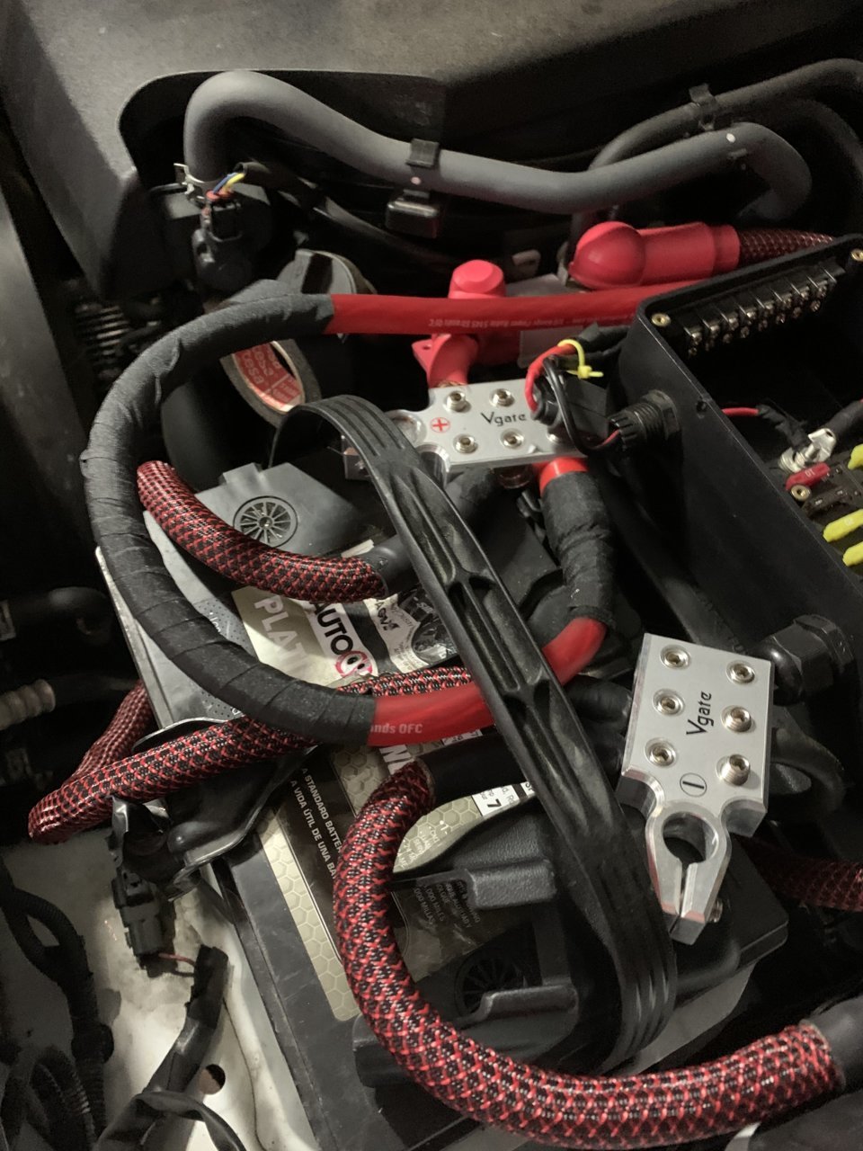

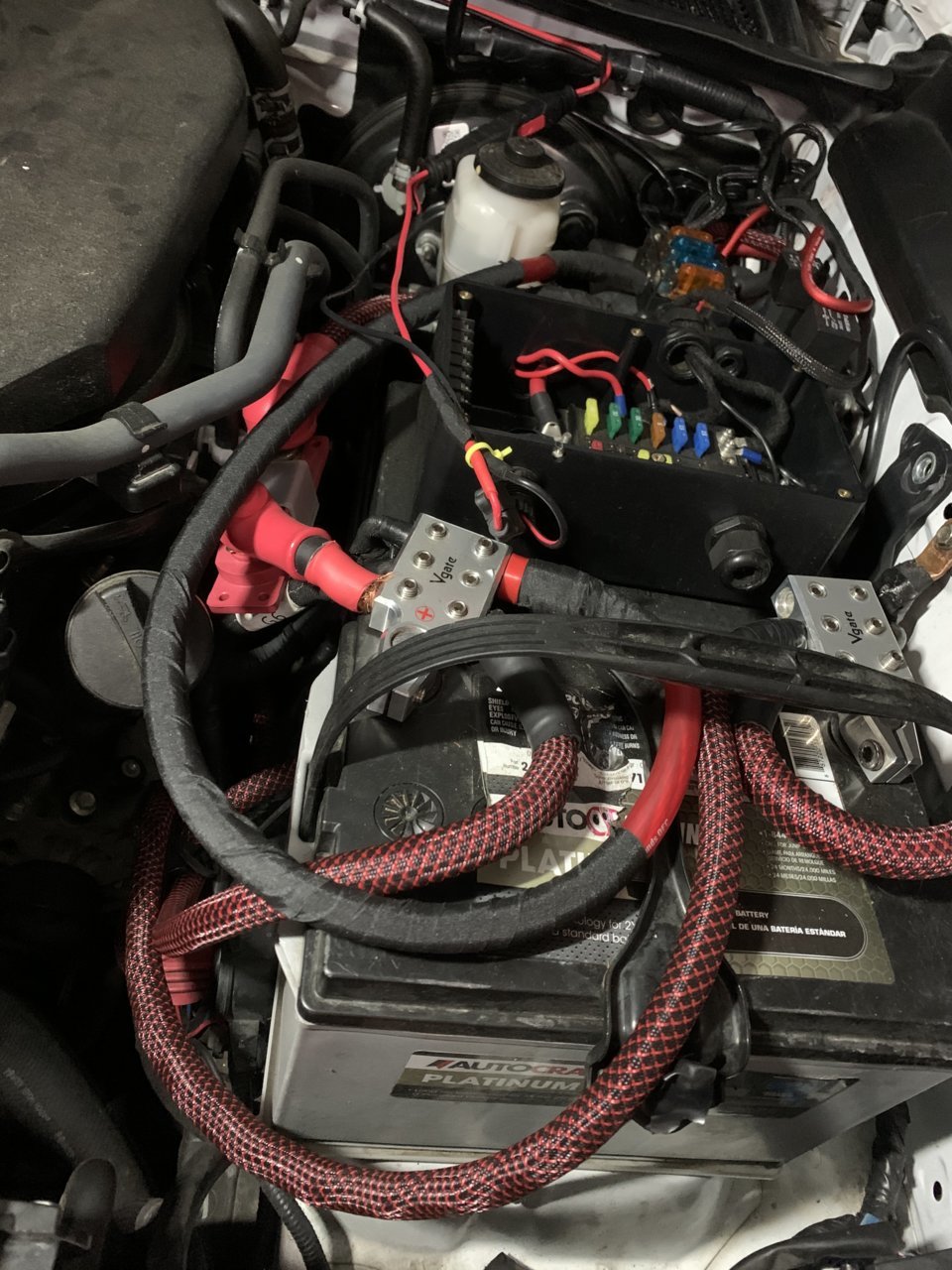

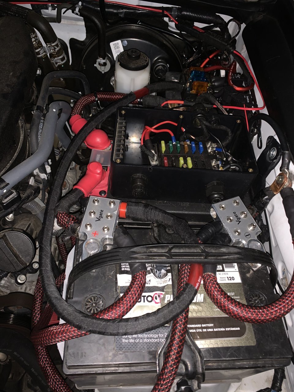

    keep an eye on that battery, that huge positive terminal is super close to the strap and can short out with any moment.

    I prefer using a B+ clamp that has a cover also. The battery clamp and the B- terminal don’t need any clearance at all since they are both at ground potential.

    08241CBF-49F7-4972-8A98-23D0BC14EBBA.jpg Good eye @paranoid56 put 3 layers of Tessa tape and electrical tape over the shielded ferrule and adjusted that terminal and gonna put another ferrule on the other side running to my fuse holder as well tomorrow

    Why such huge-gauge cables to everything? Not a criticism, just curious.:notsure:

    Lol I guess it’s my overkilling of everything plus my ocd liking everything to match up. It was all 2/0 welding cables but I’m slowly getting those out with 1/0 gauge ofc bc the more I’ve listened to my system since changing to ofc the more of a believer in them I am. Also most of my audio equipment is located under the passenger seat and behind passenger seat rear so they’re a pretty decent distance from battery. My amps call for 4 gauge so I’ve got them running to 4 gauge fuse holder then run is completed to battery with 1/0. I also did a big 4 upgrade and just used same size cable for that. As far as the big terminals go they’re very high quality terminals and only ones I found that would hold 6 1/0 gauge ofc wires on each. If you notice I do still have 1 8 gauge wire mixed in there and it’s about to drive me nuts. I’ve been bored not working and just something fun for me to do lol I have no life man. Just me and the kids here and not anything we can really do outside of home and I’ve ran out of things to do around the house

    Not to criticize but you could have a lot cleaner and more organized wiring with only going as large as you need to.
    If you want to keep it all that gauge of wire, you might be best off with a distribution block for both positive and negative power. It would make chasing down wiring issues and getting to things around the battery much simpler.
    Again, not trying to criticize, it just looks like a lot at first glance.

    I’ve actually got everything grounded under the passenger seat as a master ground. I may eventually pull all my seats out and rerun all my wiring. I’ve actually got a bigger negative/positive fuse block I intended on using at one point but I couldn’t get it to fit very good. It’s identical to the audison connection fuse block but it’s a Japanese brand for a third of the price. Appreciate the feedback and constructive criticism is always welcomed here. Learning each day and I’m definitely not a pro at this. A lot of the clutter was when I first began the wiring and knew nothing about it a few months ago when installed light bar and leds so yeah it’s the sloppiest of the bunch. All the big gauge you see at the terminals are extra grounds I’ve done and or part of the “big 3“ upgrade. I’ve ran a few more grounds that are on the other side of the engine too lol with 4 gauge wire
