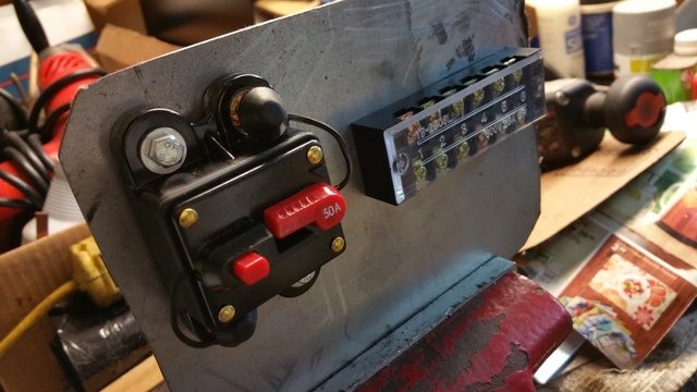

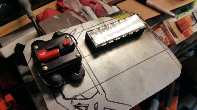

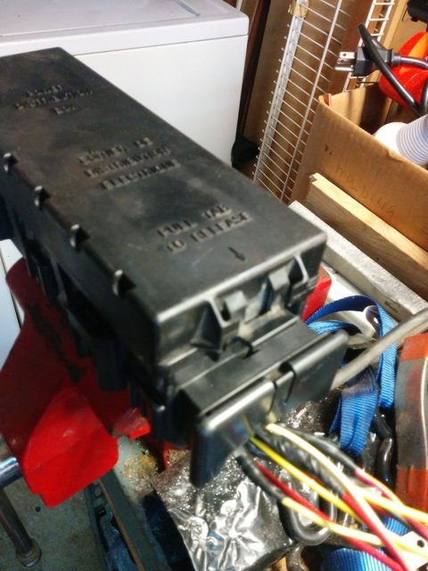

    Started making my auxiliary fuse box platform today.
    Trimmed down to size..but the mounting end isn't tall enough, as I would like it to sit lower.
    Platform is made from a heavy duty steel shelf.
    A few spot welds and paint left to do, and call it good...I think :)
    May play around with mounting straight to the wheel well.

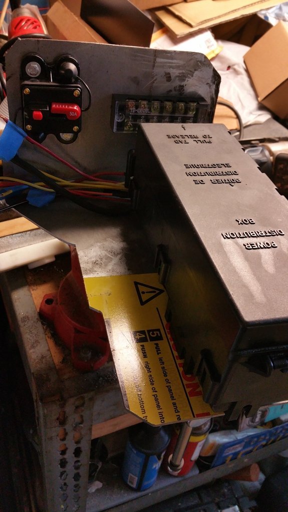

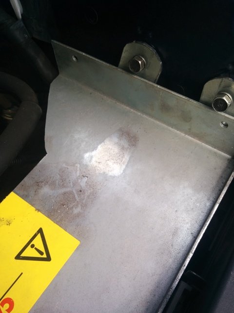

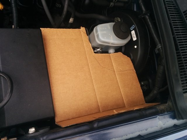

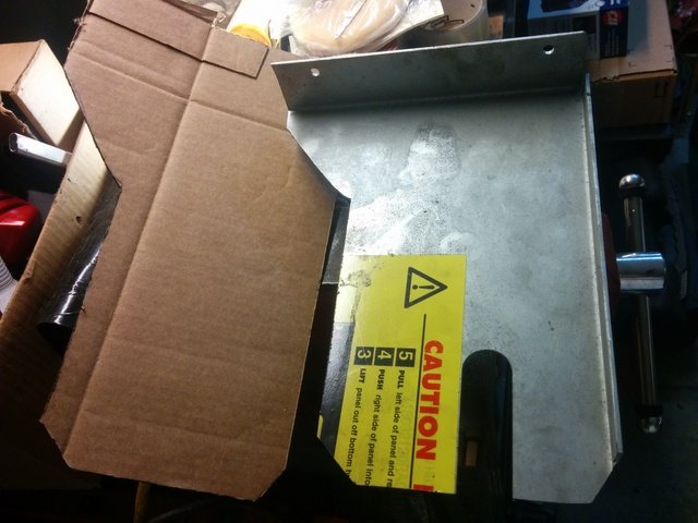

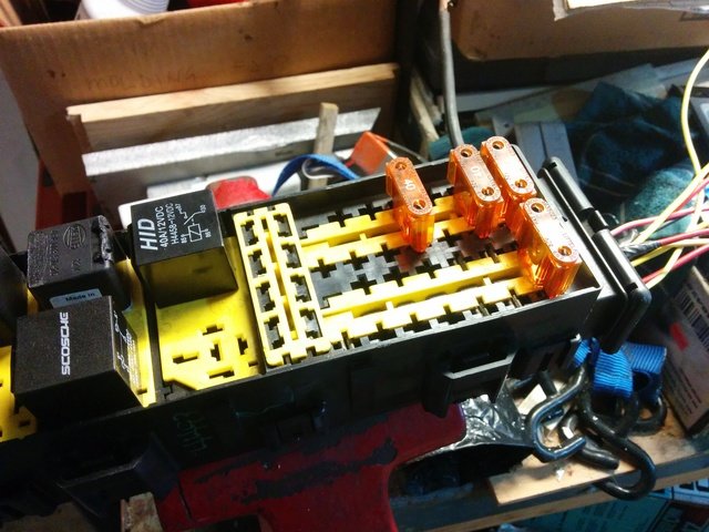

    More progress on the auxiliary fuse box mount.
    Will weld both plates together (and paint), but this is the idea I was going for.
    Need to verify fit on the truck (which is at the shop this week) for final fitting.
