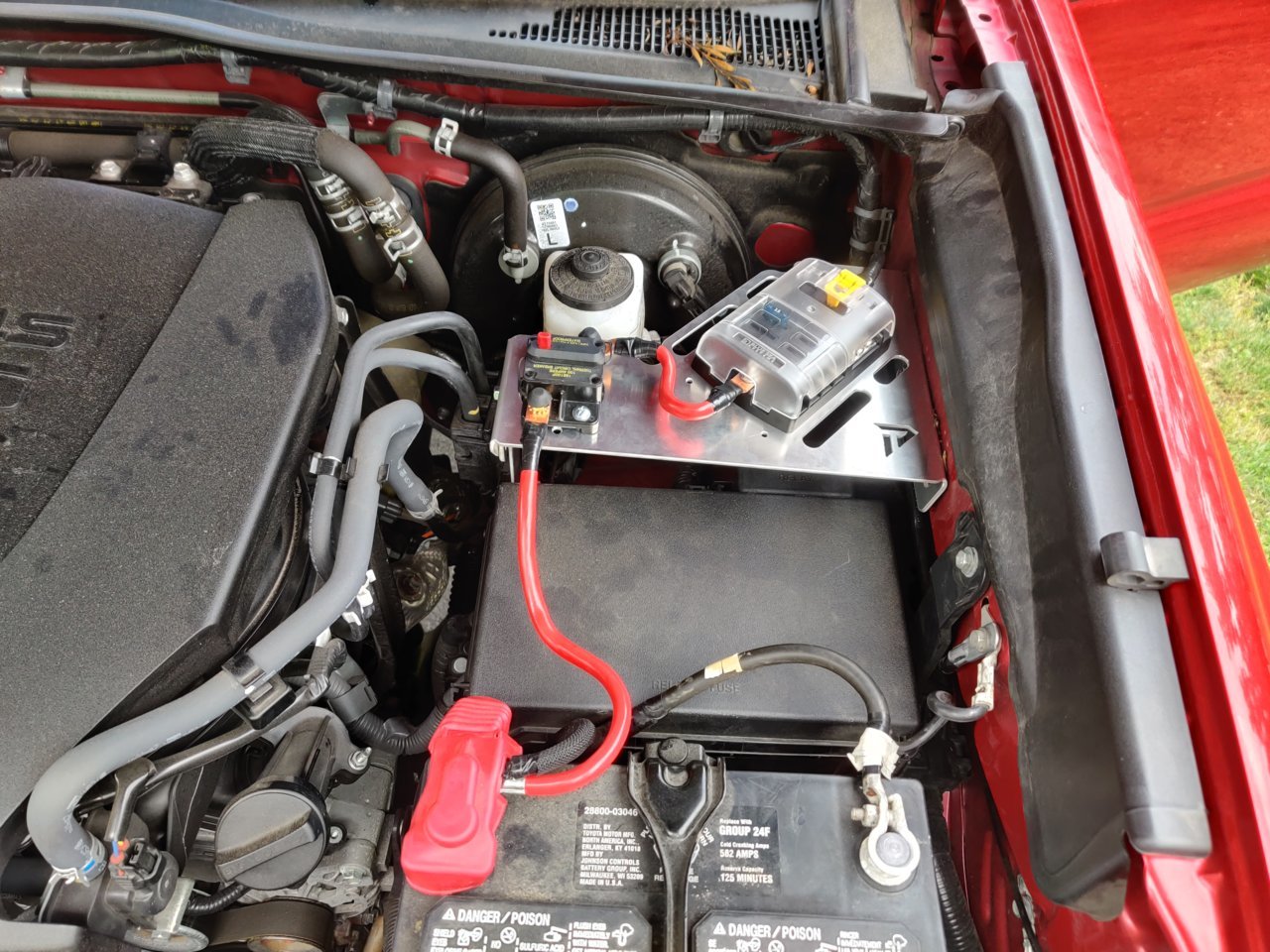

    Finally got this guy installed. Now just need to populate it.

    now to also figure out how to wire it all into the truck
    :rofl:
    looking good there bud! What wires are you running and how big is the breaker?

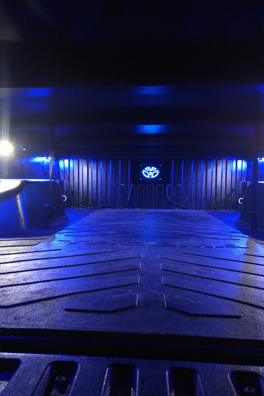

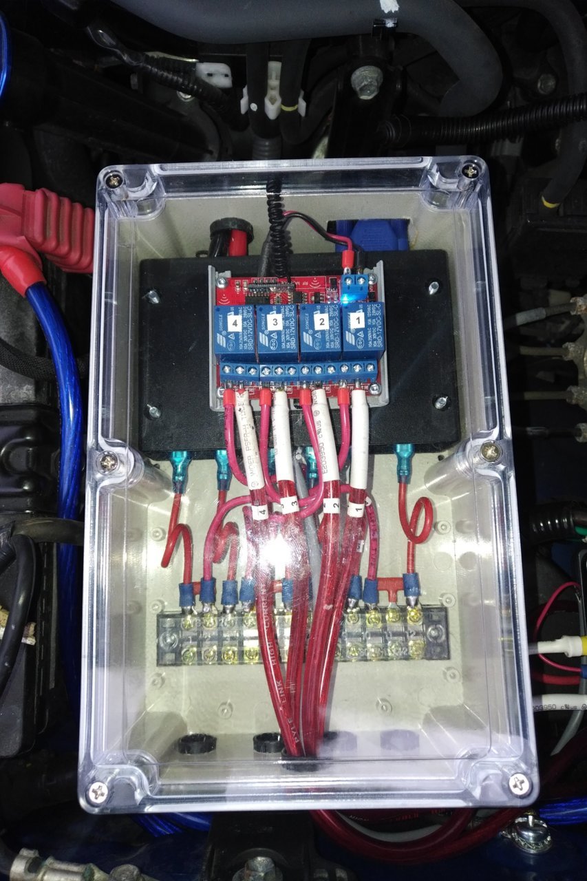

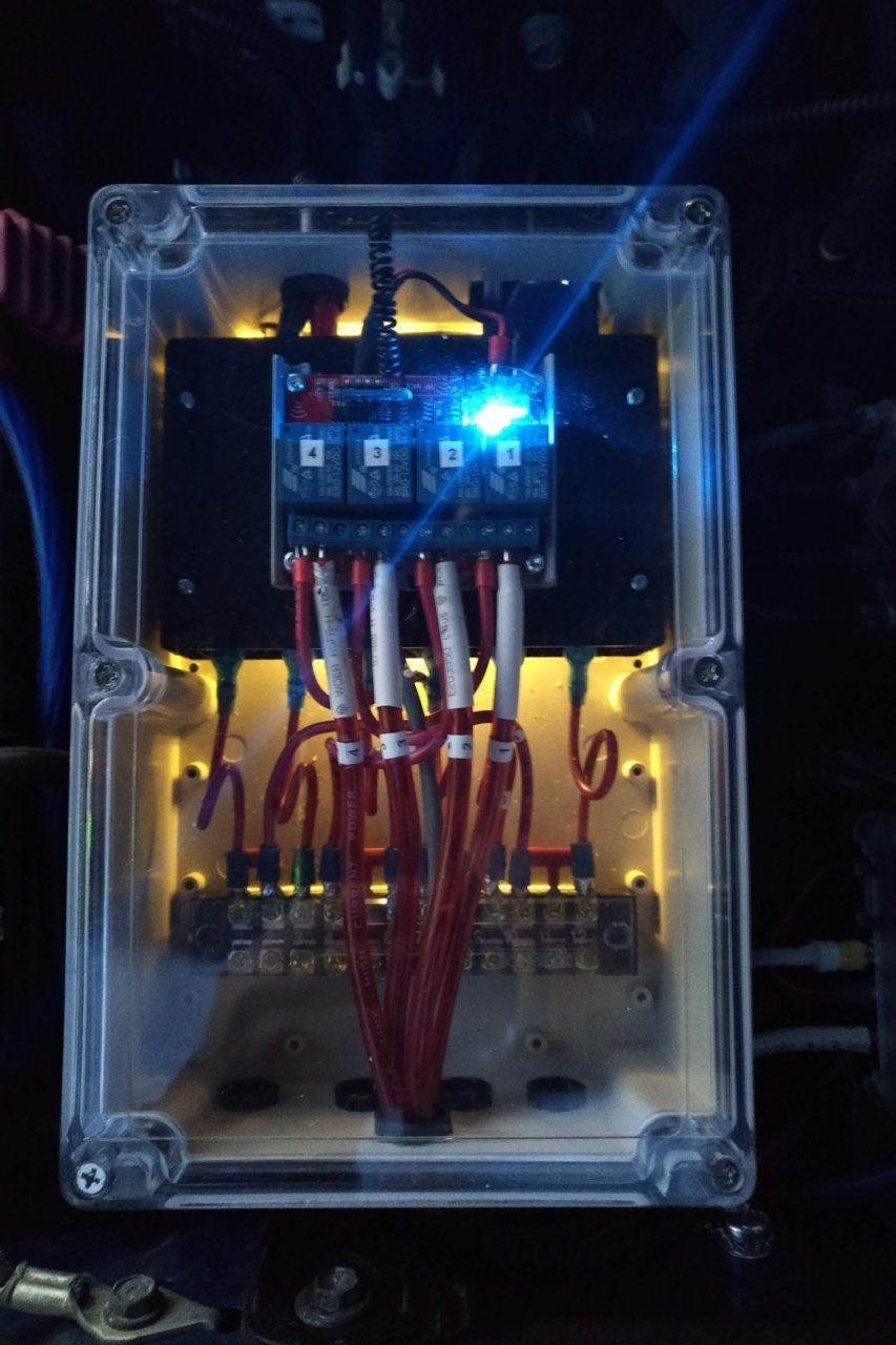

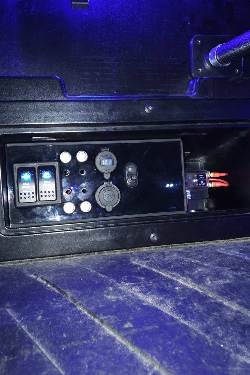

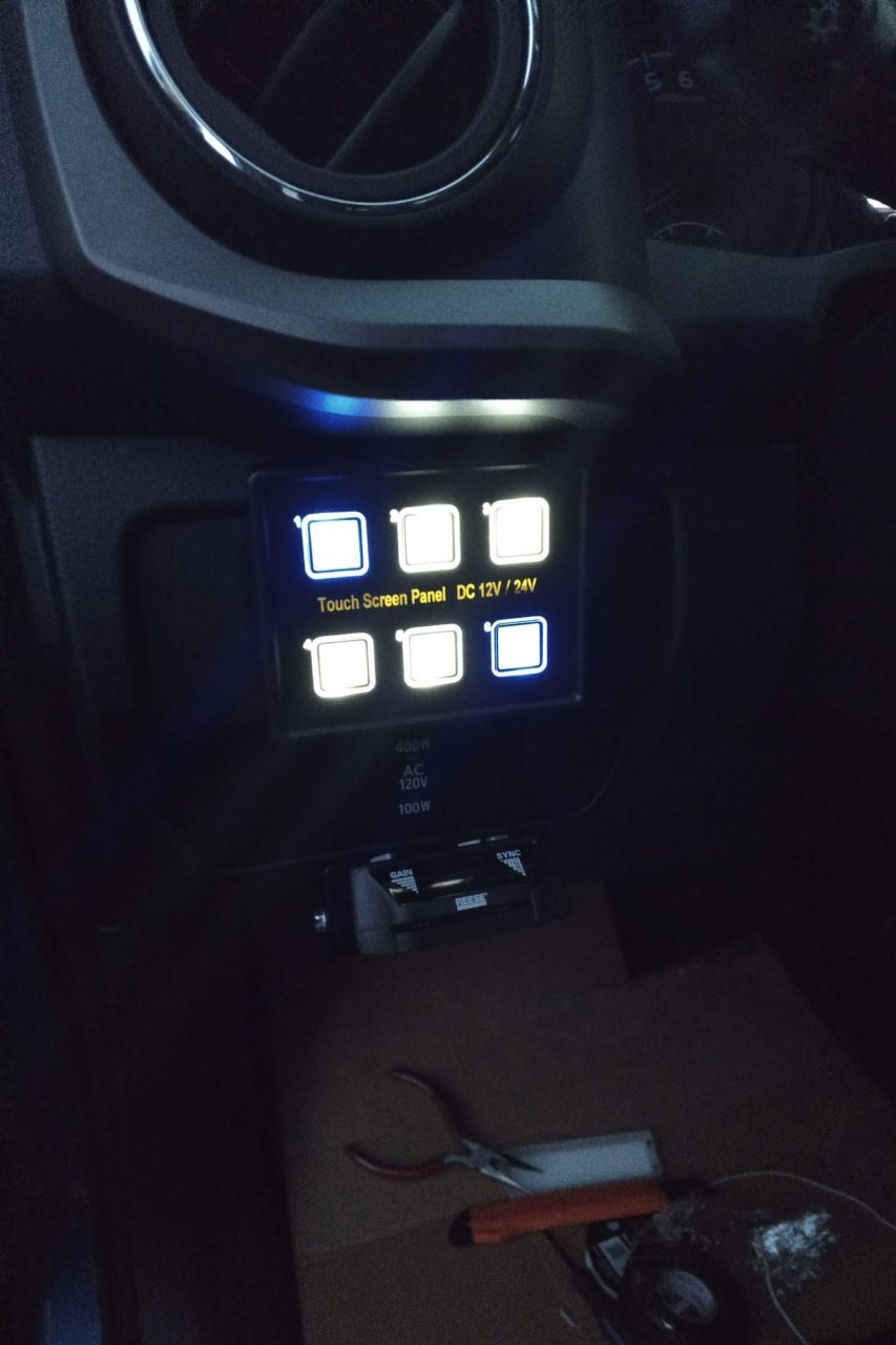

    Just stumbled across this thread. So here is what I built.

    Clearly you’re not a novice to wiring, just a word of warning though. Those led fuse blocks sometimes pass power even without the fuse.
    If you haven’t tested for it yet, might be worth it. I pulled the led circuit board out when I had one like that to make it impossible to pass power. The one I had, basically defeated the purpose of the fuse but worked great with the led board bypassed completely.

    Understood.
    I have had no issues so far with fuse block. To be on the safe side I have a relay that powers the the 6x relay(black box inside the project box) only when the AUX is turned. The 4x relay(blue relays inside the project box) is powered from the battery. Note, it is wireless so I can turn on lights while outside of the truck.

    2019 DCSB, OR
    Rocket Boosters
    Yeah I think I remember you posting that somewhere else. It’s a great looking system! I just try to send a warning anytime I see those led fuse boxes. I’m sure 99% have no issues but it’s too easy to test proper functioning to not throw a word out when I see them.
