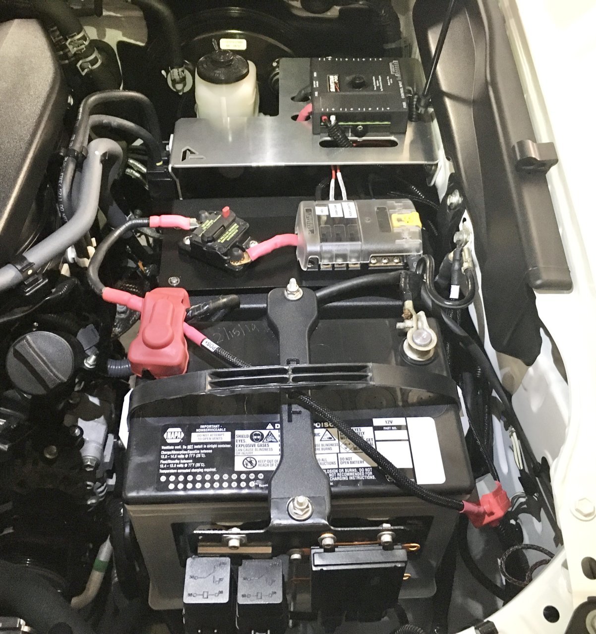

  17. Jun 7, 2020 at 4:13 PM
    #1217
    Kane50
    Kane50 Well-Known Member
    May 11, 2016
    #186700
    187
    2016 TRD Sport
    Moved aux panel over the fuse box and added SPOD Bantam.7CBDA07E-907B-4AC4-9EF9-5D05CBAE345D.jpg
