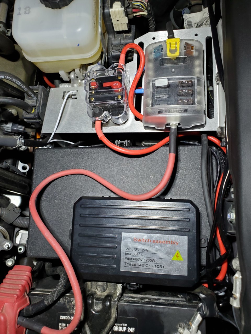

    In that case I would upgrade to 4 gauge eventually. Same for ground if you are bringing back all the "-" to the distribution block.

    Minor stuff.
    I can actually do that. Thanks for the advice. Much appreciate.

    Yeah that ham radio is probably supposed to be in a 30a fuse. So with all those there you've probably got a somewhat decent draw. Haha

    Never be afraid of the math. Add up what everything on comes to, then run a wire gauge and circuit breaker/main fuse to match the total load. The gauge @oostroma is recommending is likely correct BUT without the math, we are all only guessing here.

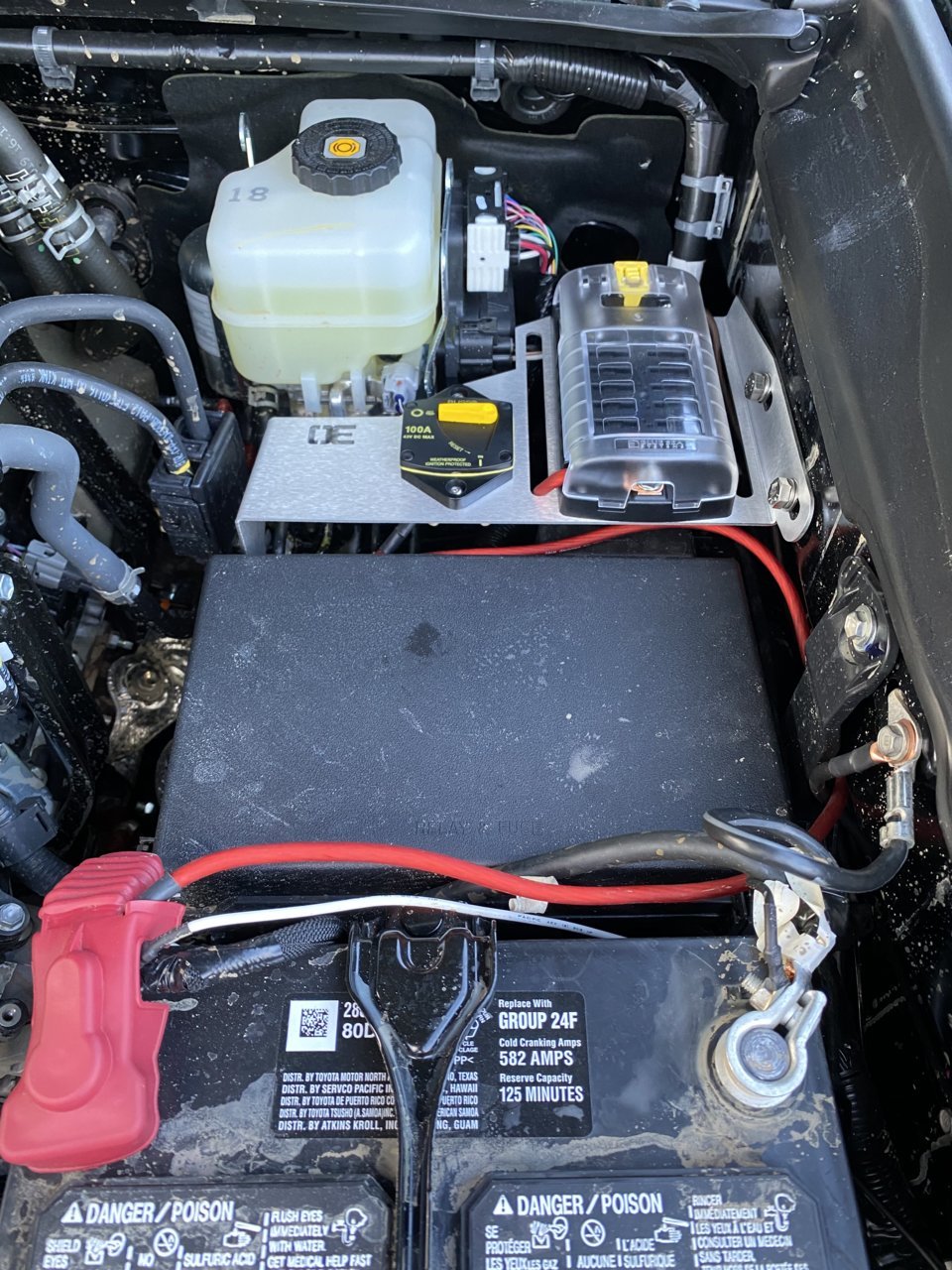

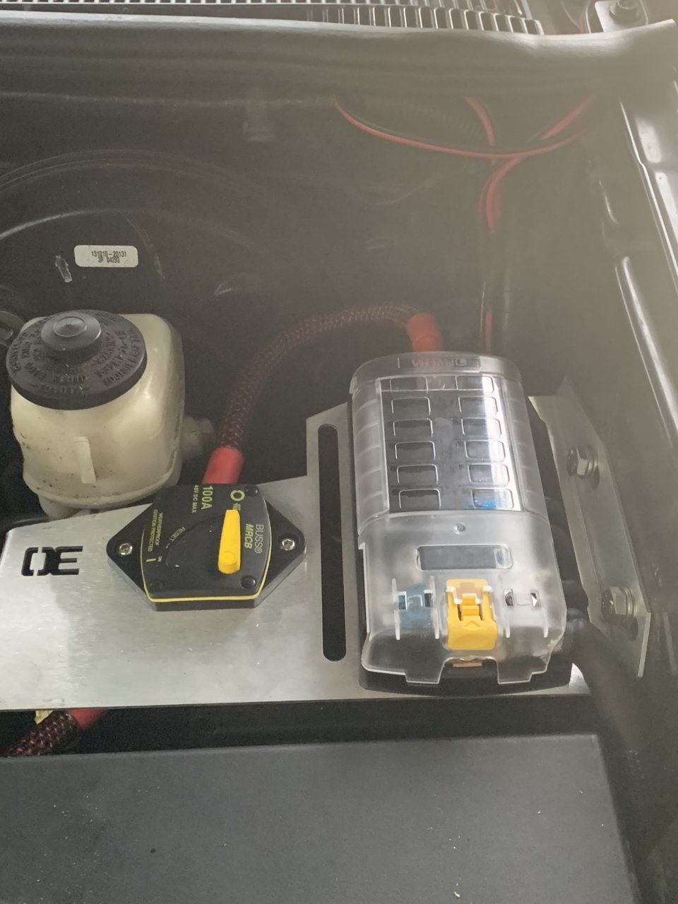

    Took few re-configurations. Think I'll be happy with this layout for a while. Lately, have been thinking about moving the aux fuse panel to the bed. Not sure what I would exactly use it for yet.

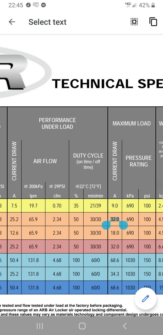

    Is anyone here powering an ARB single compressor off their fuse panel? I have the Overland Equipped fuse panel ordered and plan on an ARB single compressor in the coming weeks. Per the ARB chart, the max output of the compressor is 32 amps, though it says under performance output it is 25 amps. The Blue Sea fuse block only allows 30A fuses per circuit, would I be fine running a 30A fuse?

    I’d suggest #10 wire and a 40A fuse. I use these as fuse holders
    https://www.amazon.com/JooFn-Waterp...HBNQGPX8F0Y&psc=1&refRID=VBT2VRM6RHBNQGPX8F0Y
    since they have a fitted cap with a fastener hole. Any extras you have you can order matching male connectors from customconnectorkits.com and have everything rated 40A or better. I believe these connectors are rated at 46A. It also allows headroom for an upgrade.

    The Blue Seas fuse block says it is only rated to a 30A fuse per circuit.

    I called ARB today and they said that their single compressor actually draws upwards of 38 amps and they recommend only hardwiring to the battery. Just in case anyone cared.

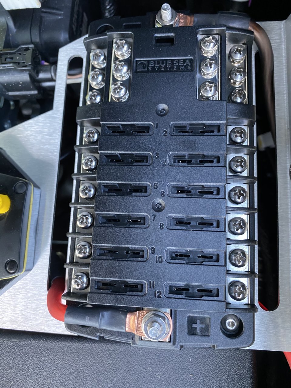

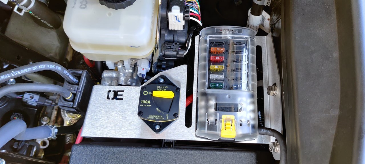

    Just put this in. The OE panel seemed too close to the wires at the top, so I trimmed and filed the panel to leave room.

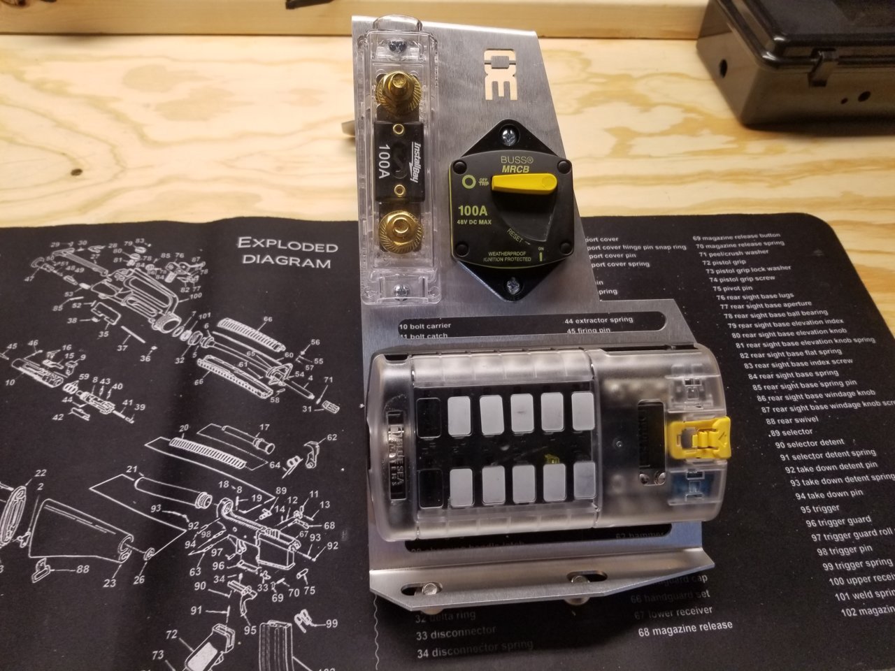

    Looks good.

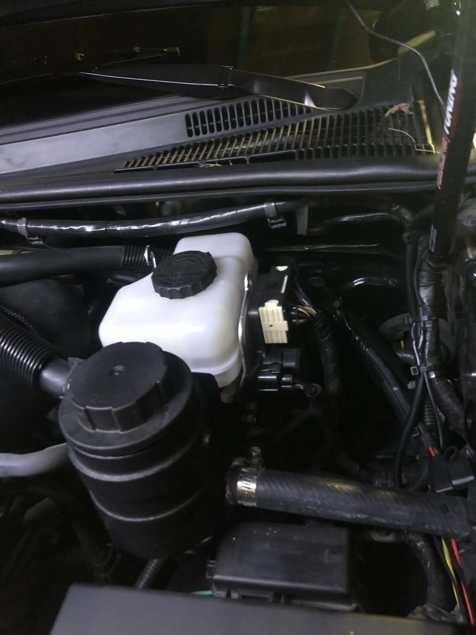

    I’d really like to get one of these Overland setups, but my supercharger intercooler reservoir is right in the way. Anyone ever deal with this? Suggestions?
