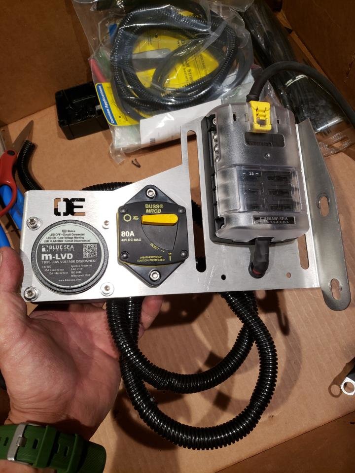

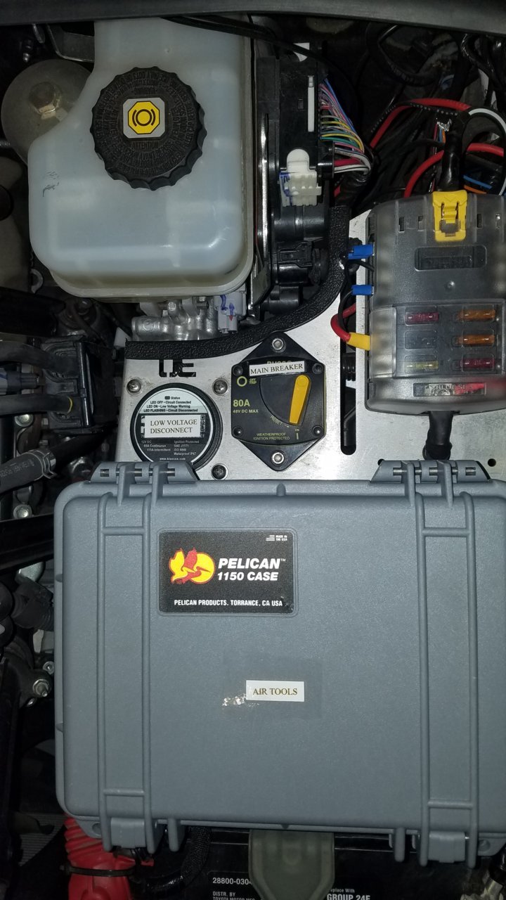

    Did you use a hole saw to allow space for the low voltage disconnect? I did not see a panel on there website that had a cut out like that. I have been looking into this same set up, but was trying to figure out how to integrate that low voltage disconnect.

    we can do custom cutting for you with our brackets. I would just need to know the dimensions. also, we are like half the cost lol

    I'm waiting to hear back from my electrician brother, but I'm pretty sure he used a hole saw, but there is a chance he may have used a large punch. If you decide to go my route, shift the LVD as far back as possible so it doesn't overlap the OEM fuse panel cover. And, be sure to take care with the brake booster wires if you use the OE bracket.
    Paranoid bracket is here if interested, but I personally can't confirm fitment with the LVD, breaker, and aux fuse box.

    yea for that hole, i would use a holesaw of the proper size. would be easy to do since its alu.

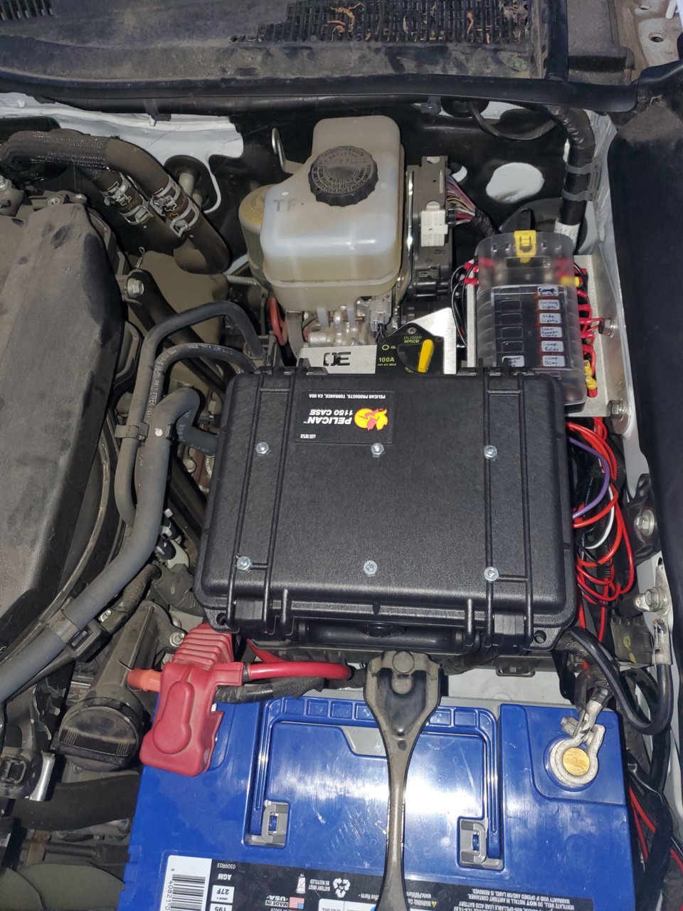

    Just confirmed that my brother actually used an electrician's knock out kit to make the hole...
  14. Nov 5, 2020 at 11:44 AM
    #1314
    RyanDCLB
    RyanDCLB Well-Known Member
    Jun 13, 2019
    #296235
    3,544
    4/19 DCLBOR

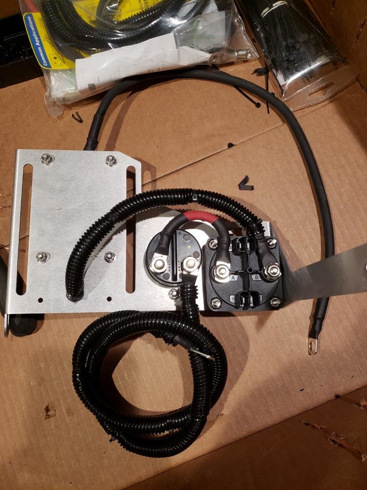

    Updated pic with the pelican case mounted as seen here

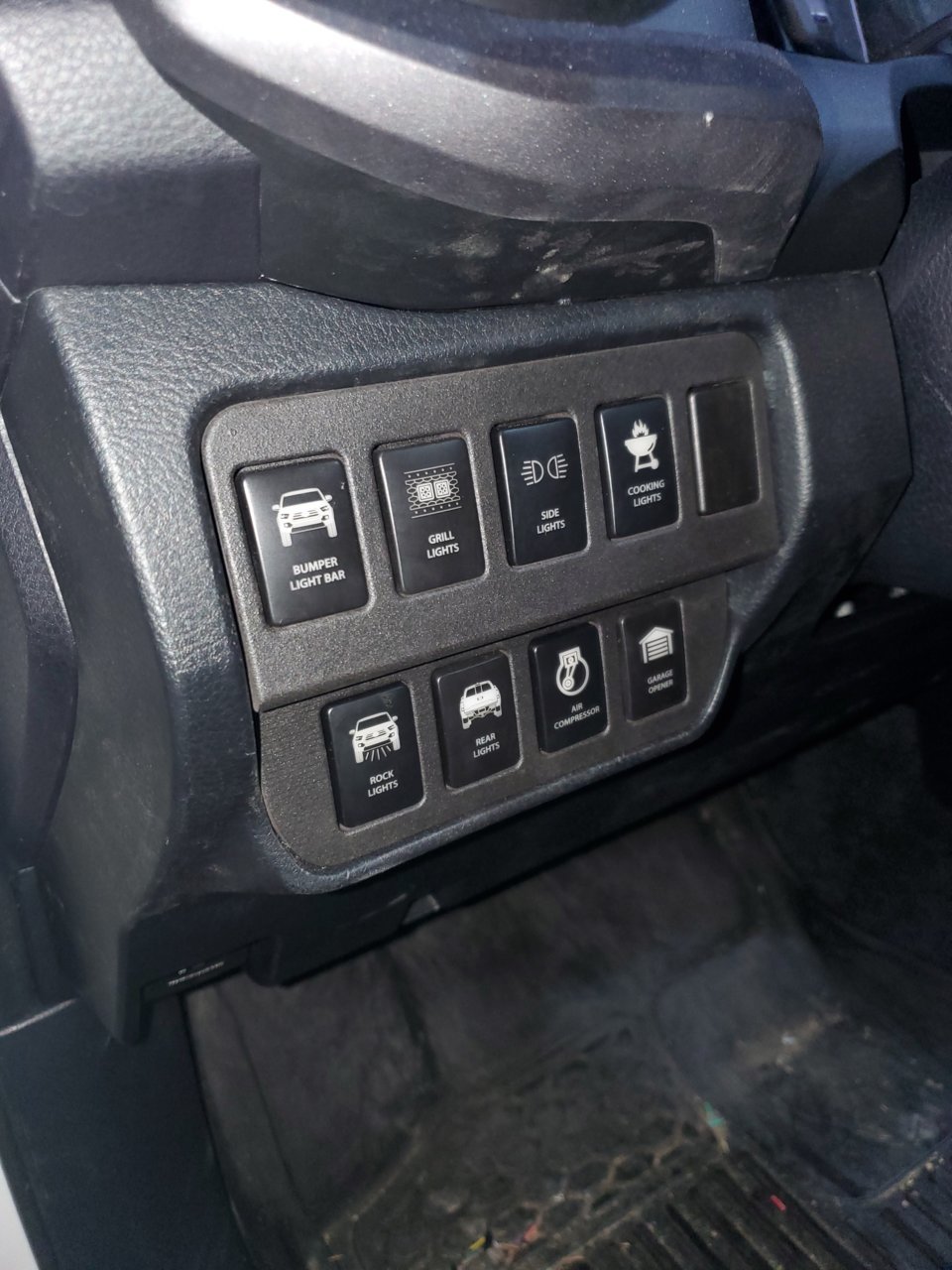

    Where did you score those dual-switches?

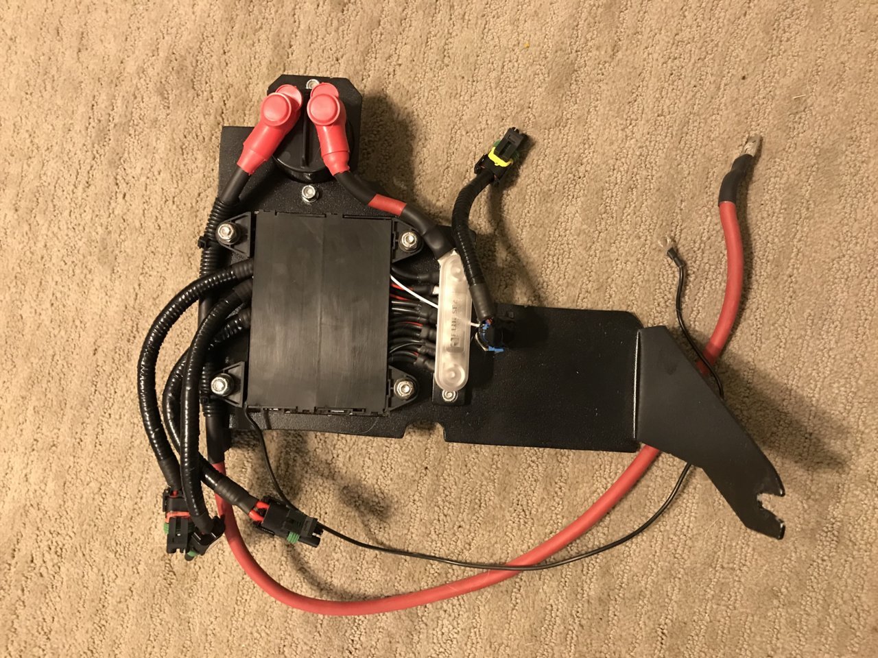

    leaving her pretty much stock, installed a sick aux fuse/relay panel
    Hey all, long time stalker, 1st time poster. thanks for the info and inspiration , just wrapped up my design, layout, and wiring. Will be installing tomorrow...

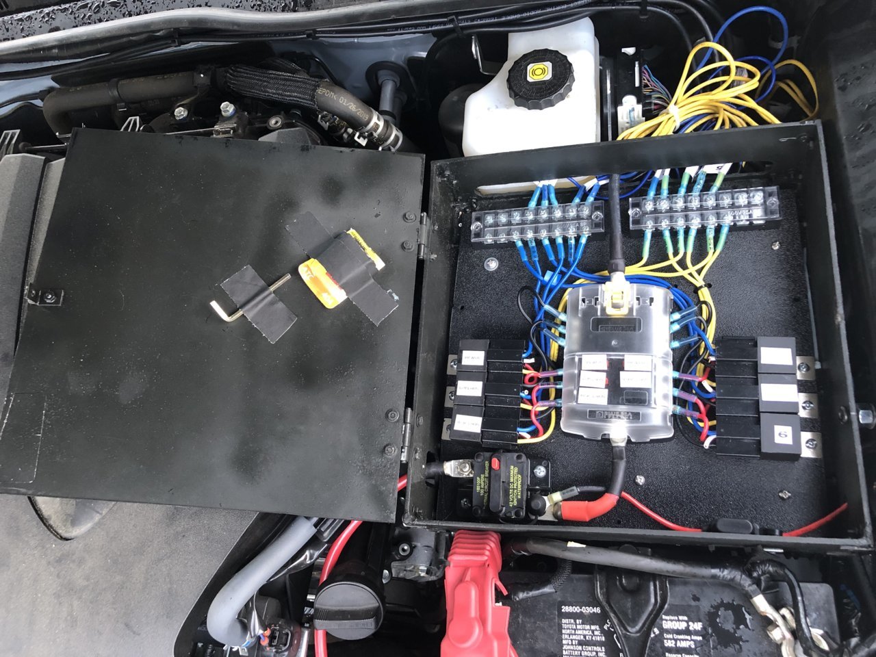

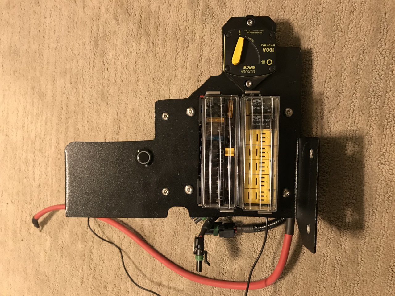

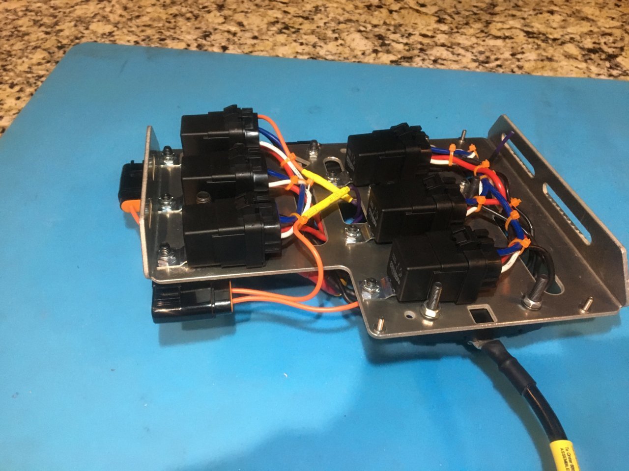

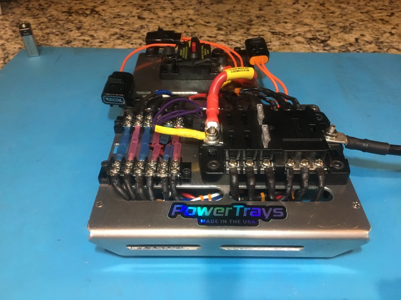

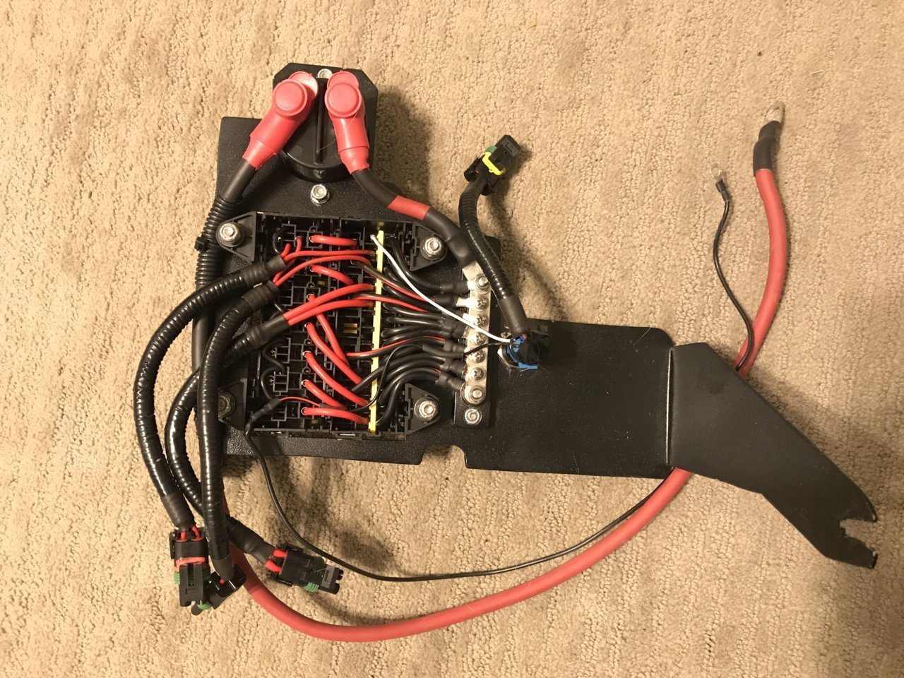

    I finally got around to finishing my aux fuse/relay panel. I decided to go a slightly different direction than most and designed my panel around a MTA 16 fuse block and MTA 7 micro relay block. These two blocks are designed to clip together. I cut the panel itself out of a 2mm thick aluminum sign sheet using a jig saw and bent it to shape using a vice and a rubber mallet. The entire panel is protected at the battery with a 100A Blue Sea terminal fuse and then at the panel with a panel mount Blue Sea 100A breaker. These stud covers help keep everything protected and add a nice finished look. I used a Blue Sea buss bar to distribute the power to the 16 fuses which then either go to one of the relays or directly to an accessory via waterproof connectors. For the grounds I added another Blue Sea buss bar next to the battery that ties directly into the negative post on the battery. The button on the left of the panel controls my under-hood light and illuminates when the truck is on. Overall I am very happy with how it turned out. I am currently only utilizing 6 of the fuses and two of the relays but I have plenty of room for future accessories.

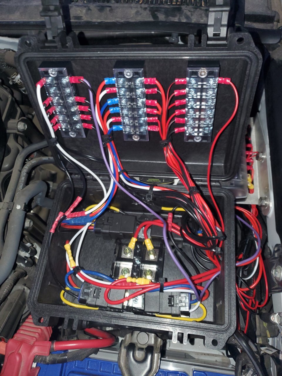

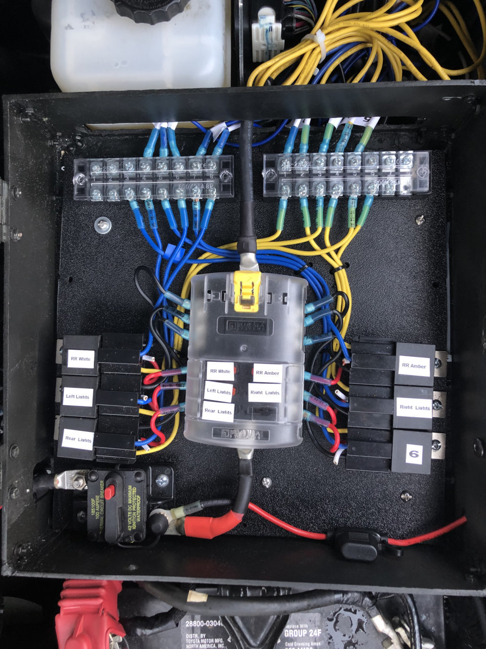

    I'm excited to finally add to this thread! It's still a work in progress and any input is appreciated. I have more lights coming in so I still have some wire to run to the terminal blocks on the pelican case. Everything will get cleaned up then. I still need to figure out labeling too. What do you guys use for labels?
