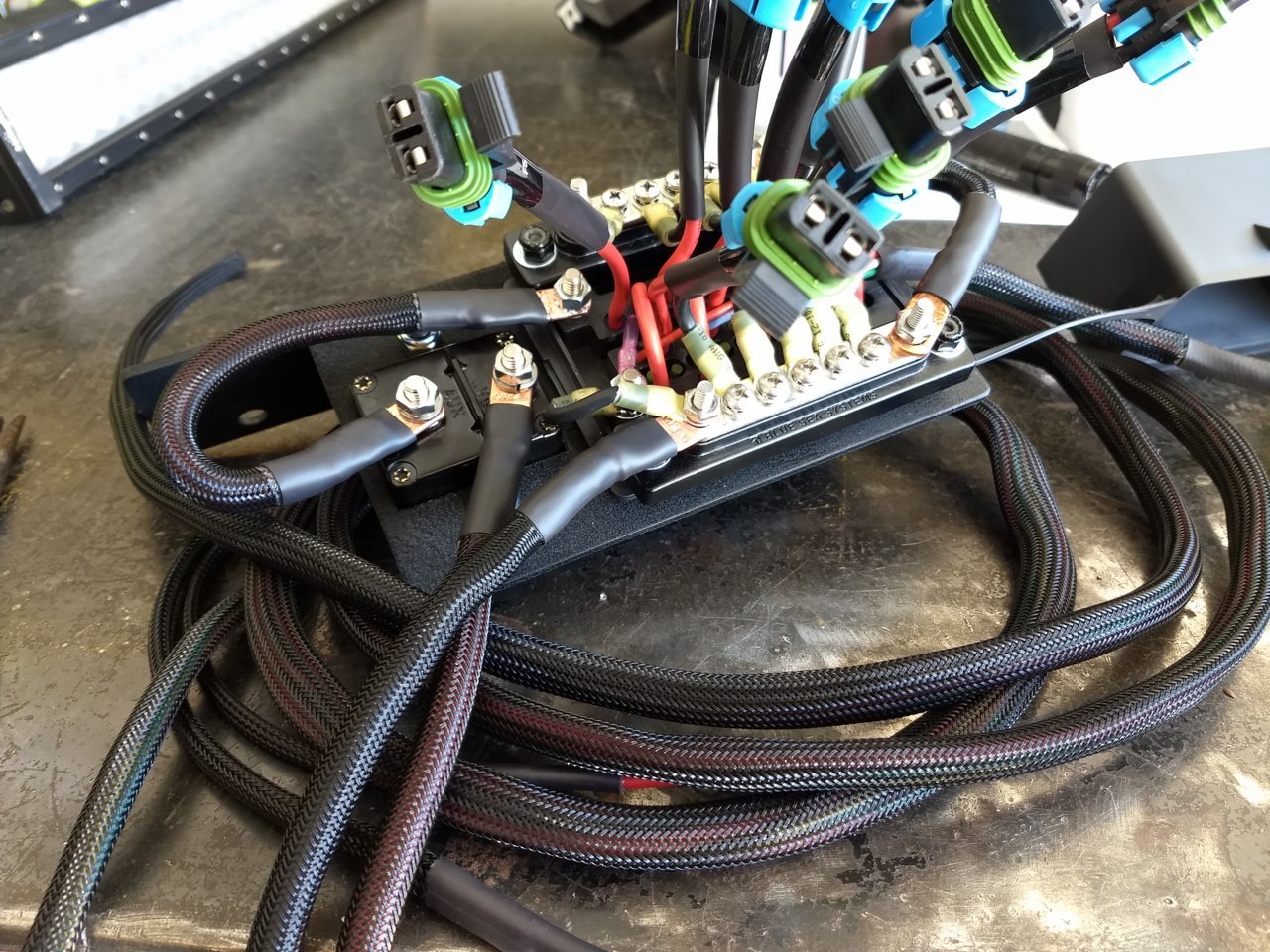

    Are you making those power cables yourself or are they available to buy from somewhere? They look excellent.

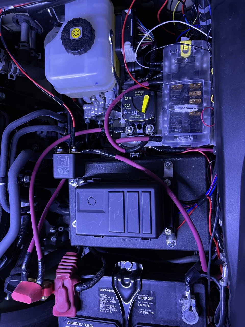

    How did you wire the switched positive into the Blue Sea? I figure 24/7 is just off the positive terminal of the battery, but switched seems more mysterious to me.

    According to another member the panel is 24/7 since I’m coming directly off the battery terminal to the fuse box. In order to make the fuse box power come on with the truck I have to add a high amp relay. I ordered one off of Amazon. Once it gets here I plan to wire it up after my circuit breaker and use an ignition only fuse in the cabin trigger the relay. Here’s a pic of the relay I chose. The battery terminal wires connect to a set of studs and then there’s a ground and an ignition trigger stud. After doing some more research I learned that there aren’t any real usable fuses in the engine bay that I’d be comfortable using that are ignition only. So I plan to use the either the usb fuse or the power outlet fuse or anything that doesn’t turn on when the truck is off inside the cabin fuse box.

    I made them myself, thanks!

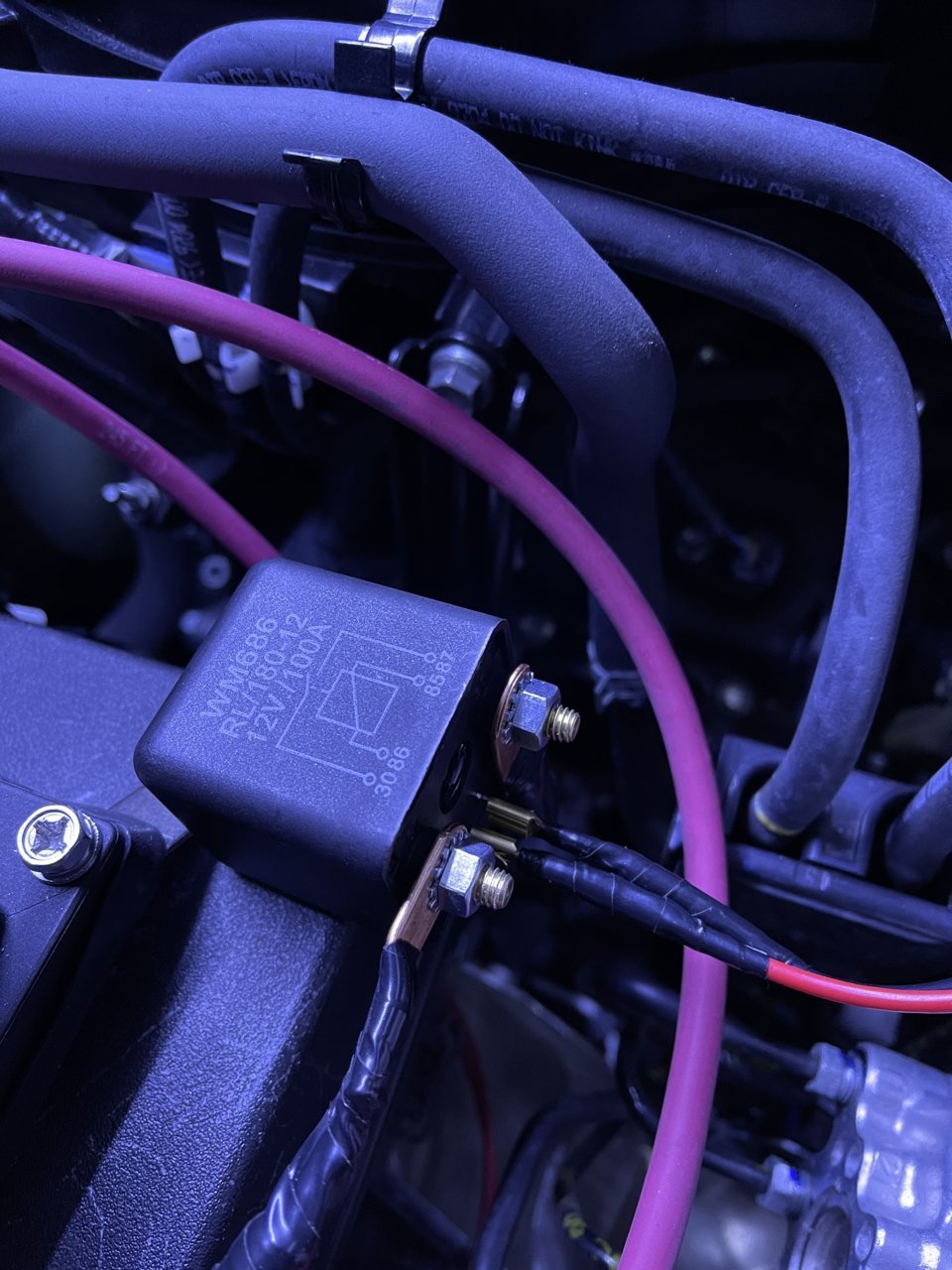

    Finished wiring my aux fuse panel. Added a 100 amp relay thats triggered by the usb fuse that in the cab of the truck. Now I have 6 constant fuses and 6 that are ignition initiated.

    Where is the fuse for the USB? That is a smart solution. I likey

    It’s in the fuse box under the steering wheel in the cab. It’s a 7.5 amp fuse labeled usb. I put an add a fuse in with a 5 amp fuse for the relay and ran the wire through the wire grommet that all my other wires run through to go to the auxiliary fuse box. I prob could’ve used a smaller fuse for the relay but 5 amp seems to work fine.

    Thank you. Solves my last problem of ignition only circuit. Same relay ordered.
