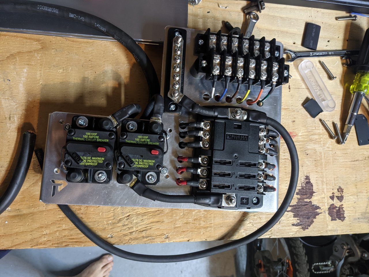

    Thanks for the inspiration Tacomaworld

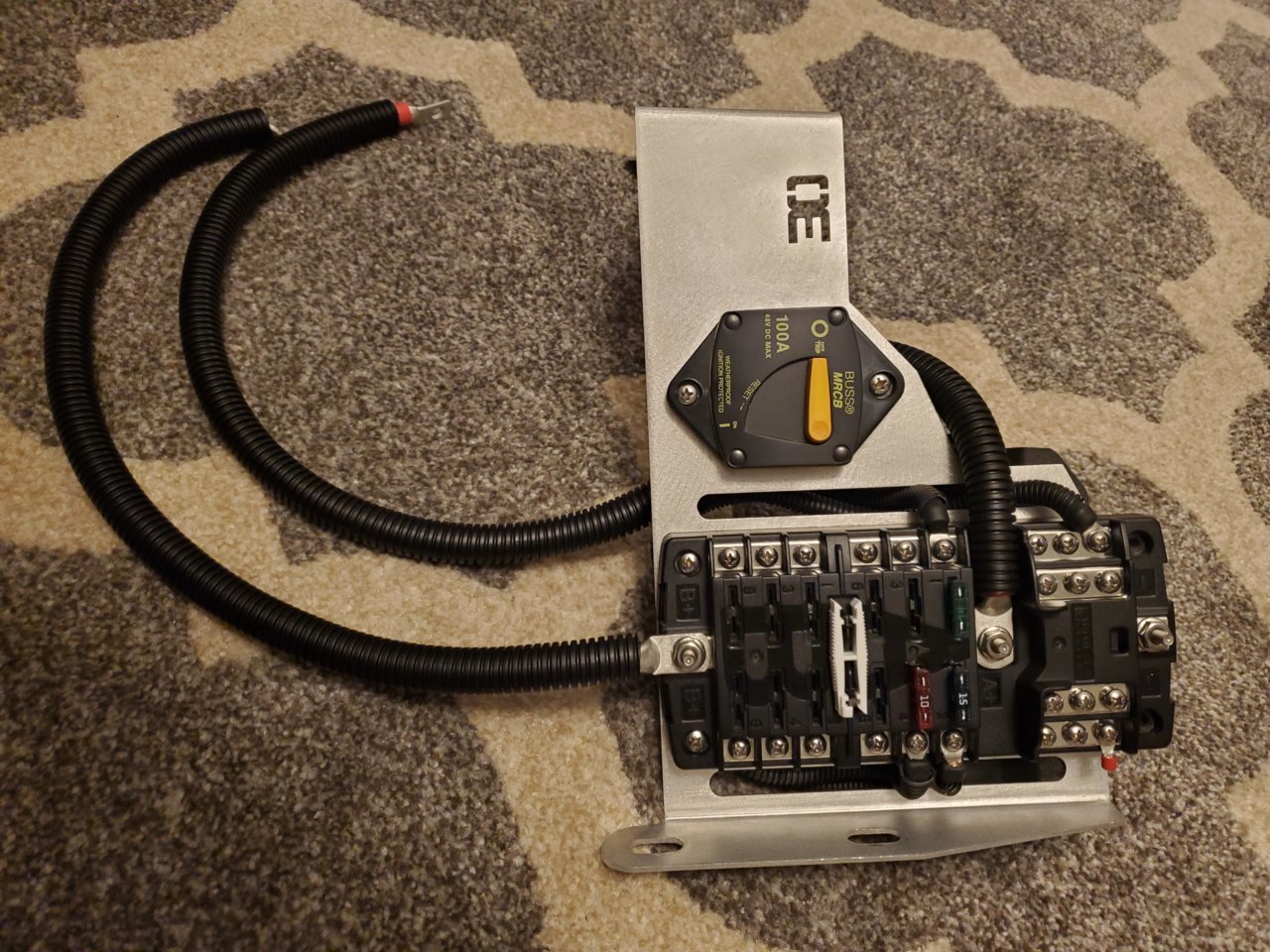

    What's the second 100A breaker for?

    Will be coating everything with crc marine corrosion inhibitor. This has to be done once complete because it is none conductive wax like coating. Meaning if I had to rewire anything would be a bitch to clean all the contact surfaces. Several other product lines out there that will do the same thing. Used in industry alot. Hoping that will be enough.
    Panel is future add-on proof. I'm only using 2 circuits for lights of the start. The main bus bar is good for 400amps, so some strait hot lines to a stereo amplifier maybe. Second circuit breaker could be used for a winch etc.

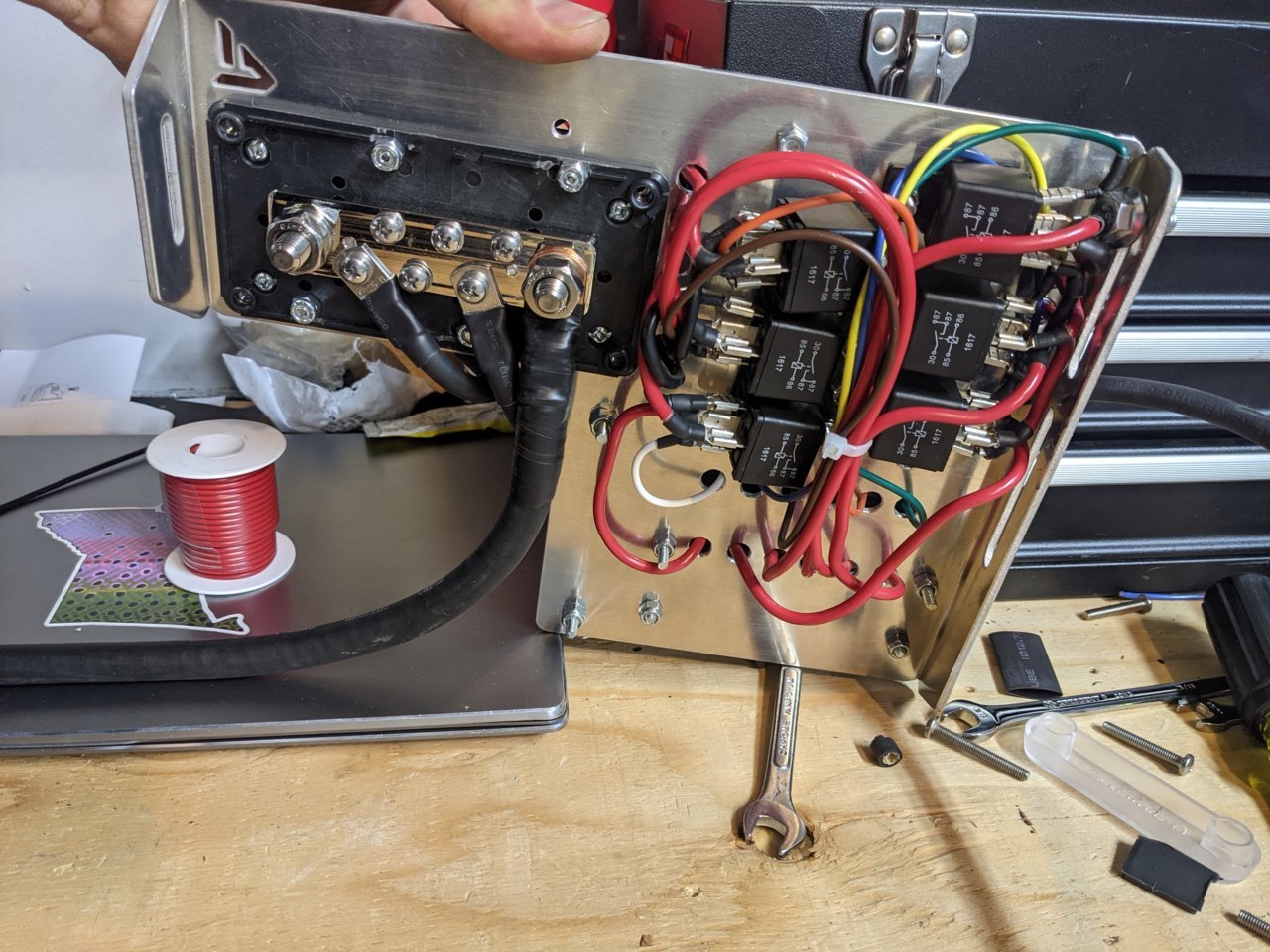

    Switch-Pros makes it nice and clean… :D
    Edit... Mounting plate mod and installation props to @AY_ARONTRD

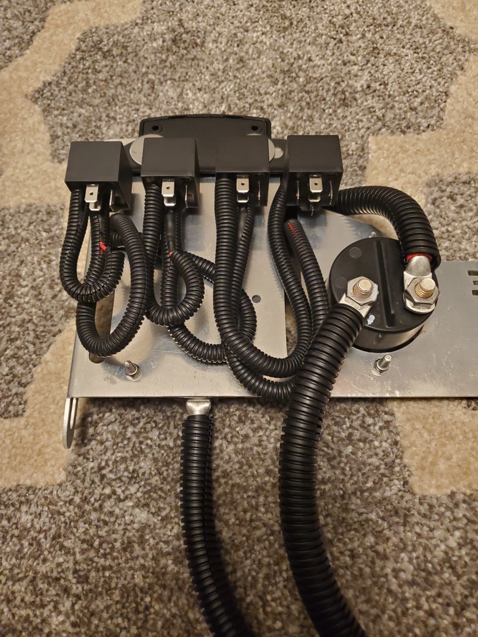

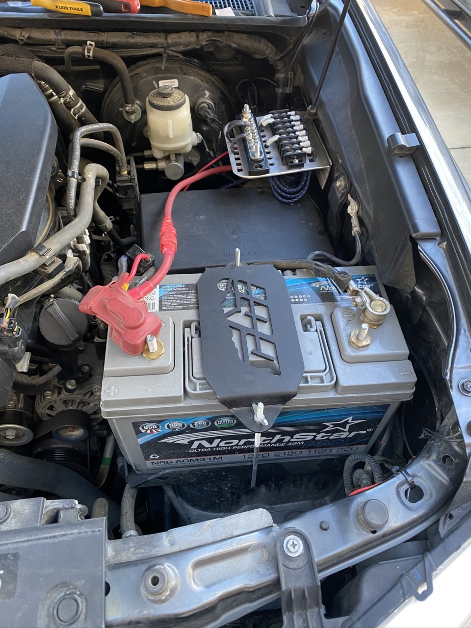

    Long time lurker here. Finally finished my set up. A few finishing touches and I'll be ready for install!

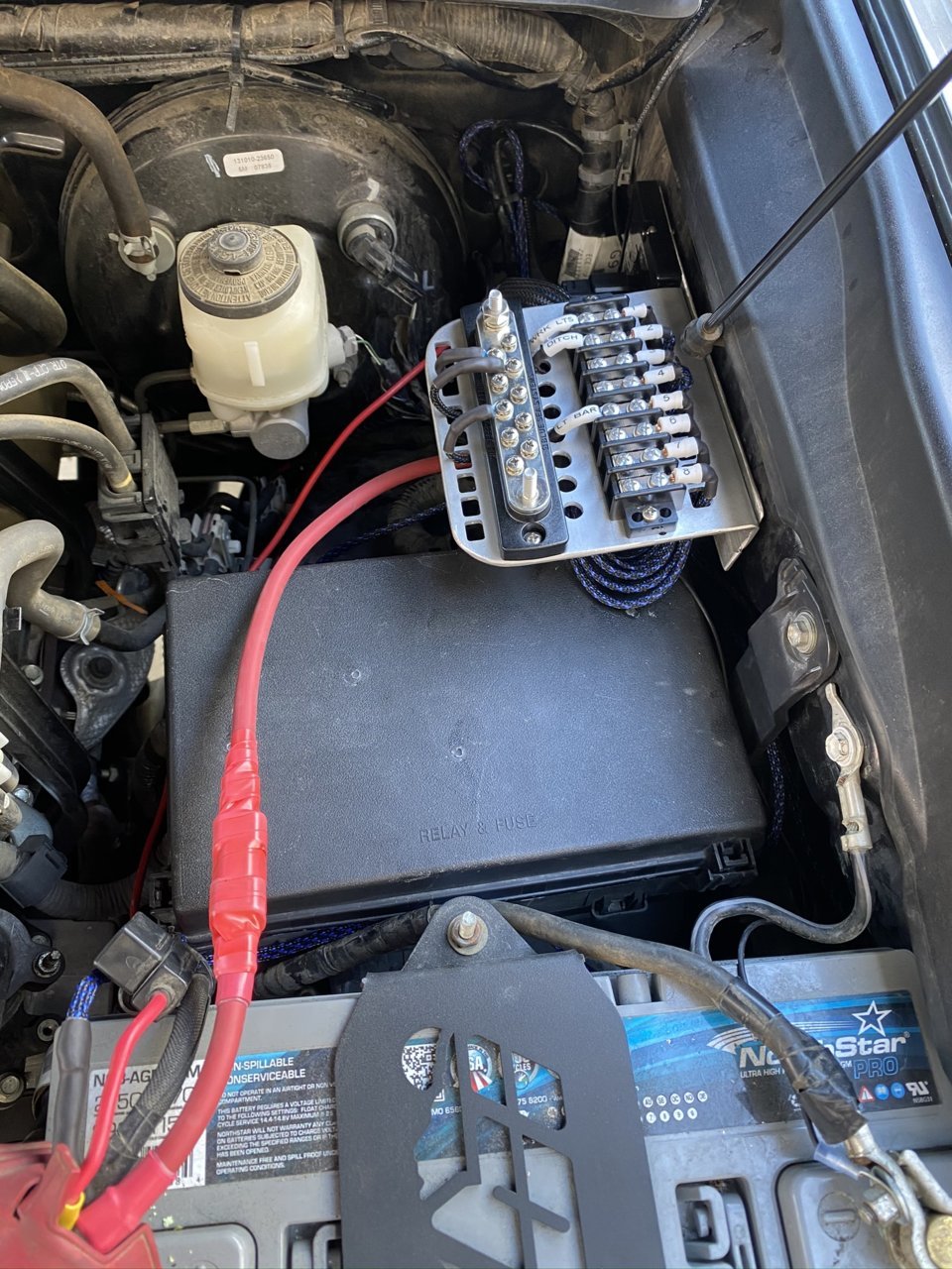

    Bussman box during the install....and after.
