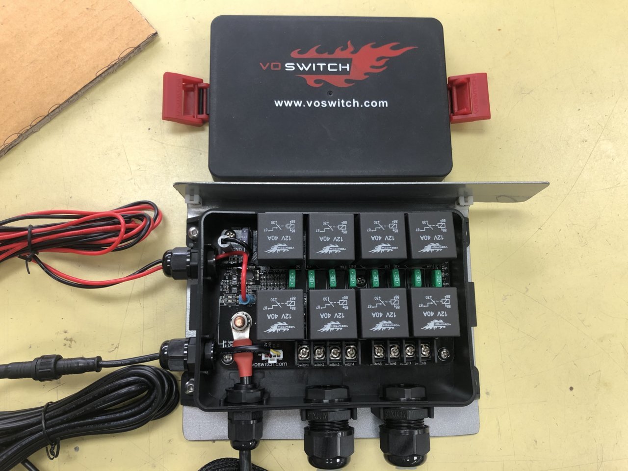

    Sorry couldn’t find wiring for dummies thread,
    I got this harness from my Baja lights it has a 30a fuse, should I take it off and put it in my fuse box or leave it?

    This is what I’m working with I have the breaker inside the box, sorry again for posting here but any feed back would help

    You can leave the inline fuse in place just so you keep it in tact if you ever want to switch up your set up.
    Make sure your fuse panel is the same 30a though.
    It's overkill but doesn't hurt

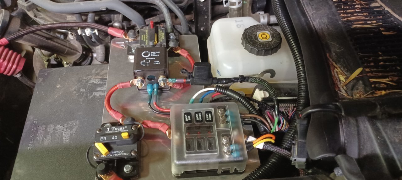

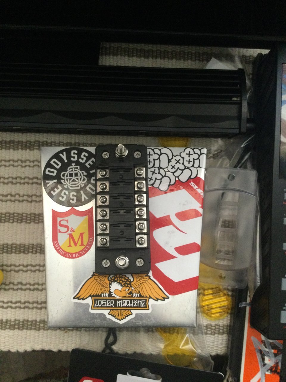

    Here’s my panel
    Do I need a add a fuse to ignition or im good?

    Yes leave all the relays 40 amp. Change the fuses according to your lighting, this was when I first received the unit and they fill all the slots with 30amp fuses from the factory. Not sure about the gauge wiring but I believe they said each terminal is rated for 30 amps .

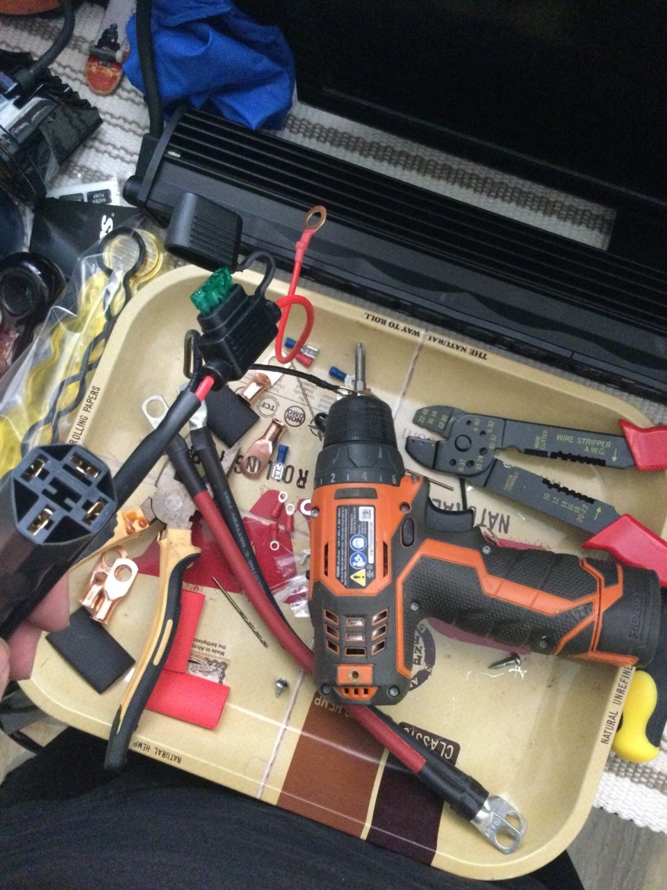

    Bumping this cuz I'm finally getting it hooked up over long weekend. If I read the message a above right it's battery to breaker to relay to panel.
    But the pic shows the breaker running straight to the panel. Maybe I'm missing something?
    Thanks!

    Battery > breaker > fuse > relay > out to switch/device

    If you use a high amp relay to power the panel it’s:
    Battery > Breaker > High Amp Relay > Panel[fuses > 30-40A relays] > Accessories
    If you just have a panel:
    Battery > Breaker > Panel[fuses > 30-40A relays] > Accessories

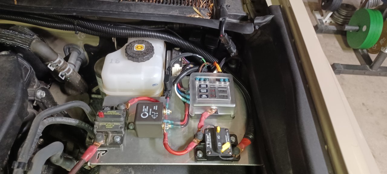

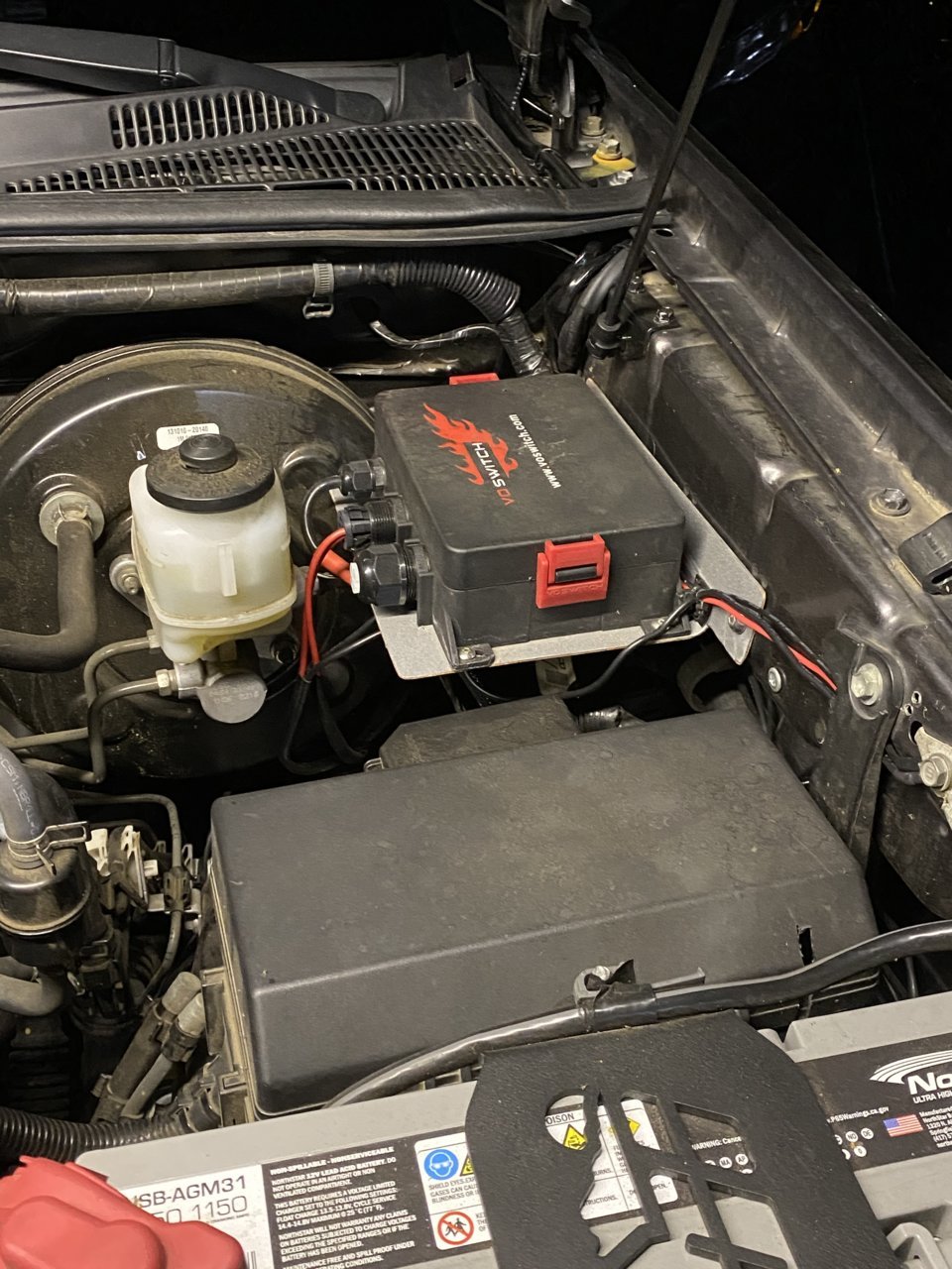

    Got this all finished up recently. 2nd breaker feeds power to the bed with my on board air setup.

    I would agree with that but it doesn't appear to be wired like that in the pics

    It looks like the first breaker supplies the high amp relay which in turn supplies both the primary panel and the 40A breaker which powers the other circuits. Basically what I posted above with an additional 40A breaker. From what I can see it looks ok.
