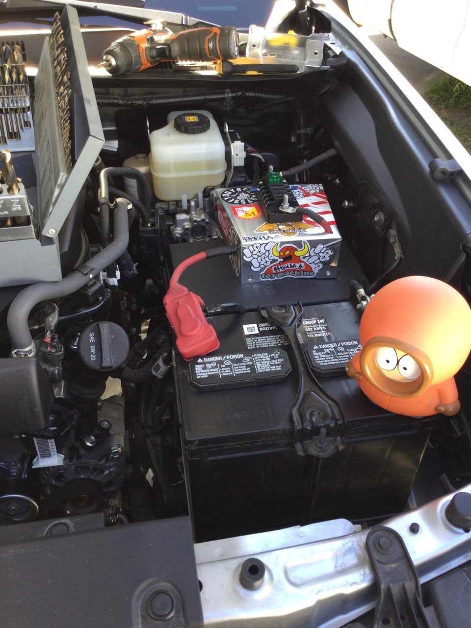

    Is the high amp relay acting like a battery isolater, but instead of isolating a battery powers the panel when the alternator is engages?

    Did you make that box? Don’t think I’ve seen something like that before. Are your relays inside? How do you access the oem fuse box now?
    Don’t think you need to tap into ignition unless you’re worried about turning something on and draining your battery. But not totally sure what you’ve got going on here
