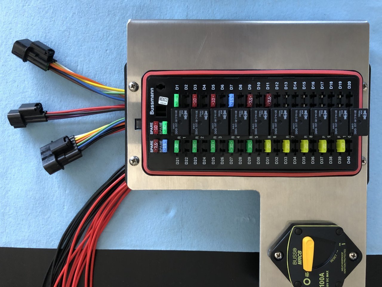

    What bracket is this?
  2. Oct 19, 2021 at 11:58 AM
    #1522
    wally11
    wally11 Well-Known Member
    Jun 30, 2020
    #332983
    62
    Mark
    2017 Black DCSB
    Powertrays. He makes a blank with no cutouts.

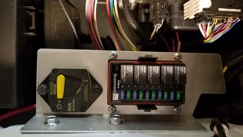

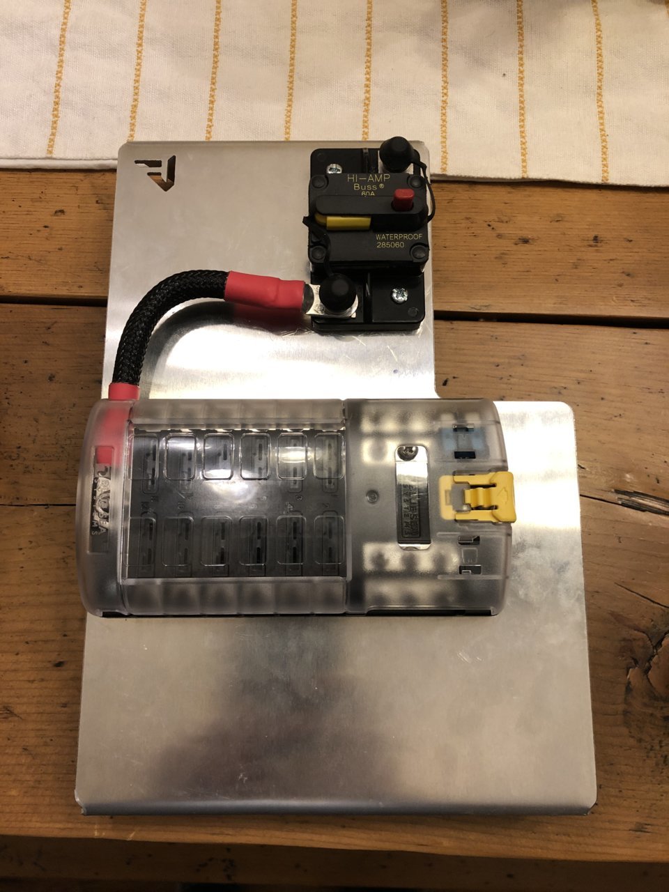

    I was finally able to wrap up my fuse panel and the interior wiring to my overhead meso 10 button panel. Now whenever I add something, I can just use 1/4" quick connects to the button harness and a quick connect to the relay power output. Thanks for the ideas and help, hopefully someone else can get a little inspiration out of this. I used two 7 micro relay panels from hella and a 12 circuit blue sea fuse block. For the wires into the cab I used a 12 pin deutch connector for an easy to remove more factory style.

    Those of you with the Bluesea 5032 fuse block, how are you powering the switched side of the box? I know it will need to go through a relay, but a) where do you find a relay capable of enough amperage to feed that side, and b) what trigger wire are you pulling from in order to trip the relay when the truck is on/running?

    The max for the entire fuse block (both sides) is 100A. How much current will be on each half? Each circuit is limited to 30A so obviously you can’t run 6 x 30A circuits on the always hot half. Common Bosche style relays are 40A switched but higher amperage relays aren’t difficult to source. Here’s a 75A relay with screw terminals.
    https://m.delcity.net/store/Bosch!Tyco-Relays/p_823743.h_823744
    And another with a 200A max and lug terminals.
    https://m.delcity.net/store/Hi!Amp-Automotive-Relay/p_823742.h_927565
    Either would do fine since it’s unlikely you’d run all of the 100A max through just the switched half. If that’s the case then you need 2 separate fuse blocks instead of the split block.
