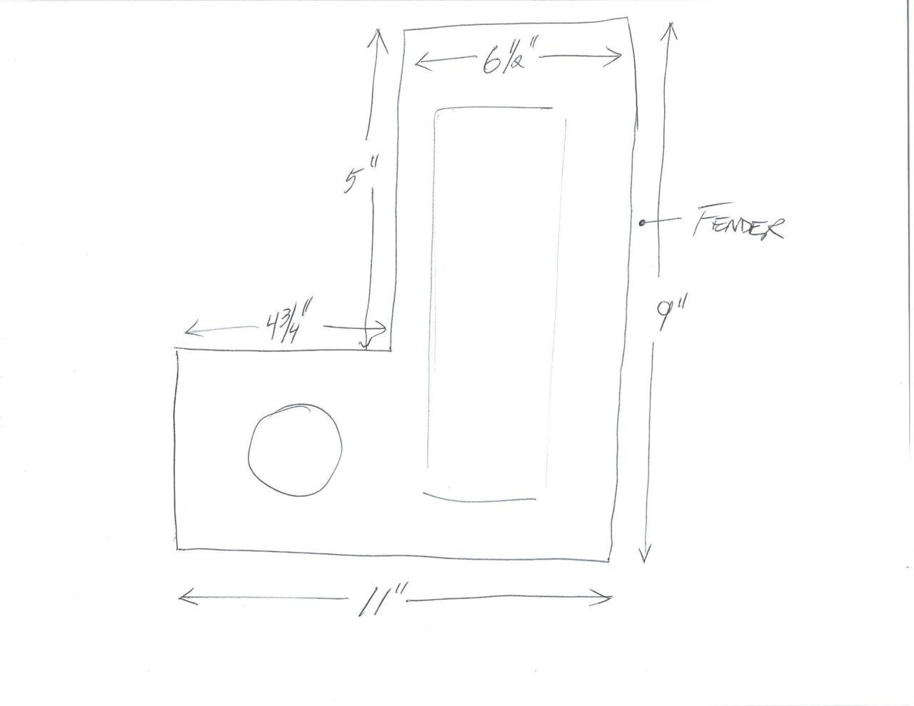

    rough measurements

    Thanks! I'm gonna measure my area again and see if it'll be more work to start with a fitting blank, or trimming an RFRM tray to fit.

    Looks like the RFRM is too wide for that location if you have an OR. Have you placed the box under the hood to see what kind of room you have? Maybe mount it vertical on the driver side fender or maybe on the passenger side?

    Correct. It will not fit between the booster and fender, but it could in front of the booster but may slightly impede the ability to life the fuse cover. I hadn't thought of the passenger side. Was gonna put another battery there eventually.
