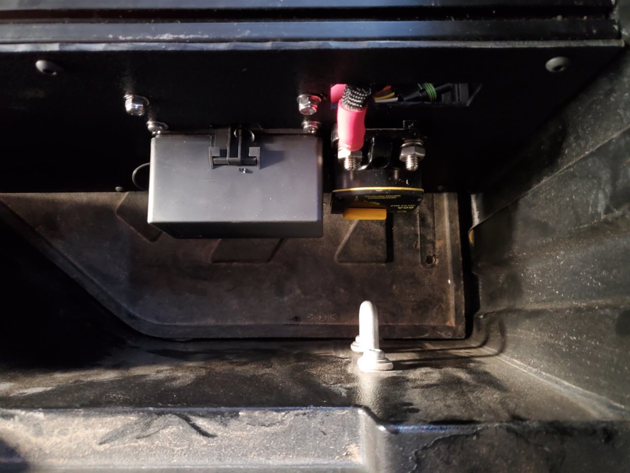

    That was basically a BlueSea fuse block in a project box mounted on the aux battery.
    Below is my aux fuse/relay for my 2022 Tacoma:
    My design criteria:
    Use a MOSFIT low voltage cut off device to prevent draining the main battery (which I already replaced with a deep cycle Odyssey Battery PC1700)
    Waterproof fuse/relay block
    Use a separate fuse block in the cab and in the bed (so I only need to run one wire to those locations)
    Fuse/relays for up to 6 accessories
    Don't obstruct access to factory parts
    Don't power stuff directly through switches (that is what relays are for)
    No metal edges on fuse block mounts to cause shorts in wires
    No negative terminals on the fuse block; there are factory ground points all over the truck
    No dual battery (no room, so use a lithium ion jump starter battery instead).
    Here's the (almost) finished project:
    To make room for the fuse/relay box, I had to relocate the factory Relay Block #2. On my 2006 Tacoma I just zip tied it to the side of the the engine bay using those extra bolt holes.
    But on the 2022 the cable is much thicker and I didn't like stress in that position. So I made a mount to hold it in an accessible location:
    The mount is secured with a bolt using the existing hole though the wheel well (obstructed in the above photo)
    All of the parts were made using FreeCAD software and 3D printed with a Prusa MK3S printer in PETG plastic.
    I used this for the fuse/relay box:
    I needed a way to mount the fuse/relay box so I designed a mount which could also be used to hold the low voltage cut off switch.
    If you look carefully, you will see a hole on the left side for the main power from the battery. The long screw post on the low voltage cutoff eliminates the need for a bus to run power to the individual fuses.
    The mount has two holes for bolts though the wheel well and tabs that use the factory fuse/relay box mount:
    There is also a spacer to provide extra room for wires under the fuse/relay box:
    Here's the base installed before adding the fuse/relay box:
    I needed to drill a hole to secure the mount on the upper left in the photo above. The other bolt uses the existing factory hole in the wheel well.
    You will notice a fuse/breaker on the left in the photo above.
    I designed a mount for the fuse/breaker that slides into the Factory fuse/relay box
    IMG_2217_6e190a70c46bb3a7c1cf5cdf89de122e1c9dd4ad.jpg IMG_2218_ab5e6449a22f6c88612e901ff1aaceb2c965378d.jpg
    Here's the cable to the battery and Victron Energy Smart Battery Protect
    Before:
    After:
    Wires to the fuses in the fuse block are done like this.
    Here is how all of the parts fit together:
    and with the spacer for the fuse/relay block
    Here's the finished project:

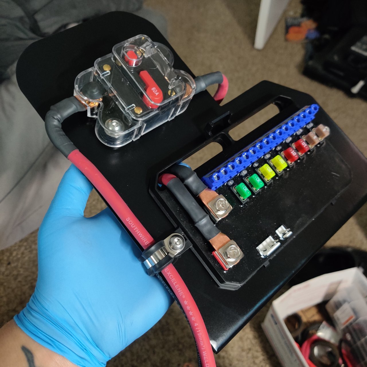

    Thoughts? I don't have all the parts yet, but drew up a template based off Blue Sea provided dimensions.
    This is without the bending and mount tabs yet.

    Most of the Blue Sea fuse blocks I see installed have a negative bus for ground wires. But there really isn't much point to running ground wires back to the engine bay because there are factory ground points located throughout the truck. Also, if you use relays, you can run lower gauge wire from your switches because they only need to carry a very small amount of current.
    Power should go from the battery, to a fuse in your fuse block, to a relay, to the accessory, to a factory ground point.
    In some cases you may decide to power something directly through a switch, but then you need to make sure the switch can handle the current. I did this for the compressor in my on board air setup, and burned out several switches even though they were supposedly 30A.
