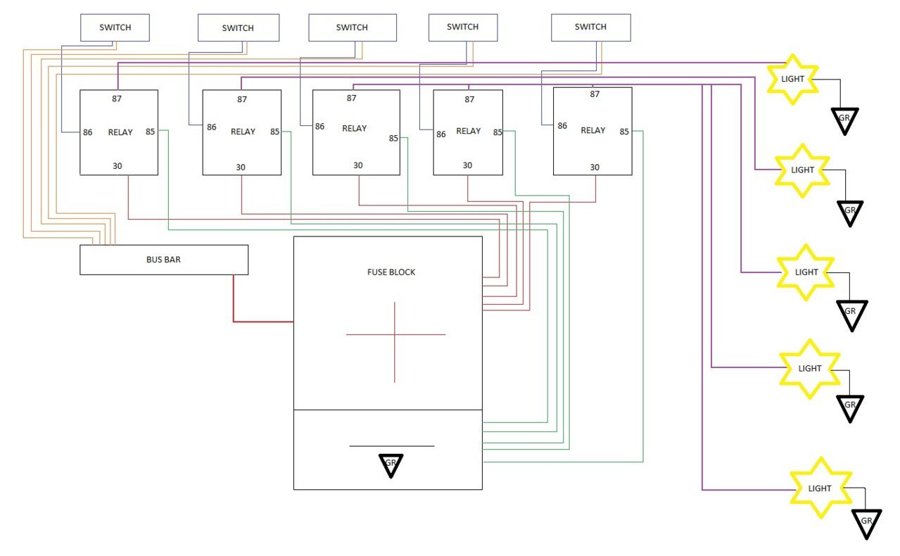

    I'll check that thread out, thank you very much. Right now the relay grounds are just wired into the ground side on the fuse block.
    This whole project ended up being way more intensive than originally thought. Seemed like a fun thing to try and build on my own.

    Eliminate the buss bar feeding the switches. Fuse one wire and run it to the first switch with a jumper also crimped to that first switch connector and a jumper in each connector after that. Same thing for all of the pin 86 wires, each one goes to the next relay in line with the last one going back to the ground bar. You can allow for additional relays and switches in the future by crimping in a wire that is capped. When you add a switch and relay, add another capped wire to allow for more. When you’re sure that’s it, don’t add the extra wire anymore.
    soundman98 and Mudman[QUOTED] like this.

    Brilliant! I remember seeing that somewhere and totally forgot about it. That would save me a ton of wires and no bus bar.
    I understand removing the bus bar part, but for Pin 86: wouldn't one switch turning on trigger all the relays at once if they are jumped to one another?
    This place has saved me a lot of money and been invaluable for info. I'm a visual and very slow learner, but sure enough I'm getting it sorta. Albeit very very slowly.

    Sorry, you’re right. See you do understand.
    For you the switched positive sides (pins 86) are all on separate wires from each switch. The ground sides of each relay(pins 85) are already all connected to ground, daisy chaining just eliminates a bunch of excess wire on the ground side of each relay and the positive side of each switch. Daisy chaining all the pin 86 wires would definitely have the effect of any switch activating all the relays so that’s to be avoided.
    Mudman[QUOTED] likes this.

    Appreciate the confirmation, electrical definitely confuses me. I am barely grasping the new to me concept. Much respect to the wizards of this stuff, especially wiring diagrams. I have the confidence to build a knife from scratch, but tell me to wire up more than one relay and my brain takes a dive.
    The relay block thread has me rethinking this build. I suppose that will be a future project for fun. Ultimately I plan to run a switch pros or spod, just out of my price range right now.

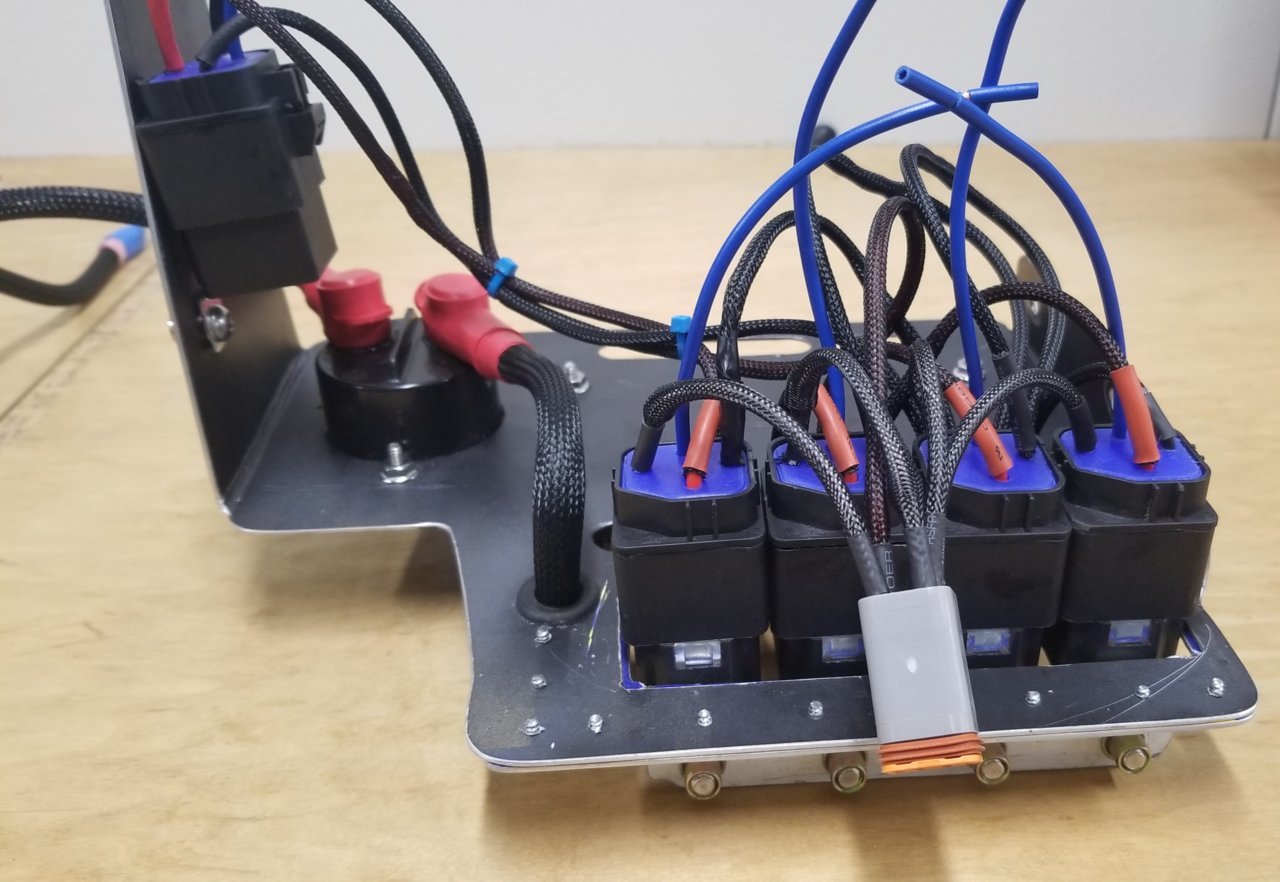

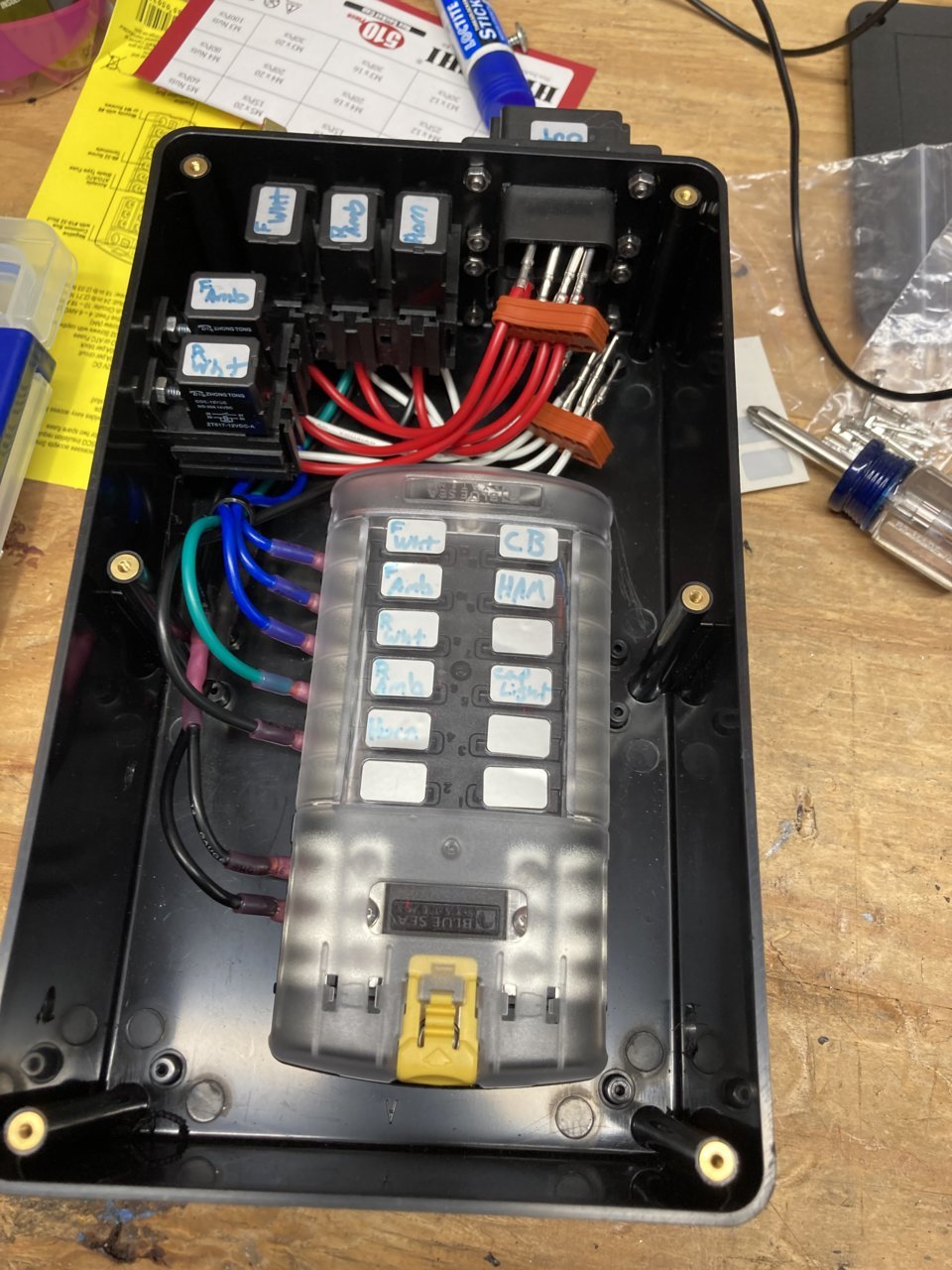

    Updated mine to add a few more fuses. Was tired of how dirty the panel got, so I built this one in a project box. Also finally replaced my stock battery.

    That's a nice setup! What plug/connector are you using for the relays?

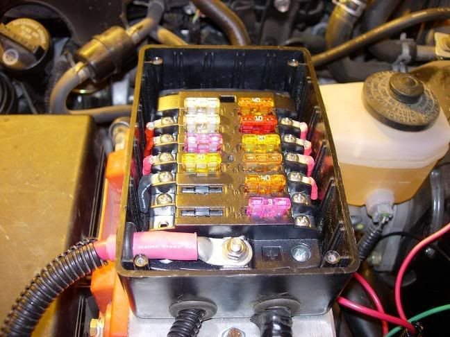

    I used a project box for the aux fuse block on my 06 Tacoma.
    I only needed one relay so I used the empty relay position in the factory RelayBlock#2
    Mudman and demo243[QUOTED] like this.

    Sweet, I totally forgot I had a small Deutsch connector kit. Gonna try that out now, I dig the way yours is setup.
    I'm trying to run that braided sleeving on everything, looks like crap if you suck at it. But I'm not ready to redo it all yet.

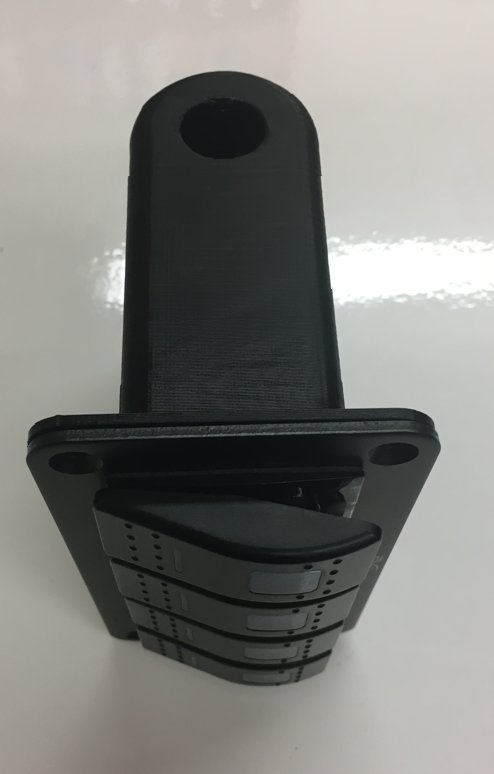

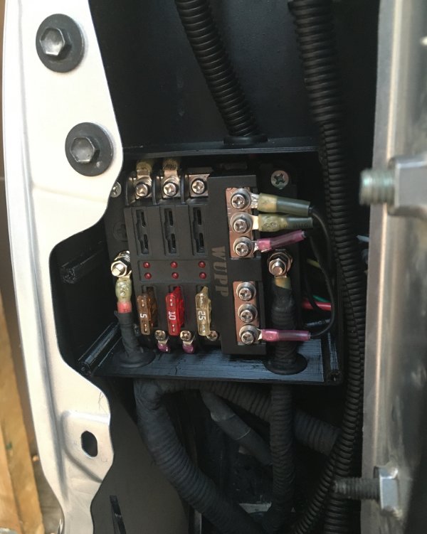

    I started working on the fuse/relay setup for the bed. This is a separate fuse/relay location located behind the driver's side taillight.
    We use our bed as a sleeping platform with an ARE Z-Series Truck cap so we need power for:
    1: Always on USB ports
    2: Always on 12V cigarette adaptor as a universal fit for random stuff
    3: Lights inside the bed
    Also since I'm running 12V to the rear of the truck, I'll use that as the power source for:
    1: Rear lights (when I get the new rear bumper)
    2: Side lights that are mounted to the ARE truck cap

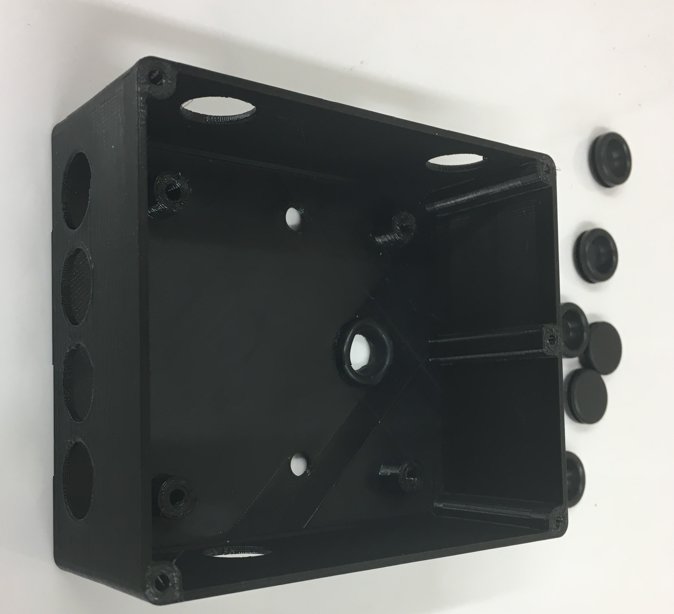

    I didn't want to crowd the fuse/relay block located in the engine bay or run all of those wires to the rear of the truck. So I ran one 10AWG wire to a secondary fuse box located in the bed.

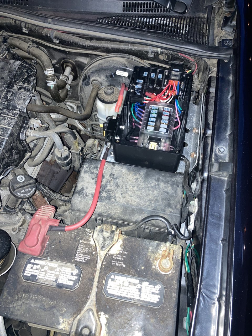

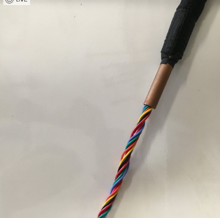

    To power all of this stuff and provide switches, I ran a 10AWG wire from the front Aux fuse block to a new aux fuse block located behind the driver side taillight.
    In addition to the 10AWG wire, I ran multiple wires to power lower amperage switches and relays. Here I'm wrapping that wire harness with multiple layers of sheathing. The copper pipe is just used to make it easier to add sheathing to the wound wire harness by running the wire though the pipe and the sheathing over the outside.

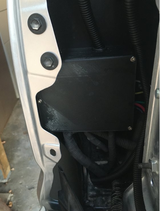

    So here is the fuse block and a couple or relays I installed behind the driver side taillight on my 2022 Tacoma.

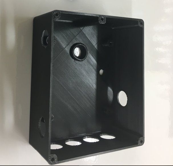

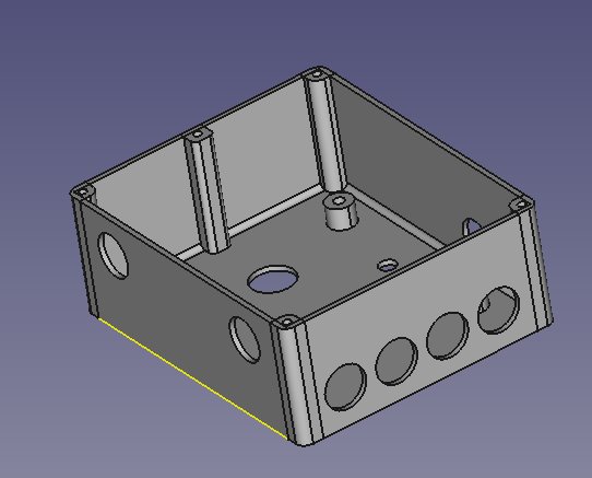

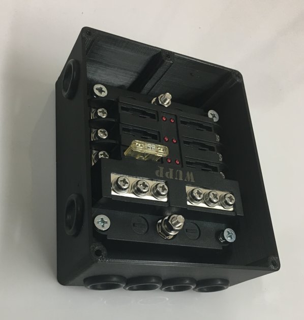

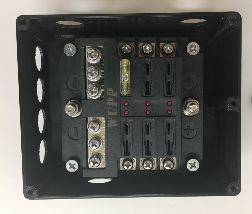

    The fuse block housing was designed using FreeCAD software and 3D printed using a Prusa MK3S 3D printer:
    I started by looking at prefabricated project boxes but none fit my exact dimensions and all would have required extensive cutting for all of the holes I need. In the end is was easier to pre-fab what I wanted in cardboard and then print the fuse box with all of the holes right where I wanted them.
    This fuse block housing was designed for a WUPP 12 Volt Fuse Block that I got on Amazon. It is slightly more compact than the Blue Sea fuse block that I used in the cab.

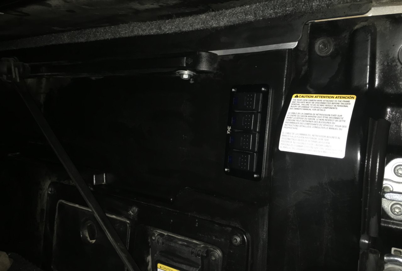

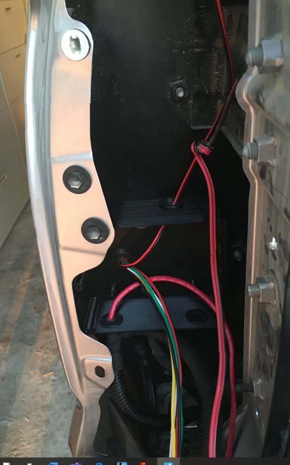

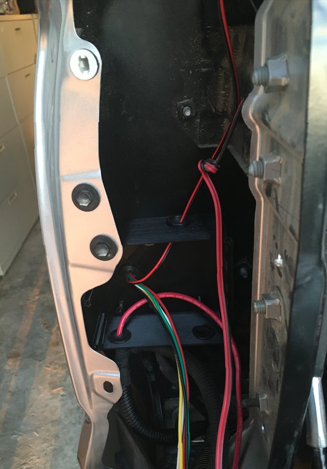

    Here the fuse block housing is installed behind the driver's side taillight. I'm using existing holes for the bolts that hold this in place.
    10AWG wire from front Aux fuse block

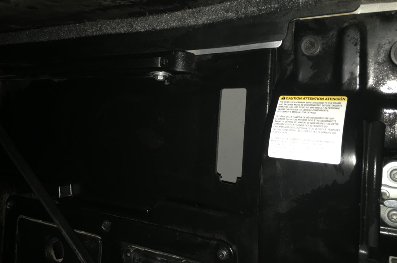

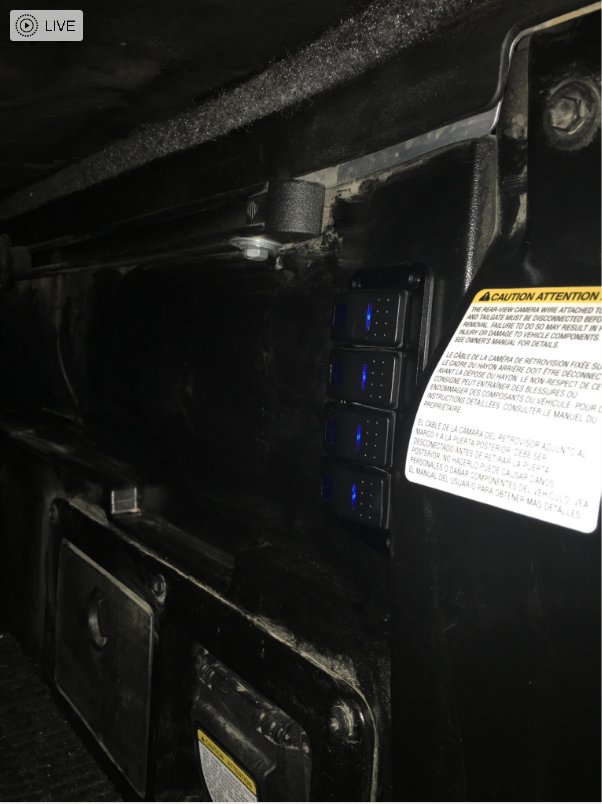

    And starting to run wires from a switch panel in the bed to the new fuse block:

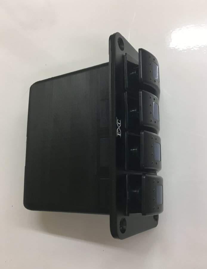

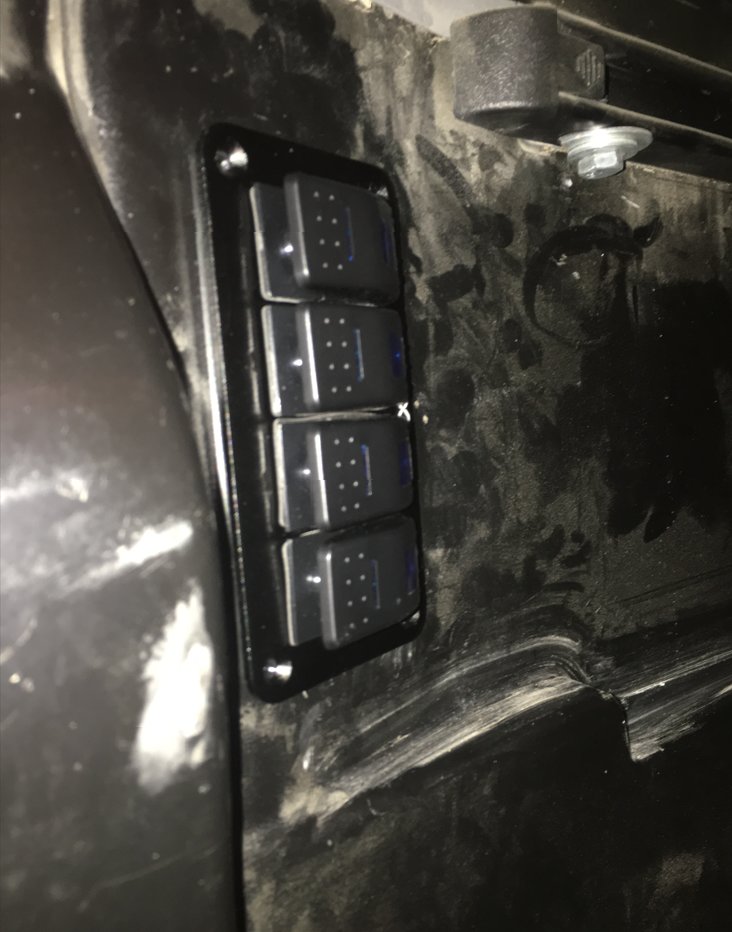

    The 18AWG wires shown above go to a switch panel installed in the bed.
    The new switch panel is a FXC Rocker Switch Aluminum Panel 4 Gang I bought on Amazon.
    I designed and printed a housing for it that fits in that cut out in the bed near the tailgate.
    Here is the hole in the bed near the tailgate that I'm using
    And here is the switch panel installed
    I hope is is OK that it will take multiple post to document this but I didn't want to start a whole new post on this project. That's all I have for now.
    cmonjack, Criera, Roof Walker and 7 others like this.

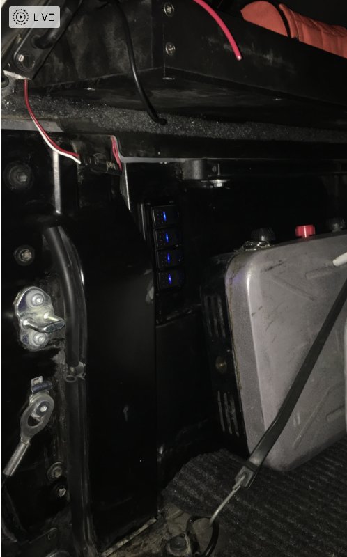

    getting to the final stages on this project. Power to the rear auxiliary fuse block is complete, power to the switch panels and interior lights, and switching of the rock lights from both drivers' side and passenger's side are complete. I still need to wire the relay for the rear lights but I' waiting until November to the the rear bumper installed. I also want to have switches and power for side lights that are mounted on the Yakima rails, but I've had a hell of a time finding a mounting for the rails themselves.
    Anyway, the two most important switches are working now.
    Next is wiring the 12V cigarette adaptors and USB ports inside the bed for powering accessories and 110V inverter.
