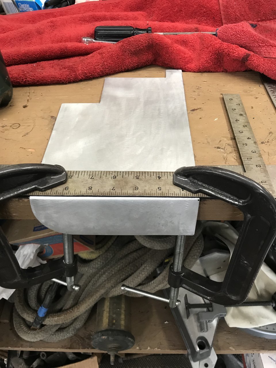

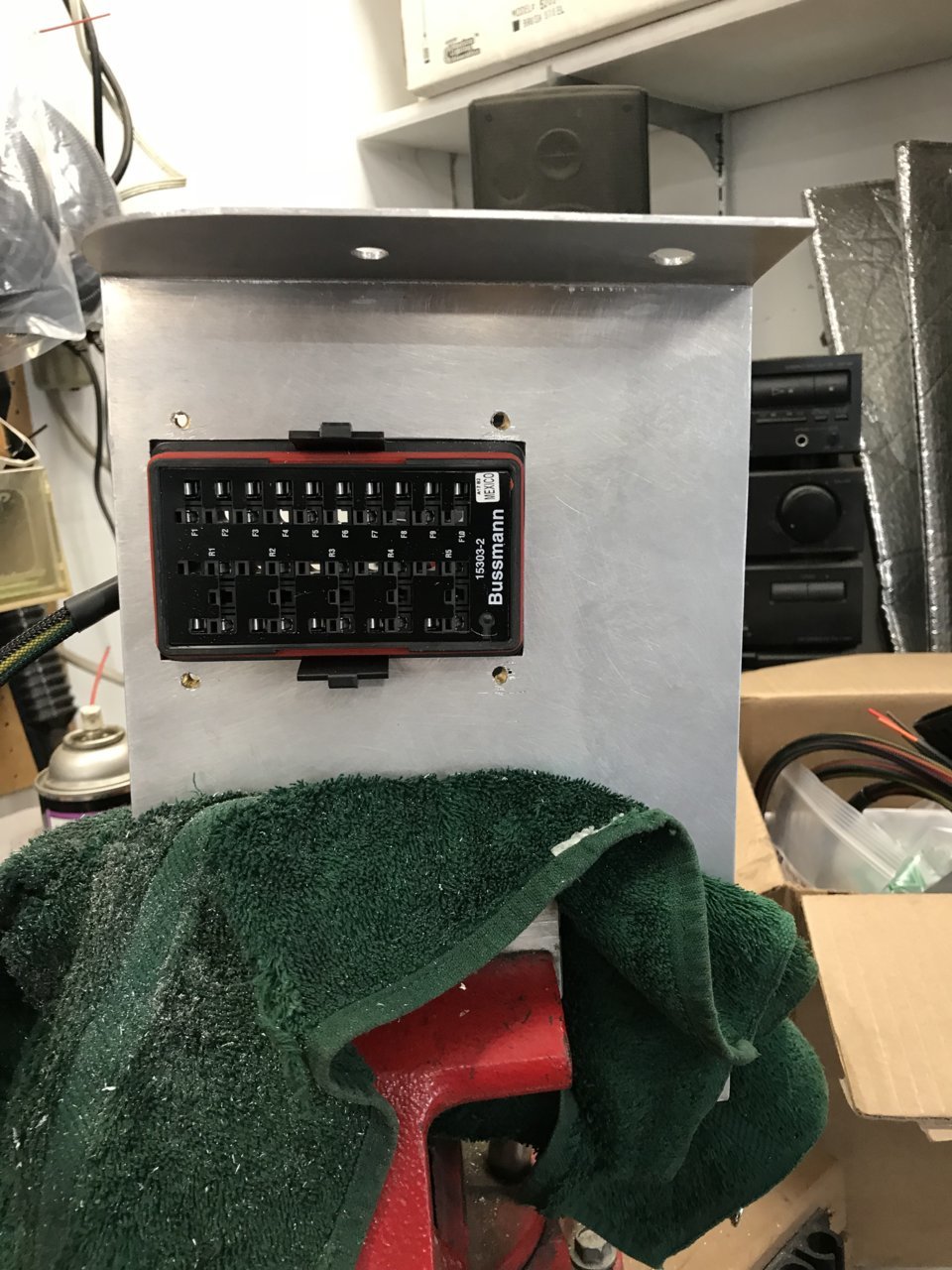

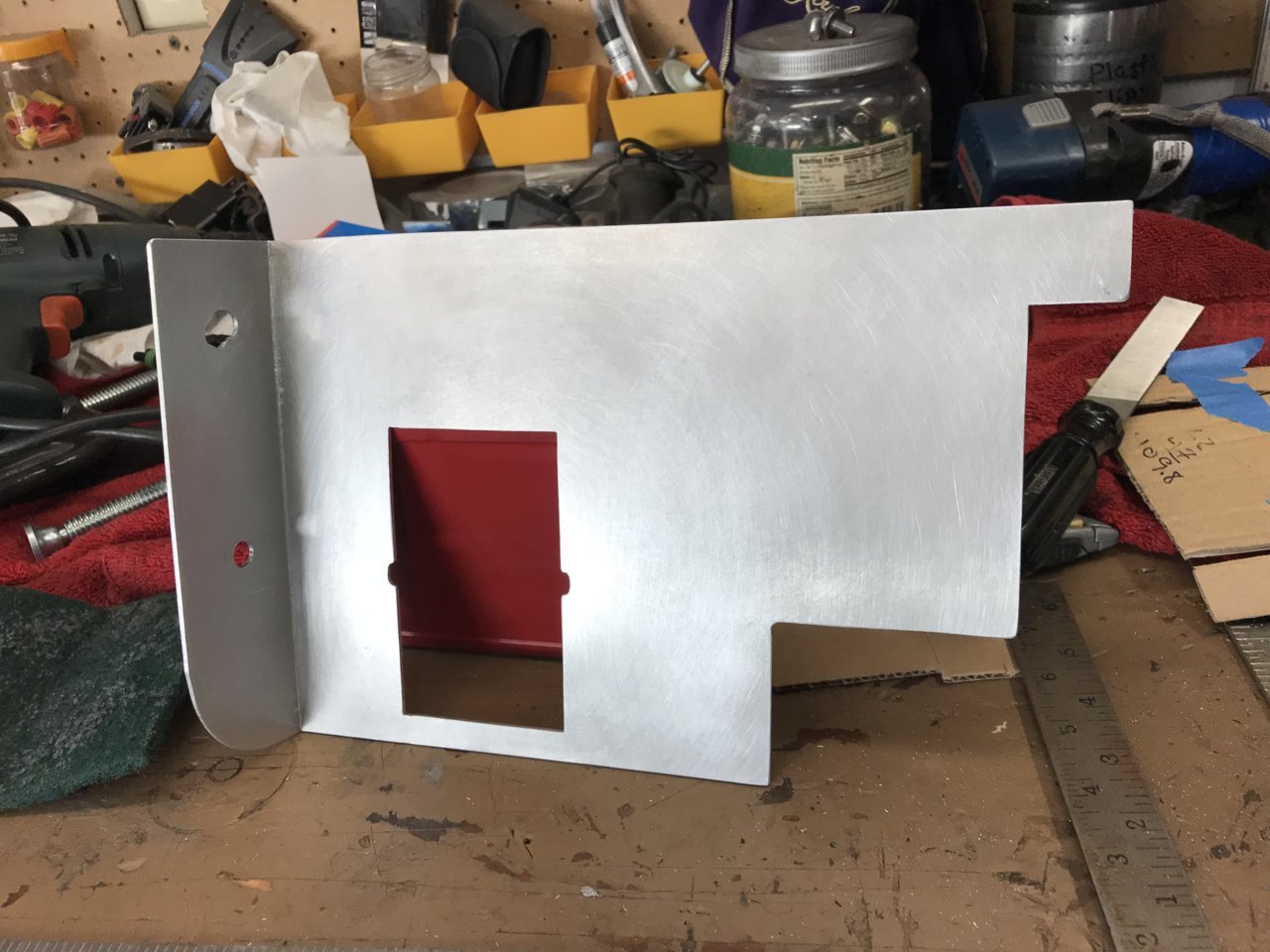

    Ripped out my old budget aux panel and I went with a Bussmann and designed/printed the panel for it. The goal was to minimized the size and to keep things clean.
    I also integrated a mount for my clutch fluid reservoir. Since that was in the way.

    What kind and size/thickness metal are you guys using to make the Trays?
    And how are you bending them??
    I snagged some aluminum pieces but I don’t have a vice big enough to bend it without making a mess.

    I often used 1/4” ABS sheets, cut as needed, and then apply heat to bend.
