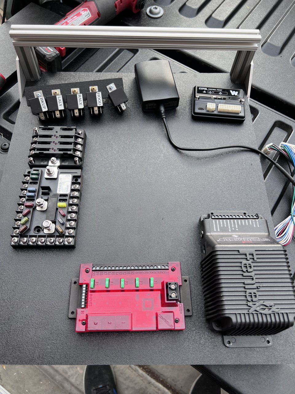

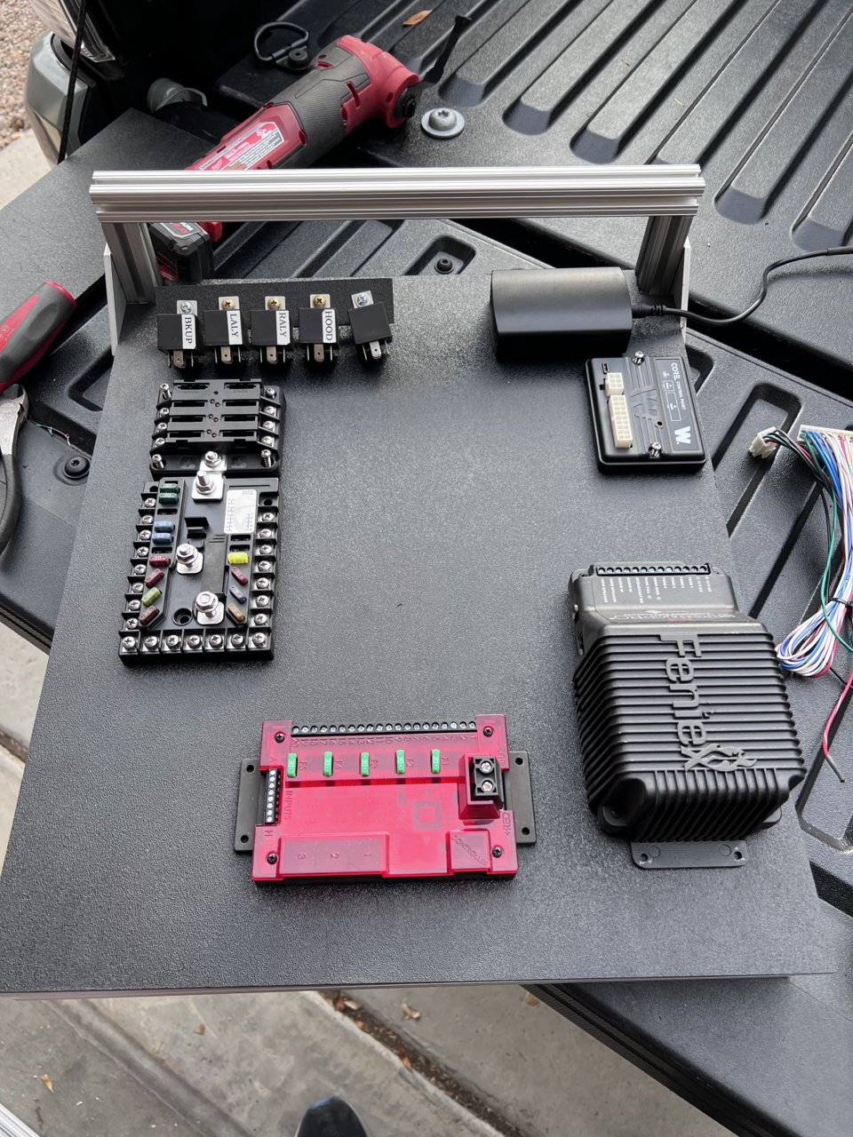

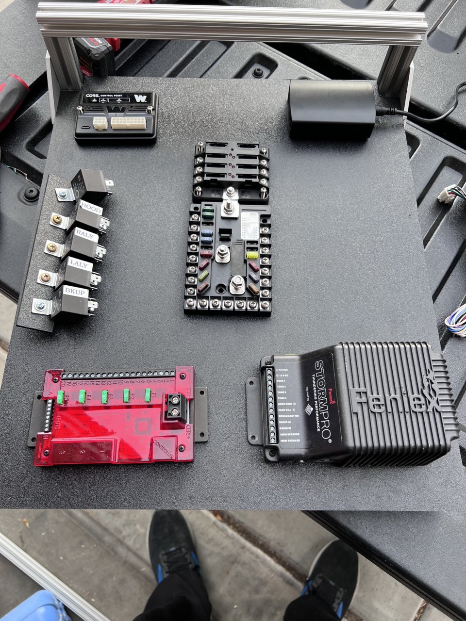

    My RSI cap should be here in the next month or so and now is the time to start figuring out how I want to layout all the doodads.
    3DABA66A-531A-4555-8D1E-6D4C835CFB5D.jpg 547E7F93-A15A-40C2-ACF3-3713C7092F88.jpg 62EFB915-B611-4E0F-BF48-8DC07E6354A7.jpg
    I’ll have 4 cigar plugs added as well, but those will be able to be wired directly to the fuse block (one always on, one on the timed circuit, two on the ignition circuit)
    so now it’s just a matter of making the decision on where to put everything, then mounting it all, changing my mind a few times, then wiring it all up and regretting not leaving it in the original layout.

    What are those components?

    the one that says Whelen on it is a brain that I use for my remote spotlight (Arges II)
    the red one and the other box that says Feneix on it are a siren and siren controller (StormPro 100 and 4200 Datalink)
    the boxes that look like they are fuse blocks are a PDM-14 from Egis an added fuse block for extras. Has voltage sense, three zones that are programable, and low voltage cutoff.
    https://www.egismobile.com/shop/2602b-pdm-14-circuit-ground-175-a-12-v-5499#attr=
    a USB hub for added power ports, and 5 relays so that I can run higher draws off of the siren controller without taxing its circuits.

    I know Whelen products when I see 'em :) What's your plans with the Arges and the siren? Have any lights to go with those?

    Had the Arges on a Quick Fit mount on my Ram 3500. I will be designing a mount for the Arges to go somewhere on the Taco, just not sure yet. I need the cap to come in and I need to get some ditch light mounts also, then I can decide on placement.
    I currently have 8 FedSig Micropulse Ultra's (RAW, and AW) that will go on the truck, and a Brookings Industries traffic director with white out. Additionally, the Arges will be tied into some of the warning light functions (alley, takedown, and a few others.) I had a set of Star visor lights in the Ram as well, but I do not care to work with the turn lock visor tabs, so I will probably end up with another form of warning lights for up front and also be adding a few MPU's as well.
