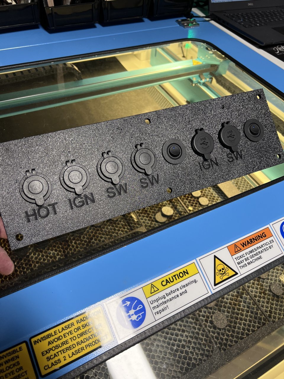

    Had some time to finally get my cigar plugs and usb plugs mounted into a panel. I’ll get them pre wired at some point and get them installed.
    An always on cigar, ignition cigar, and two
    Switched cigar plugs along with an ignition and a switched USB.

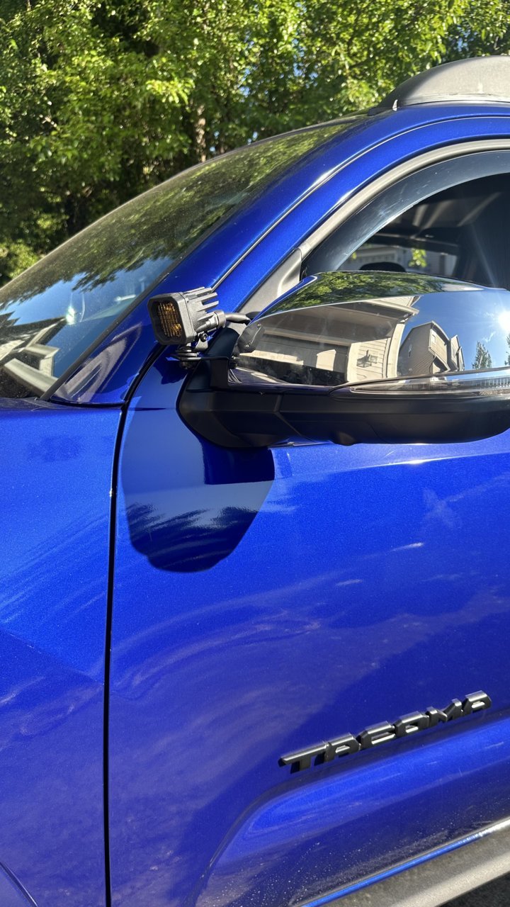

    What size/kind of aluminum are you guys using to make your plate?
    I made some mirror mounted light brackets out of 1/8” 6160 T6 Aluminum. I think it might be a little overkill for this plate though.
    Shoot some links if you know a good place to buy some aluminum sheets.
    Thanks

    How’d you make those, you have a brake or shop access?

    I annealed the aluminum, then used a vise brake to bend, then re-tempered, then powder coated. Paired them with some Diode Dynamics SSC1 Pros.

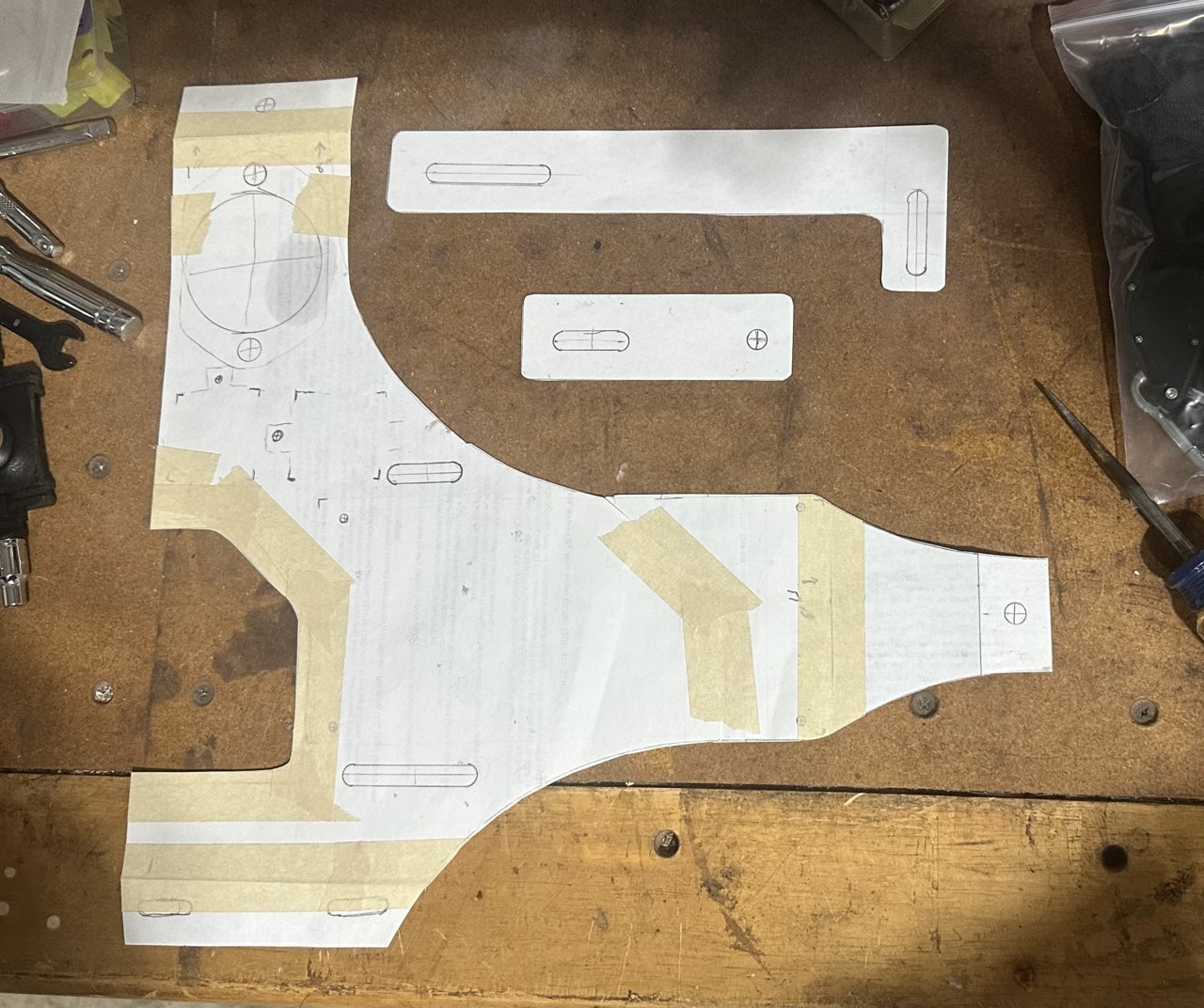

    Working up some templates to make a fuse block tray.

    I don’t have a vise and nothing to mount one too, i guess I could probably rig something.
    I thought that would weaken the AL, going back n forth?
    Was it a pita to install that mount on the mirror?
    That’s kind of a better spot.

    the aluminum is 6160 T6, it’s pretty strong. Annealing the aluminum makes it much softer and makes it pretty easy to bend with a brake. I highly recommend a vise brake, but it limits you to 5” wide, unless you pay some serious cash for a larger brake. After bending, you can re-temper the aluminum to harden it again. In the end it is not as strong as the original T6, but pretty close. I can almost stand on one of the brackets without it bending. Definitely strong enough to mount lights.
    You gotta be committed to lights on your mirror arms since you will be drilling into the arms. There is not much room inside the mirror arms. The holes need to be planned precisely for the hole to pass the wire through and so that you can fit a lock nut on the three mounting screws.
    It was kinda complex, but not hard. Working with aluminum is cool. it is easy to work with, strong, won’t rust, and is fairly cheap. For things like the fuse block tray, I can make it whatever shape I want so I can make sure I still have full access to the original fuse box, the relay box next to it, the brake sensor plug, and other connectors that would normally be hard to get to after the tray is installed.
    I plan to do the same for an onboard air mount under the hood and an air-tank mount where the spare used to be.
    I’ll do a full write up on the mirror light project, here on TW, soon.
