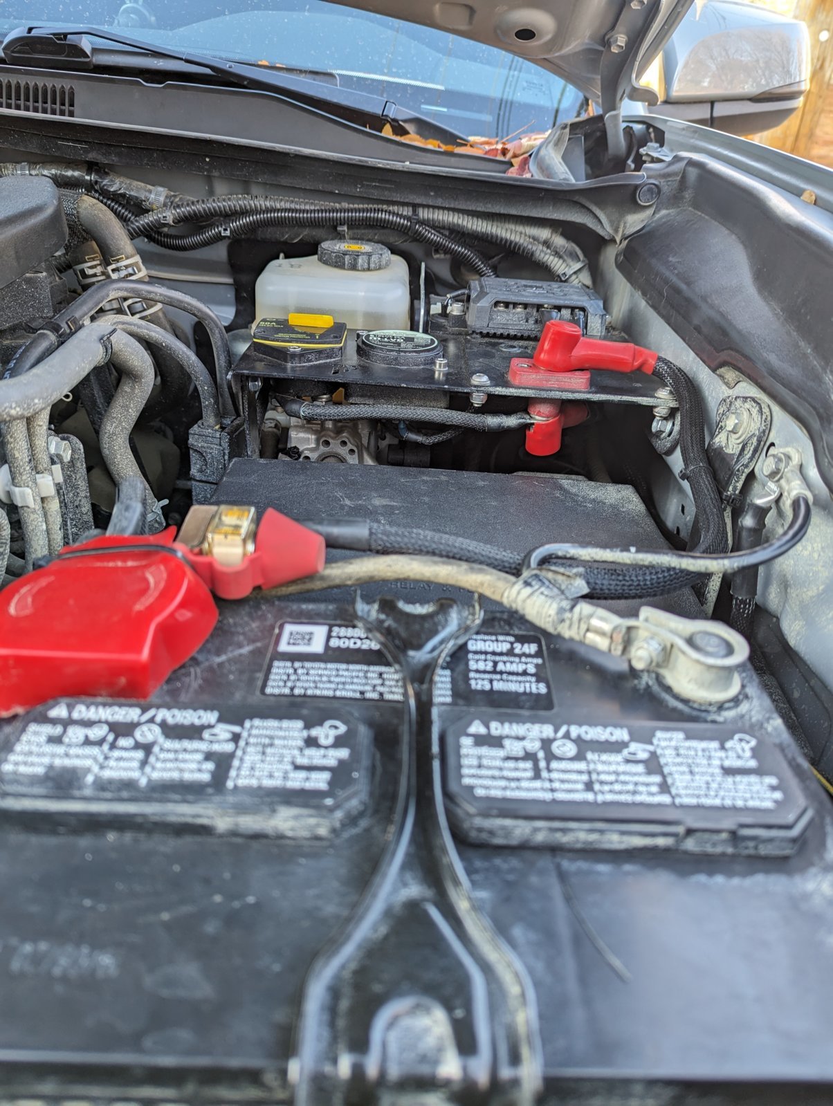

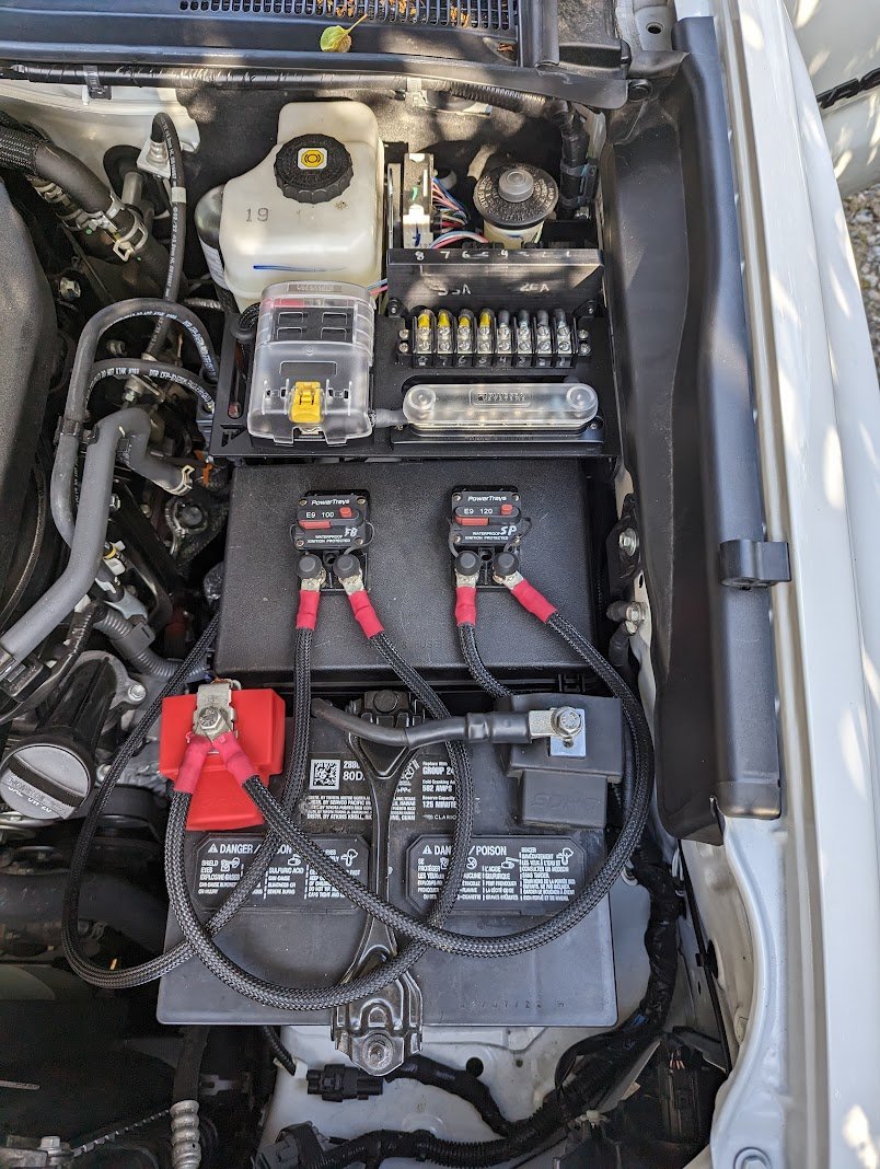

    Got all this bullshit squared up and installed and running. Wanted to do this project/install exactly how I had envisioned it and make it as future proof/expandable in the future.
    Mounting bracket is a modified power switch bracket that was originally for a bussman block and switch pros. Orginally setup for 2 blue sea breakers. Negative bus is hidden on the backside opposite of the Power switch. Had a custom plate made up and bolted to it for this configuration.
    100amp Bluesea terminal fuse
    2 awg from fuse to bulkhead power post.
    4 awg and inline 120a fuse to Garmin Power switch (came oem like this)
    6 awg to 50amp Bluesea breaker
    6 awg from breaker to Bluesea mLVD
    6 awg from breaker to 6 circuit blue sea fuse block in sealed up rear cubby panel. Everything will enter/exit cubby via cord grips/ cable glands.

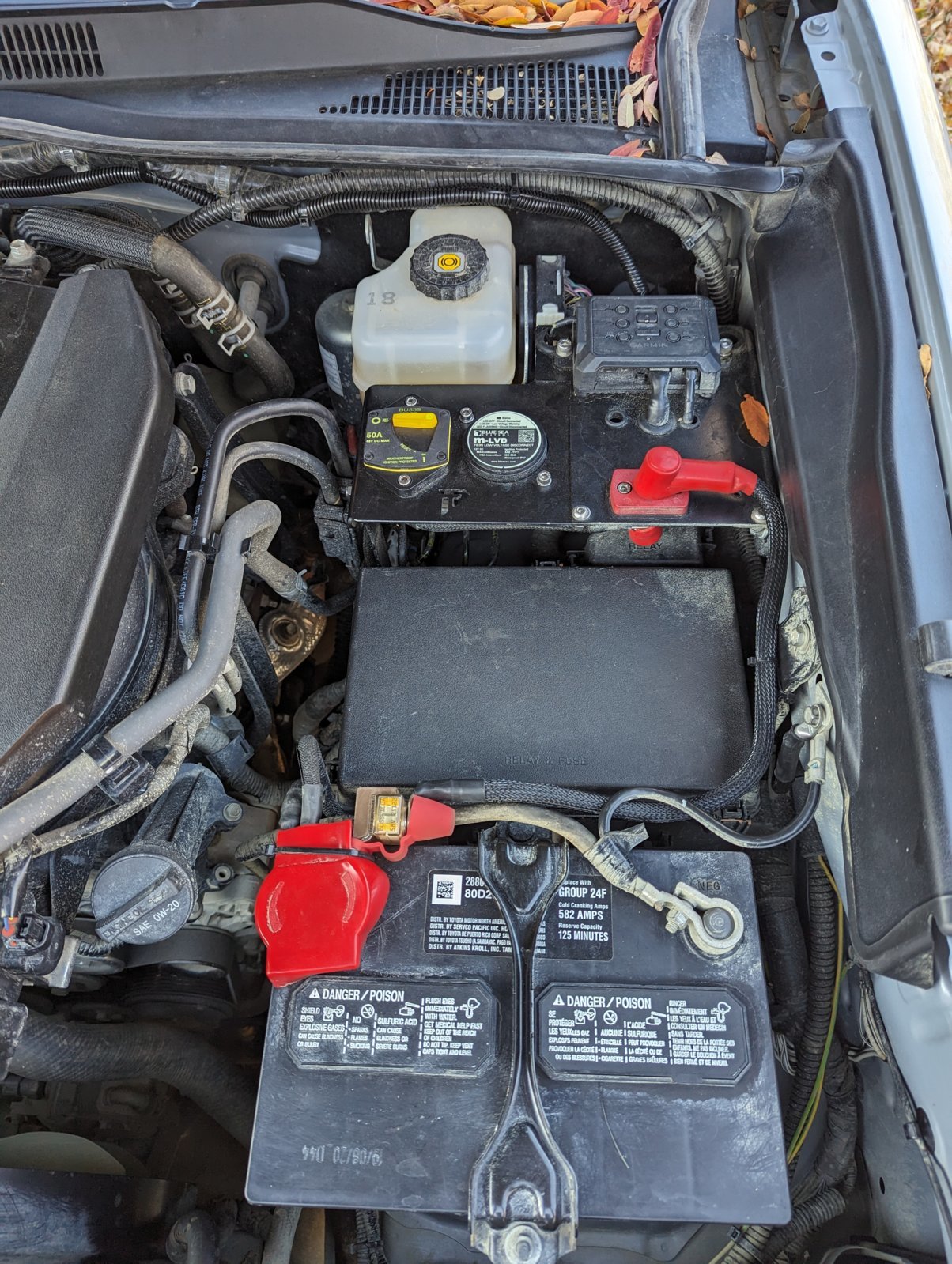

    Just getting started.
    When you relocated your clutch reservoir did you cut the line to shorten it or were you able to make it work without cutting?

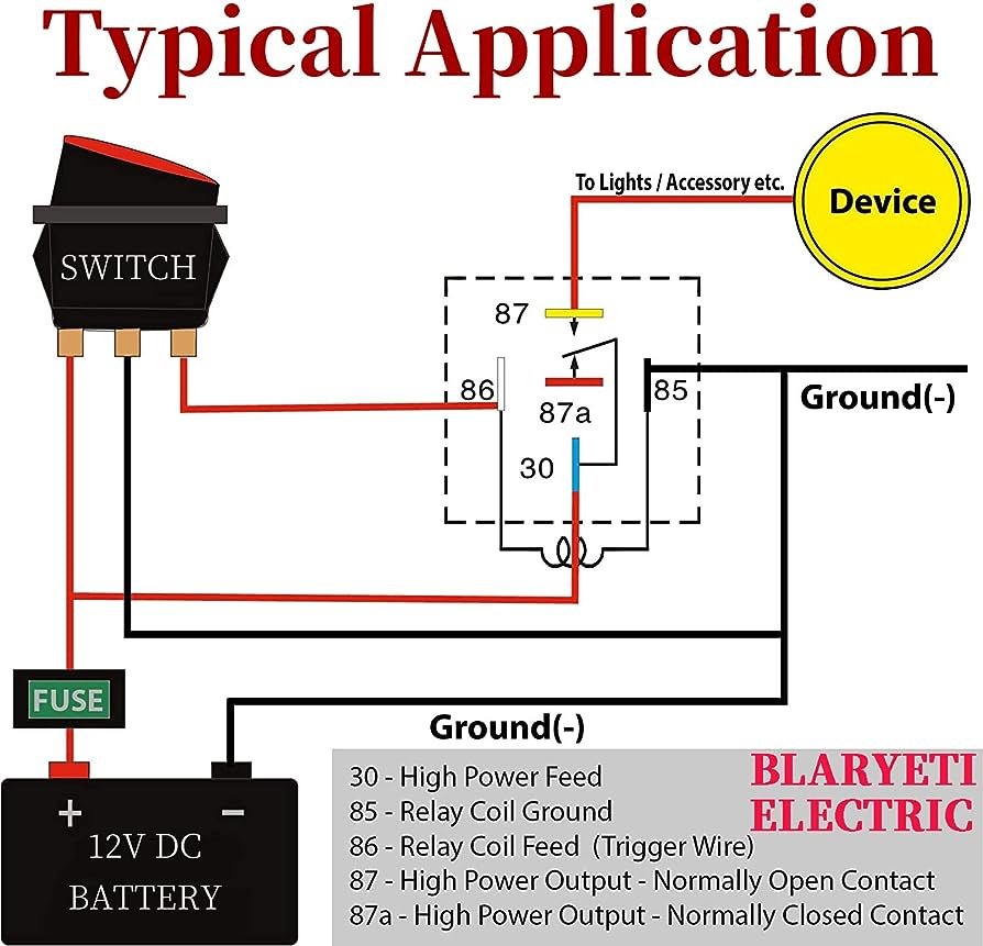

    Like @tacoma_ca said, colight says each light is 60watts, which translates to both lights pulling about 10 amps if you just go with a 12v system calculation, which in reality with the vehicle on the voltage is slightly higher so less than 10 amps for BOTH. Now I’ll just say the cheap Amazon panels will skimp on wire gauge, or run CCA, or straight aluminum wire. But if each circuit is safe for 20amps then you could do what I originally said which is cut the power and ground leads at the relay on your harness and run the lights to your Amazon panel.
    If you rather stick with using your panel as a trigger for your harness which overcomplicates a bit then see this diagram which is basically probably what your generic harness has going on :
    You’d have to cut the wire that goes from the switch to terminal 86 on the relay and connect that to your Amazon panel. That’s it. Heat shrink the other two loose ends that would’ve gone to the switch. In that case though the 20 amp fuse on your Amazon panel is just fusing itself as a trigger lead and you could downsize the fuse to like a 2 amp.

    Awesome, the second part is what I was looking for originally. However now seeing that the lights aren't pulling that much, I may just wire them to the aux box. Much appreciated

    I was able to bend it in a way that avoided cutting it. Pain in the ass though.

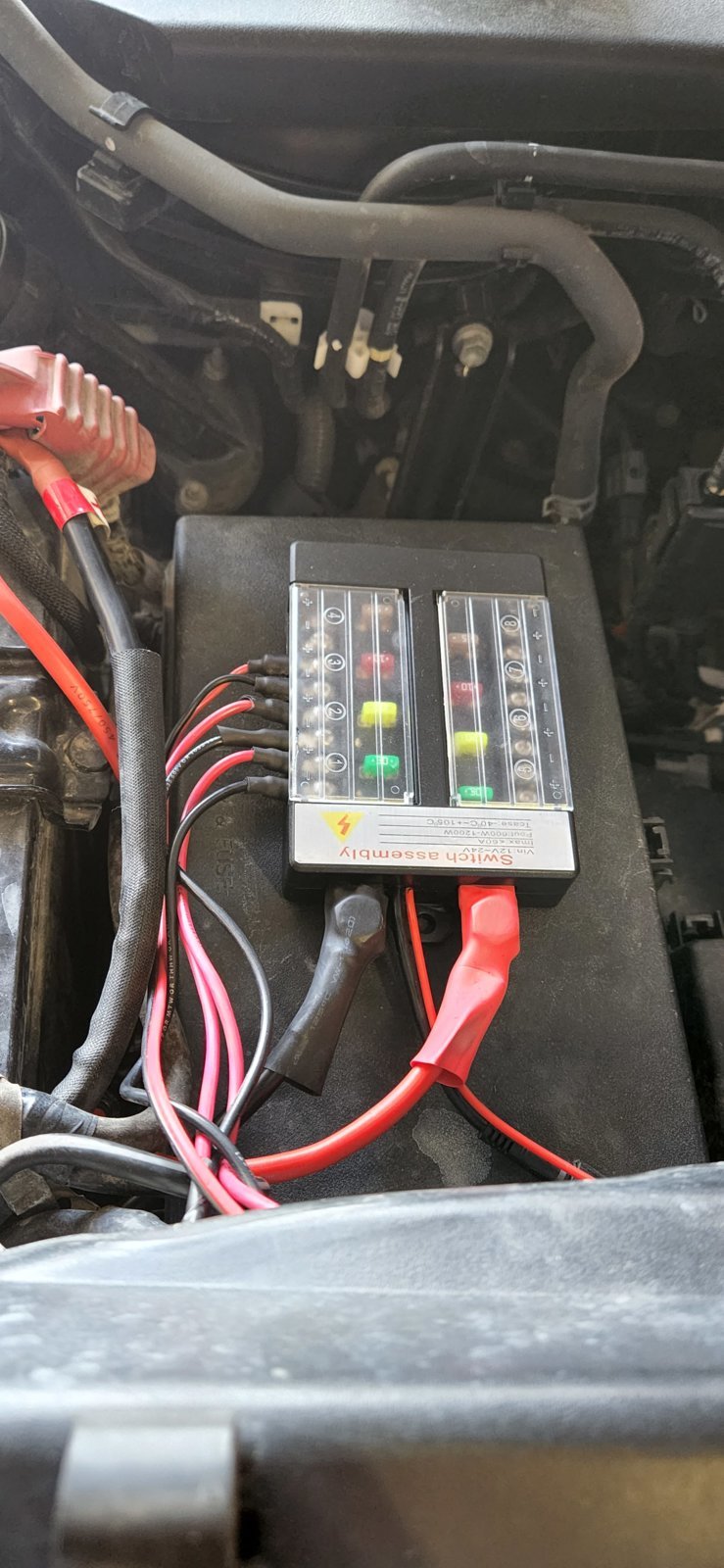

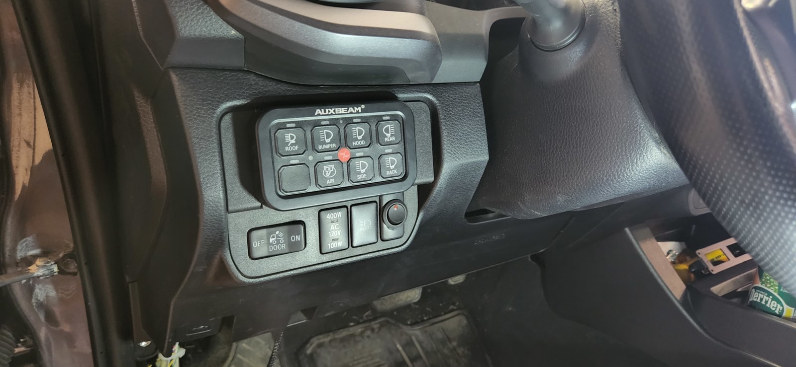

    Just an aux beam 8 position. Been on the truck since the spring with no issues. Only thing I did was put the power feed on a switch rather than a switched 12v feed. To power camp/awning lighting. Looking forward to adding a few more lights and onboard air to it down the road.

    Check the specs on your fuse panel and compressor since most panels seem to have a 30A per circuit limit and compressors are usually more than that. You can daisy chain from the panel supply cable to a stand alone compressor fuse for supply.

    It will be used to control a seperate relayed circuit as you are right the Amp draw is far to high for the current relays in the panel
