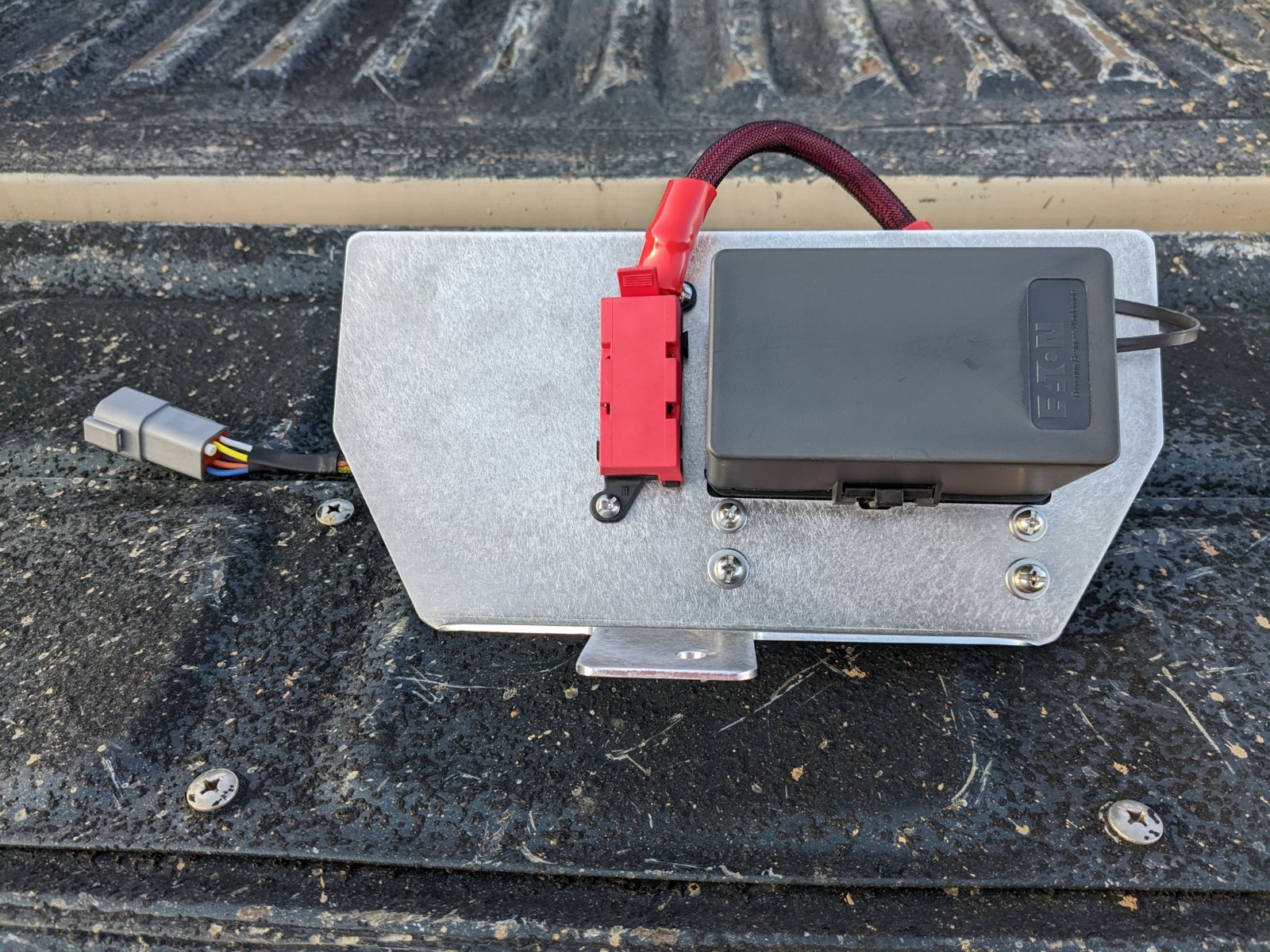

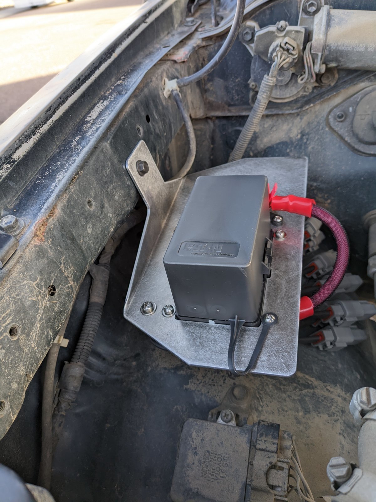

    Here's another one, this one for the 96 Tacoma. Mounting plate by @paranoid56

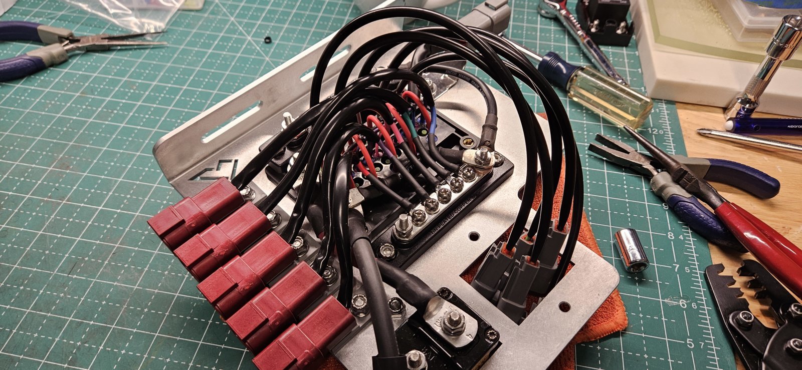

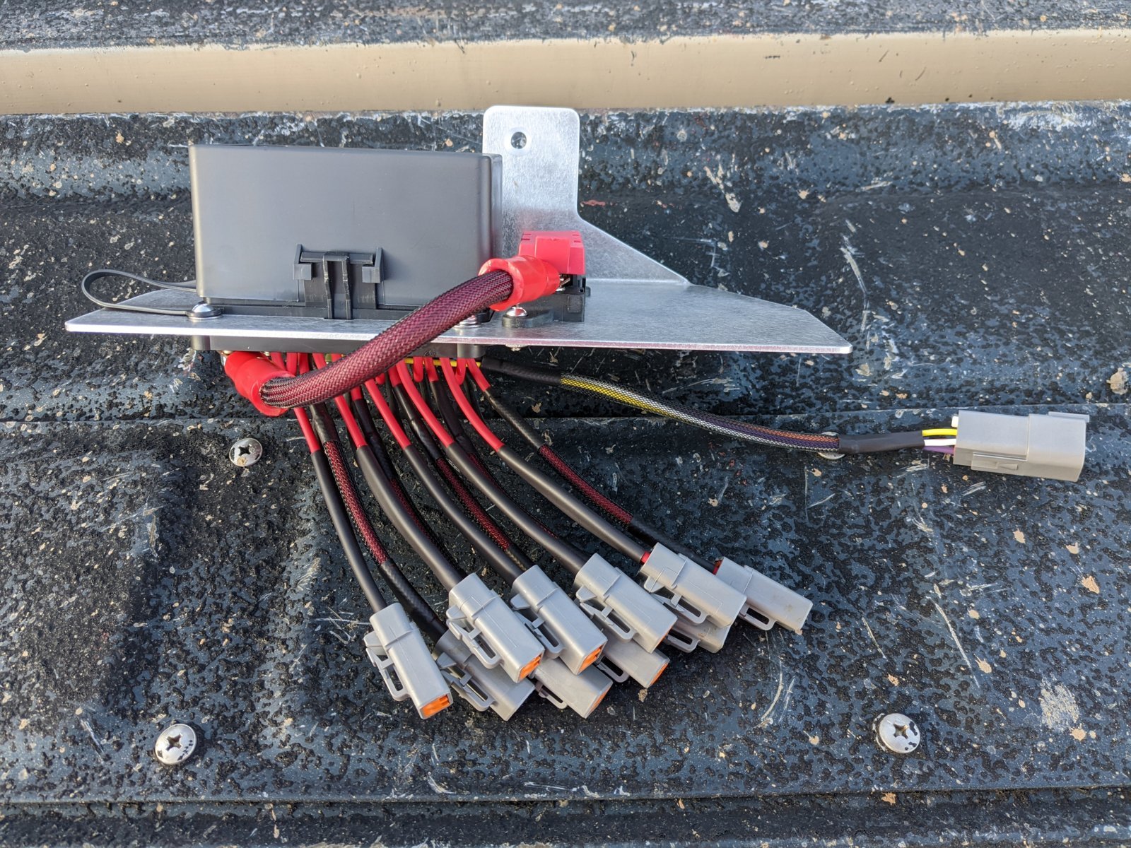

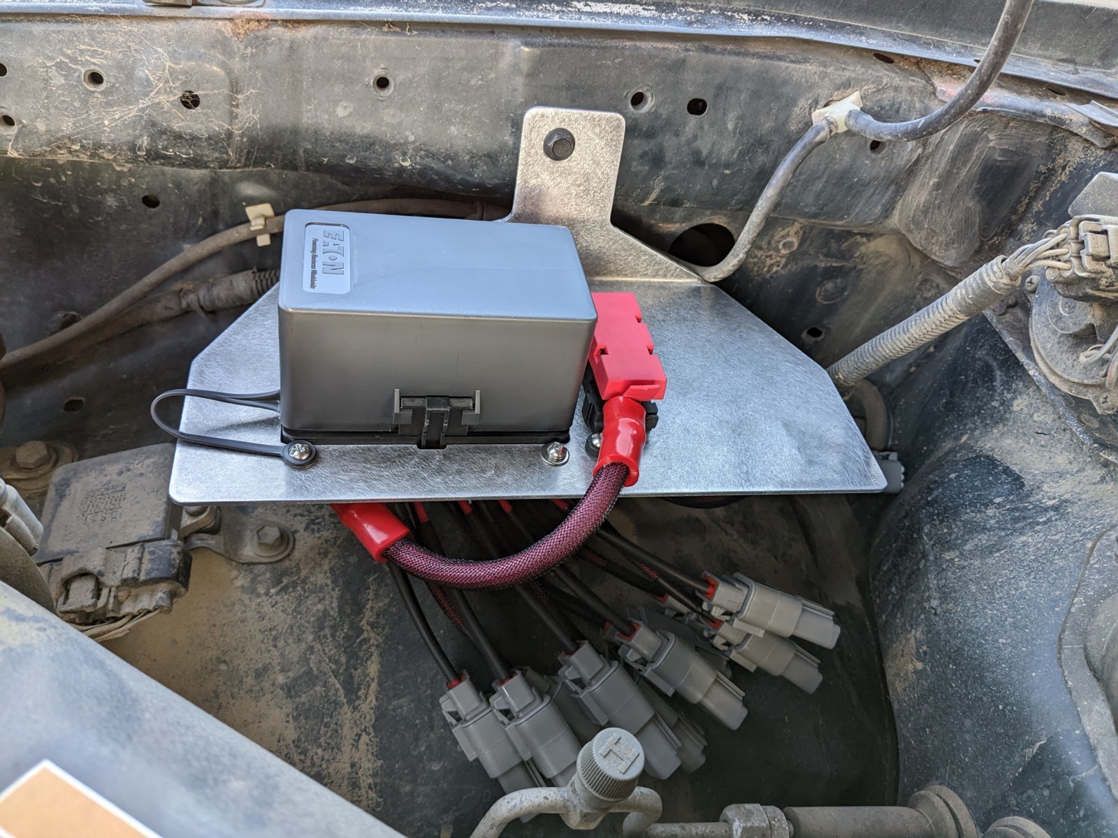

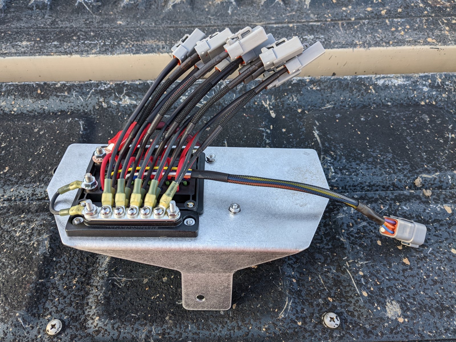

    Finally finished my install:20240504_115852.jpg 20240506_180020.jpg
    I also have a OE bracket, Bluesea 6 circuit panel and some other parts for sale that I couldn't seem to post in the Buy/Sell area. PM me and I'll share more details.

    Nice setup. What gauge/thickness is the stainless bracket and doesn't it have any flex without the extra support down to the wheel well?

    @Foushee , I used a Pelfreybuilt bracket from Bay Area Fabrication (currently on sale for $20: https://www.bayareametalfab.com/Pelfreybilt-Bussman-Mounted-Plate-AUTO-Trans_p_133.html). It's pretty thick, around 1/8" aluminum, so it's pretty sturdy as long as you torque the mounting bolts appropriately. There is also some additional rigidity crated by the wire harnesses once they're connected.
    As a side note, the way the panel is fabricated, it's a HUGE pain to thread & tighten the bolts. It took me about 30 min. with a ratcheting spanner to mount & torque the panel, one click at time.

    Icon Stage 10, Icon Rebound Wheels, OVTune
    You got it. One note, I did a bunch of research on which connectors to use and landed on Deutsch products due to their compact size, weather sealing & availability of mounting brackets. The grey ones are wired to the constant circuits with DT series connectors (rated @ 13A I believe). I also used a 6pin DT connector to run the switch harness to the cab.
    The red ones, are DTP series which are rated at 25A. I used those for the relay'd circuits since they'd likely be running higher current accessories. I got them all at 'BuyDeutsch.com'. If you go that route be sure to order all the parts you'll need (male plug, female receptacle, plug wedgelock, receptacle wedgelock, male + female pins). Ask me how I know...
