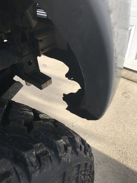

    Your trimming front cuz you caster is set wayyy forward. At 3* caster I only had minimal trim to inner rear plastic fender behind driver tires. Never touched my liners and never did cam mount chop. She was good to go even off road.

    I rub my cab mount now with my crazy caster

    At full stuff?

    Yes

    It's likely because your caster is cranked. Think about how caster works. Yeah you push the front tire forward at ride height but at full stuff and compression its bringing the tire closer to the cab mount/firewall.

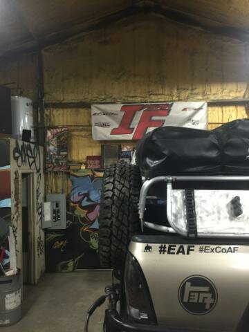

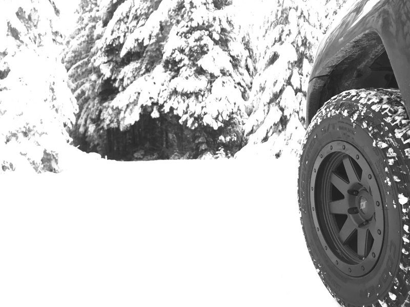

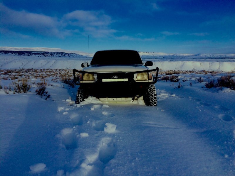

    Need to rotate and such pretty soon.
    Liken them pretty good though.

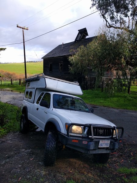

    Mostly I think. I ground and hammered the pinch welds today and feel a lot more comfortable with how it looks now. At some point I'll swap the 10mm fender bolts out for machine screws with countersunk washers as shown on expedition west's website when they install the 255/85 bfg m/t's. I think if I'd gone any bigger I'd need to regear for the taller tire, but with the 4.10 5spd V6 I can get by. You're probably better off than me since you don't the weight penalty of my massive expedition shell. Also fwiw there were less rubbing issues back there before the wheel spacers than after. I think .5" - .75" spacers with the stock wheels would be ideal or just finding new wheels with the correct backspace to have the same effect.
    http://www.expeditionswest.com/equipment/tacoma/bfg_mt_km.html
    Thanks burrito! Super stoked on the setup now that things are getting all sorted out and dialed in. Will definitely be doing a build thread including interior of the shell at some point. I'll make sure to post a link on here and in the signature bar when I do!
    Thanks lotus. More than with the STT Pro's or most other M/T tires! I'm still under 1000mi on mine so I can't comment from experience, but based on what I read in the thread I'm hoping for 20k before their off-road performance starts to decline and up to 50k if I were to run them into the ground. Driving style, weight of truck and terrain probably have a huge effect on this as well. If you read through the thread 'these wear like iron' is a common denominator here. I looked at 235/85r16 also before committing to the larger 32" 265/75r16's. Might be a little narrow for soft terrain, but probably would get the best gas milage out of all those choices.
    Also I was concerned about the 'pulling right' issue that many mentioned and am happy to report 0 issues with my 265/75's in that respect.

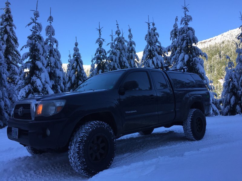

    Have had my STMAXX on for about 3000 miles now love them!15577931_1277696698957579_2069583744767626637_o.jpg
