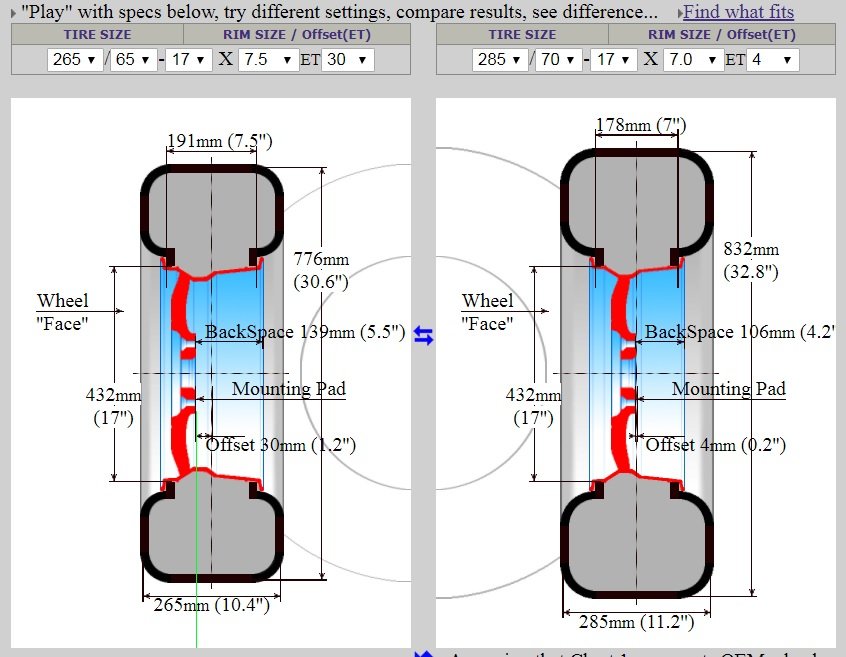

    So help me understand this. I plugged the numbers in to compare my stock wheel/tire to the T4R wheel and a 285 tire. According to this I should even even more room than the stock setup next to the UCA.

    I'm at work, so my connection is slow and it's not loading unfortunately. The only thing that would explain it is the difference in backspacing. Do you know the specs on the T4R wheels?

    4mm

    Oh then it'll definitely clear. That's 4.16" Backspacing, which is more than enough to keep 285s off the UCAs
