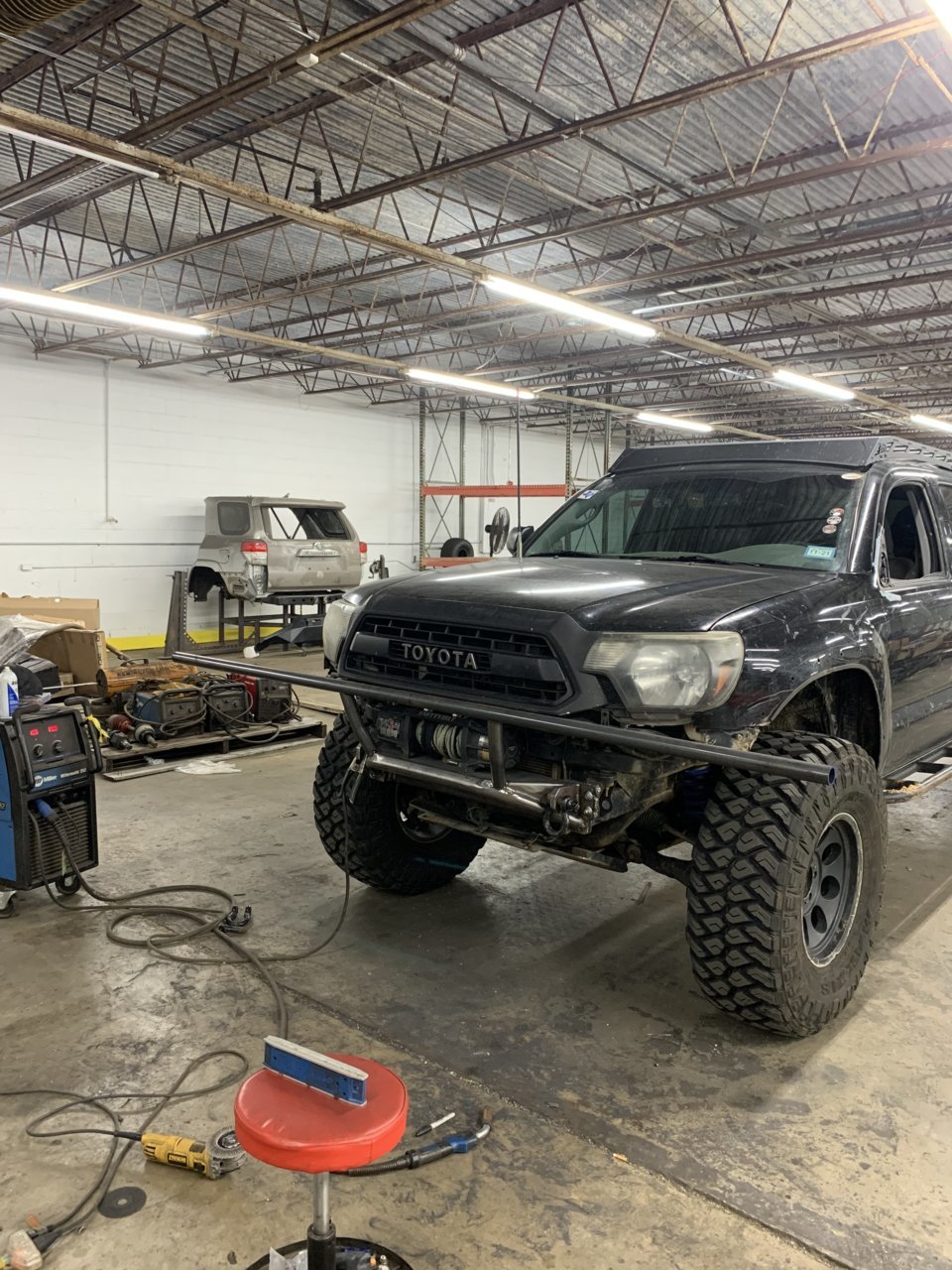

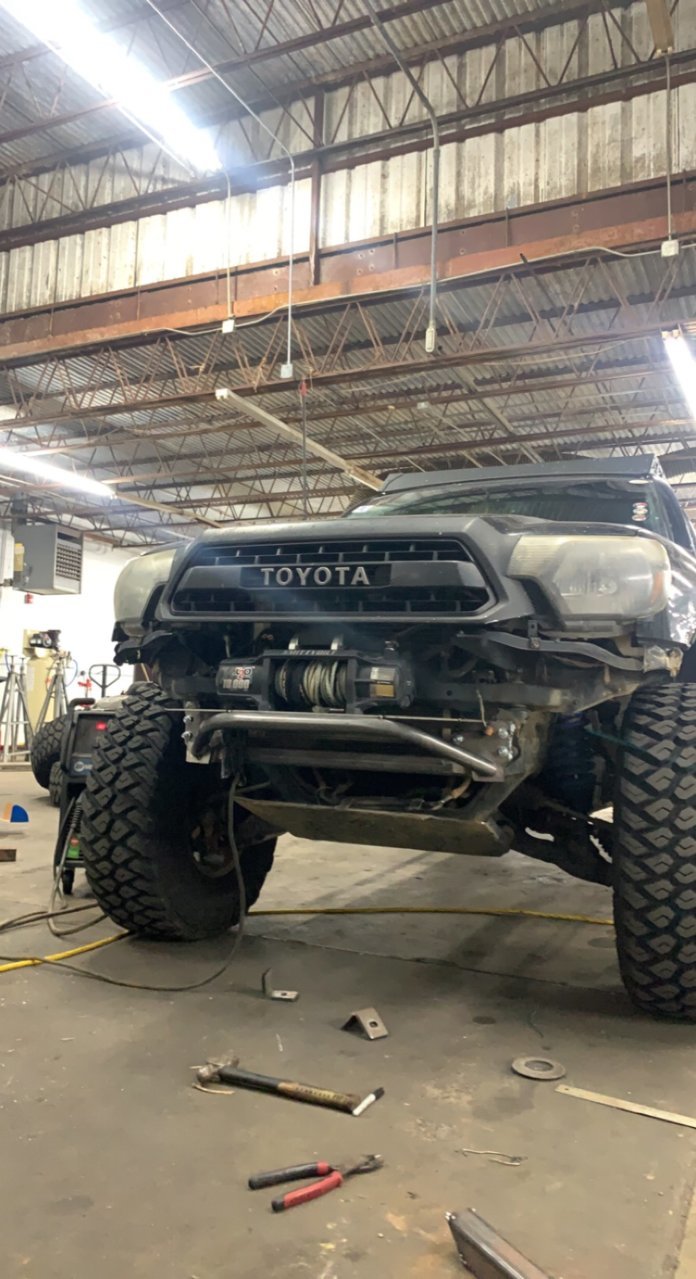

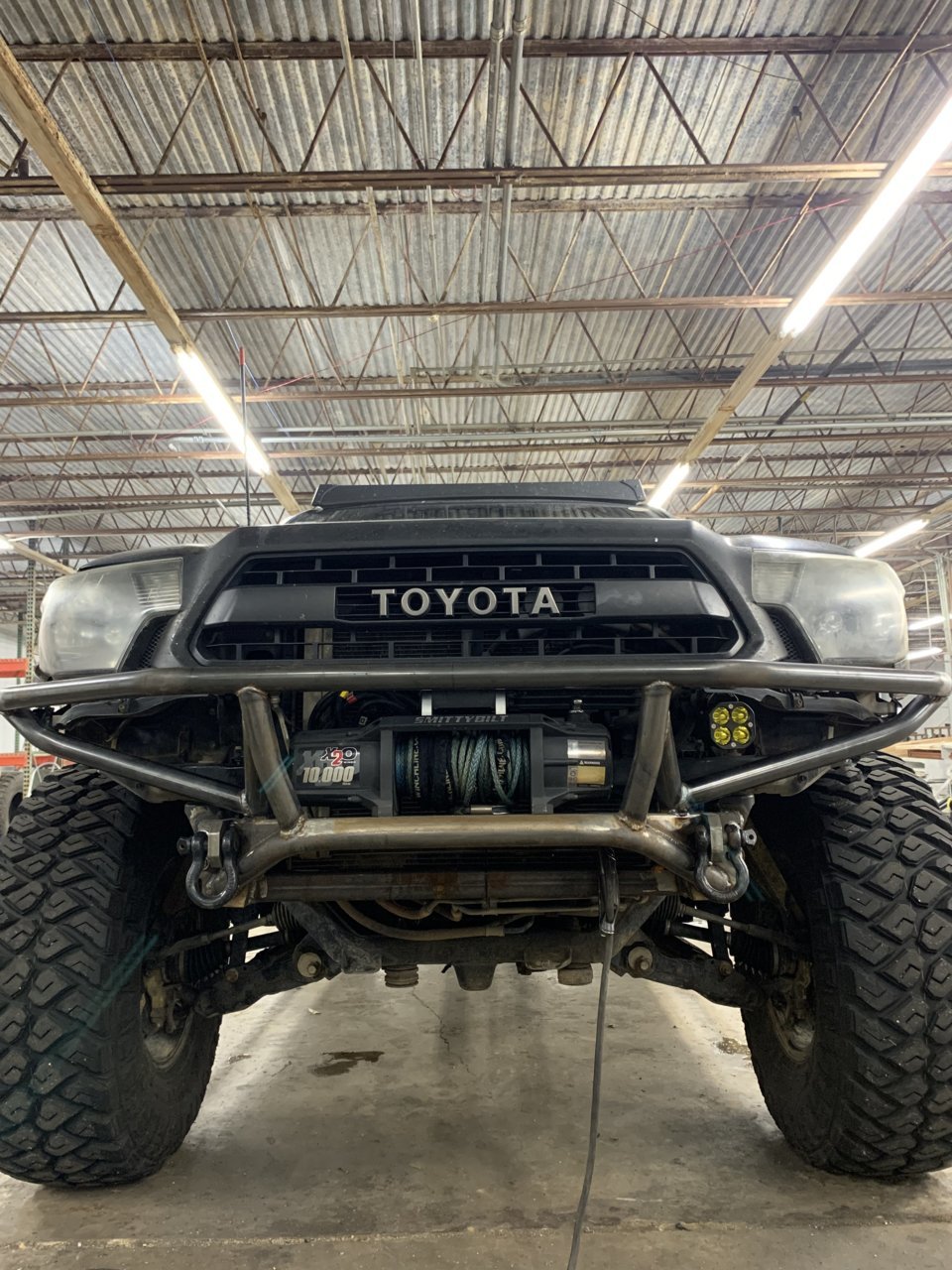

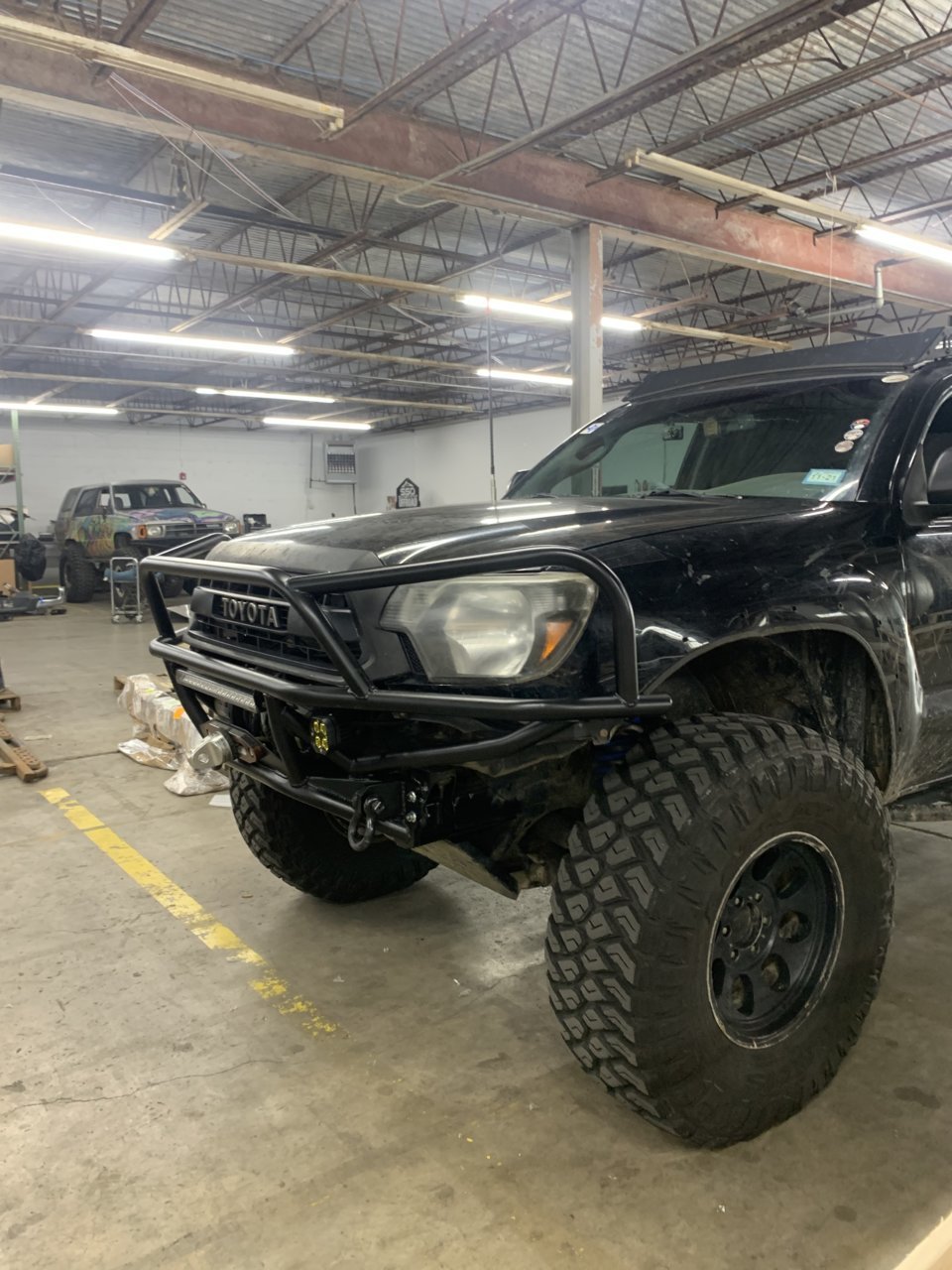

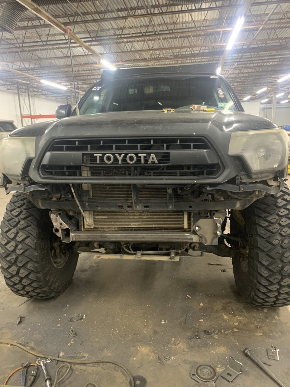

    Just got done with my front bumper. Cut the lower x-member and added a new one right at the frame horns, gained about 5.5” from the previous eBay knock off bumper I had (nearly ripped off) here’s some pics of the process.

    What's up with the half cut 4R?

    I work for Southern Style Offroad. We used that to build our 4R rear bumpers so we know the fitment is right.

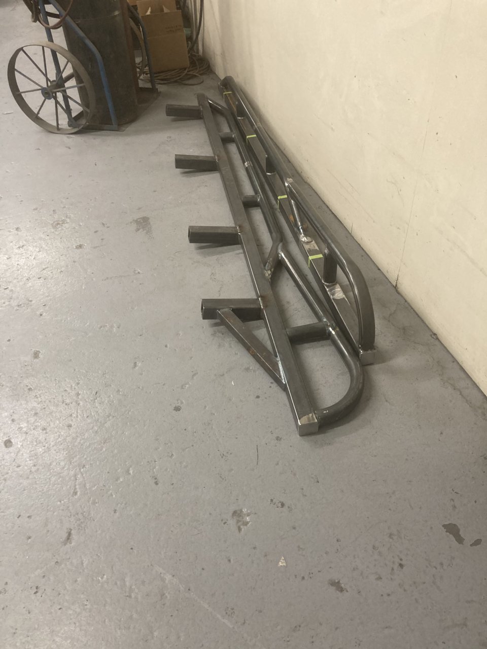

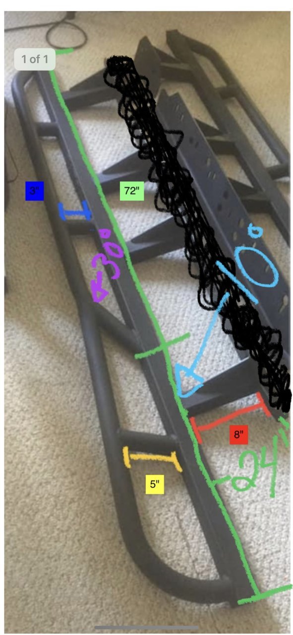

    Made some BAMF clone sliders for my DCLB. Here are the dimensions I used in case anybody needs em.

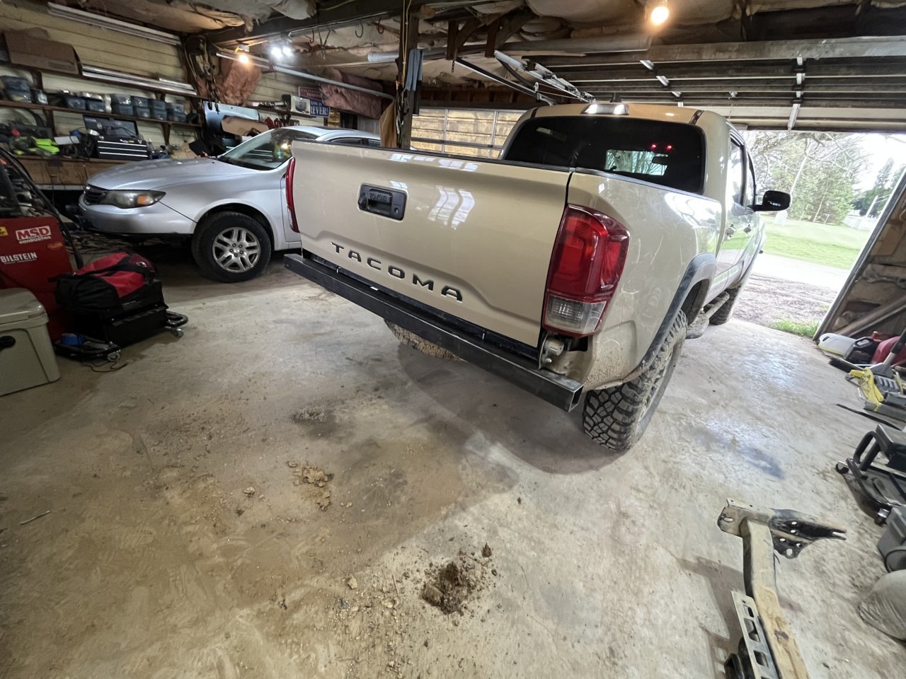

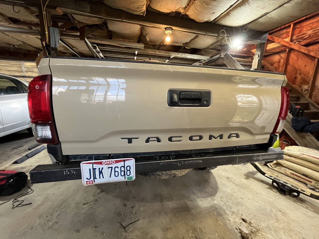

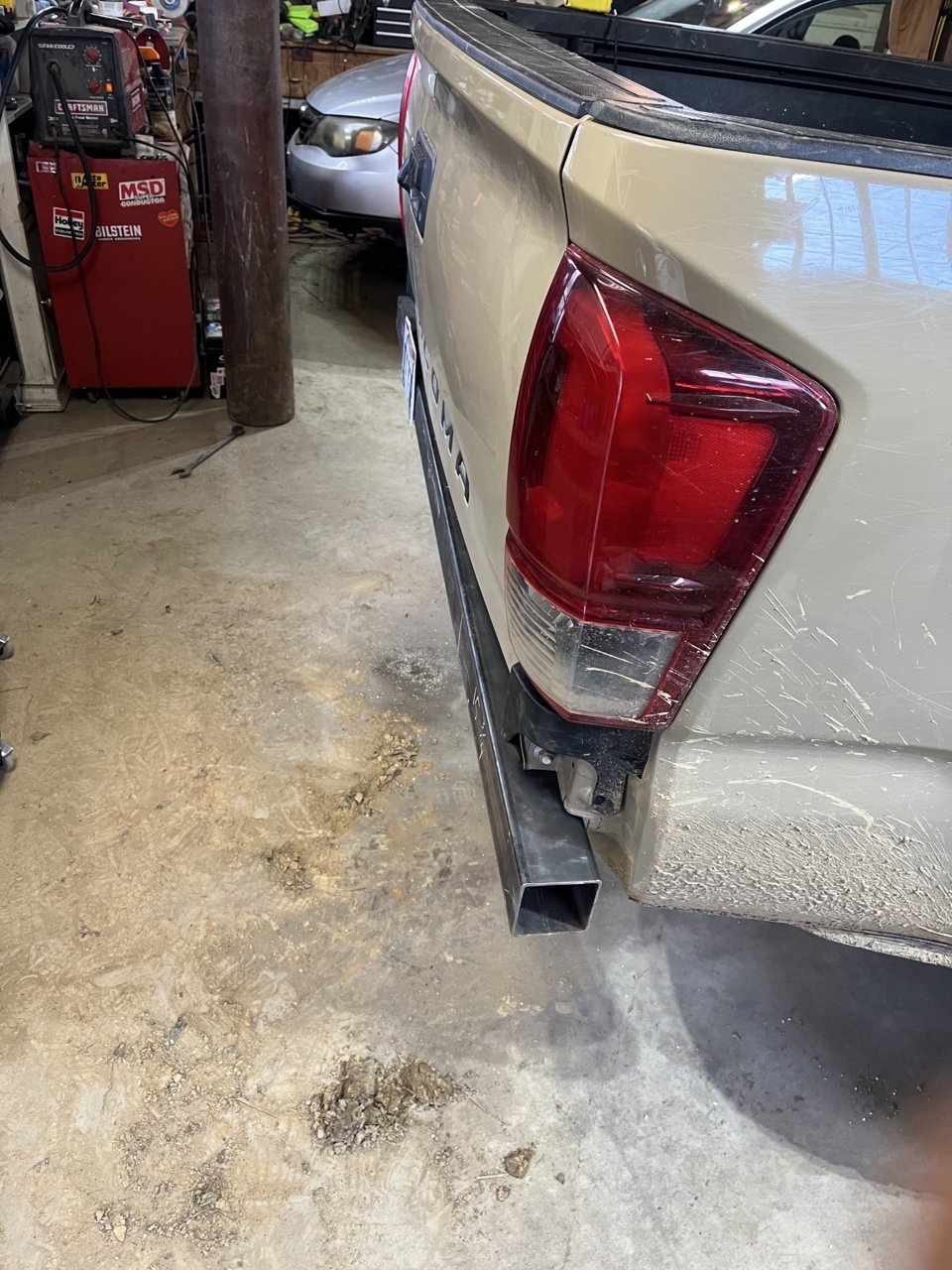

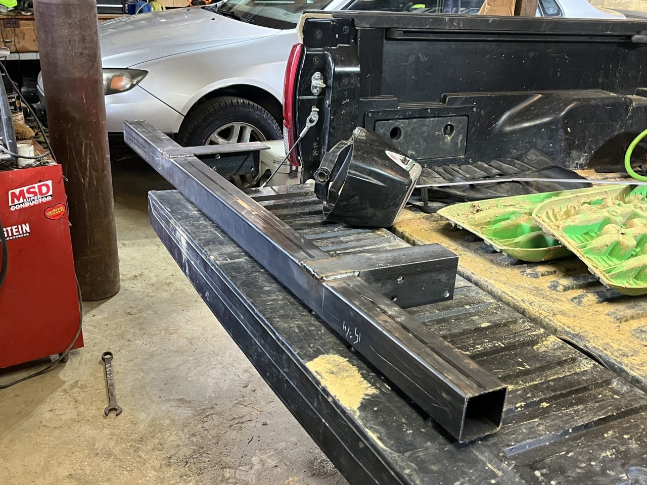

    Second time doing anything like this (and it’s already way better than the first bumper on my Gambler car lol).
    I’ve still got a lot of work to do but it felt good to actually bolt it on for the first time. It’s getting a receiver mount and a set of bed protector bars on the sides but I gotta borrow my works plasma cutter for that to happen.

    You can see the Subaru in the back ground of this pic. She just got a new set of A/T’s and it literally tripled the value of the whole car. I’m running the Detroit Gambler500 this June (with my buddy driving the taco as my chase vehicle) but I’ve got some more welding to do on it before then: winch mount and a skid plate below the engine mainly.

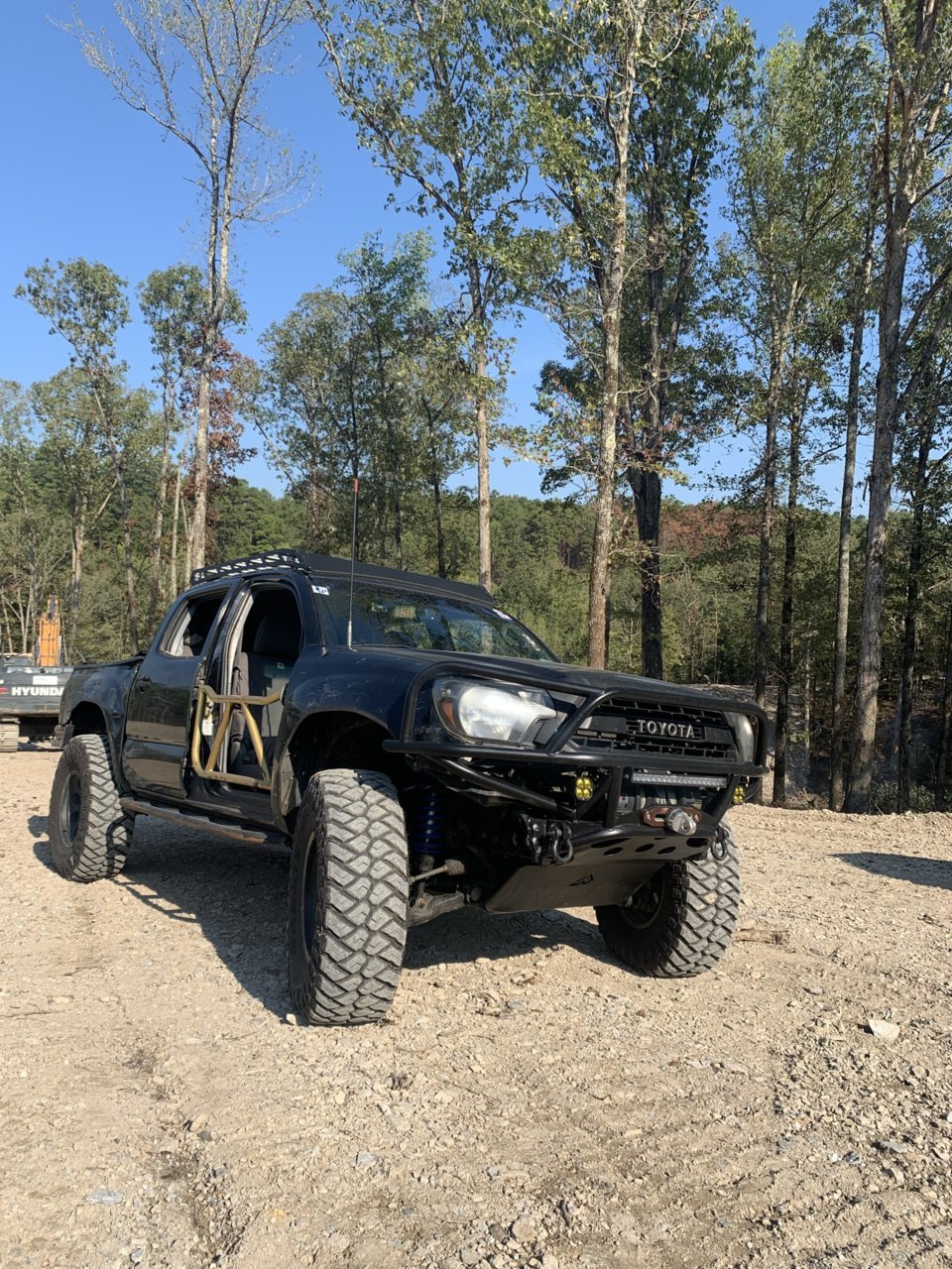

    Making some good progress towards powder coat, just got to finish the tubing and light brackets for the bumper.

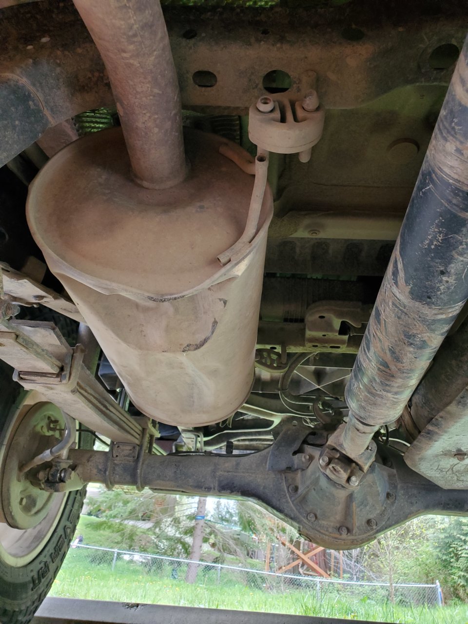

    Homemade skid out of 3/16"s thats heavily ribbed, mounted with 8 1/2" bolts and made it so it rests against my lower pivot gussets to prevent bending where its not bolted.
    Only picture I have, but plated the bottom of my diff to tag along with the rear truss/ring gear plating.

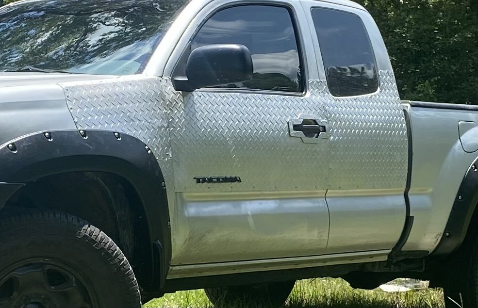

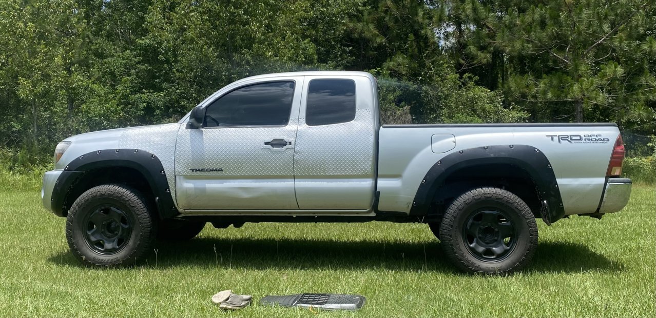

    Leveling kit, wheel spacers, personally fabricated modified frame, and some sweet diamond plate to cover up a smashed driver side! Because I was stupid
    E040EA57-DCAF-4F8A-9397-D13A596A213B.jpg E5CCE3F3-BC45-4ECB-967F-E06A981C365C.jpg
    I was showing off my “body armor” on another thread then I found this one! The diamond plate is covering a smashed in side!
    I need to redo the fender, I ran out off plate and used an old tool box
