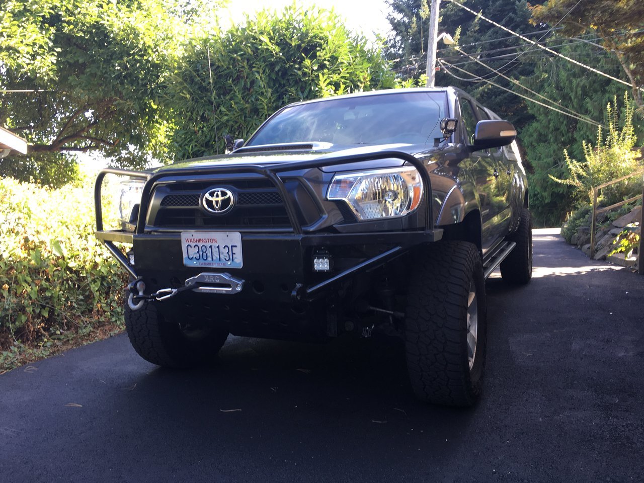

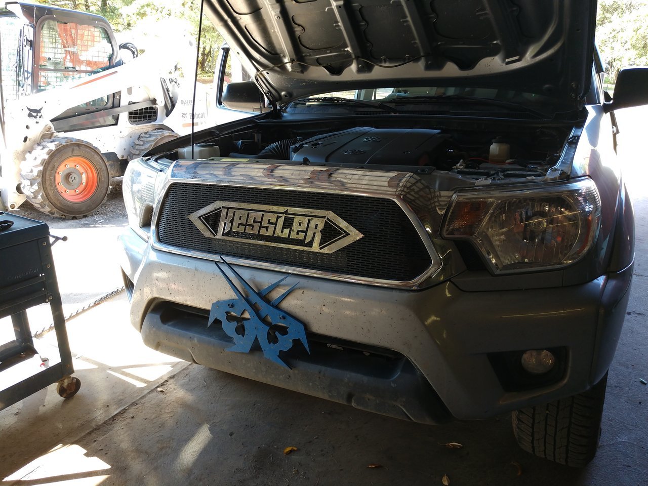

    Did you use a water jet?

    CNC plasma. It's only 1/16" steel so I was able to run very low amps and get a very tight kerf line.

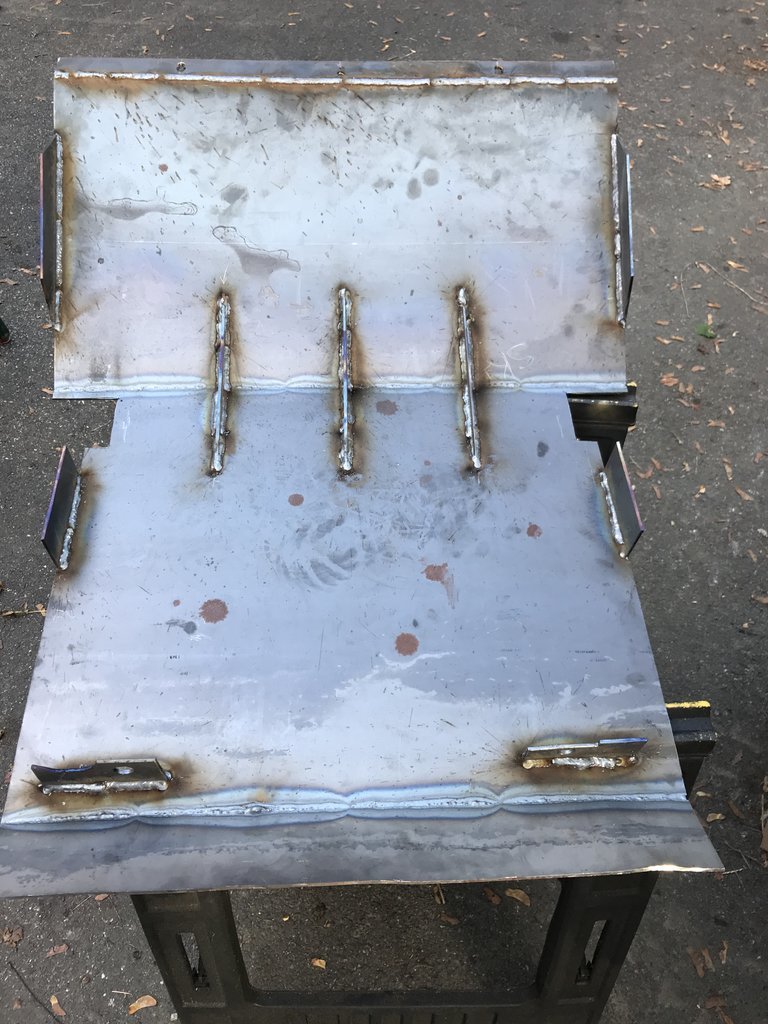

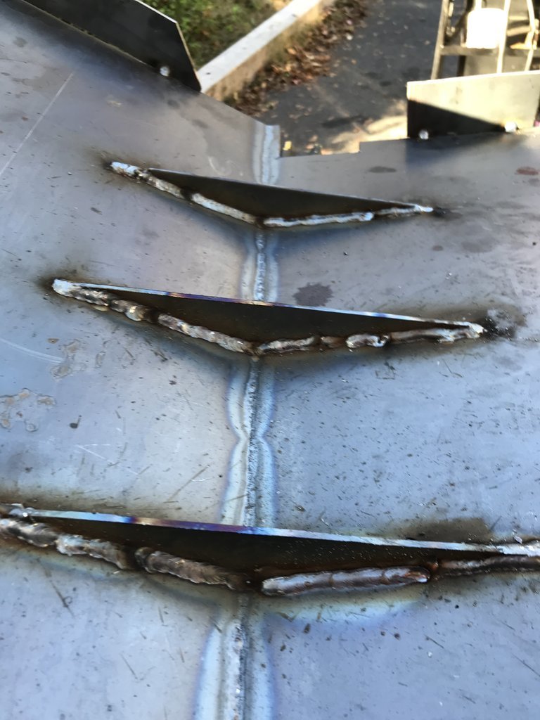

    Got most of my skid plate welded together.
    I'm going to make another one in the spring when I get some plate cut and build a front bumper. This is kind of a rest run and a chance to practice welding.
    I'm starting to design the bumper and want to include space for a winch. Are there any general size specs for the winch plate? or how much space to design into the bumper to fit a winch?

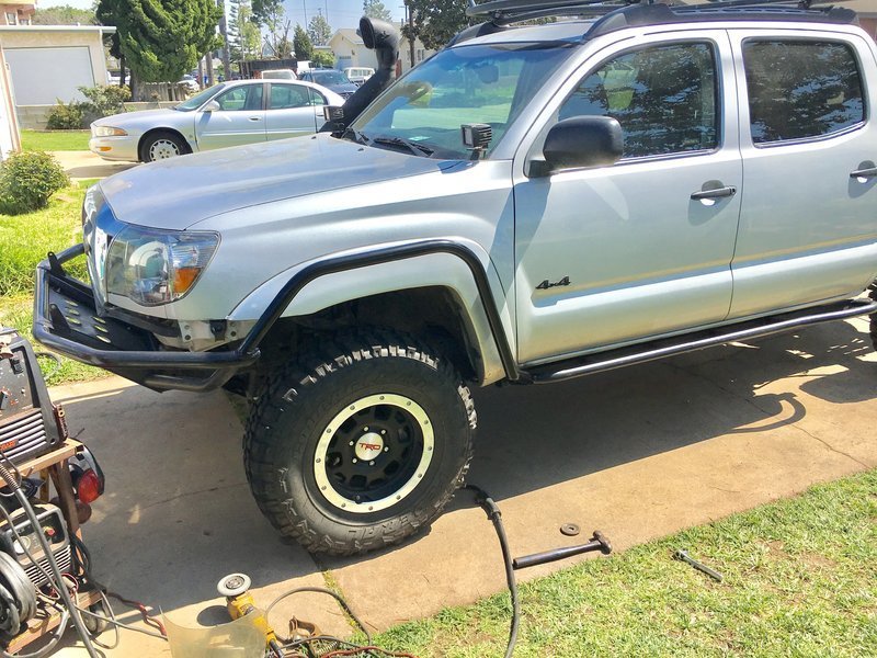

    What are those called?
  8. Oct 19, 2017 at 5:27 PM
    #148
    Shmellmopwho
    Shmellmopwho Well-Known Member Vendor
    Apr 10, 2014
    #127399
    11,682
    Lomita CA
    2013 White DCLB TRD sport
    Bunch of stuff
    Good question! I have no idea what they're officially called. I called them fender guards or fender bars lol

    I would have made my own skids if i had a template to go off of. Too many mounting points for me, but yoursnlooks great!

    Whiskey bend method?

    https://www.tacomaworld.com/threads/homemade-skid-plates.262726/
    Tons of info in that thread. My skid is based on Dirtypool’s measurements and BoxRocket’s rear mounts.
    Oh yeah. Just wondering if I should lay a news down on both sides of the bend. I’m tempted to leave it as I’ll be building another in the spring anyway.

    If you have a Metal Suppermarket near you they can do those long bends for you.

    I do have a Metal Supermarket, but everywhere seems to be more expensive than I'm willing to pay. I guess I'm a cheap ass :anonymous:

    Mine did the bends for 50$ more than the price of the steel. But we did order 2 bumpers and 2 skids from them.
    I also couldn't see doing whiskey bends in 1/4" plate being any fun.

    They were all quoting me 100 bucks to have the three bends. I couldn't pull the trigger.
    I'm sure 1/4" would be a bitch, but probably manageable.

    That's a bit steep.
    Anything can be done :)

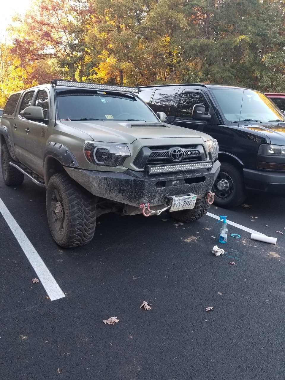

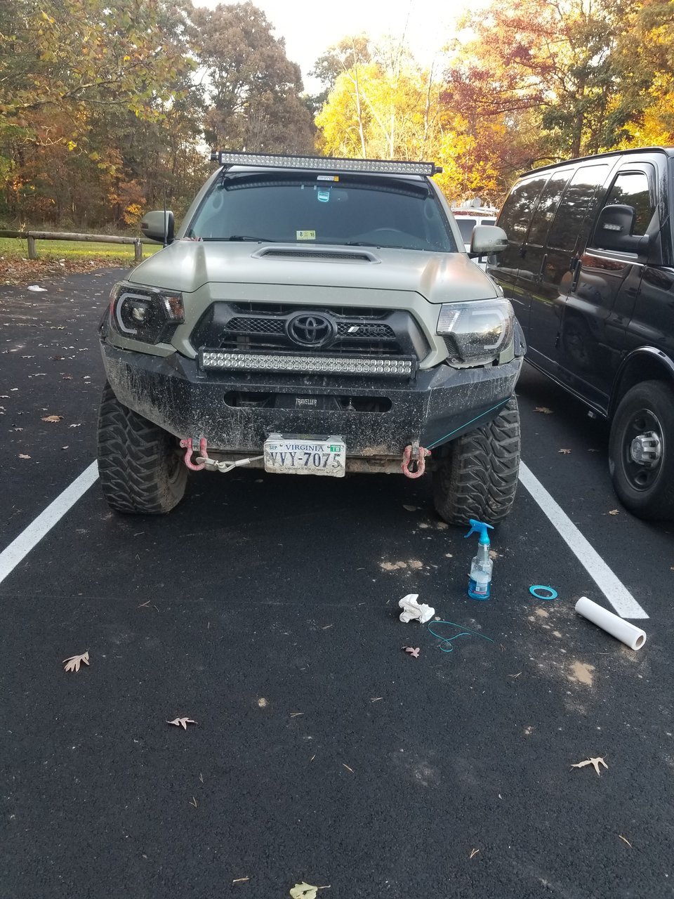

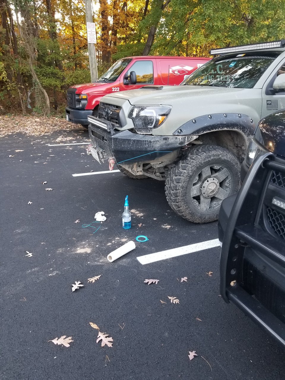

    So, thinking about changing the shape of my front bumper. Any thoughts? Blue tape was where i was thinking of cutting.
    trabo, 05Taco4x4 and DustStorm4x4 like this.
  19. Nov 2, 2017 at 3:29 PM
    #159
    Pot_Lickr
    Pot_Lickr Well-Known Member
    Sep 23, 2017
    #230874
    423
    Ontario, Canada
    2017 Access Cab TRD Off Road
    Very cool bumpers... I like the multiple pieces... Apocalyptic..
    Great job.
