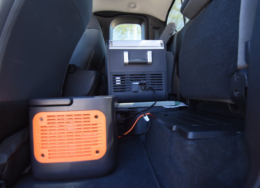

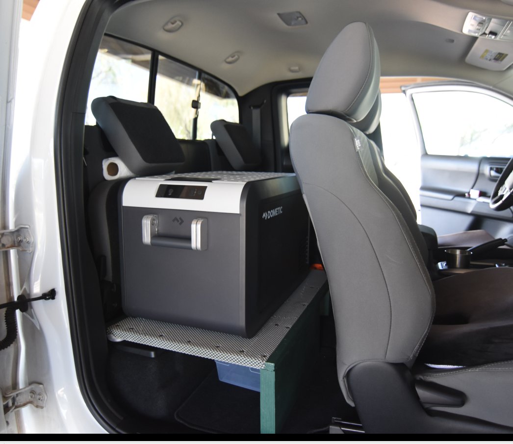

    Mine is pretty simple, and setup for only one half to hold my Dometic.
    It could of course have been built to cover the entire area.
    I set my Jackery 1000 Pro on the drivers side, and run a connection to a new 12v port in the cubby so the Dometic runs off the battery when
    the truck is running, and then switches to the Jackery when turned off. Works great. The rear seat will come down and I can set containers of
    food-stuffs there - coffee/ donuts/ breads/ etc.
    At the end of the day I'm slinging camping gear into the bed and heading in any direction I want.

    Love that, and it makes for a nice little storage area underneath too. Is that 1x6 that you used for the vertical part?

    So the main piece is 20" wide by 30" long... 1 inch plywood.
    The first (front section) right-angle is 18" long and 7" high. These are composed of 2 pieces of 1 inch screwed together and pocket screwed into the main.
    Then right-angle brackets support it underneath.
    The 'hump' piece is 6" long and 4.5" high.
    Depending on if you keep the carpet in the back or not you might have height adjustments of 1/8 inch or so on heights.
    Measure twice ( or three times ) and cut once - leave a little leeway and make your own measurments.
    Be advised at 30" long you can't make 2 of these to fit side by side, you'd have to go less to get everything to fit.
    The hump piece is not 'square' with the end but sets in a bit - again grab your tape measure and play around with it if you want a similar setup.

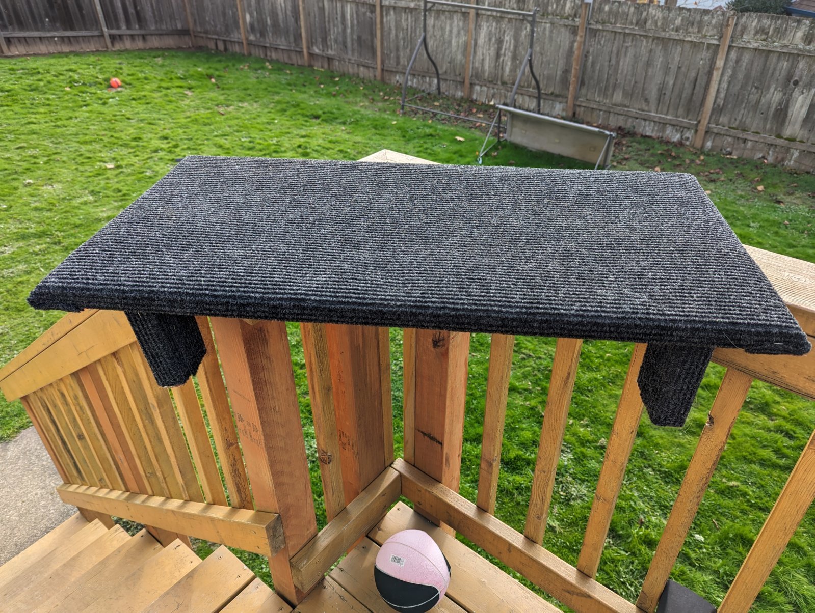

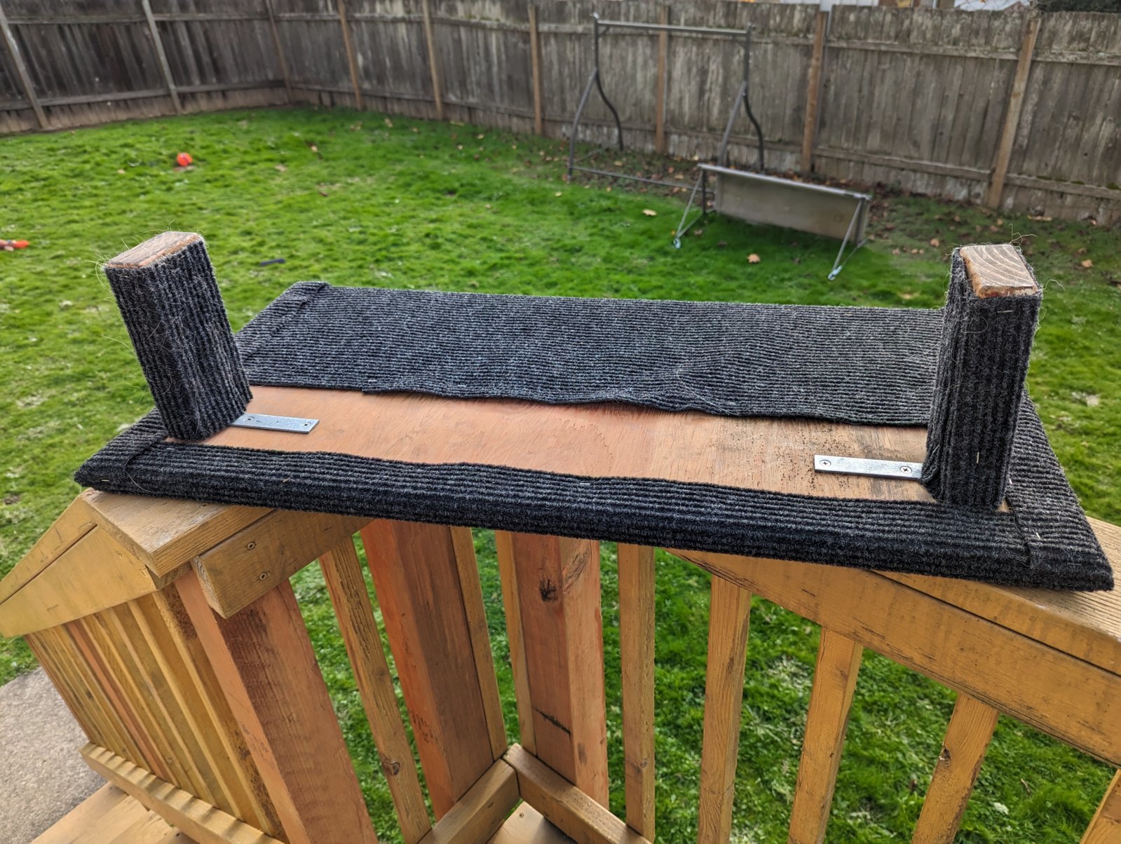

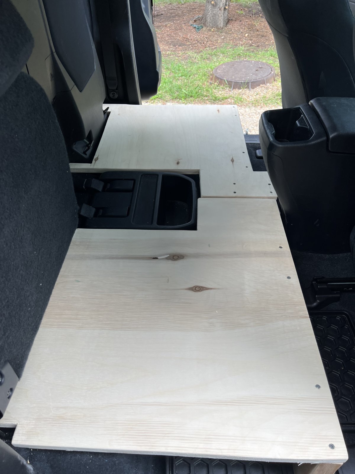

    A couple of months ago I had my dog platform out of my truck for re-carpeting. I have my Access Cab rear seats folded up and the platform sits on the storage cubbies. I made the length slightly shorter so my dog has room to jump on the floor of the truck and then step up on to the platform.

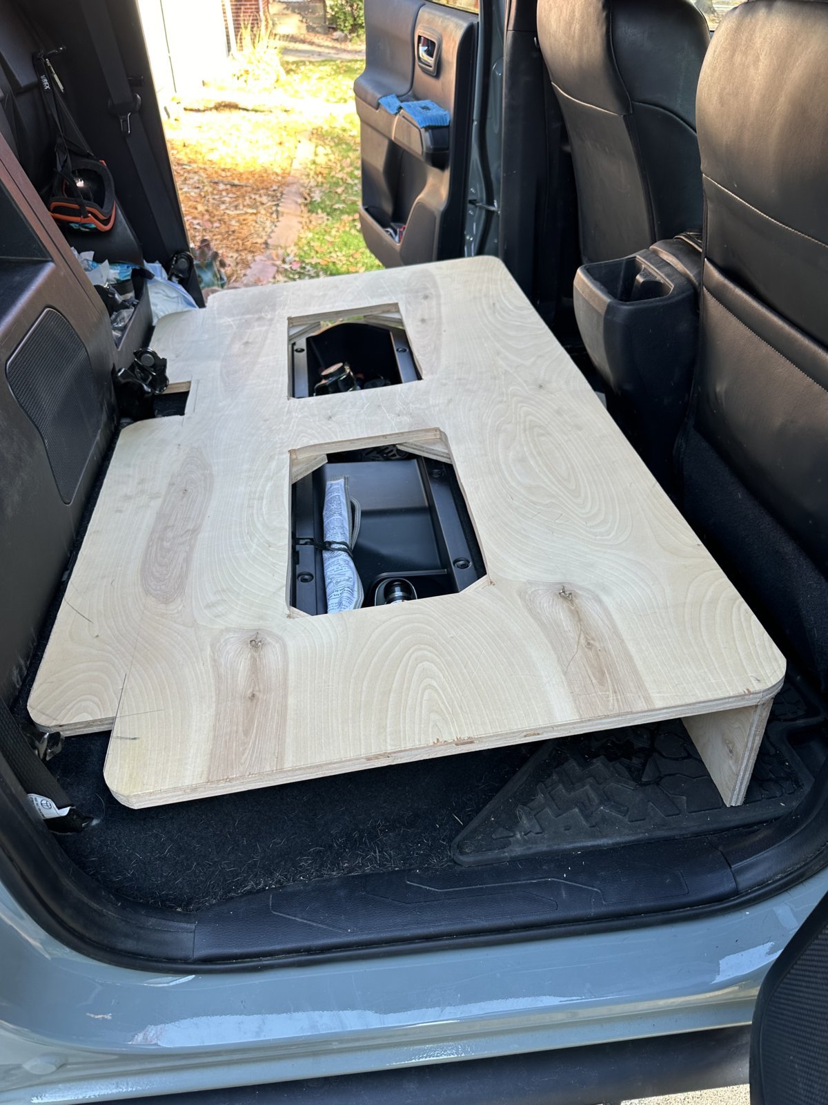

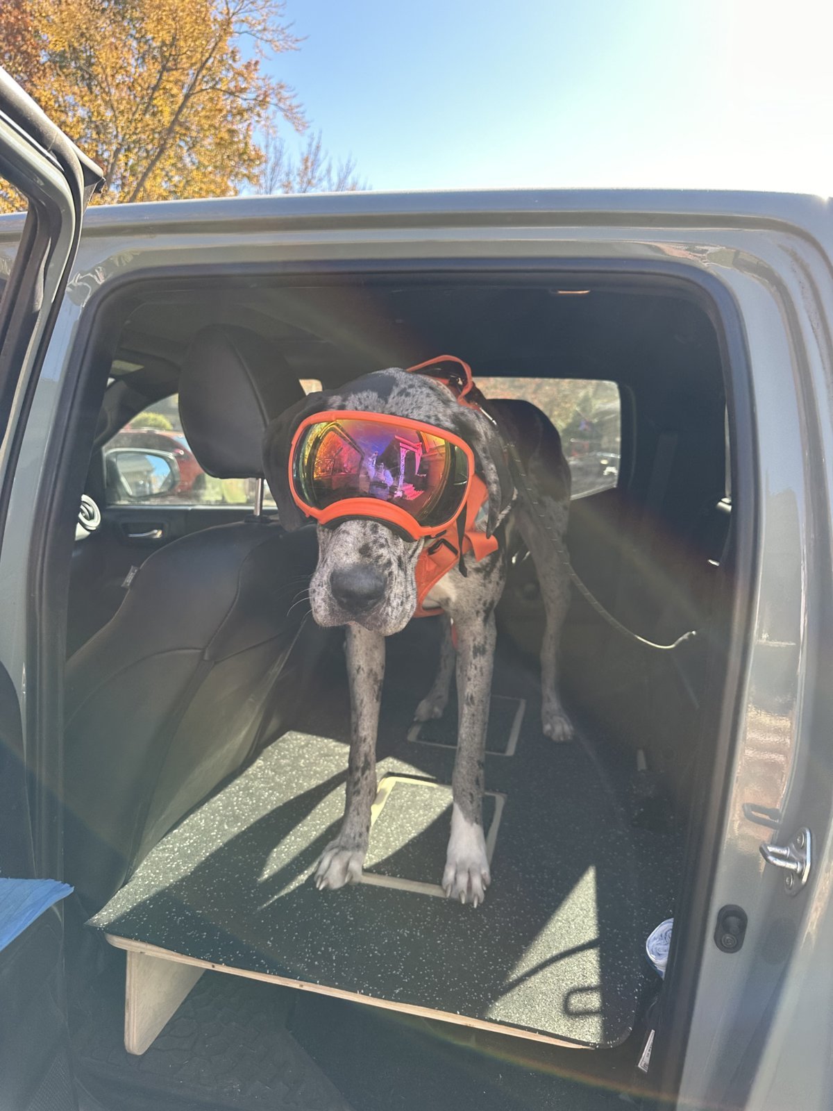

    2021 double cab.
    Two big dogs- 100 lb Lab and 120 lb Great Dane.
    Lined the top with rubber flooring that Menard’s sells as “gym floor”. I didn’t want to use carpet for fear of all the shed hair from the dogs being hard to clean/vacuum. Went with the rubber floor, and very glad I did as it gives my girls a lot of traction in the back when they are riding (or from other things sliding around when they are not in the truck)
