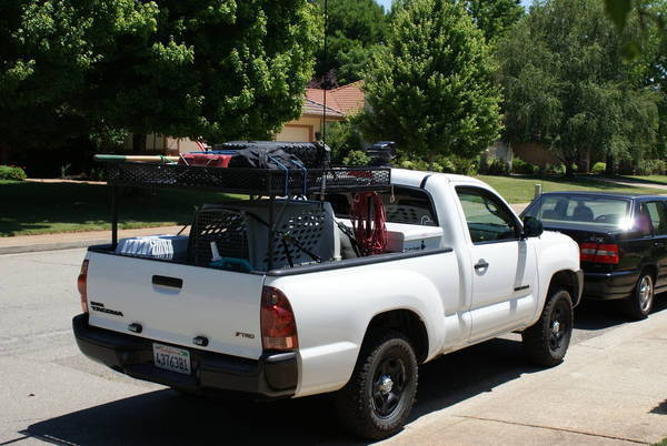

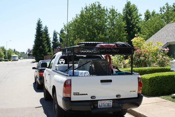

    I bought this rack from a guy that had it on a full size Dodge. After looking at, I figured I could modify it to fit the Taco, seeing as it was completely adjustable.
    He had made it with 1 1/2" & 1 1/4" square steel tubing that slides into each other to adjust. It is bolted together with 7/16 bolts, and nicely welded corner peices. He had made this in his garage himself and did a very nice job! The mods I had to do were, even with it in its smallest size it was still to long and to wide. As well I had to make it fit my bed rail system, as he had it mounted right into the bed wall holes on full sizes.
    Cutting the lengths to size was pretty straight forward. In order to mount it to my truck, in the box on that small lip, I mounted a right angle bracket, and used a 1/2" bolt to go thru the post. I used a 1/2" carriage bolt in the bed rail for the four posts. As you can see in the photos, he made attaching points so the entire rack can be easily removed and just the attachment posts are left in the box of the truck. I made this in order to carry my 12' aluminum fishing boat, as I tow my tent trailer behind the truck. I added the rollers on the back corners. On the front cross member I put an upright 1/2" bolt which goes right into the handle hole on the bow plate of the boat. I made a bracket out of flat bar, which goes on the inside of the bow plate and bolts down the bow of the boat right to the rack. Eliminating the need for a safety line to the front bumper, which I think is annoying to have to do!
    I have done four fishing trips with the boat on top, and it hasn't even budged! The kicker is I bought this rack for $75, and with some new bolts, and hardware and rollers, I am into it for $137! Sure beats a $800 for a factory made one! Hope some of my ideas are helpful. Cheers and happy trucking!
